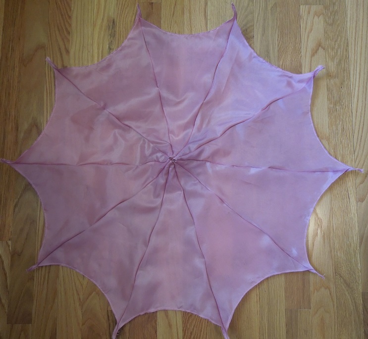

The kit comes with good instructions on how to make and sew the panels. I have a pattern for them, but my wife does all the machine sewing and she's currently working on a pointy-shoulder McGonagall costume!
