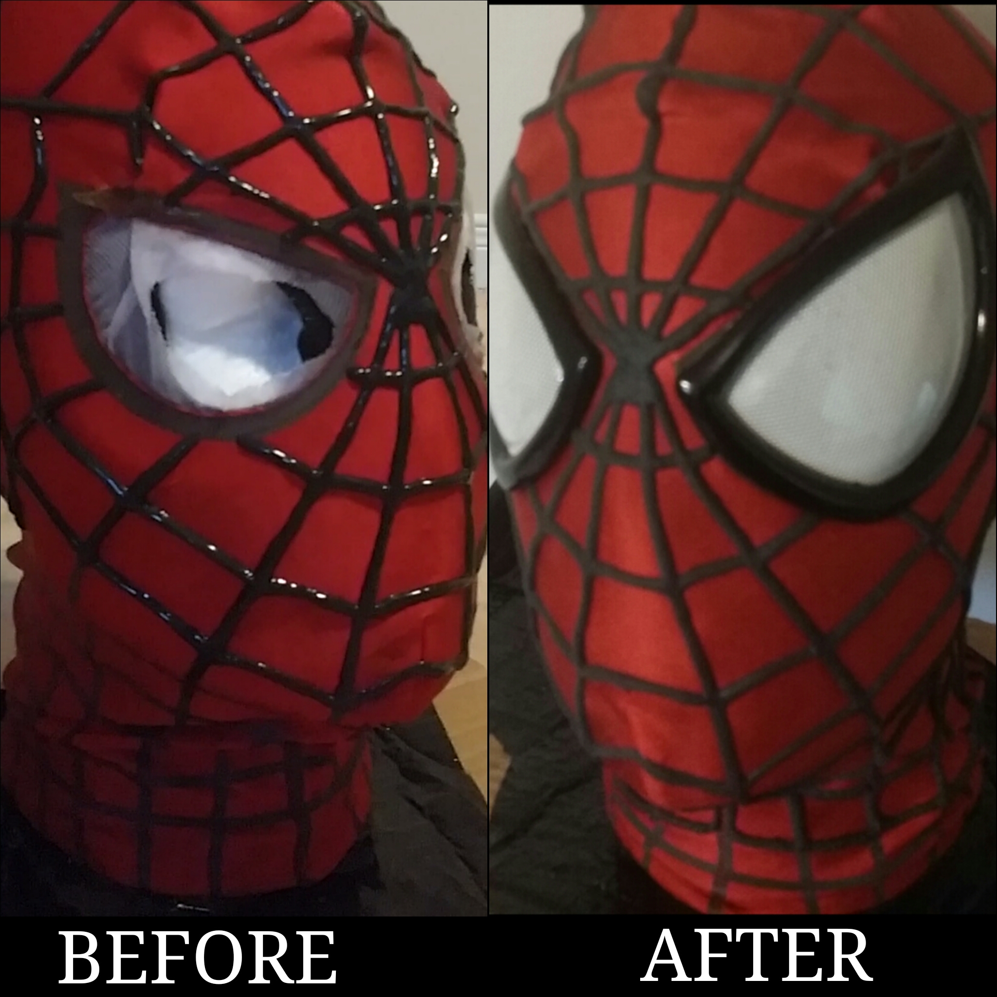

So I admit this might sound a little obvious but Im working on a tasm 2 suit thats going great but until tonight I had NO IDEA that in order to properly activate puff paint you have to blow dry or steam it!
It's amazing.
(I have to start thoroughly reading directions...lol)
Hopefully all you guys are doing this...it makes a MAJOR difference in quality!*
Anyways if yall wanna share tips or photos please do...I see alot of questions about puff paint on here.

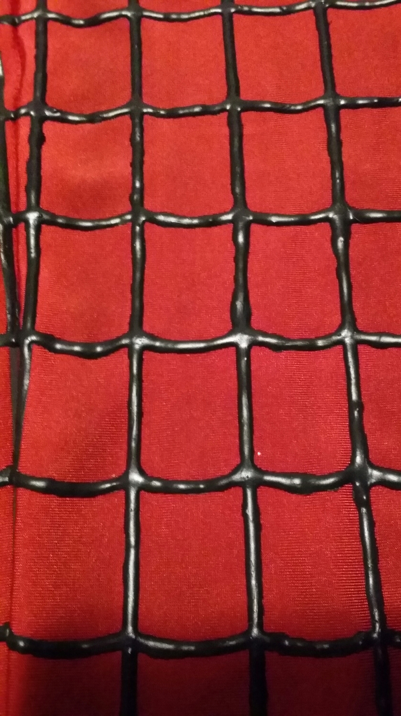

This is a "before" it looks shiny and lower quality....I've see a lot of builds look like this....(no offense...my first build does too) 20141014_235828-1.jpg

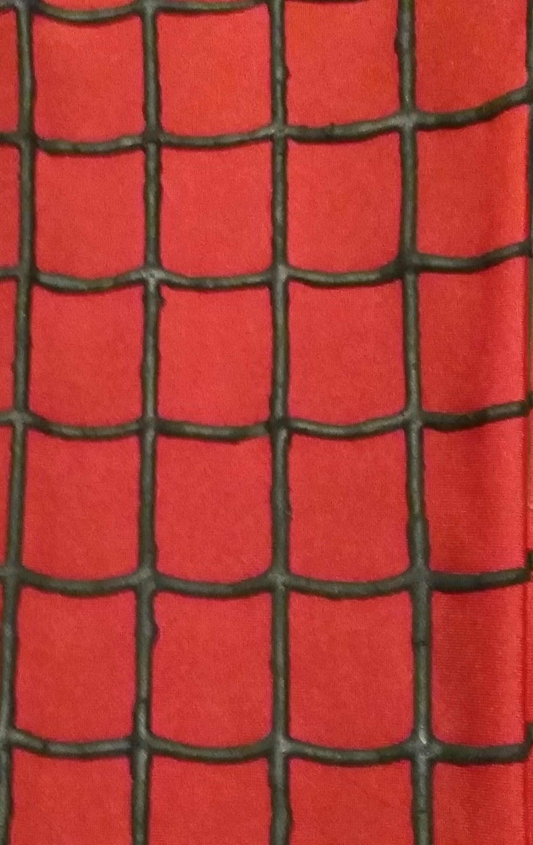

Here's an "after"....granted my lines are a bit wobbly here but the level of puff is good and the matte effect is dope..20141014_235845-1.jpg

I wonder if that's why the puff paint always had this tacky feeling to it and would stick together if I didn't hang the suit on a hanger. Thanks for the info this helps a lot
Yea exactly!
I would run into the same problem before....and also the rise on the paint wasn't as high as I wanted...but I thought it was just always gonna be that way....but once you blow dry it....you see a major change.
No more tacky feel....no sticking together. :)
How long should I blow dry?
Hard to say as blow dryer heats vary....what I can say though is you will visibly notice the change in the paint....and can stop when you feel you've gotten the look you want...
For me it takes literal seconds!
