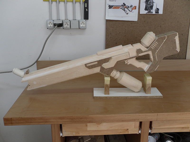

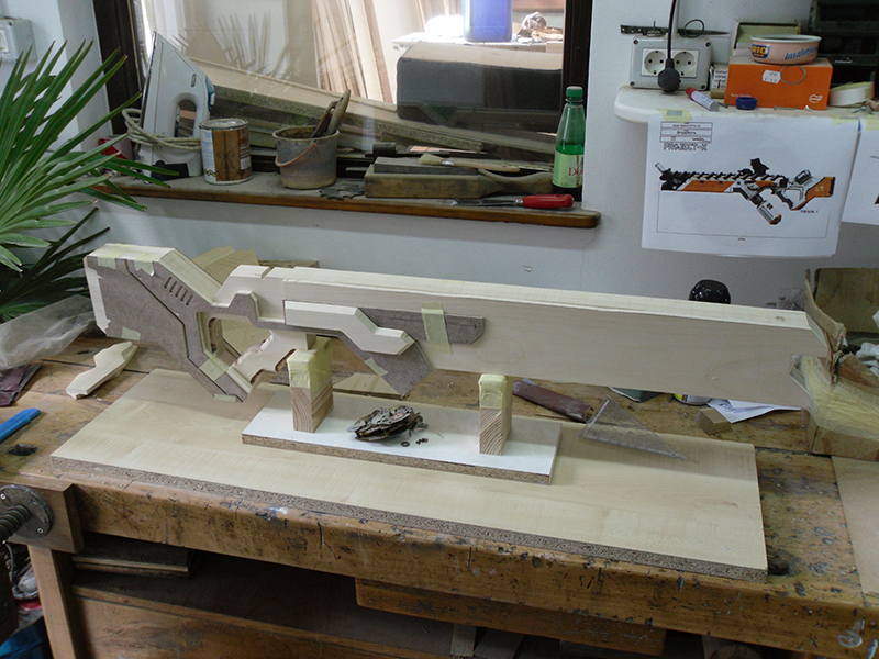

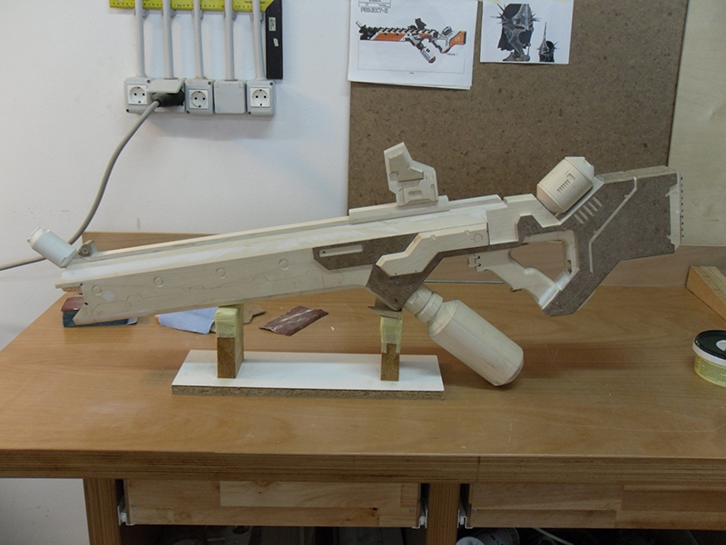

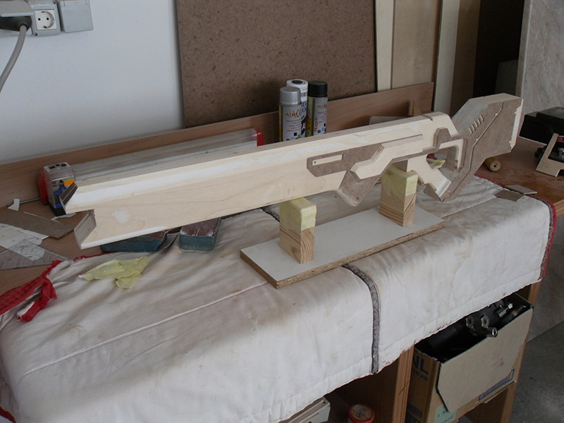

some time ago I started building the Assault rifle from District 9 and recently picked it up again. I am making it out of wood - maple and mdf, using some amount of layering. It has a good solid heft as it is now.
Reference:
Progress so far:
And this is where I'm at the moment:
I'm keeping it pretty screen accurate but I did change a few minor details to make it easier to build.
I'll update as I progress.
Thanks for watching.

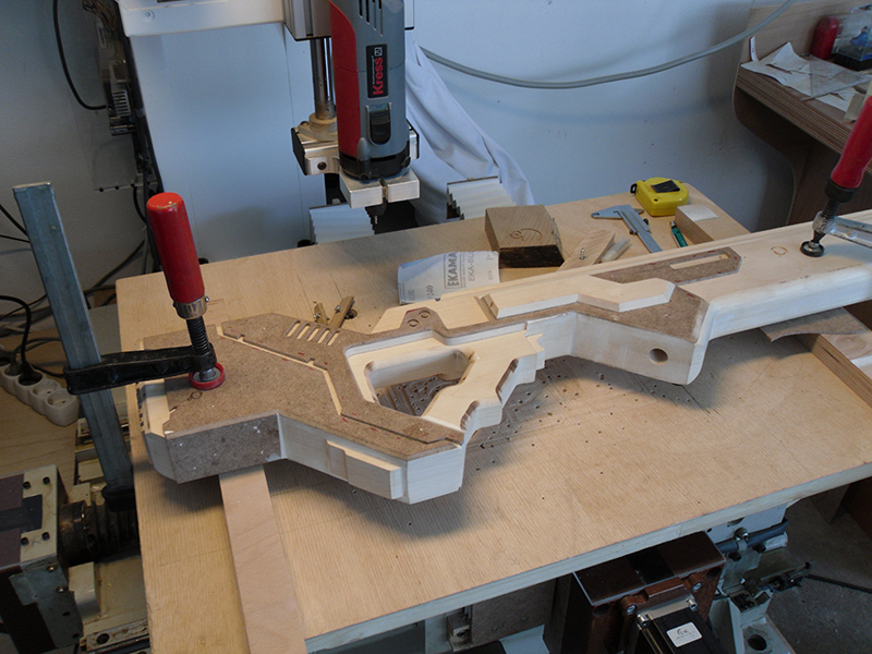

Thanks. The darker wood is 4mm MDF.

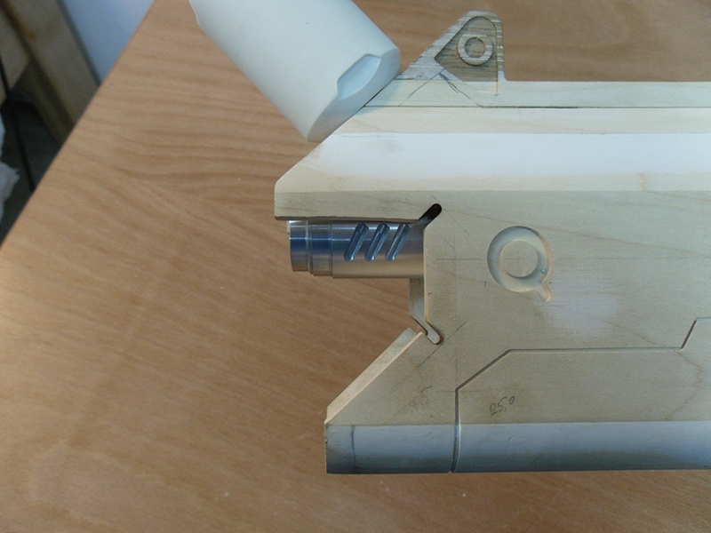

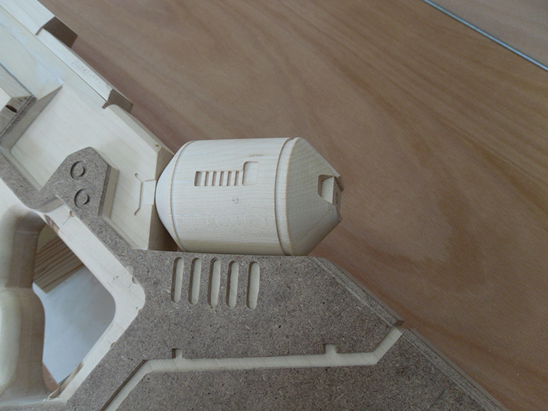

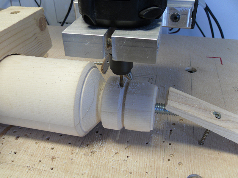

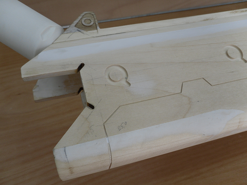

I made the two top canisters and cut the details into all three canisters. The two big ones have threaded rods and screw into nuts in the gun, because I want them to be separable after the gun is finished. I also engraved the panel line on the foregrip, which may have been premature if I'll be spraying the gun with spray filler.

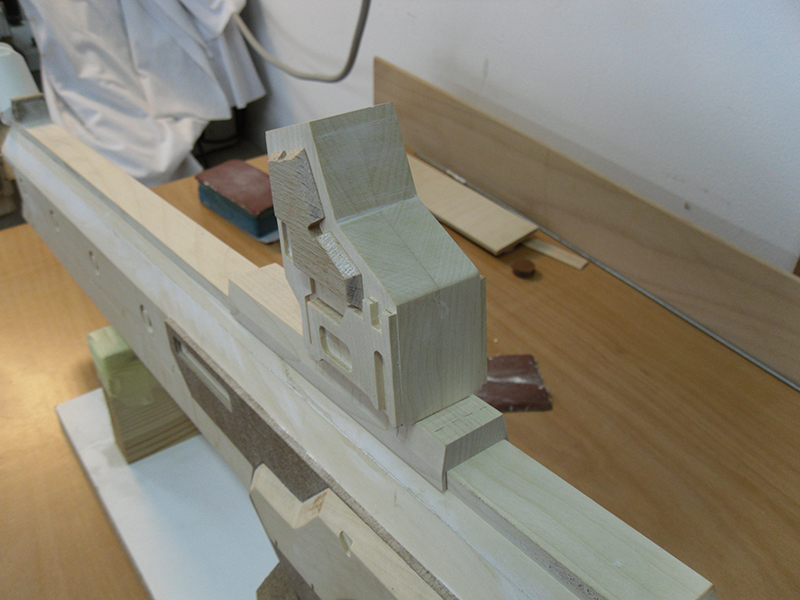

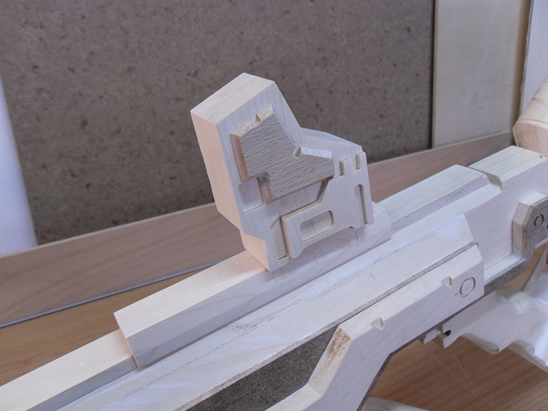

And I started on the optical targeting system thingy.

This project was (kind of) started and propagated by new machines I added to the workshop. A year ago I got a lathe and I looked back on the project ideas I thought too complex before, and this assault rifle was one of them because of all the cylindrical parts. Soon after I started building it I put it on the back burner because of school. I was drawn back to it 'cause I finished my CNC router and had a simple way of doing all of the little details (and some of the details on the mdf parts al a bit wonky because I was doing them a year ago mostly by hand).

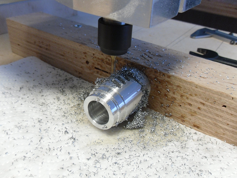

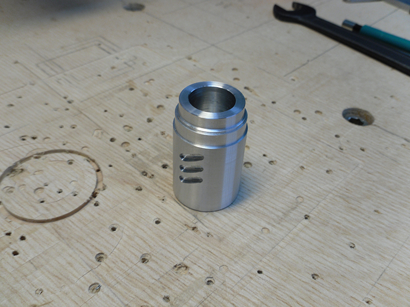

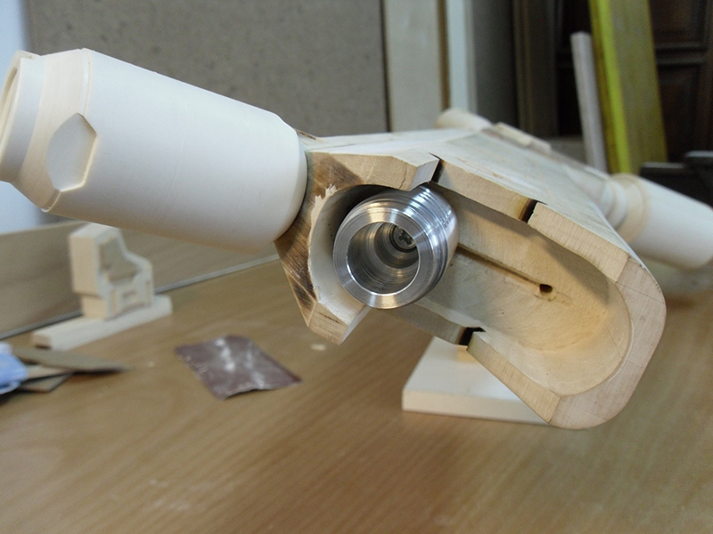

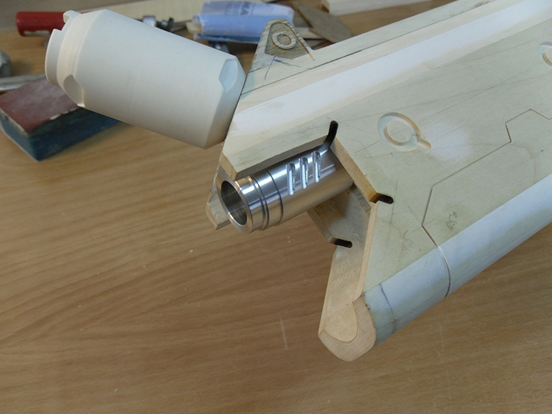

I didn't put a lot of hours into the build this weekend, because I didn't have much time. I made some progress on the targeting device and I made the barrel for the front. I used aluminum for the barrel, cause I didn't have any plastic of the right diameter.
