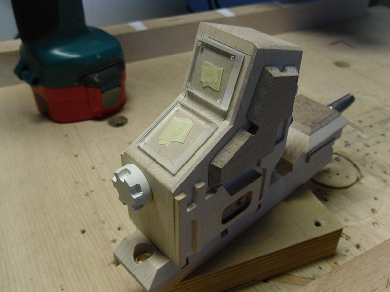

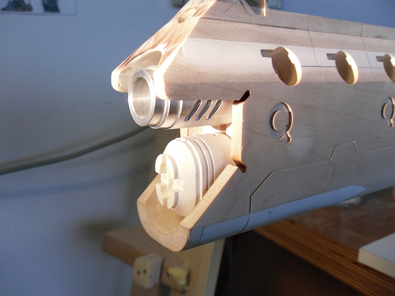

I made the piece that goes under the barrel. That was quite tricky and it took me the better part of the day. I even ground myself a custom cutter for the grooves on the side.
And I made the knob and the two acrylic pieces for the targeting device. The acrylic parts will be painted black on the back to look like displays. Not sure if that's what they really are, cause they're just painted as the rest of the targeting device on the Weta replica, but you can see them glowing red in the movie. Anyway, it will look good, which is what's important.

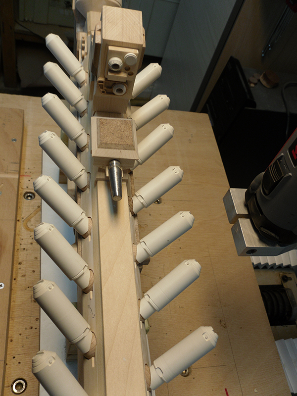

The last picture shows the detail on the front canisters, the recessed part is new. Initially I just planned to paint the shape on the canister, but it wouldn't look right. So I made another slightly smaller cylinder, cut it in half, made the two inserts out of that, cut holes into the canister and inserted the inserts. Took hours, but it improves the look of the gun considerably.

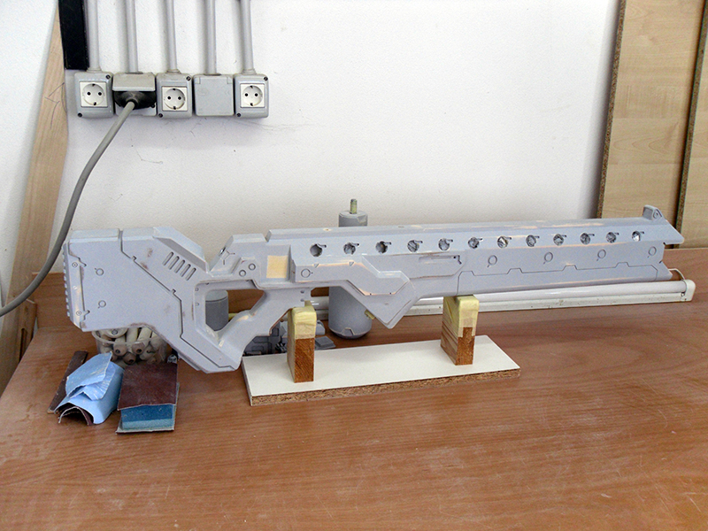

And this concludes the building part of the project. All that is left now is finishing and painting (and, to be honest, cutting some panel lines that I'm not sure I should do before or after filling and sanding).
