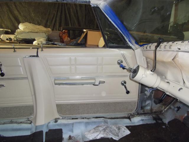

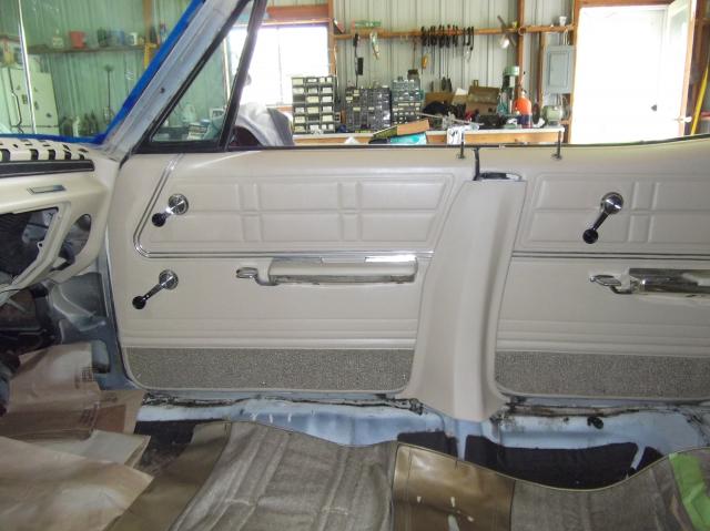

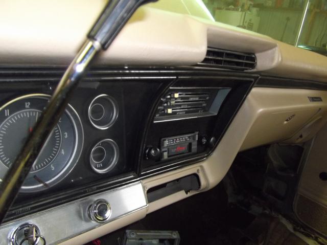

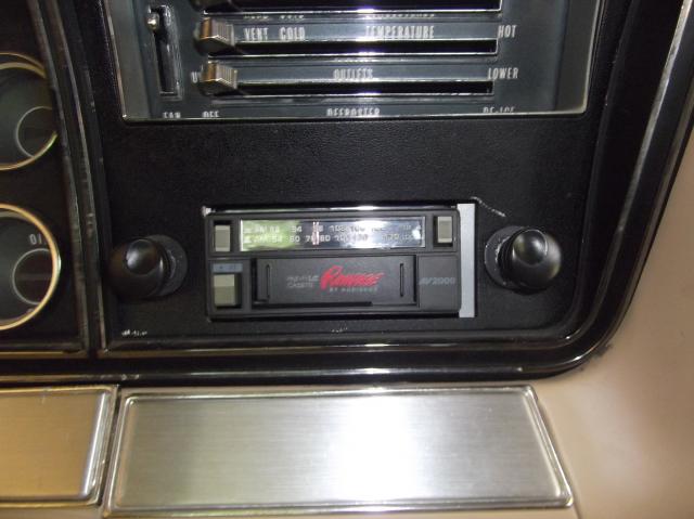

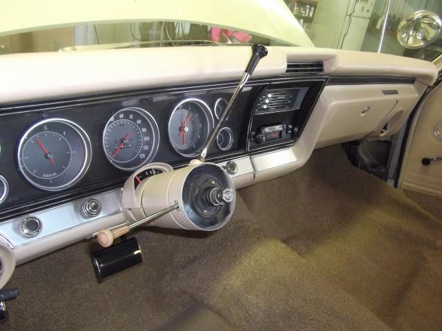

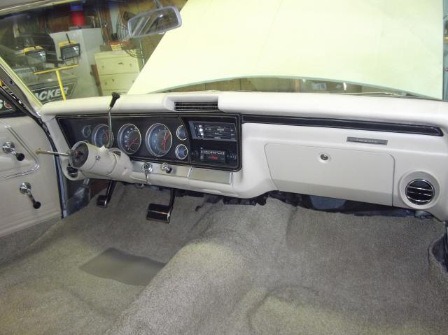

Door Panels Installed.jpgDoor Panels Installed 1.jpgDoor Panels Installed 2.jpgDoor Panels Installed 3.jpgDash Painted 2.jpgPainted Dash 1.jpg
Here's some photos of the car I am building for a customer. It's finally caoming together.........................:)
Gorgeous work as usual mate.
Do have another interior/paint related question for you. Did you use the SEM Aerosol cans? or did you buy it in tins and use your own gun/compressor? and approximately how much did you use for the entire interior?
SEM isn't readily available down here so I have to special order it. Want to make sure I get enough.

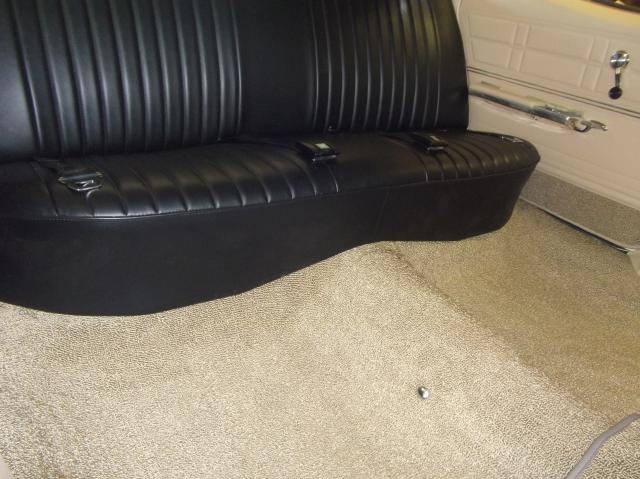

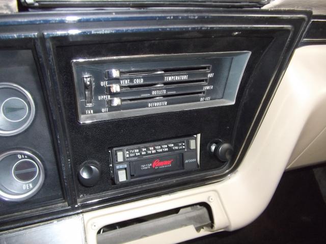

Dash 1.jpgDash 2.jpgDash 3.jpgDean's Radio (5-19-13).jpgRear Deck Shelf 1.jpgRear Deck Shelf 2.jpgRear Deck Shelf 3.jpgRear Deck Shelf 4.jpg
No I did not use the SEM aerosol cans as I had the paint mixed at my auto paint shop. I had a gallon mixed and I used it all on the interior as I put on more than one coat with my paint gun.

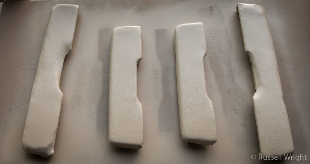

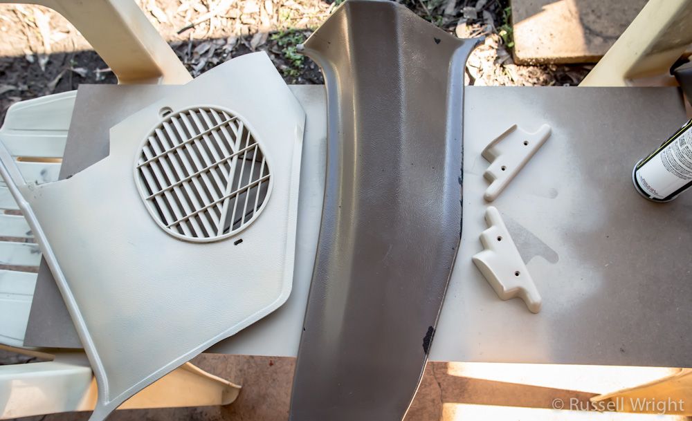

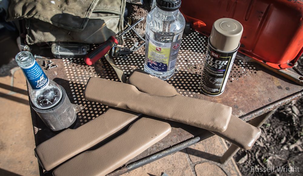

I found a place locally that sold it, but they only had 1 aerosol can in LT Buckskin, an no tins. I grabbed it to see how good it was and get started.
For anyone interested in doing their own, 1 aerosol can does approximately 4 arm-rests, 2 b-pillar caps and 2 kicks panels (though the kick panels will need another coat). I'd say I'll need at least 6 cans in total to do the roof lining, rear shelf, b-pillar covers, c-pillar covers, dash, steering wheel - I won't be doing the doors. They're black and I like the contrast.
(beer optional)
impala-interiorpaint1.jpg~original
impala-interiorpaint3.jpg~original
Here's a shot of the old & new difference. Covers it well enough.
impala-interiorpaint4.jpg~original

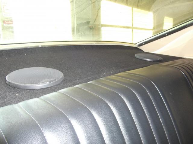

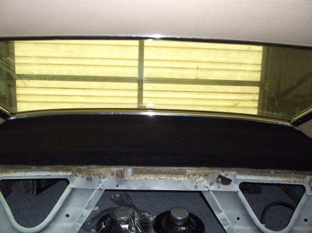

What are you using for the black rear parcel shelf? Are you spraying it black, or are you covering it with a carpet-like material? Looks like the latter in the pics I've seen, but I'm unsure.

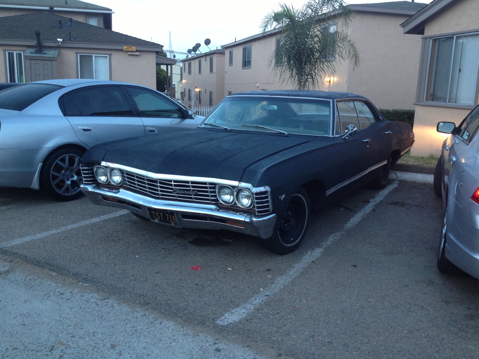

Hey everyone! Just giving an update on my progress...i found most of the trim for the car just missing one eyebrow trim and then its all coming off for the paint job! I got the Rims on order...here she is: Pala (Morning 4).jpeg
Good news. Fortunately the eyebrow trim is reproduced. Very easy to find.
Exactly I should have that in the next week or so. The door trim was the hardest to find for me.
Yeah they're a pain in the arse to find, and can get pricey when found. Problem is they're specific to the 4 door. Up until Supernatural, 4 doors weren't popular and were only used as parts cars for guys building fastback Impala's. Things they couldn't use on their fastbacks were simply discarded.
Bumper guards are equally as pricey, but fortunately they fit all 67 Impala's so they do turn up.

Hey Brother,
I did the same thing the show did on the rear deck shelf/package tray and that is I covered it in cheap black carpet. I bought my carpet at the auto parts store as I think it is the same stuff people use to cover there speaker boxes.
Hope this helps you out.................... :)
