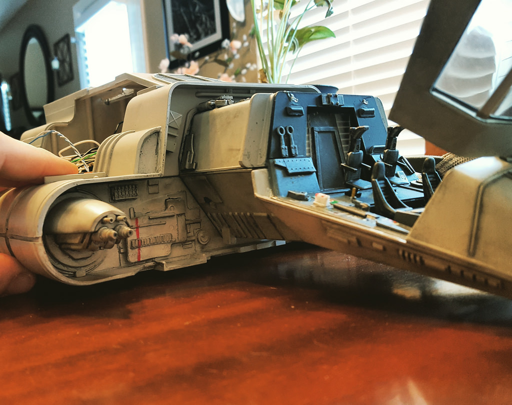

OK! Shuttle Tydirium! This one is getting the full workup, including Arduino-controlled nav lights, lots of cockpit work, and attachable landing gear doors so that I can put it in either mode when it's on display. I'm using the same kits (Flakverling & hanomag) as the original model used.
Let's start with the cockpit:
First step is to greeblie up the back of the cockpit:
Then, build an accurate set of wing guns:
Next it to cut out everything from the cockpit, so that i can get it back to proper scale:
Then, start building up the cockpit:
After that, start building up the jump seat risers, and wall for the recessed door and blue panel lights:
Alright! Time to start running fiber and lights!
Presto! The lights change color in different sequences. (CLICK FIRST & SECOND PIC TO GO TO A VIDEO)
20170621_191305 by Booyotch1, on Flickr
20170626_204837 by Booyotch1, on Flickr
Now let's add some teeny seats from Shapeways! I also lensed some larger gague fiber to make little spotlights for the inside. It's hard to capture, but you can see everything nicely through the cockpit glass.
After that, it was time to make the gears and gear bay doors. They will attach with magnets to the fuselage. Tried to get it close to screen accurate, but had a little fun with the extras. When painted up, hopefully the illusion will be that the bays will be open, and the attaching panel will be matte black to look like it goes into the ship.

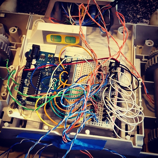

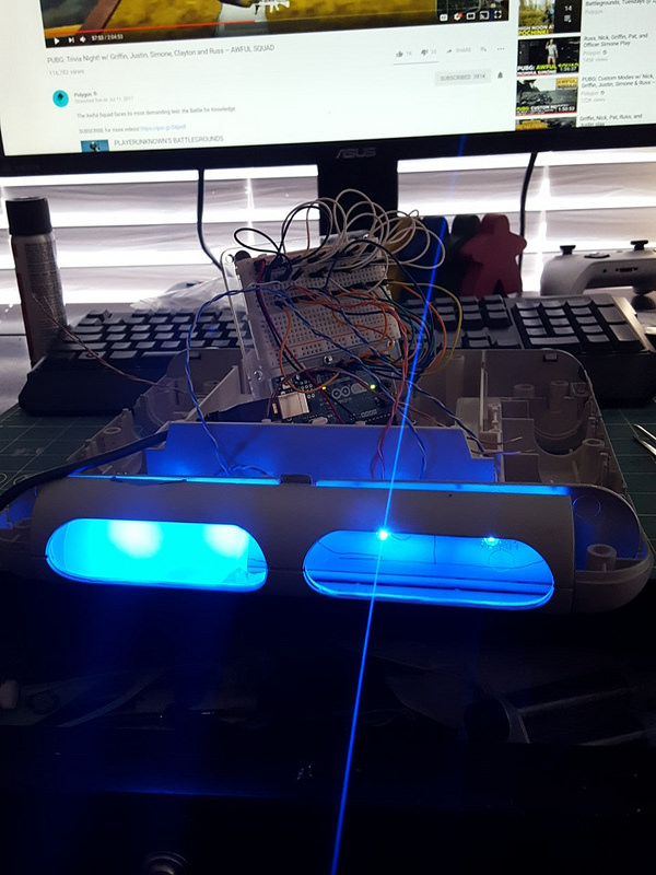

Ok, after that, I got to work on the Arduino controller for the rest of the lights (Everything except the cockpit).
Programming is hard! Still tinkering, but now it's controlling the 6 nav lights, 2 landing, and 4 engine lights. I went back and checked the movies, and got the timing and delay on the ligts exactly like they are in RotJ.
Lets see if the video link works:
(Something happened to the original, here's the full light test):

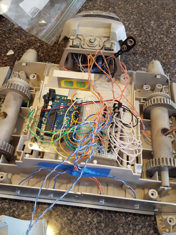

After that, it was making sure that the Arduino and all the wiring would actually fit.
So after that was done, it was time to do the final wiring and make sure once everything was buttoned up that it would work ok. It went fine, had to rewire a couple of things, and the wires to feed the wing lights are exposed in Landing Mode, but there's no safe way to route them otherwise...
