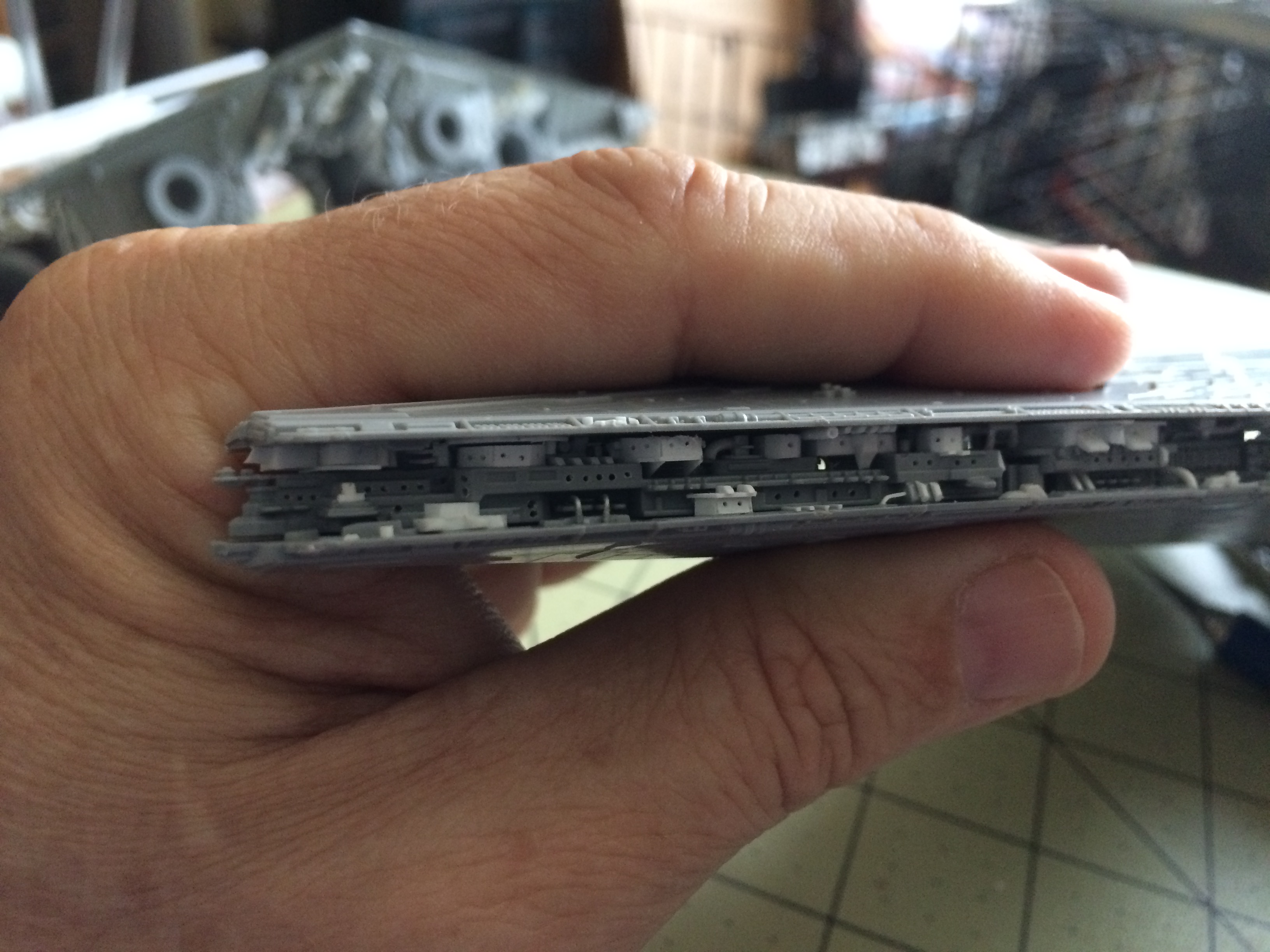

I started the greebie additions to the port-side trenches. I am raising up the trench height a fraction and in so doing, have space to add more detail to the trenches. I attempted to mimic the ILM 8- footer but that is going to be an impossibility to do at this scale. So, carving out new overhangs and recessed gun ports and piping to approximate the detail is the best I can do.

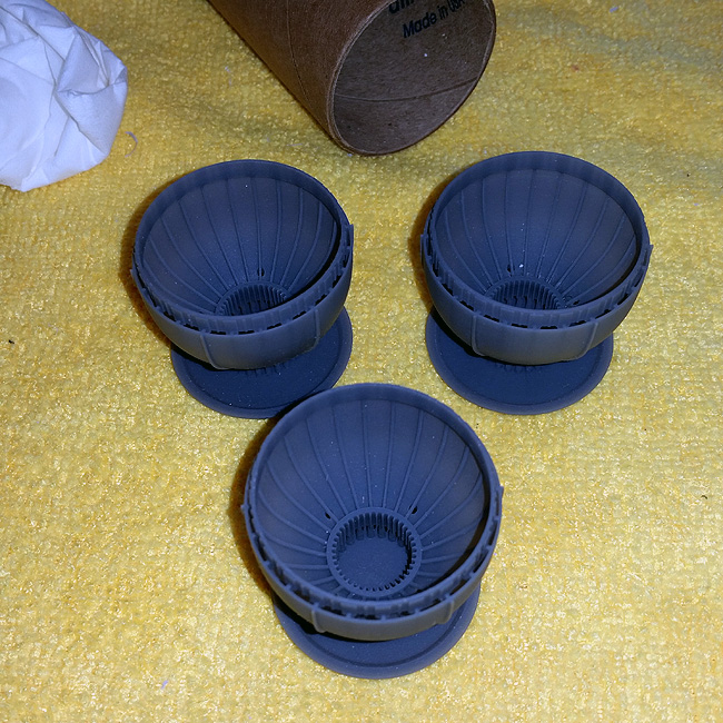

nice start, my ISD is still waiting its turn in the line-up. I have the falcon3d engine bells and they were well worth the money compared to the kit parts. subscribed
I was planning to get those for my build but it was mentioned on another forum that those particular engine bells are prone to warping unless stored carefully until they are painted. I think they look wonderful but that is some cause for concern for me. If they can warp just by being placed on a tavle, how long with they hold up mounted sideways with only primer and paint to stabilize them?

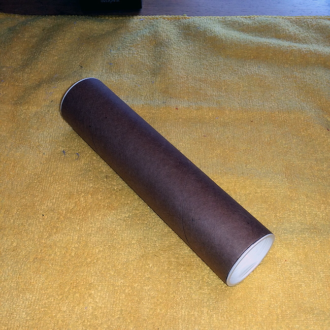

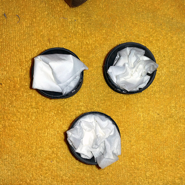

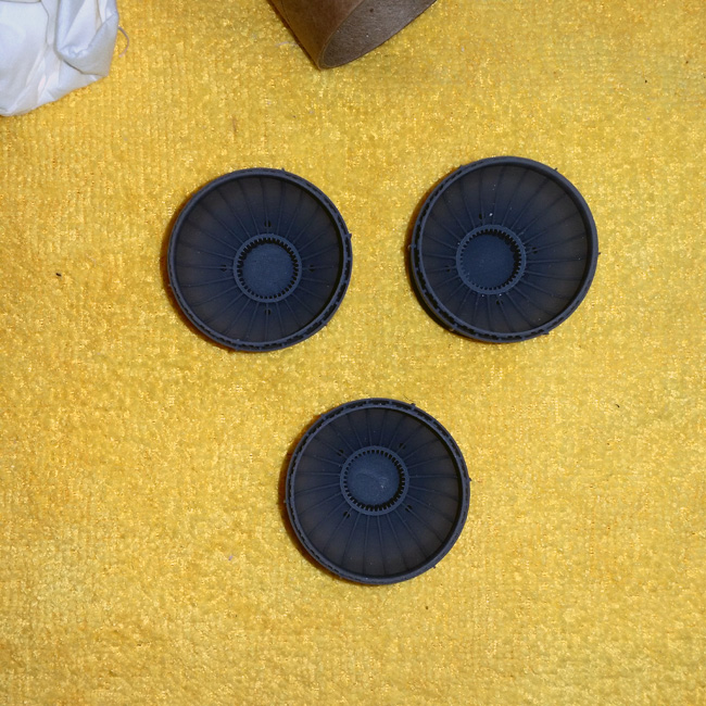

That's a first for me, what forum was this from? Mine were shipped to me in a small poster tube (really small of course!) and cushioned with small wads of tissue paper. I really can't see them warping either in there, or even on a model, unless they deliberately exposed to heat and/or UV light. But then that caution applies in part to polystyrene plastic anyway...you wouldn't display it in a window that receives constant sunlight, or anywhere near a heater. If PLA is indeed susceptible to such warping I guess I'll discover that soon enough. :p
Interesting. Well, these are mine, got them at least two months ago and have been stored in that tube in my spares box. They're still round.

Hi gents that was me over on Britmodeller with the distorted 3D engines - they kept changing shape as our UK weather changed seasons. Once I got them through a good clean with some SHL and instantly primed 3 times, they held their shape.
