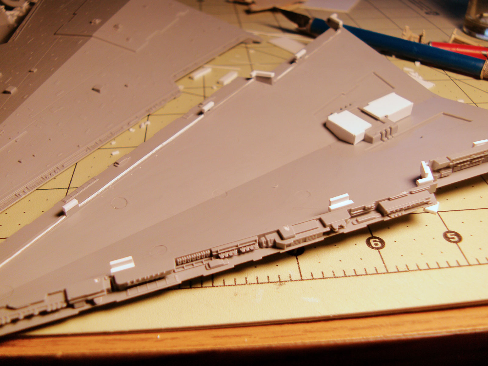

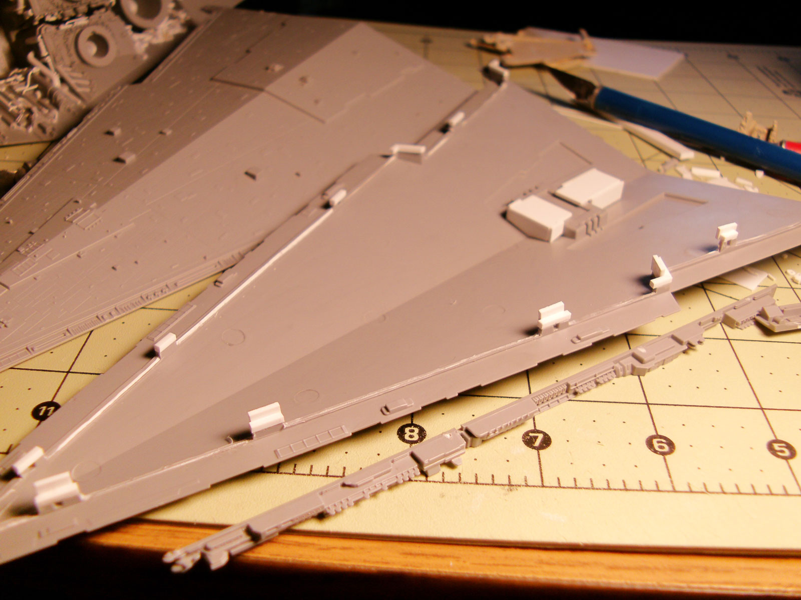

More alterations...removed the greater part of the internal dividers behind the trench pieces (bring down structure appeared) with the goal that fiber optics won't get guillotined lol. I cleared out the regions where the parts enter into the dividers with finding pegs; there is a lot of sticking surface over the trench parts for the upper structure.
