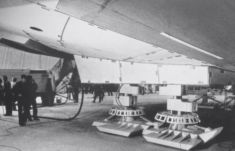

Hey, don't forget the 5'falcon was retrofitted with landing gear for Empire Strikes Back for the Bespin landing scene.
The references that you are using for your legs are very much the same as what was seen on the model.
The gear doors are still in place covering the wells but unsure if the legs are inside, in the archive, a private collection or lost to time.
There was a Propstore auction many years ago for a leg or casting of the leg that was apparently from the production.
Not sure about the ramp though...

OK Looking further into the ESB Landing gear - of which there is not a lot of reference around. I have found what I think is my major problem.
I am trying to make the landing feet and rings fit into the landing well/cavity - it looks like there may have been a lot of poetic/spatial licence in the design here with the feet a lot wider than the actual docking well.
I also noticed in the actual bespin landing, that there was quite a difference between the hydraulic extension of the gear in flight, vs landed with the weight on - extending by the suspension range shown above within the 2 horizontal lines. - I might consider implementing some extension in this range as well, just for fun.
It also looks like the original ESB landing had the landing gear doors angled and hinged similar to the Bandai Model - but very hard to tell from these shots
Any further info or shots anyone has of the ESB landing gear I would be extremely grateful

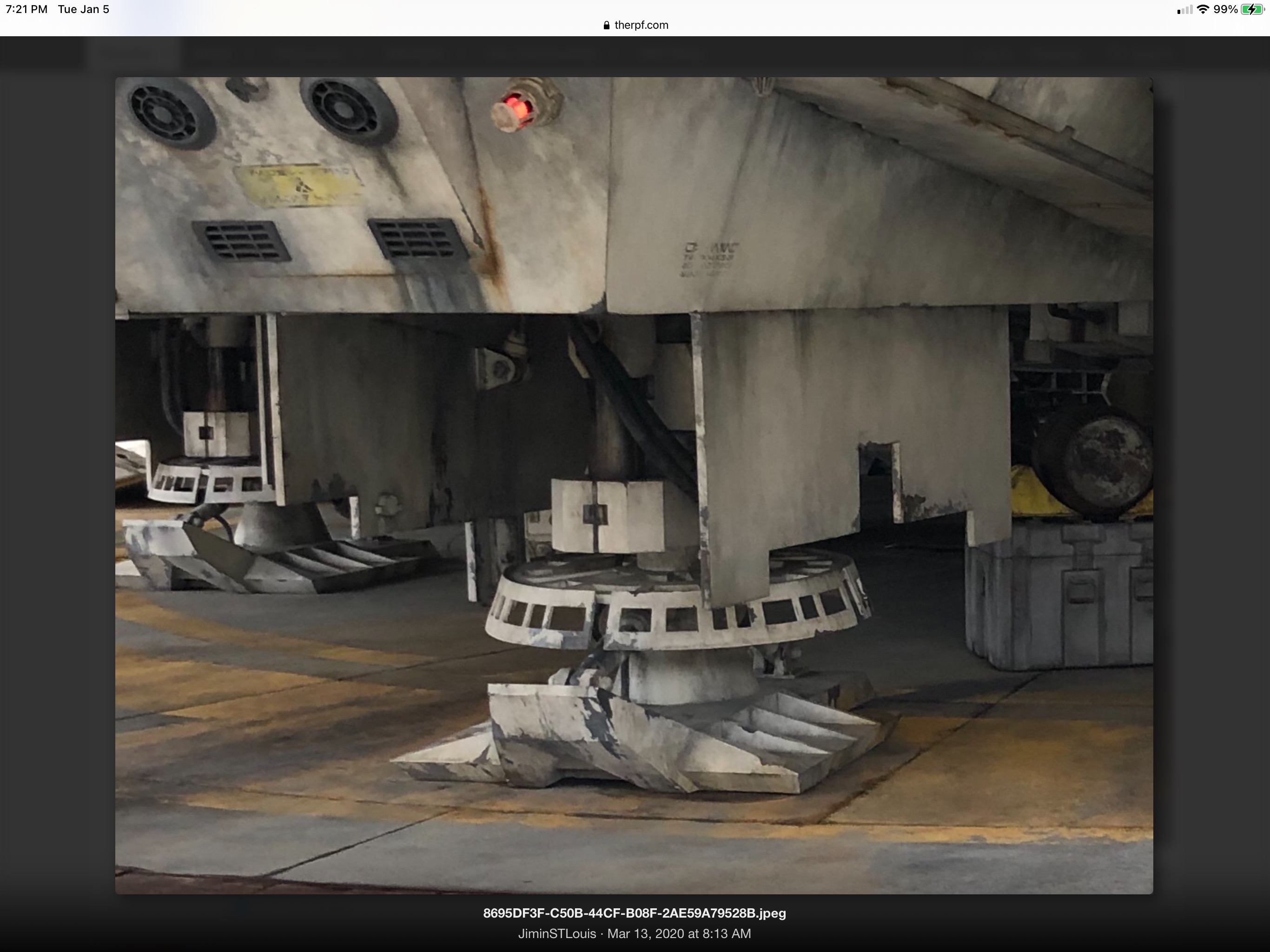

Dazza007,
As an X-aircraft mechanic, I had to stray from true Studio Scale and have landing gear on my Falcon. Interesting you also noticed big feet vs. wheel well door size. Mine are retractable so size matters in stead of the plug in versions. My gear design is per drawings. There seems to be many different types of feet designs, hydraulics, L/G door styles etc. among models and pictures. Bottom view’s of the door openings still confuse me, so no decision made there yet. The ”hinged / angled doors” are neat, however they are complex.
Attached are some web site grabs I found to be interesting regarding door design. No doubt you have likely seen these, but the show the variety

Dazza007,
Thanks Searun,
My current design is like yours, based on the blueprints with largish flat doors similar to the Disney one , I am possibly overthinking things, will more than likely just stick with what I have, but would be nice to add the spring hydraulic landing system to that. (I have so much more that needs to be done anyway.

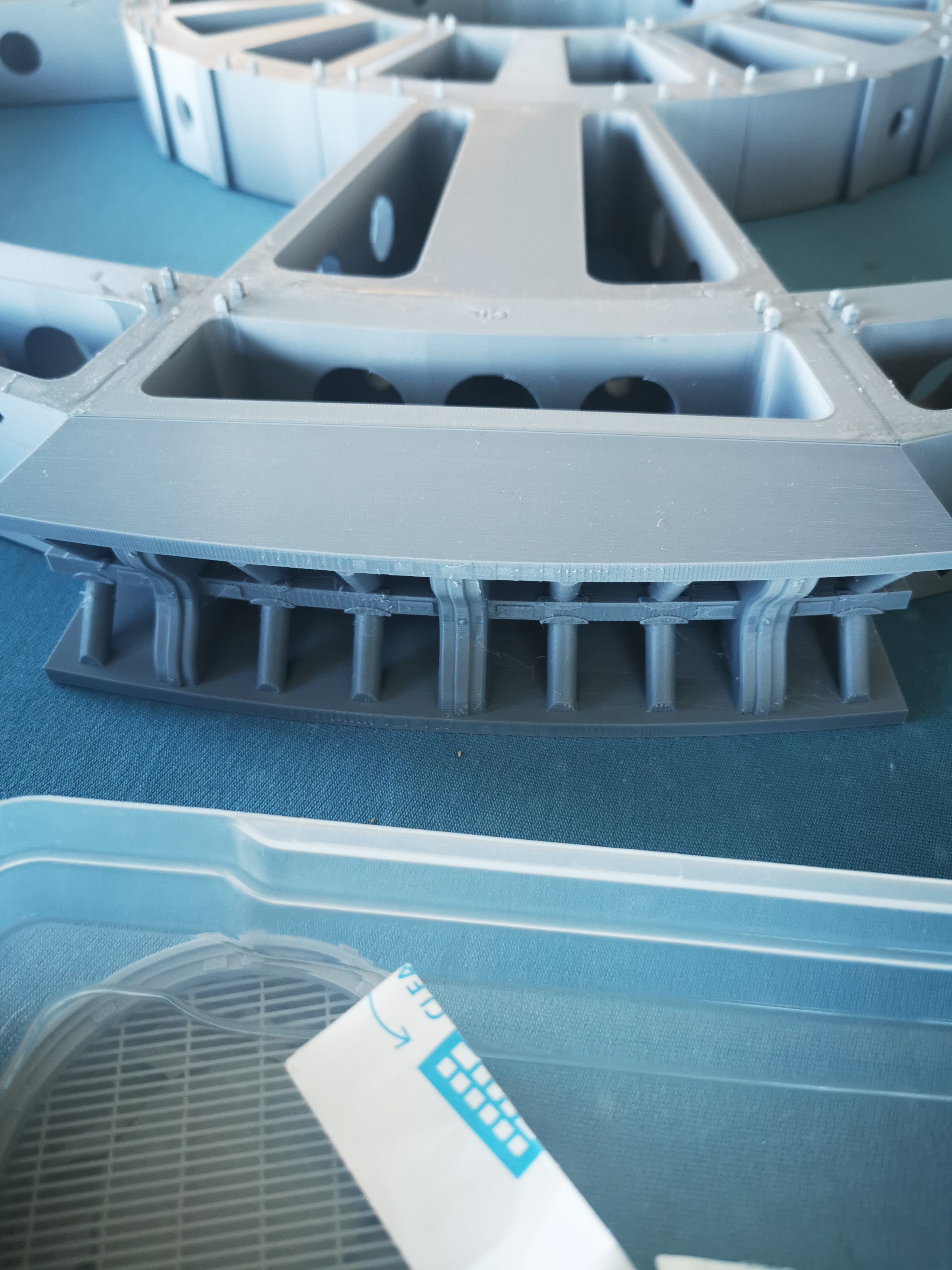

Well coming up to the 3 month mark and have just finished printing the upper half of the hull frame, just printing the cavity inserts for the Radar Dish and inspection panels areas. (That'll be the next photo) - Excuse the mess...
Its only half glued, this is mostly just a dry fit
