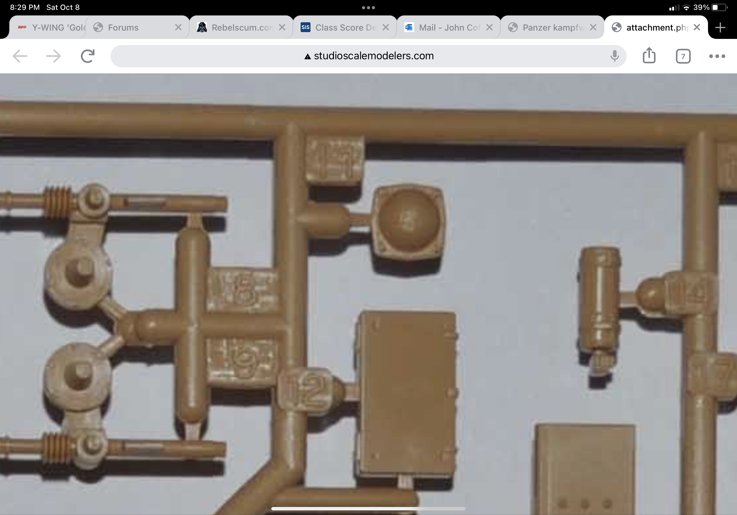

Y-WING 'Gold Leader' Studio Scale Build by dtssyst
I ask if any or everyone to please help ID the parts needed.
All I can give is a huge thank you.
#14 Panzer kampfwagen III Ausf.N Tamiya 1/35?
#4 is AMT 1/25 Peterbuilt wrecker.
#12 is Williams Brothers 1918 LeRhone radial engine.
#7 Is Peerless Max 155mm M1-A2

DTSSYST,
I have a bag of everything you need except #10 and #17 headed your way by Thursday. If anyone can get me those ID's we can make this Gold Leader complete. I know I have #17 in my possession somewhere, but can't recall what it's from. 10 is simply drawing a blank, and I can't tell if it's part of a landing gear strut, part of a bigger piece that's been cut off, or a small F1 engine part.

Does someone want to send me a picture of 7 on the sprue of the Peerless Max? I have the kit, but can't seem to find that part, and so would like to pull this piece before sending to dtssyst. I also have the Testors and/or Italeri version, so if it's on that one too it'll also work.
Also, just to be clear, the original kit was Max, then Peerless/Max took it over, and the 1975 version that ILM would have used would have been the AIRFIX 155mm Howitzer boxing, for all you purists out there. I don't currently have an Airfix boxing, but do (now) wonder if that kit would reveal even a further difference in part numbers?
The Testors version came out in 1982 and the latest/most recent version of this kit is the Italeri version from 2020.
