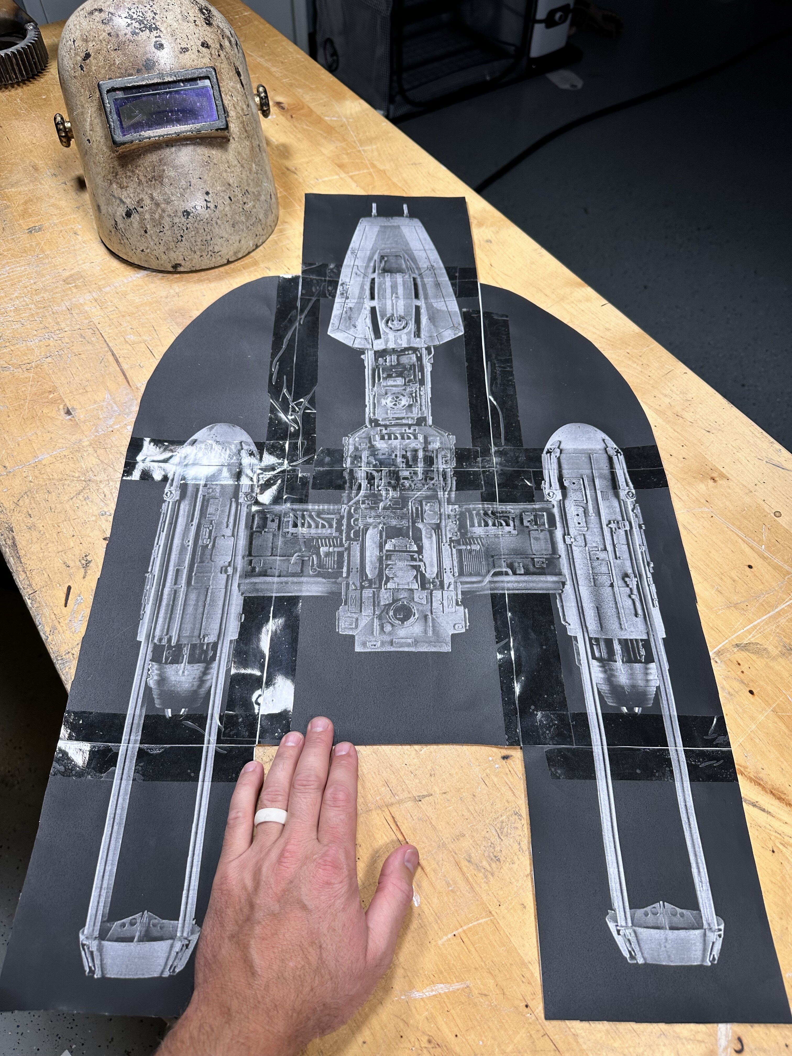

I started a week ago with planning and basic shapes. I sourced materials yesterday.
The processed involved will be paper templates then stepping up to cardboard and finally steel. Then mig welding, tig welding, possibly some soldering and brazing of small details. Polishing with scotchbright wheel and finally paint, patina and weathering.
I have started with the main fuselage and cockpit at the moment
This is just a rough start and I am refining shapes. More to come.
Thanks for watching and any help/ feedback is appreciated
