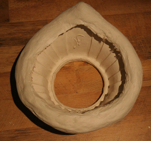

Well the neckring mold went real good, ( i was concerned as i had to turn it as the plaster was drying to get to the underside. )
only one tiny little bubble which ive filled.
heres a quick pic if anyone interested.

looks good mate, though I'm not sure why you've made the mold open at both ends as it'll make slush casting a pain in the bum. Still looks a corker...I still panic why I cast in stone as you never know what air pockets you'll find...I tend to press all over the inside to see if there are any errant pockets under the initial beauty coat. Learnt that the hard way with the old bat cowls I made as the mold initially looked cracking until I sanded the interior to remove any uneveness on the surface and put my thumb through a BIG pocket...Still looks good.
Well never done a neckring mold before so i didnt know, i just figured id make a lip/groove and just roll the mold .
i can easily block off the small end if needed
Well it's probably just me being bone idle as when I used to do a lot of latex stuff, I used to dwell the molds rather than slush as I usually had 4 or fuve of the same mold on the go, just poured the latex in each and left and then poured out and then poured again to build the thickness desired...You do tend to get increased shrinkage that way but for fast production stuff it's a real time saver especially if you put the molds in a box containing rock salt, as this draws the moisture even quicker but does mean the stone can break down quicker than normal. I also soak the molds prior to pouring too as this seems to prevent a lot of air bubble forming too.
Ill just do what i do with masks , 1 brush beauty coat then slushing around
fingers crossed it works as well for ring as masks. :p

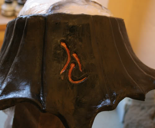

1st ring came out of the mold this morning ( i took it out too early and ripped it in a few places ggrr, teach me to be patient )
Ive repaired it and then painted, heres 2 pics ( excuse top pic, i took the photo as the permawet was still drying ), the 2nd one showing how it sits on the upper body, it fits great apart from around the P1 neck which is smaller than my wolf anyway,
it also fits me great and im 6ft2 with a 44 inch chest.
Still undecided if i should sand the flat bits or leave them alittle uneven, uneven may make it look more eerrr natural ?

Da-yum! Thats looks awesome Lee! I love how the neck ring looks on the P1...too cool!
Now get to it and mold that Wolf! CHOP CHOP!!! hehe, j/k!
hell yes!!! neck ring is great lee, and like jason has stated...man it looks good on the P1.
I would leave it on there...just to switch it up a bit. may i ask what the symbol stands for?
AM
Symbol is meant to look like Pred symbols, but has a double meaning.
H L Hunters Lair
but thats alos my initials Backwards :)
That looks real sharp there Lee! :) Don't fret about ripping it in a few places, it'll just add to the look!
Its all fixed now anyway hehe, im sure ill find a home for it.
