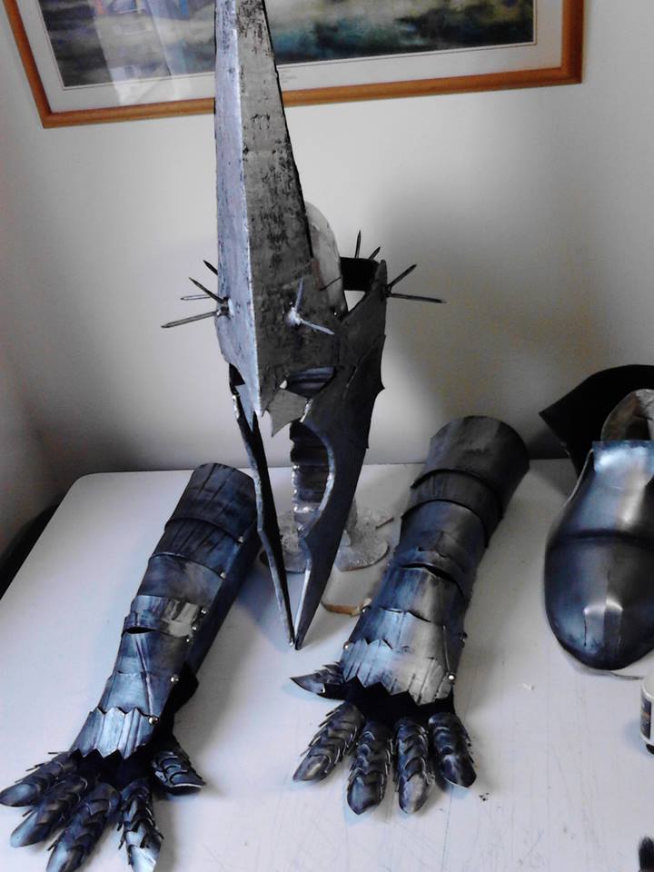

Hi guys this is a little update of my witchking of agnmar costume, here is the crown and the gauntlets, thanks to hamsterstyle for the template of the crown, very helpful
Holy Smokes Batman!!! that is really soooo cool Novashadow! Have you been using Stryene like Hamsterstyle? Your coloring is dead on. Do you have any other pics of your process? Would love to ask a few questions if you wouldn't mind?
Thanks man, actually the material i use is eva (or foamy in my country) for the gauntlets and for the crown i use the template that hamsterstyle put in this post, then i cut carboard using the template (the cardboard that i use is one from a television box, its very hard and useful) then i used bondo for the finishing touches, the paint job was done making first a coat of black and then i used a coat of metallic acrylic paint with strokes trying to do the appareance of old metal, if you like the whole process im waiting to an event so i have photos of the finished product and then i will put then in here.
