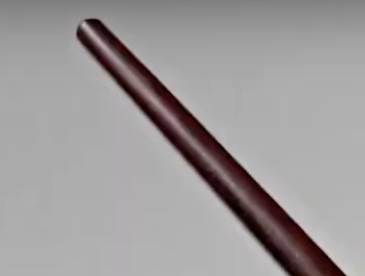

Looking at the shaft of the wand, it's a sort of purplish red, and becomes darker down the shaft— perhaps charred? I love the look, and the first thing that comes to mind is that it's purpleheart wood— and looking up some other images of wands/pens made online from purple heart strengthens my suspicions.
Also, now that we have these HD photos, I noticed something that I missed the first time around:
That looks like a METAL end cap! At least those two gold specs make it seem so. It's definitely a different material from the zebra wood, but it transitions from the material seamlessly to the point where, looking at screenshots as well as crew gifts distributed by warner brothers (which would have been made cheeper), I thought it was just another charred bit of wood! I'm thinking it might be brass, maybe bronze? Just by those two little gold dots.

I think, to colour match the wood, you should go with the first picture where the wand is more at an angle then the second picture. It looks like there was a lot of light in the second picture. And I have not yet found an image in the movies where you can see the tip of the wand being lighter in colour to the rest of the shaft.
I am not quite sure that I see a metal end cap. I would say more of the same wood from the shaft. Those little spots could be either little dents in the wood where the light reflects differently or if the wand was not made from wood, then maybe just chipped paint. Does anybody know if the wands in the first two movies where made from wood?
I agree that the second image seems to have more light, but having more light is a good thing— it highlights things that you might not have seen in the dark. I'd also argue that the first picture definitely shows a change in color along the shaft as well, the base of the shaft is darker than the tip, but that might be the highly playing tricks on me! I'll look further into it. :)
Yeah, it's kind of up in the air for me with the metal until I can get more info (I'm going to try and contact Bohanna today to get some more info), but at the very least I believe it is a different material (or painted a different way) with how different it looks from the other two materials. I originally thought it was also the same material as the shaft until I saw these HD photos of the prop, notice that the reflections on the shaft of the wood (tip and base) vs the end cap:

It reminds me a lot of this old brass chair leg that hand a similar finish, but that was just gut instinct after I saw those two golden dots— but you are entirely correct that those dots could very well be chipped paint or a highlight!
