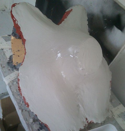

#ahsokatano #ahsokalives mold back. Fresh ultracal is the best! So much faster to work with. by pinkdiamond, on Flickr
Not of much interest to those of us already familiar with ultrcal, but this is why it's amazing- aside from durability that is ;)
Yes, you can make dimetional molds just with the product. I do not use bandages as I live in a very humid climate and they just rot. So instead I mix about 2C of water with product, brush that over, then as that is starting to set up I mix about 1C water batches so as to have a mold about 1" thick (a bit overkill, but I have mentioned humid climate which makes thin molds really prone to breaking when demolding, unless I am supr patient and wait a week, ahahahahahha!!!!)
So I like to use a chipping brush but had to use a goats hair brush for the back and my hands. My hands are lovely and pruny and in much need of proper moisturiser.

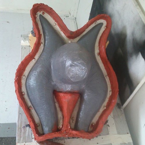

Back to progress:

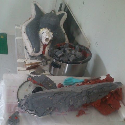

#ahsokalives clay walls in the crockpot and on the desk.[/url] by pinkdiamond, on Flickr
Forgot to share this one, I used my crockpot to heat the clay, sometimes to melting point, sometimes just to warm and soften. I usually melted though ;) It's easy to use a paint scraper to lift some out and work it on the desk until it cools, and then by hand.
Shared now because I am remelting all the clay to clean it. I usually use a pot on the stove but it's nice outside so my workroom is a nice option :) And it definitely works.
In case the terminology isn't familiar slower cooker= crockpot. Because the pot part is.. crockery or pottery. It's how they can slow cook. Physics!
And as I used red/orange/brown to build the new walls I'll wind up with a muddy grey clay ;)
#ahsokalives mess left over from molding the back. A lot tidier than I was for the front! Tidy area is vital so you don't trip or ruin furniture. Note all the sheeting- I reuse where possible.[/url] by pinkdiamond, on Flickr
I only had to throw away the one that was heavily taped.
#ahsokalives mold being transfered, note the towel. Also used to move the full mold to the floor.[/url] by pinkdiamond, on Flickr
This towel has been great! It's been able to mop up water and also acts as a cushion. I was able to hold the mold and move the towel then start building the clay and insulation foam on the under side.

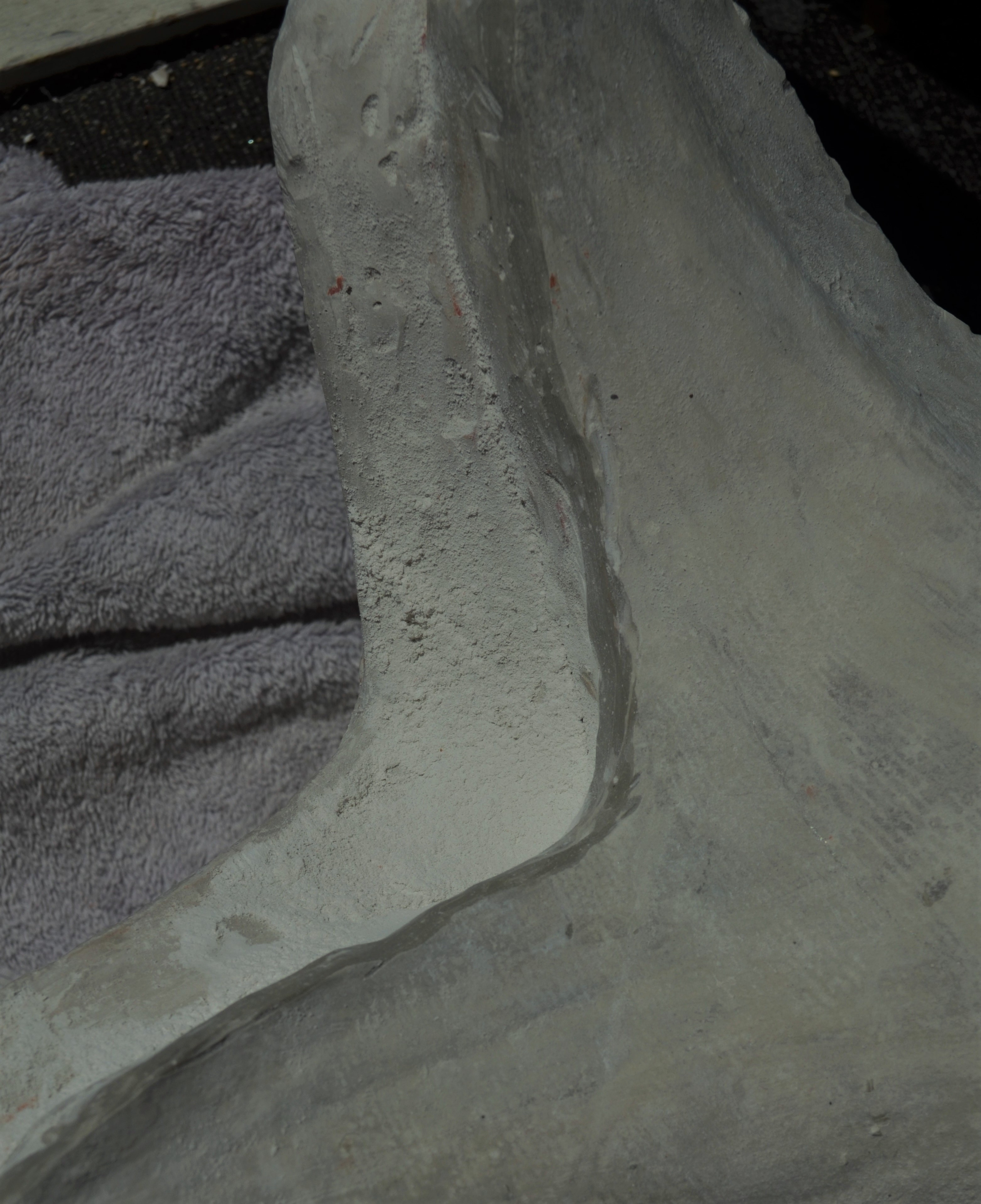

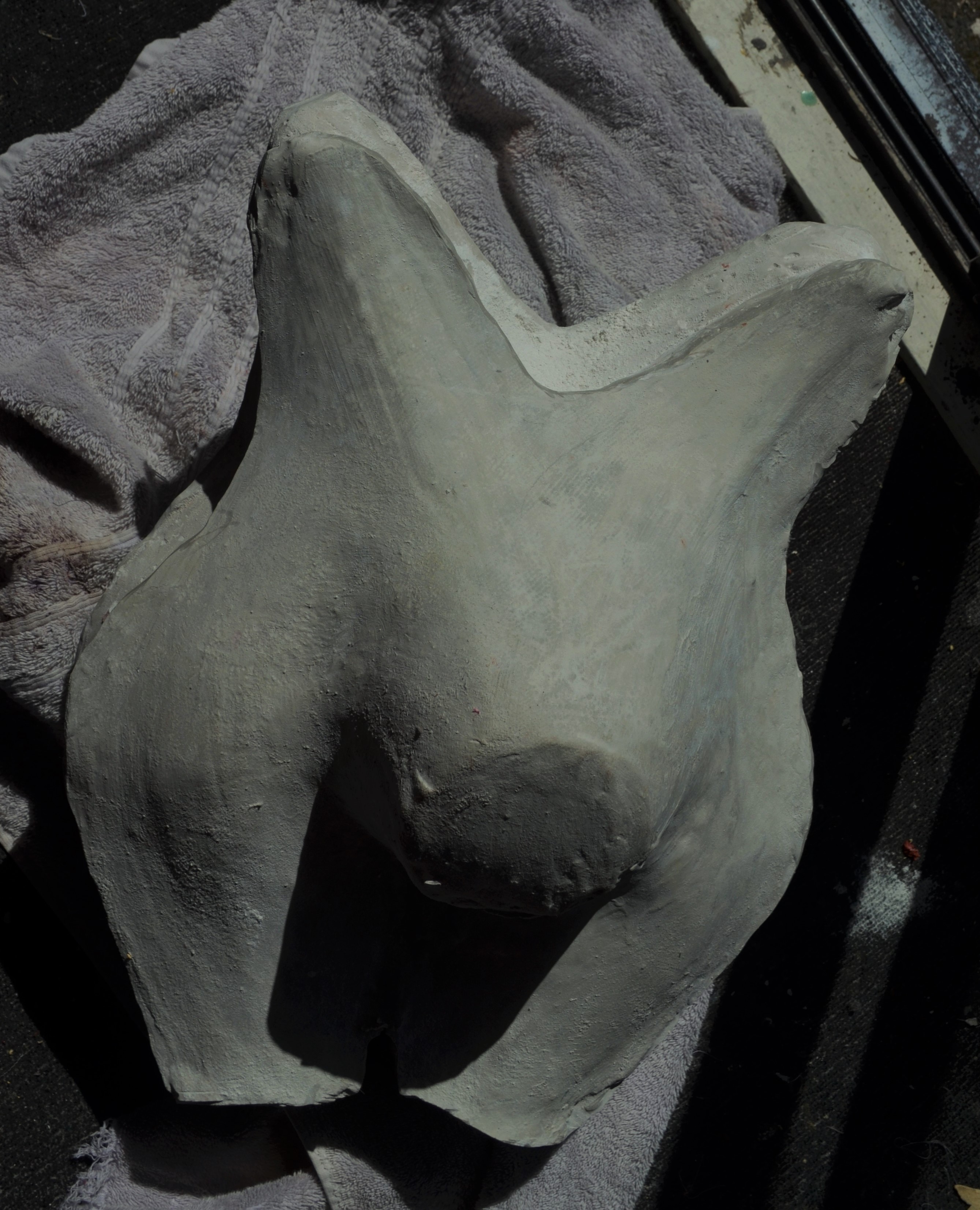

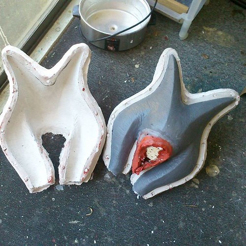

#ahsokalives ? #ahsokaisfree !!! That was insanely easy to demold, seriously so happy as I can now move the molds more easily and to follow the sun! by pinkdiamond, on Flickr
Nearly perfect! I was right that my keys were off just enough to break in many cases but there are enough and enough stumps to still help it lock into place :)
#ahsokatano is free!!!!!!! The heat from the sun softened the clay and the fibreglass so that I could break it apart. I really can't touch the clay that's left until it is cool enough to peel out. But woot![/url] by pinkdiamond, on Flickr
And now the sculpt is destroyed. The base of the back lekku curves downward thus locking the sculpt in place. When I cast this won't be an issue as latex is flexible enough to peel out of most molds, so long as it isn't too bulbous. I really need to get a page up on this. I don't think I would have had much benefit from making the back in two parts, but it is an easy spot to put a seam and to disguise it.
I think my front mold is slightly asymmetric as it tends to lean to one side while the back mold is staying nicely on the three points of the lekku bases.
I think though the day in the sun has helped the cure, it certainly feels much drier and looks like it is curing well :) So next step is to see how much latex I have for some test pulls. It takes about 3L of the stuff for my Shaak Ti molds and this is a very similar size. Might be time to get those mold out of storage too :)

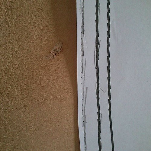

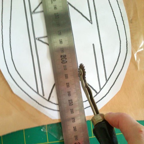

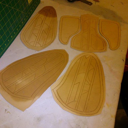

#ahsokalives transfering line art to leather. I did wet this section and then realised I didn't need to :)[/url] by pinkdiamond, on Flickr
#ahsokalives close view of the hide. There will always be imperfections so try to avoid them. I managed to miss this but have a couple of tiny holes in the greaves.[/url] by pinkdiamond, on Flickr
#ahsokalives not sure if it is obvious but I altered the design. I was using the concept art which has a few bumps that get exaggerated with scale! My error so I will tidy the graphic file once I know that this works.[/url] by pinkdiamond, on Flickr
#ahsokalives the transfer is a series of dots that will be merged once I do the tooling proper. I do love this work, but it is delicate as the surfice will take an impression of nearly anything that touches it![/url] by pinkdiamond, on Flickr

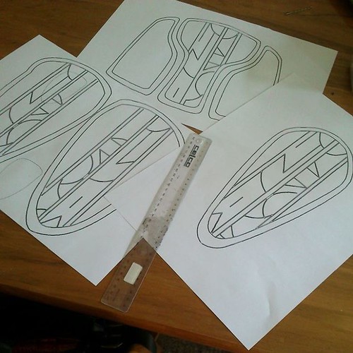

Yesterday I mixed and cast latex for my Montral. I need to gather a few more supplies, for supporting and maintaining the shapes nce out of the molds. i also cleaned some leather to back the armour pieces. I also made some card templates of the pieces that were curved too much to match in the chrome tanned leather.
Today I got some of the chrome tanned leather cut to match those templates and also took a pattern of my greaves.
sm_DSC_2548
sm_DSC_2550

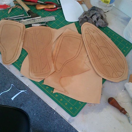

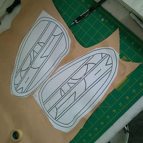

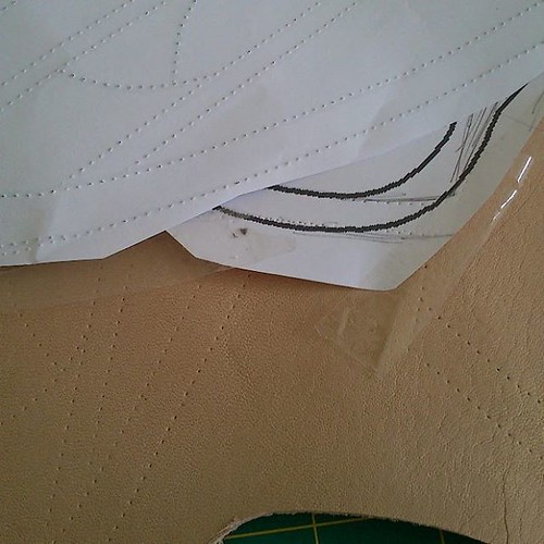

I transferred the card template to the leather using tailors chalk. I extended the lines as a guide for findint eh perfect point. I leave a seam allowance on all edges so I can decide which is the better option once set up for curing.
sm_DSC_2547 pinkdiamond
I folded the leather so I could get perfectly matching left and right sides, and it ensured I got a left and right copy for each side!
I used the flattest piece for the only really flat piece in the armour. It is currently weighted to remain as flat as possible.
sm_DSC_2553

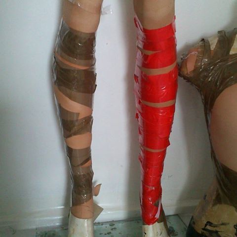

The greaves were the most complex to transfer, so I have taken a pattern from the pieces. I first cut along the known joins, then folded the widest pieces in half to fine room for an additional curve to be cut.
sm_DSC_2554 by pinkdiamond, on Flickr
I had to label each panel as the pieces are not symmetric, reflecting the curves of a human leg. These line drawings will be scanned and tidied with paths in photoshop tomorrow. Right now thee lines are overly accurate.
sm_DSC_2557
Even the knee cap is curved.
sm_DSC_2558 by pinkdiamond, on Flickr
The cap and upper decoration are also asymmetric so have to be labeled in a way to remember which side is which.
sm_DSC_2559
All these paneled pieces are for the linings, there will be contact adhesive between the outer and inner layers as well as a very open gauze for stability against stretching.

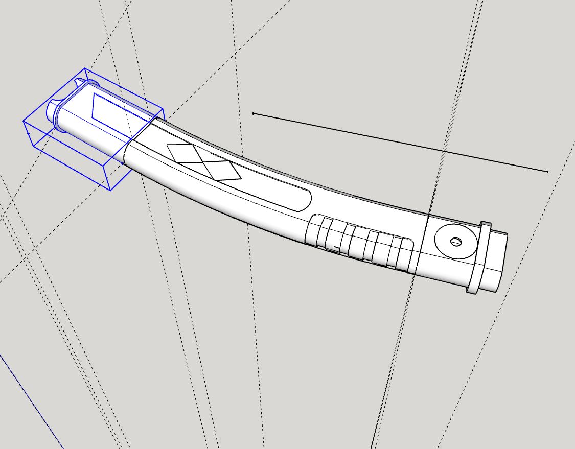

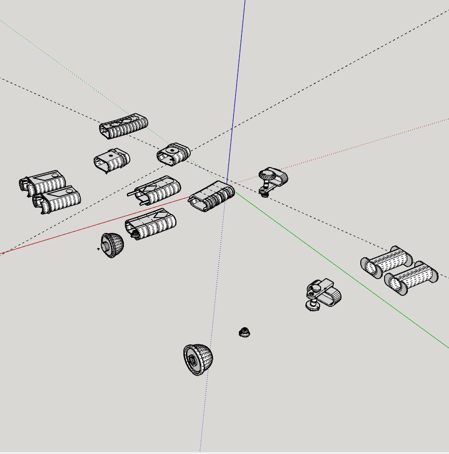

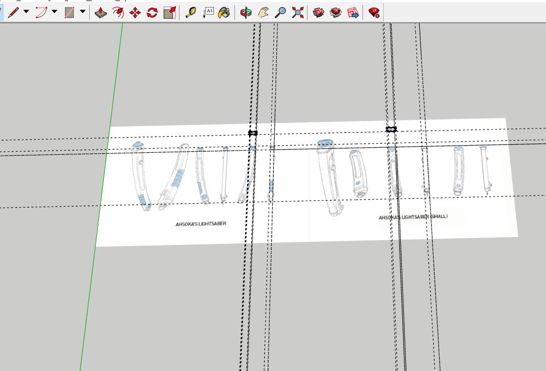

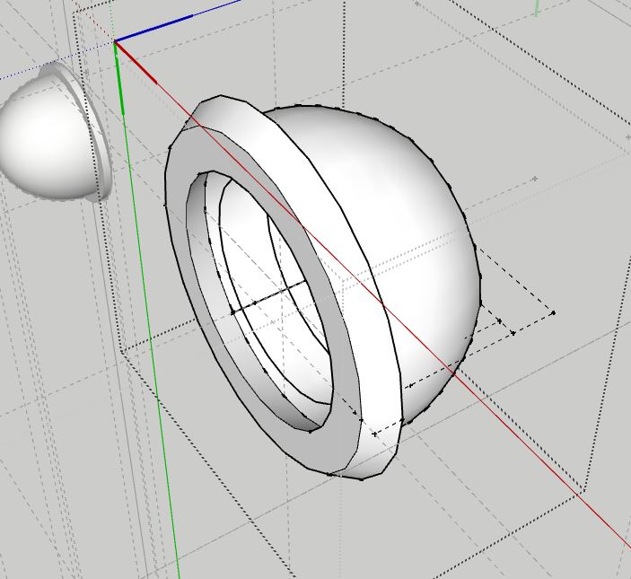

I bought a 3D printer for these and for my new Maleficent horns. But to get to print I need usable files.
And I am a maker at heart so using a freely available file was not going to happen, tempting as it was.

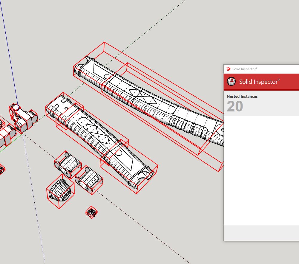

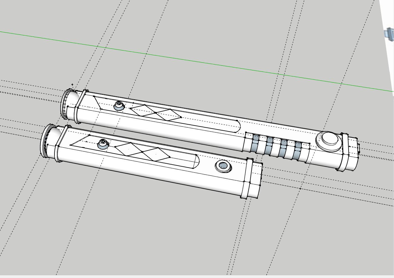

Looking good.. excpet there were errors I couldn't fix with the Shape Bender plugin. So I knew I had to make the file easier to bend. Also somehow it got slightly skewed up the green axis.
So finally:
I wound up keeping my second set of emitters and greeblies and totally rebuilt the hilt bodies and accidentally got the measurements off but they show up as error free!
To make these print very quickly they are short sections that will slot together and I'll use a little acetone to weld them together. But to get that to happen required cutting the hilts while straight tubes, copying them , cutting alternating sections, extruding lengths one one side and recessing the same on the other side. Then making each a component, then put together again as a group, then lines and curves created to use the Shape Bender plugin.
The shape bender makes them all back into individual components so I had to then copy and cut alternating pieces and repair the lost geometry that way.
But it worked!
So I have moved the printer to a ventilated spot and will callibrate the platform again, test and then do a fast test print before a finer setting :)
