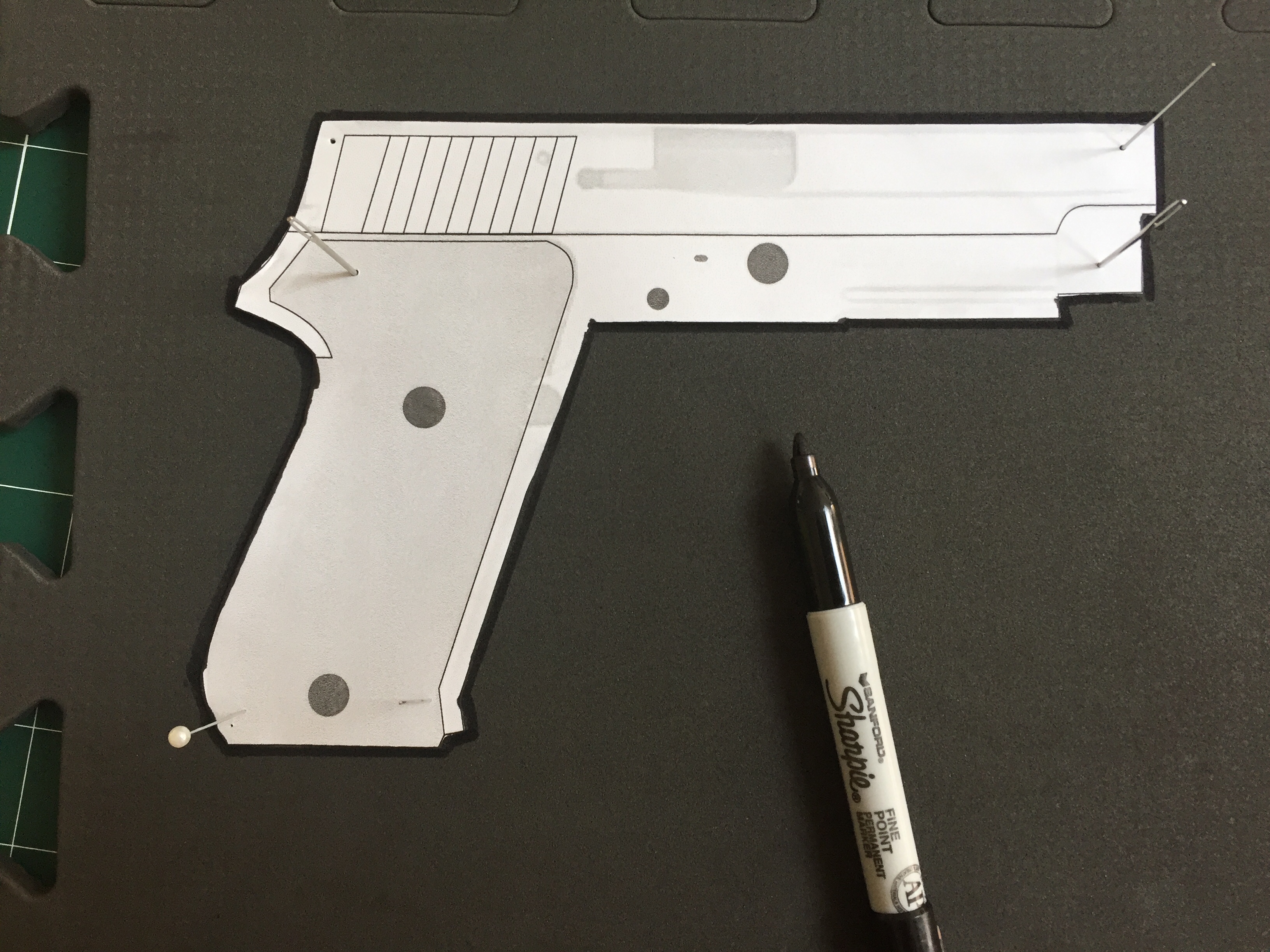

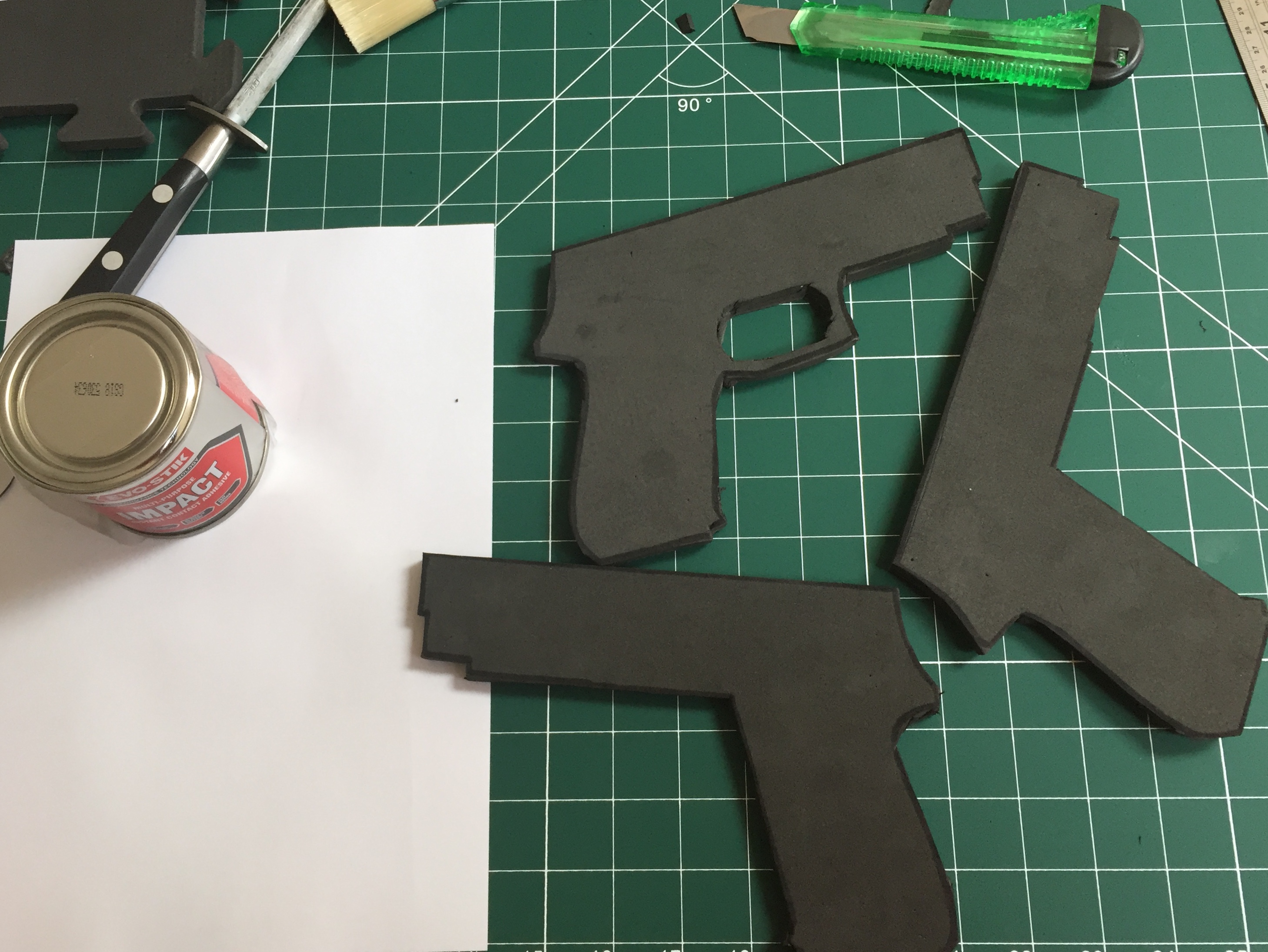

Thought I would start with a pistol. Used Inkscape to create a template around an image and then transferred onto EVA foam.

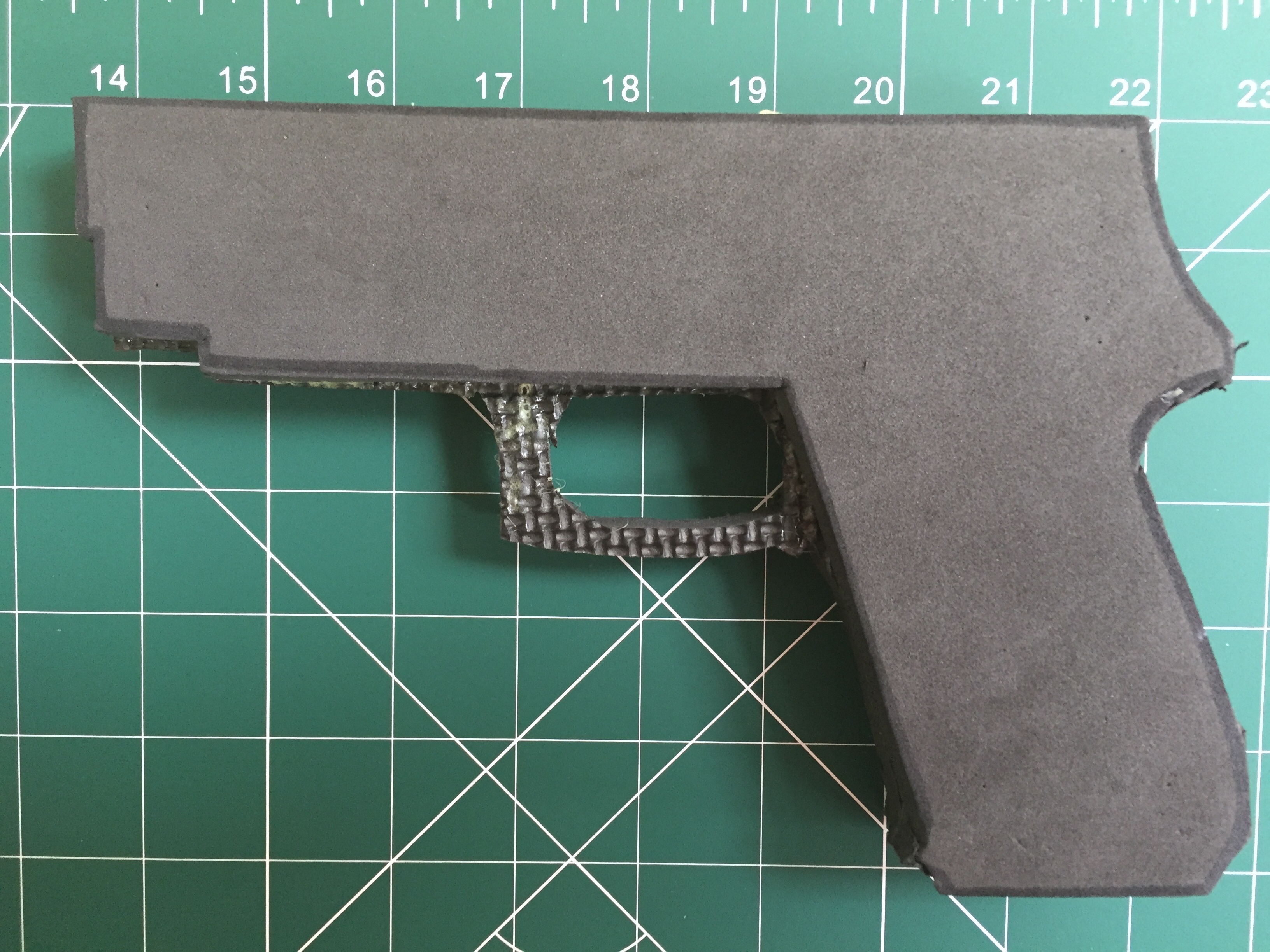

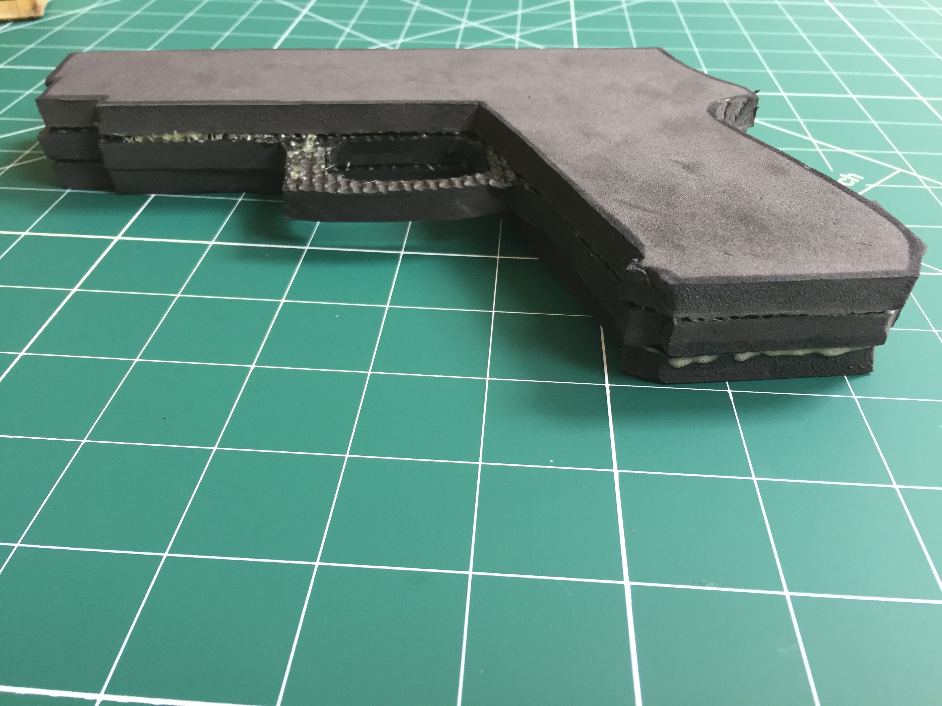

The one thing which hasn't worked as well as I thought it would is the contact cement. Think I might need to sand down the sides I am going to glue but even two coats didn't stick together immediately as well as I thought it would. Perhaps I wasn't putting enough on?
Any clues or suggestions would be welcome.
Here is the end product of the rough outline.Loads of filling, sanding, smoothing and detailing to do yet. This is just the basic shape.

Hey there! Yeah, when gluing layers of foam, you have to sand off that waffle texture. The way it’s factory sealed, it’s a pain to glue. When you get to the arm, check this out: https://www.etsy.com/listing/617651790/winter-soldier-arm-foam-templates?ref=shop_home_active_2

Thanks so much for replying. I will treat this first attempt as a prototype learning exercise. Today I sanded, bevelled and filled in some gaps. May have been a bit heavy with the sealant!!
I used a silicone based sealant which many of the cosplay videos suggest but not the Kwik Seal which many recommend. It’s only available online in the UK. Think I put too much on and didn’t scrape enough off.
Now starting to add some detail. And I will then look at sealing, coating and painting.
