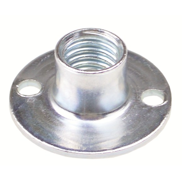

Also, I did use an old T nut on the endcap, drilled a fat hole and popped it through with some E6000 to keep it situated.

generally speaking, you'll want one with the right sized threaded portion, which was quite large

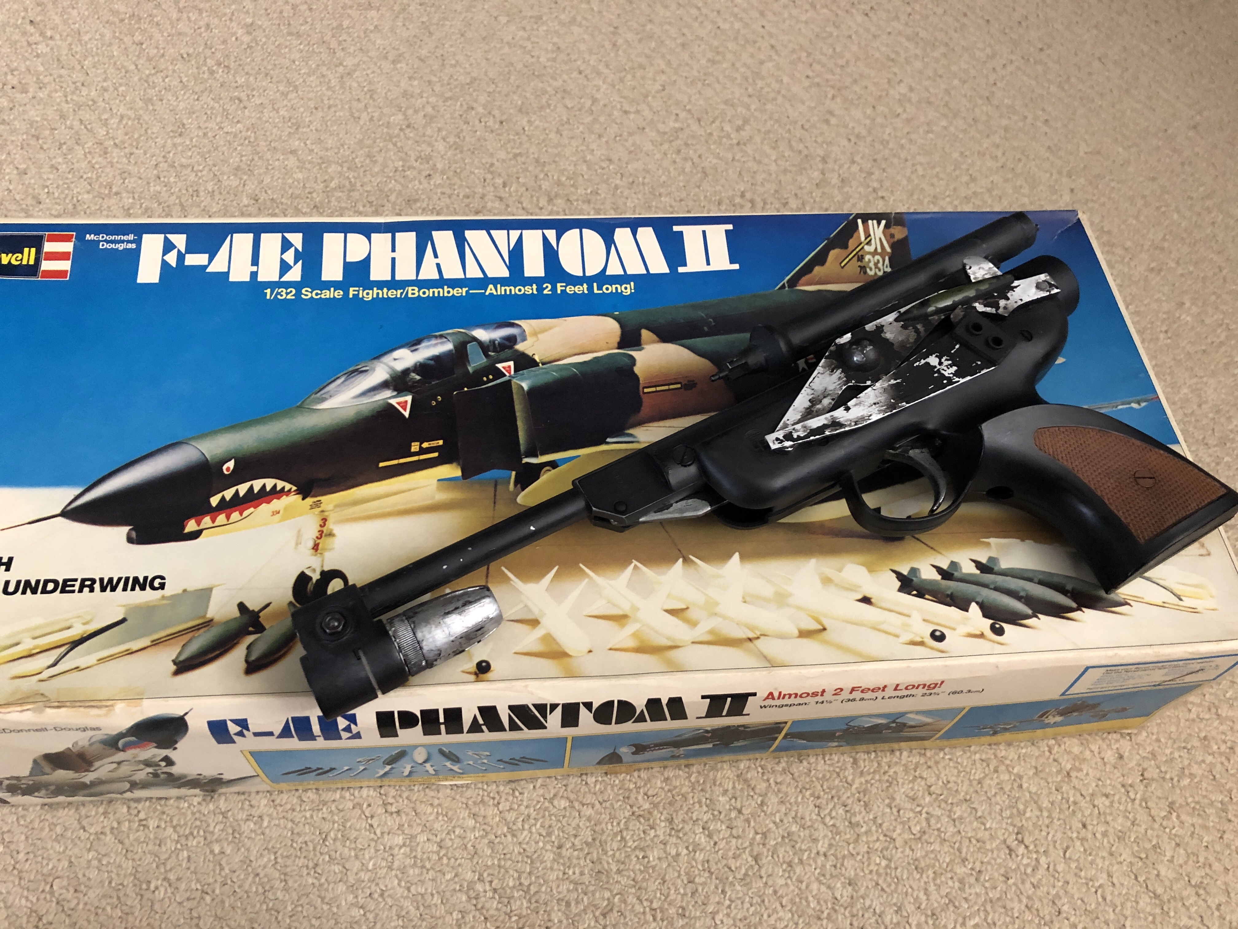

Bit the bullet (missile) and bough the Revell Phantom II F-4E kit. It's a whopper of a kit, and I'm tempted to build it. Although it has raised panel lines - so... plenty scribing. I can now "revell" in glorious X-wing engine and Fett Blaster parts.

I forgot, for the back, I used a lathed/ground down knurled bushing from a brass antenna socket from my undergrad phsyics lab old stock parts, couldn't find a T nut large enough.
it had a brass tube, with a flexible copper plug inside, and a big knurled brass collet around the top. I ground off the knurling, drilled a hole in the rear cap and stuck it in!

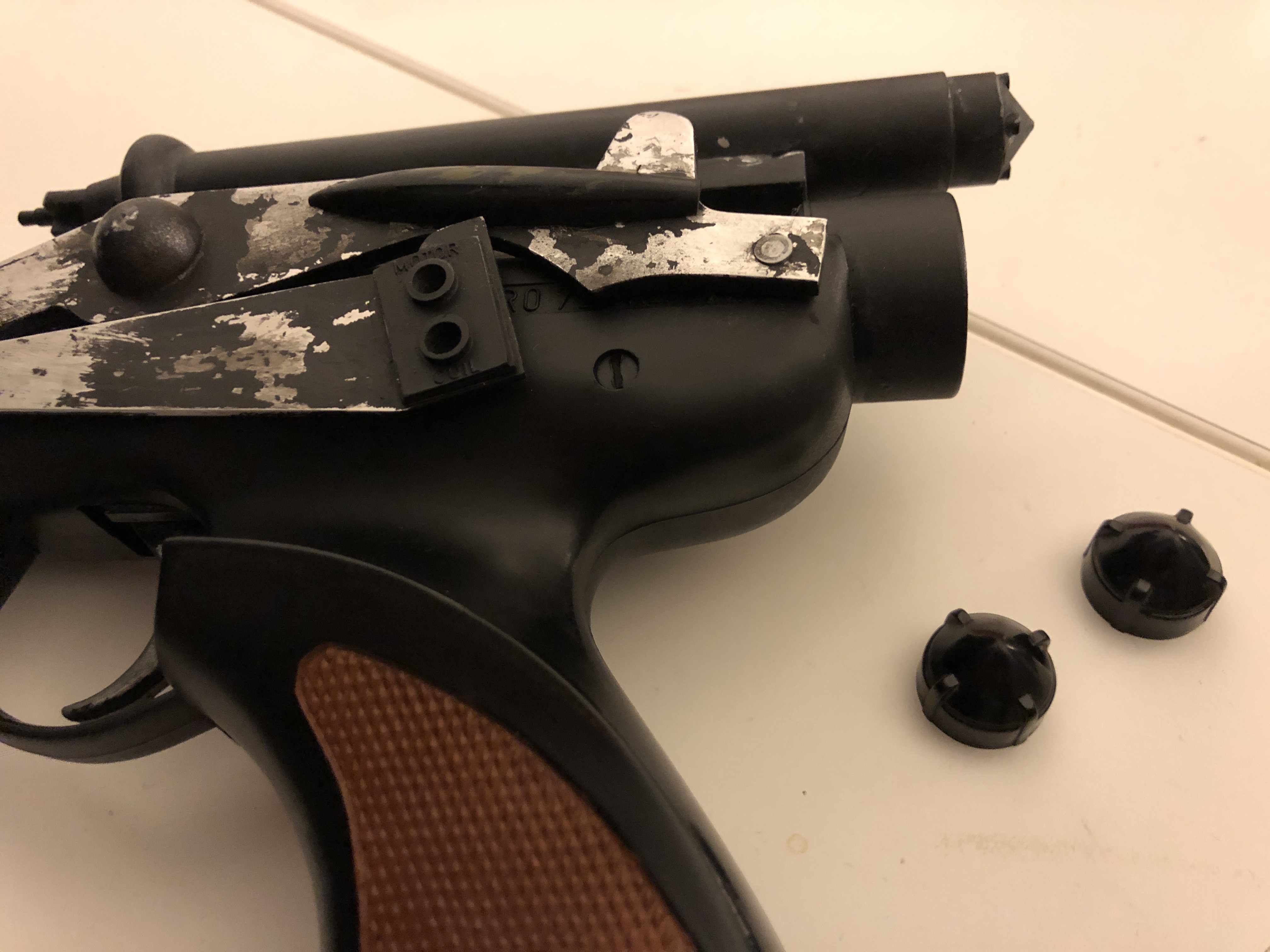

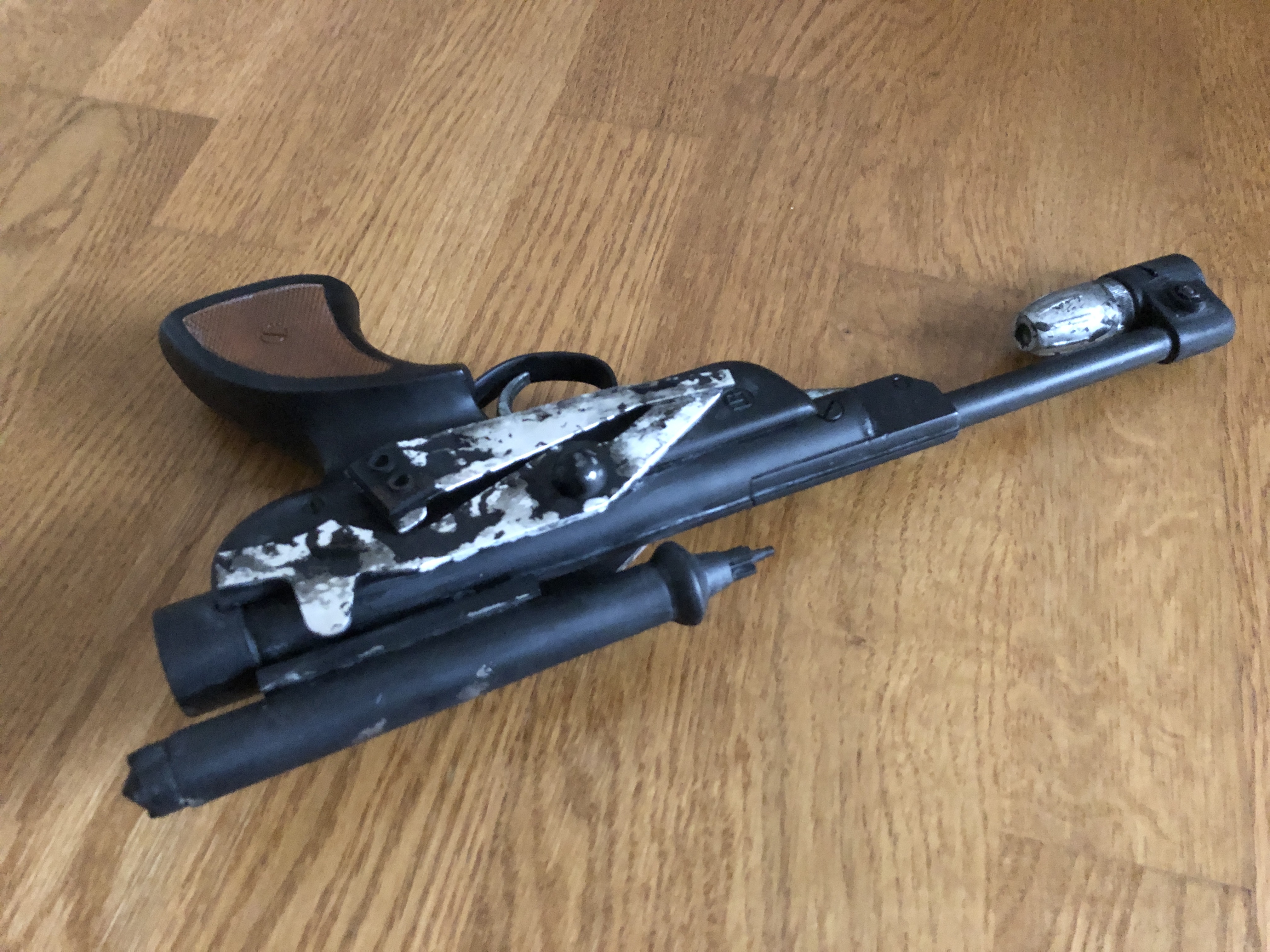

I've just received my "vintage bullet shaped thingies" to replace the end caps of the CE scope (which I'm going to have to saw off!!!! YIKES).

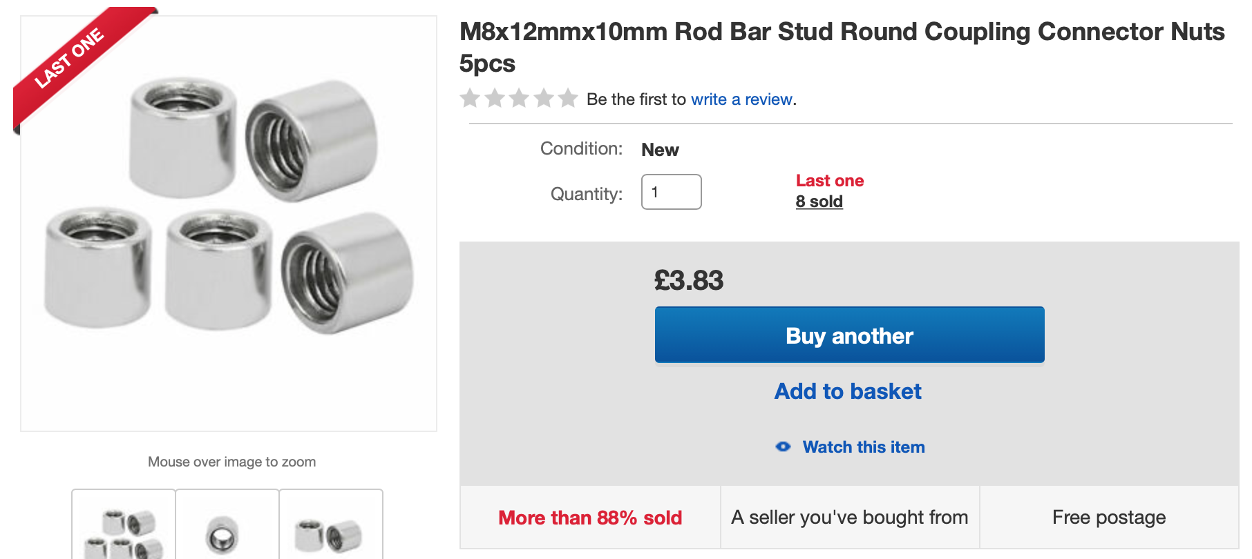

I'm going to be using stud connector nuts from China for my missing stock nut - they're a bit undersized being 12mm diameter (15mm is the right size by my estimate. Is that correct?), but I'm hoping they'll do the job.

For the "cross knobs"... are there different sizes of these? As the ones I've got seem too wide in diameter for Vince's CE scope.
Dann - you have the Vince scope don't you? Your "Cross knobs" look like they fit correctly, being slightly smaller in diameter than the scope.
If so, please PM me what knobs I should be looking for LOL!!!!

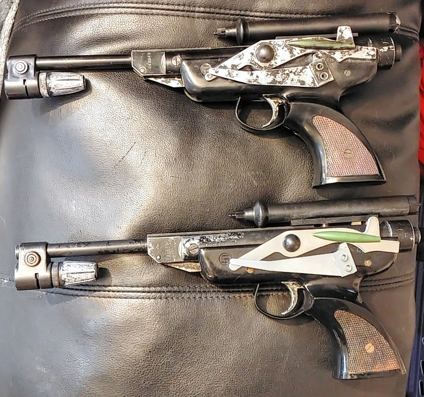

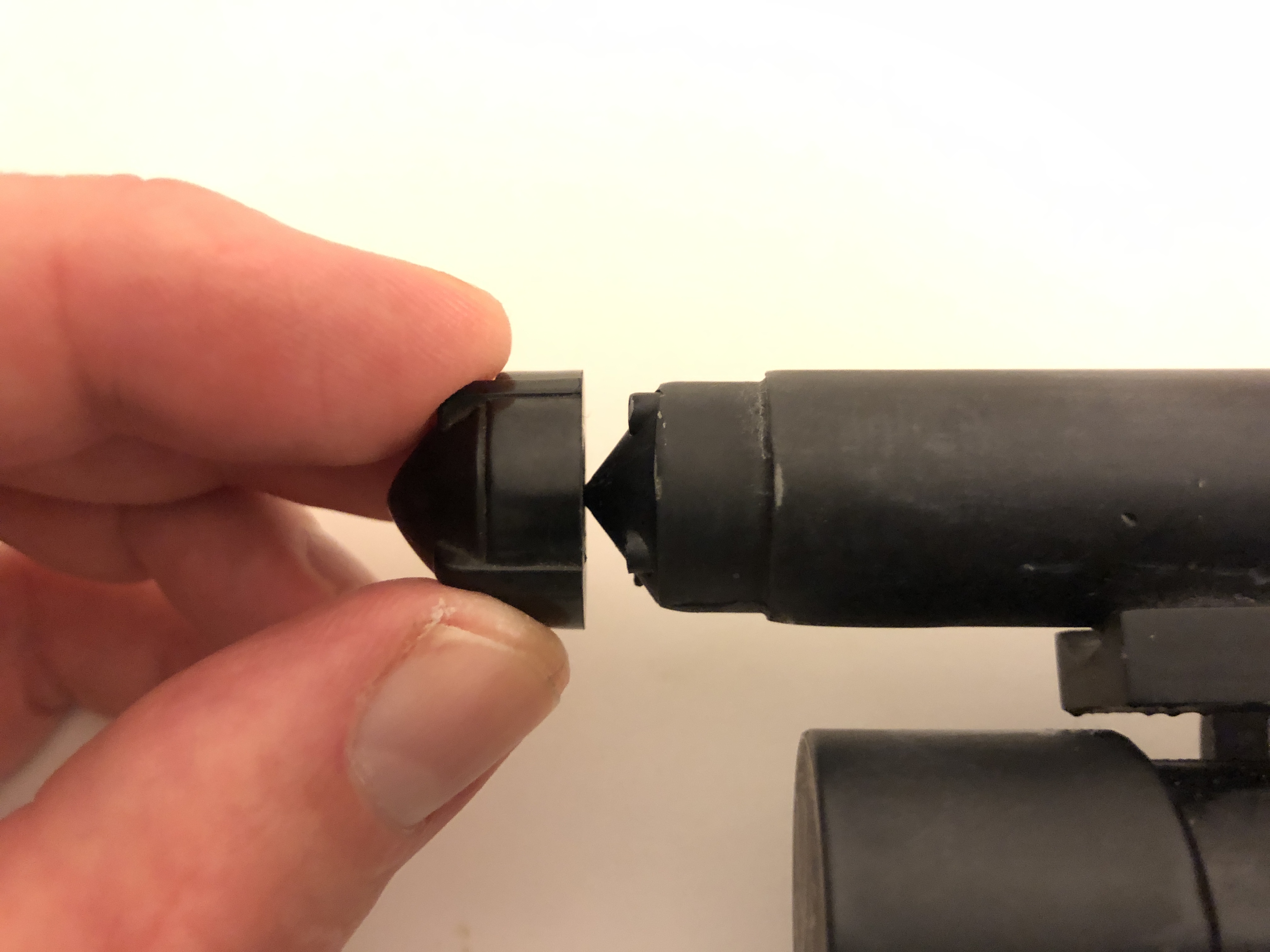

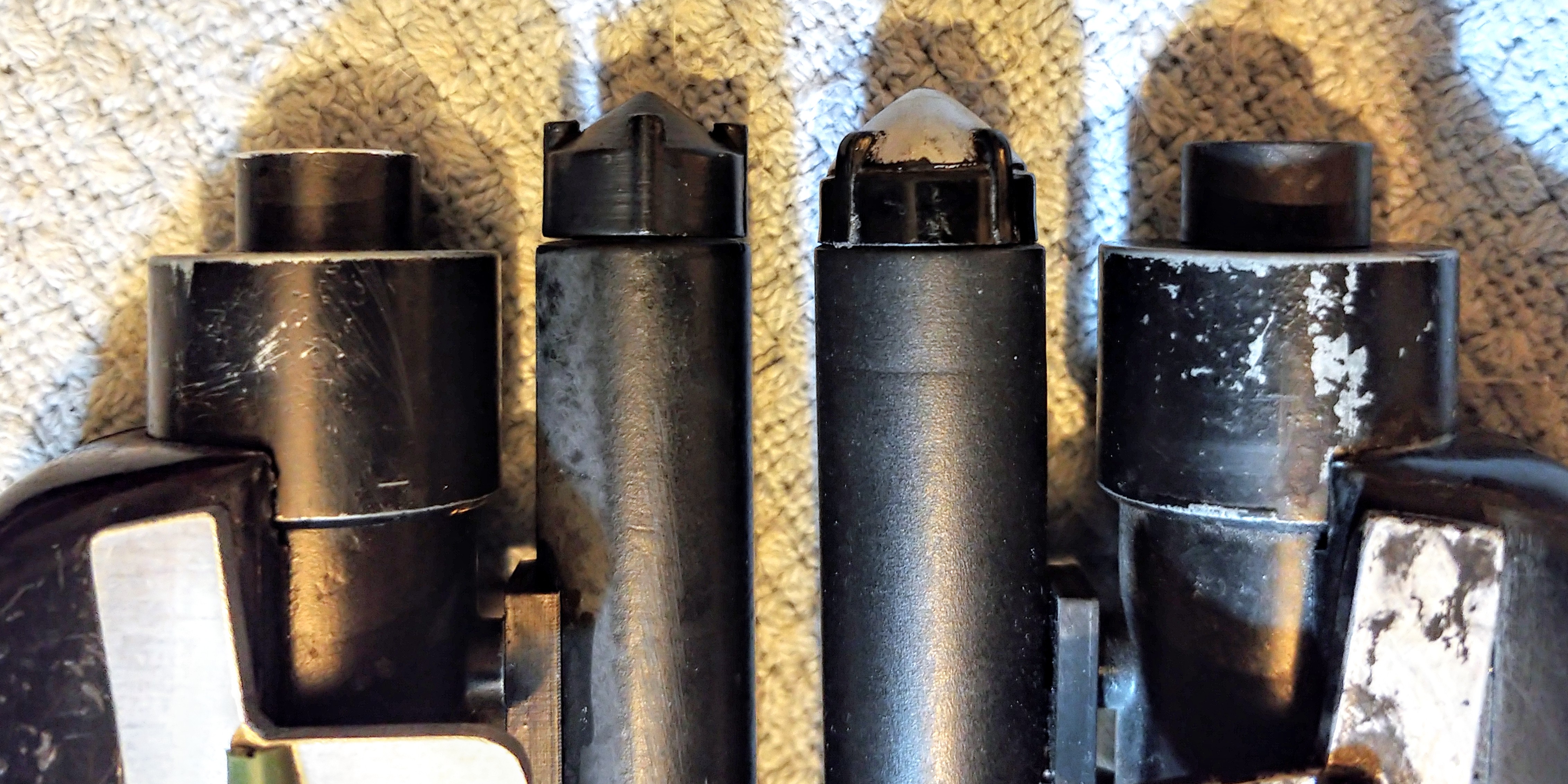

So, I've actually got two of these blasters. They're currently in a state of flux, because I recently got some new parts. But yeah, one of the scopes I have is Vince's, and I get .759" for the diameter at the rear end. My real "end cap" is .754" at the base, and it has a very very slight taper (more of a curve, really), so if I measure up in the middle area of the cylindrical area, I'll get .745".
Yours looks right to my eyes, I think Vince made his "end cap" just a little on the small side, diameter-wise.
In this pic, the CE scope is on the bottom blaster, and it's got an inaccurate end cap. The top blaster has the new scope with correct end cap.
Here's another shot comparing the two. Note, I cut Vince's end cap off shortly after I received it, to install the correct one. But since then, I removed it again to install it on this new scope. So, Vince's original cap isn't in these pics, but the one I modeled as a replacement is very similar to his. I haven't gone back to change my model since getting the real end cap. Too many other projects, but I will remodel it to get as close as I can to the real one.

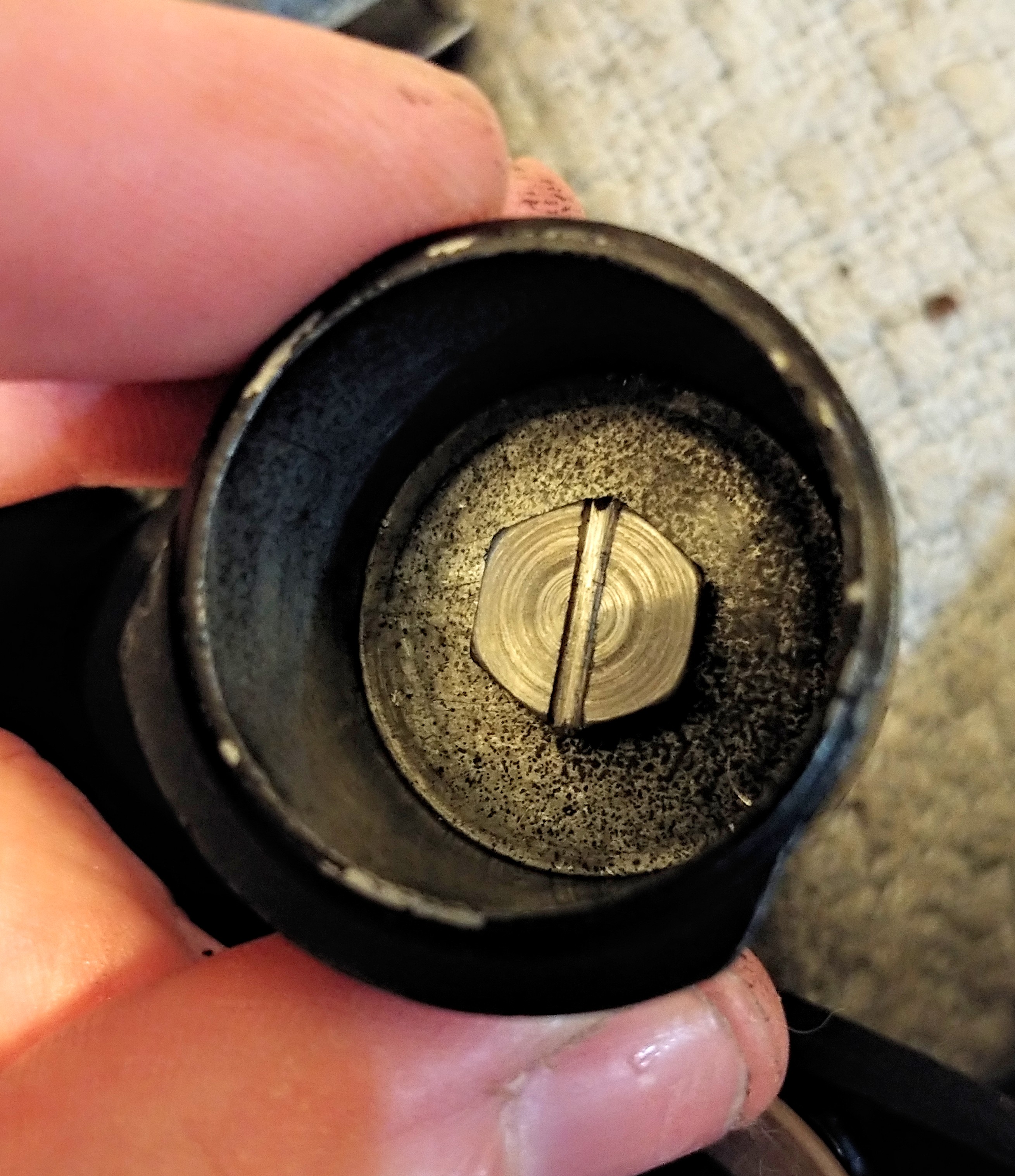

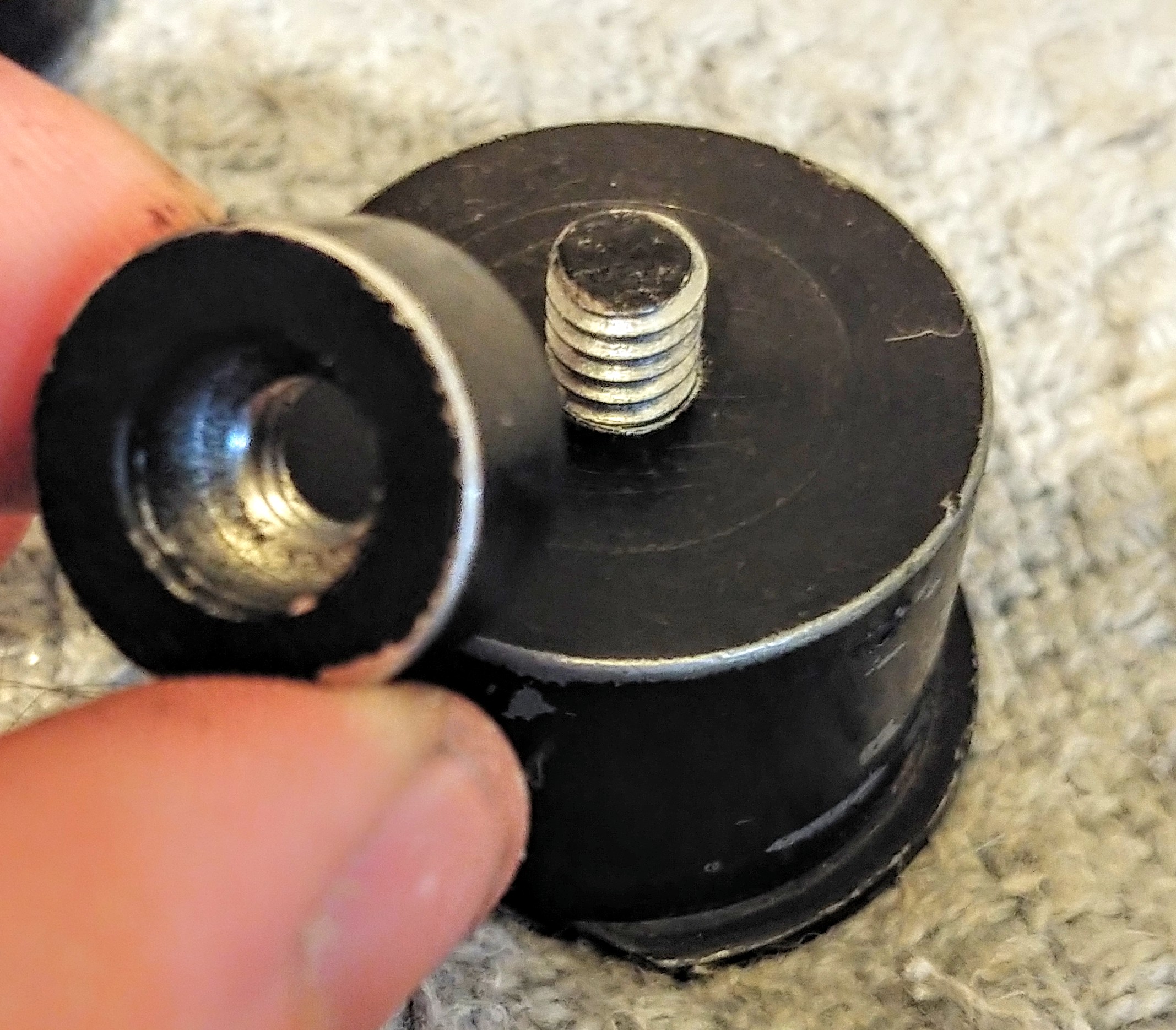

Oh, one other thing, to answer your question about the stock attachment nut. Mine are 5/8", or .625", or 15.85mm. I think that's pretty close to the original, but I'm not 100% sure, and I'm also not 100% sure about the internal threads. I think they're supposed to be 3/8-16. Can anyone confirm that?

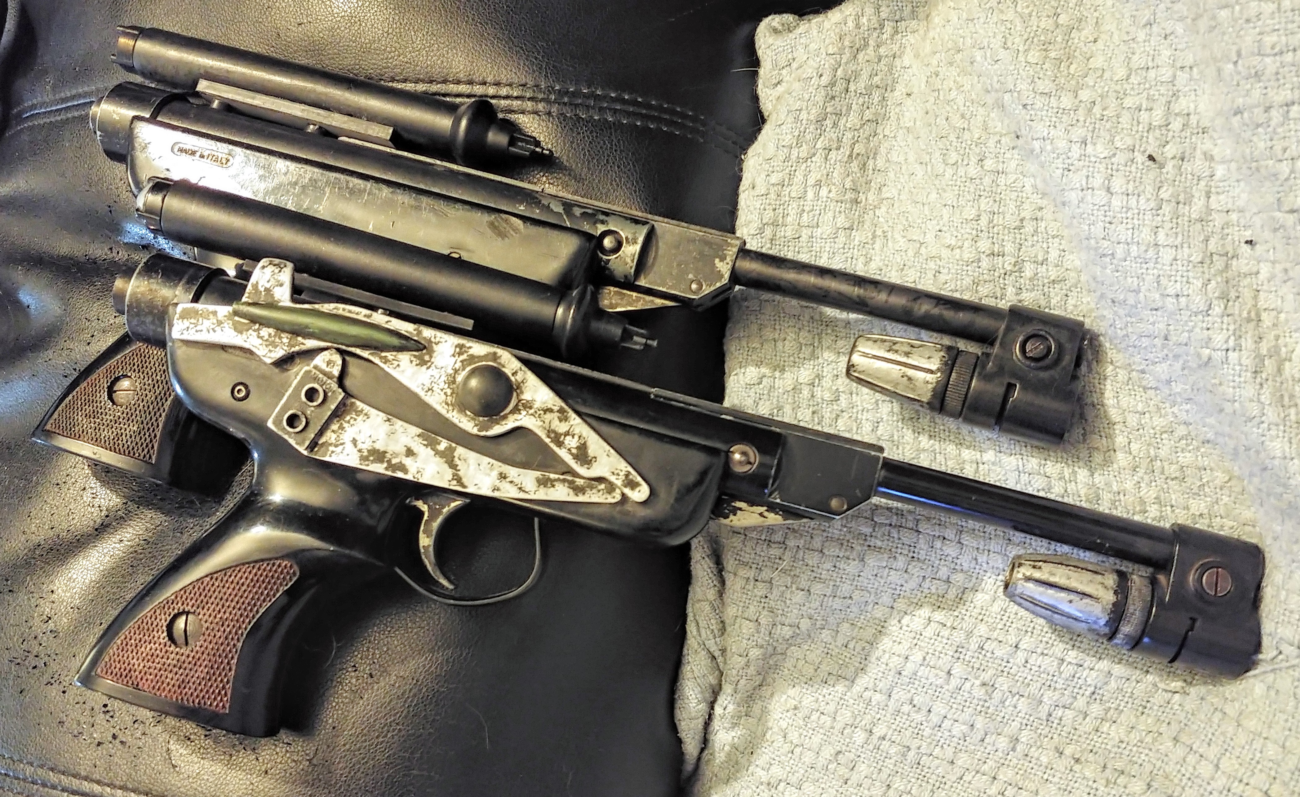

I used Humbrol masking fluid in a fairly loose, splotchy pattern, then sprayed flat black. I "glanced" at the reference while doing this, but mostly did what felt right. After I rubbed off the masking fluid, I scraped along all the edges with sandpaper to get natural looking edge wear, and created some chips with my nails! But I found the bright metal and black paint were too contrasty, so I painted a wash of thinned black acrylic over the parts. Then I rubbed that back too with a bit with wet'n'dry.
I came to the same conclusion as you: don't try to match every chip on the real prop. It's better to figure out the original prop-maker's process and be as loose and rough with the prop as they were. You get a more authentic looking finish, rather than a "perfect replica".

Oh, I DEFINITELY looked and looked and looked and looked some more, for the "real" part. I spent days on eBay looking at all kinds of shish. Found a lot of similar looking shapes and things, but nothing definite.
So, no, as far as I know the real part still hasn't been identified.
