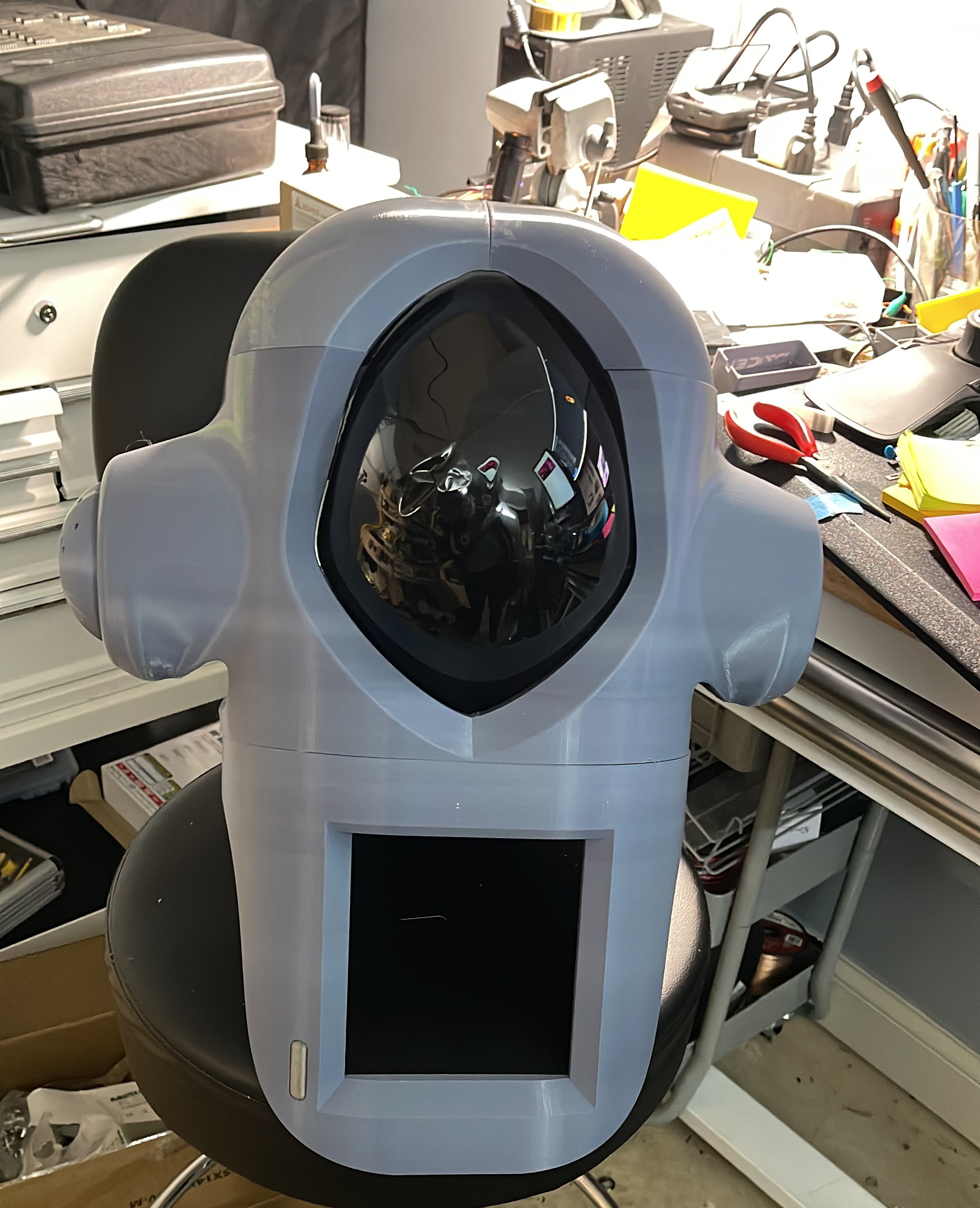

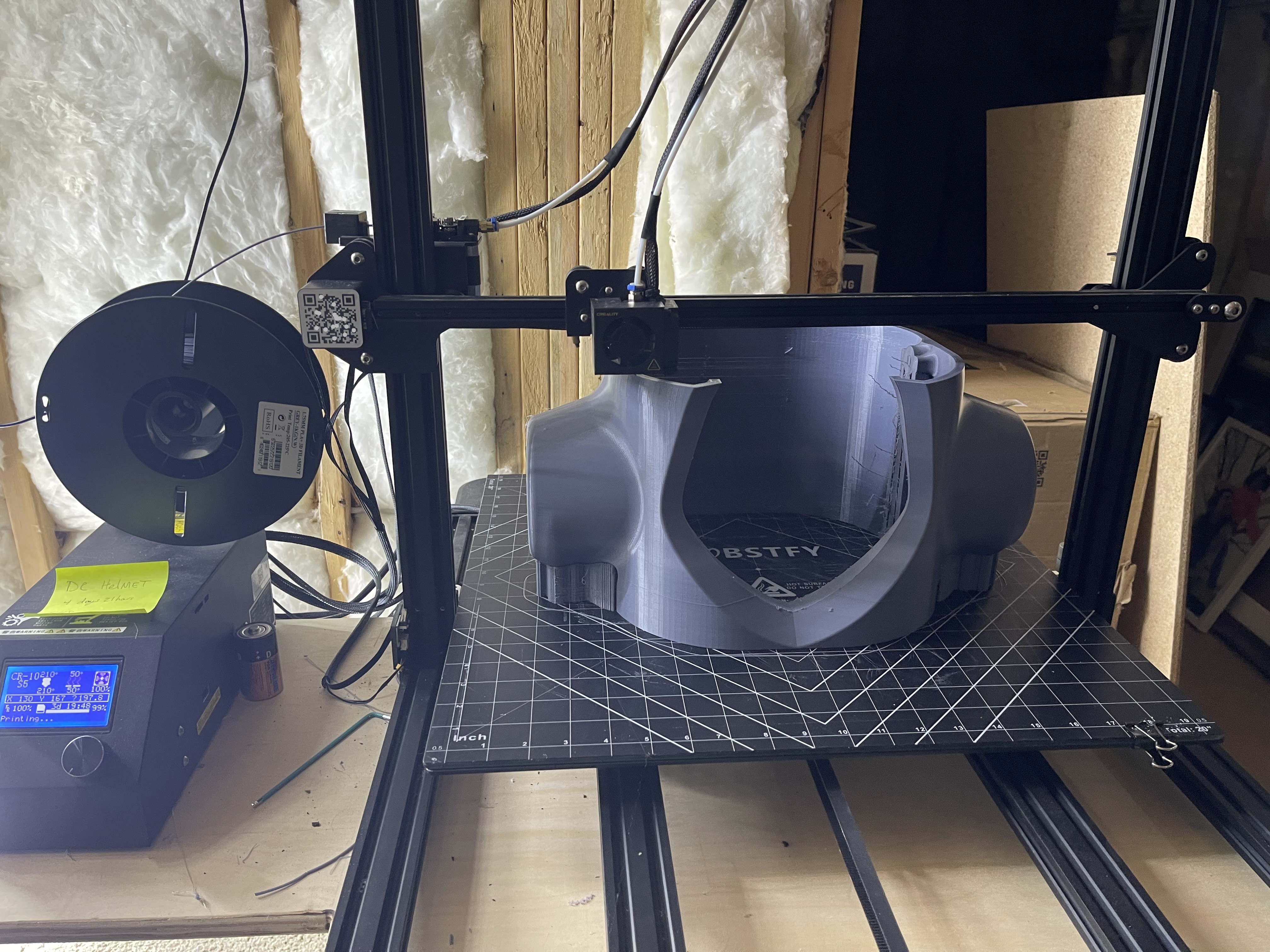

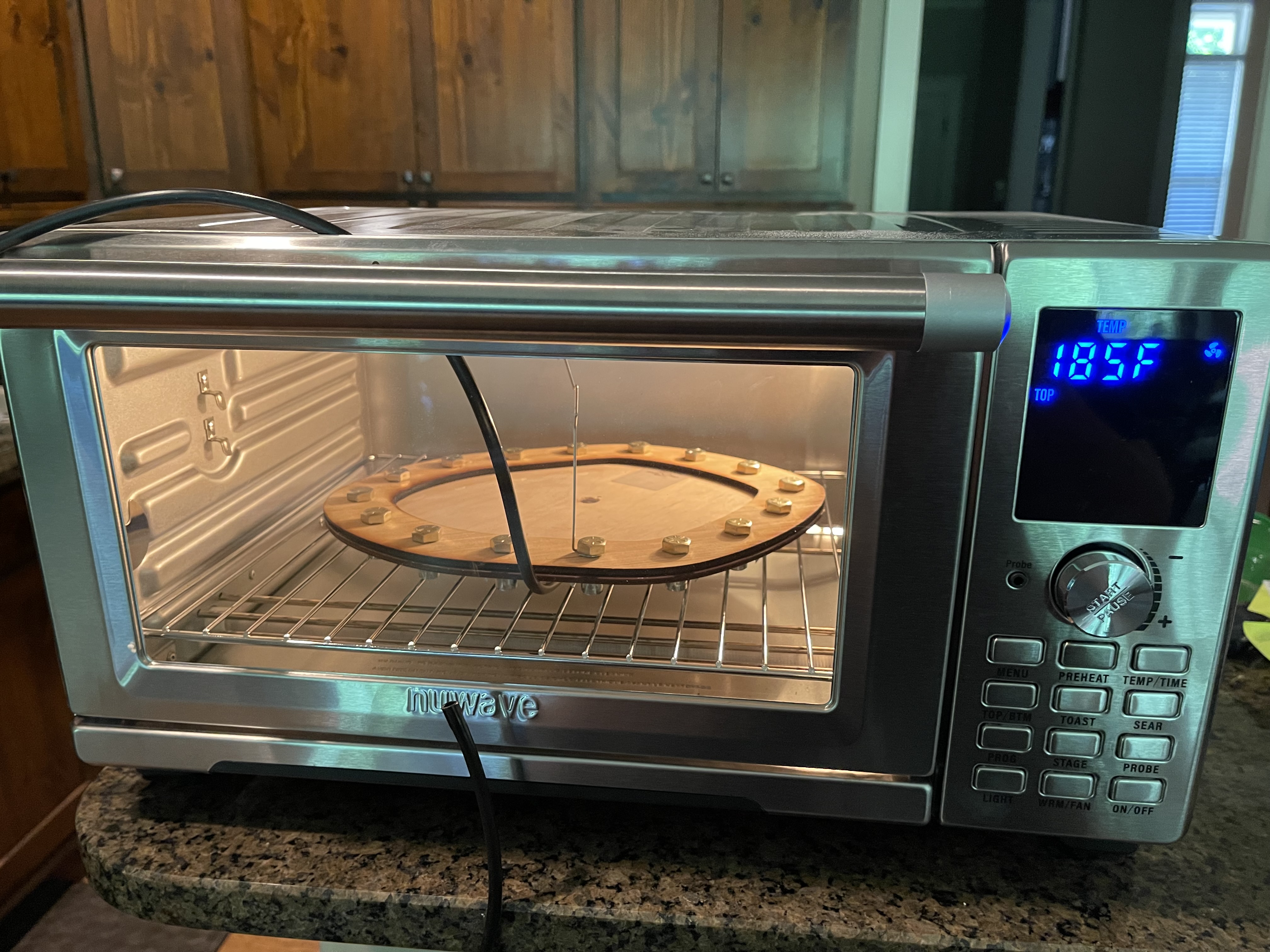

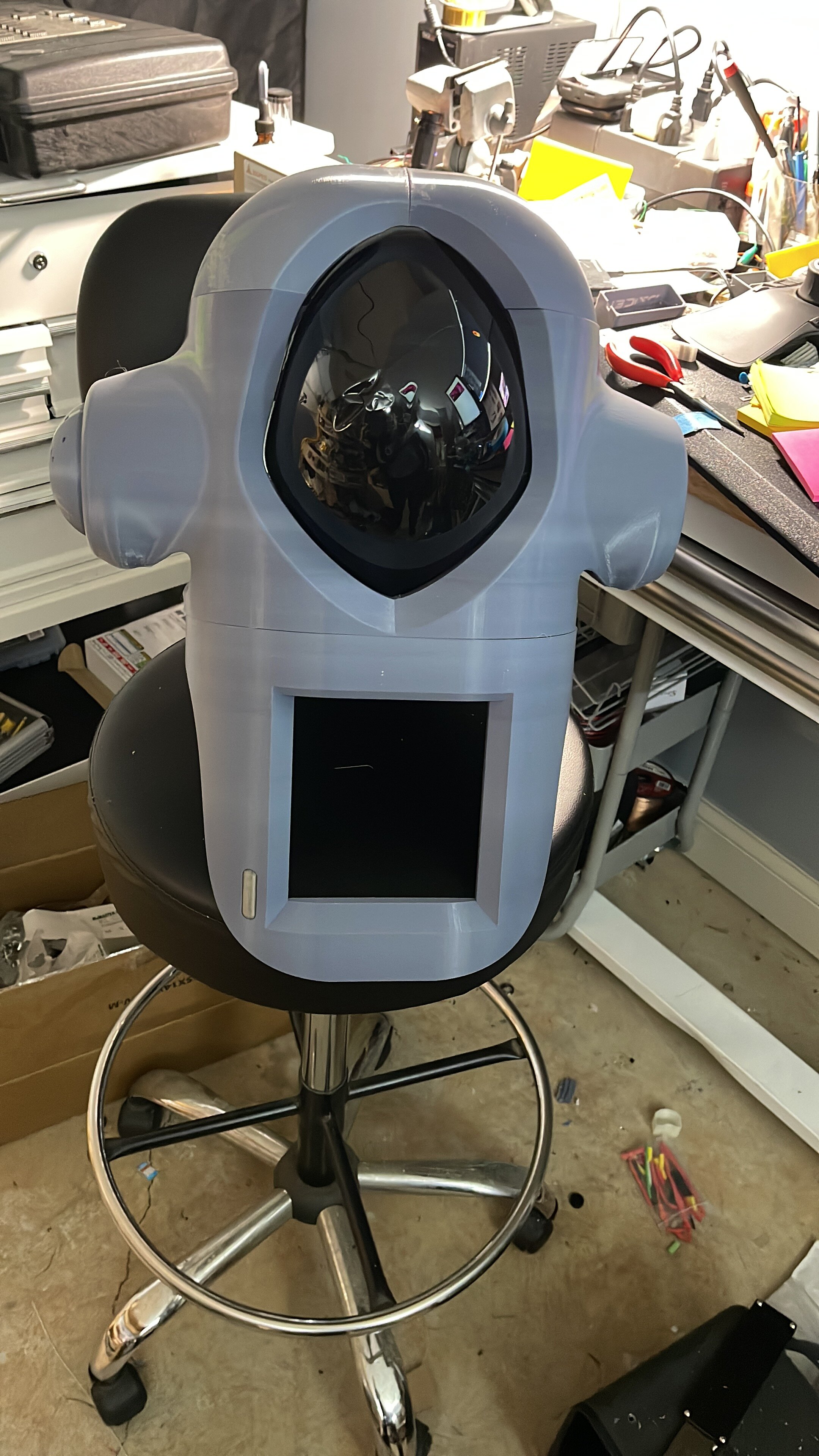

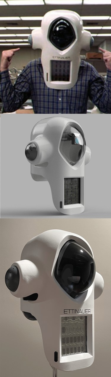

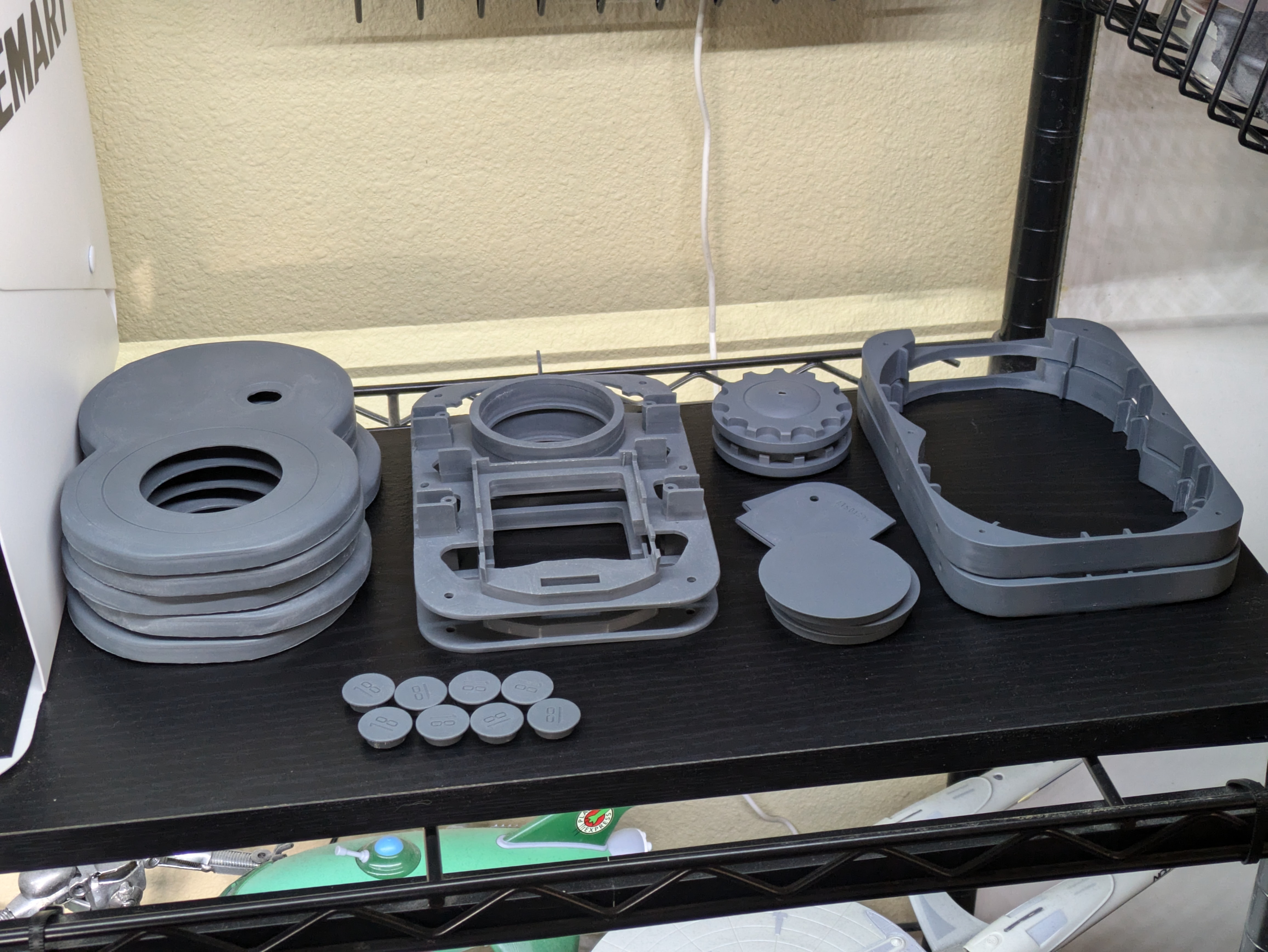

I had finally got this project out of my head. For years I have loved the camera men from "Real Life" 1979 film and wanted to build a pair of cameras that can be worn and displayed. As you can see better in the 3D rendering is a functional 4K camera that is voice controlled by the operator. This project was a lot of fun and learning experience building this from scratch. The build took about 9 days total. A quick break down was 2 days of design and test prints, the main body took about 5 days of printing between 7 printers then lots of sanding filling priming and painting. The lens was blown in a toaster oven and took about 10 blows and dyeing to get 2 4 usable lens. I never could figure out what circuit boards were used in the original Ettinauer 226XL but I feel happy with what I was able to dig up. I wonder what ever happened to the original Ettinauers from the film? If anyone has ever come across them or know more about them I would love to here the stories.
View attachment 1849080View attachment 1849089View attachment 1849090View attachment 1849088View attachment 1849092
Pretty cool how you’ve done the visor

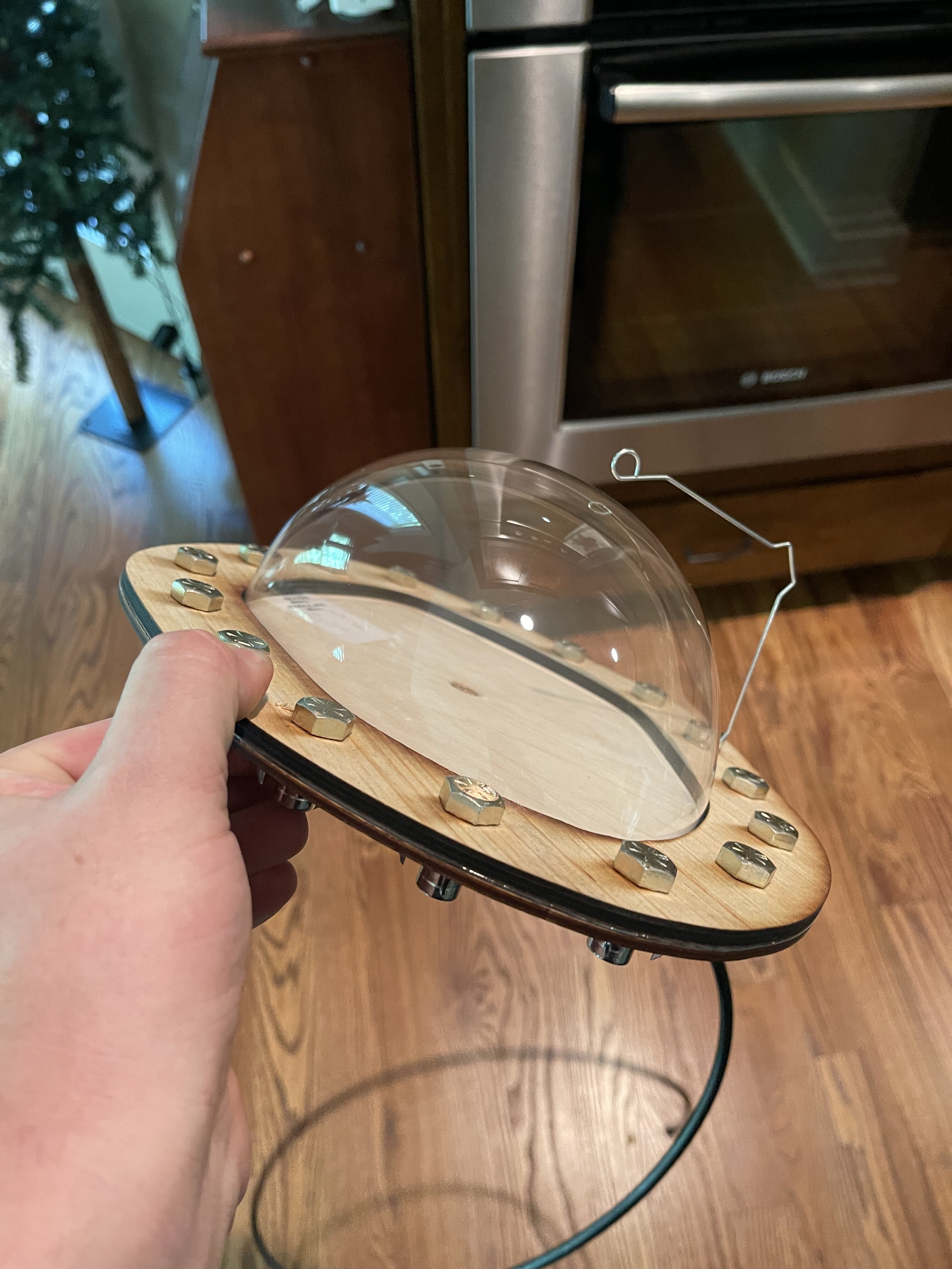

It was hard to figure out how I was going to fabricate it. I was thinking of vacuum forming over a buck but that would probably leave ripples. I did think about slump molding it on a vacuum former but I also didn't have a larger forming machine. I remember seeing on line a guy blowing a dome and thought that would be perfect for this application. Plus I had a odd shape hole I needed this to fit, so I took a reference of the opening from the 3D model and laser cut a frame to hold the material for blow molding.

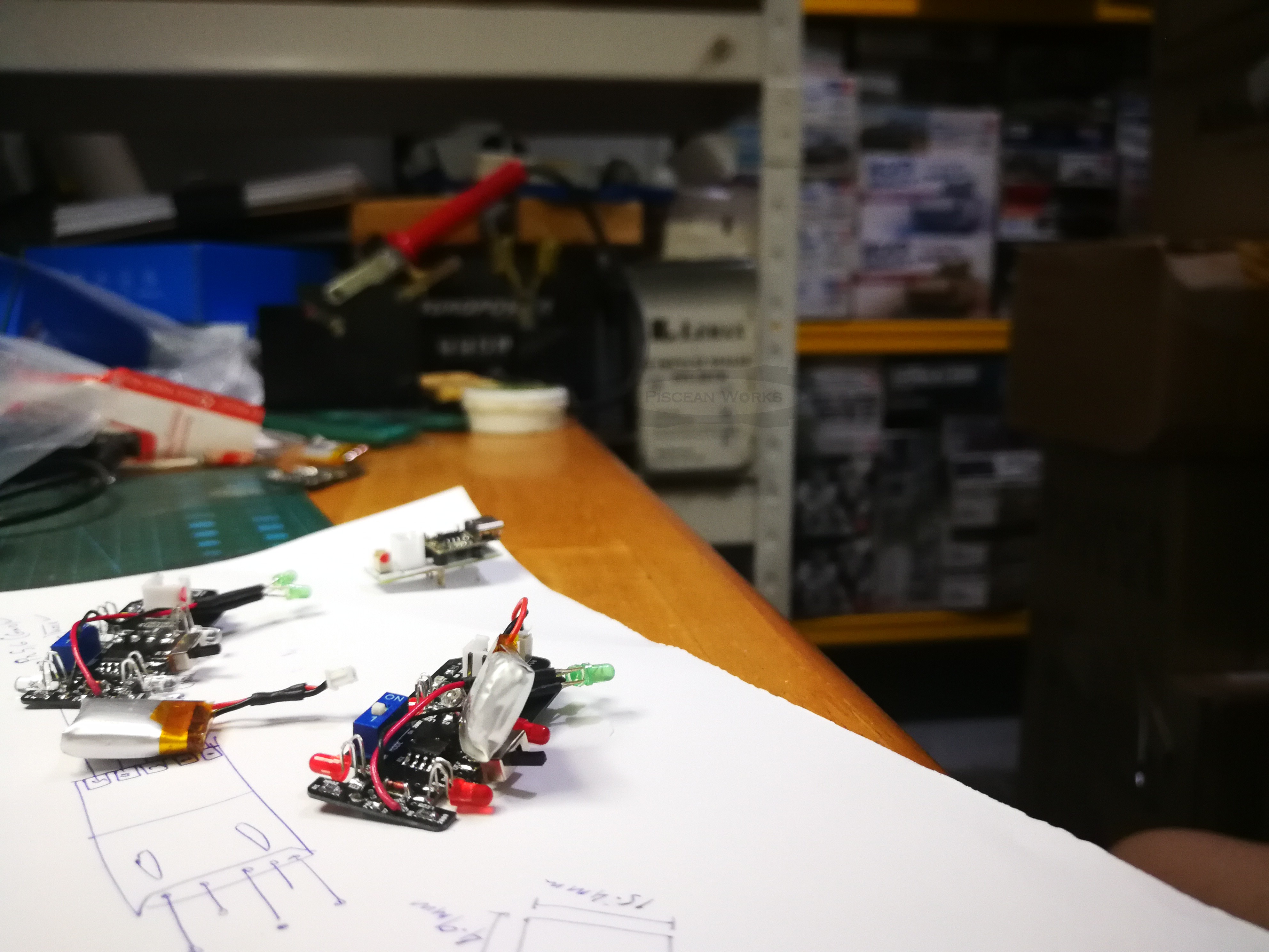

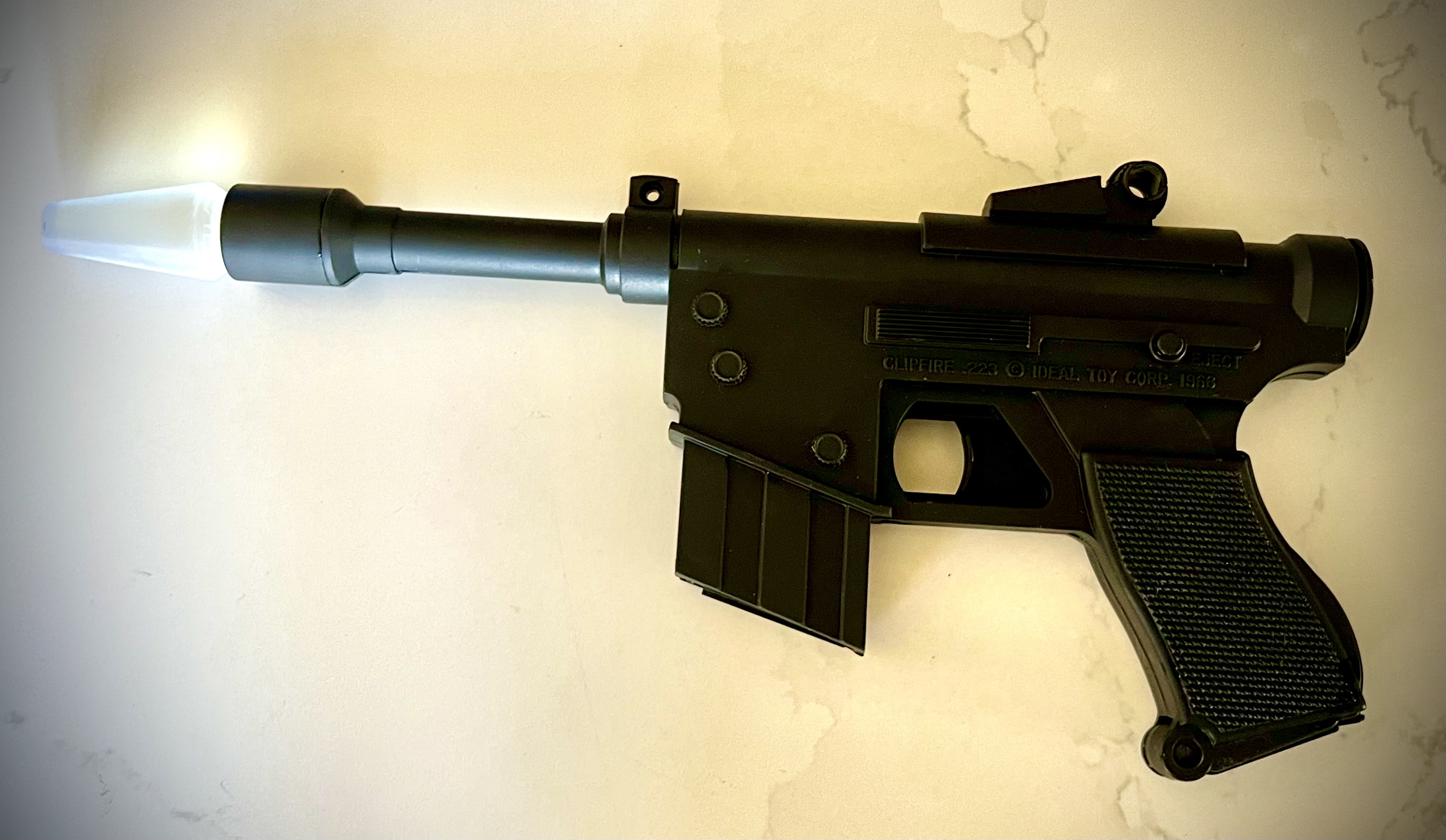

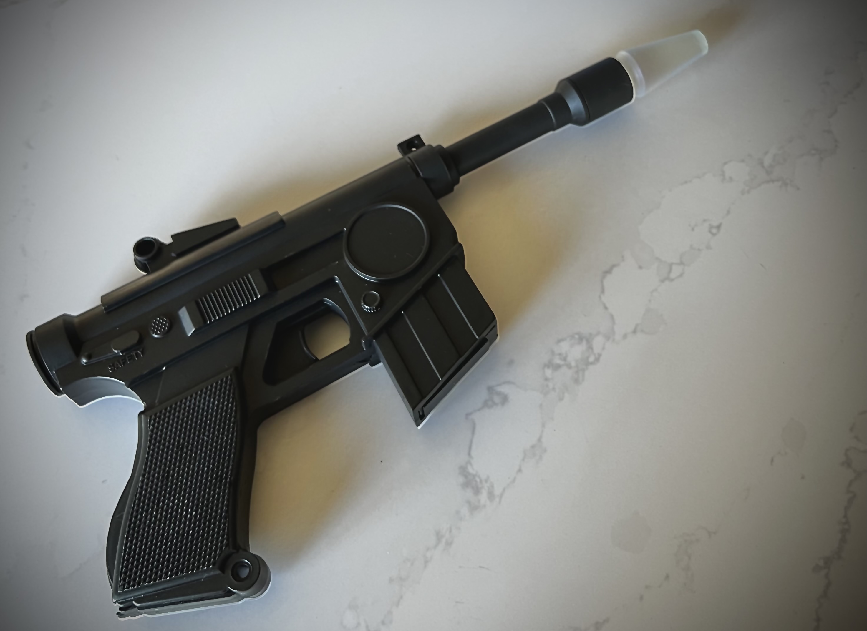

Trying to figure out how to solve a design issue for the PKD Blaster circuit board and figuring where to get the cash and how to write an instruction manual so I can start getting these boards out the door.
