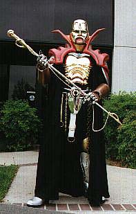

For the American version of Masked Rider we had Count Dregon's helmet metalized and it was made of a urethane rubber. Even after a season of shooting it still looked pretty good. You could clearly see where it was being bent (to put it on, you had to flex it, hence the reason for it being rubber) but it held up much better than I expected.
Side note: The chest and belt plate where also vacuum metalized and I think the gauntlet pieces where fabricated in aluminum and polished.

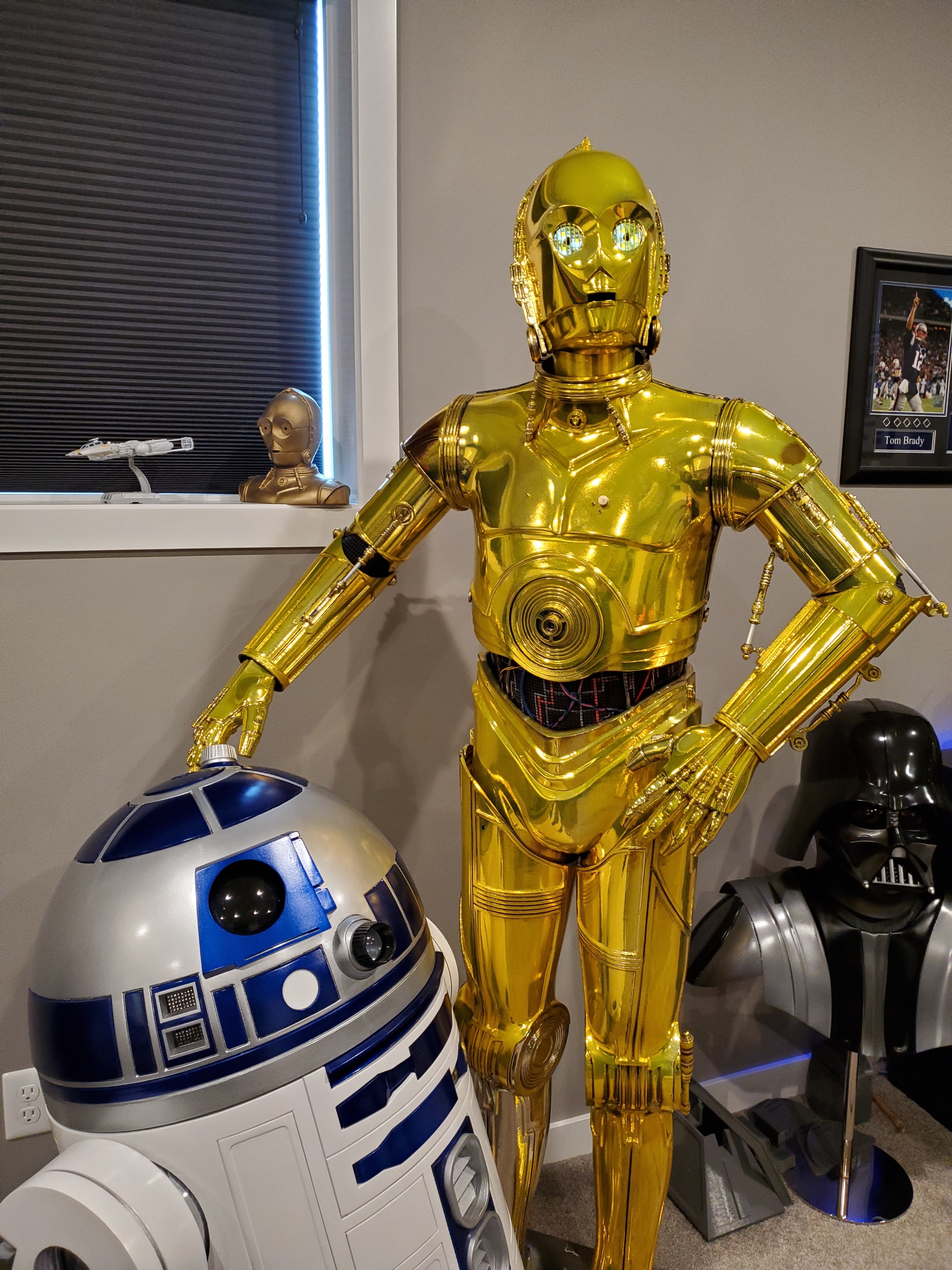

I used this for this
Looks to be silver nitrate. One issue I have had with this technique, is unless the top coat is very good, and impervious to oxygen, the silver nitrate discolors over time (5-10 years)
I used a 2k clear coat with a gold tint over the nitrate, I have no idea about the longevity of it but I can't imagine it being an issue. I used 3 coats so it should be well sealed.
