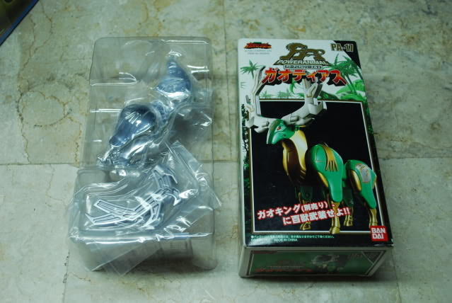

Here's a photo of the toy:
The toy is VERY hard to find for some reason, I could have had it in 2015 but I did buy it for some reason.
I'd like to attempt to make a custom one.
I'll be using the painted toy as a base:
I'm not sure how I'd do it. What would be the best way to make it look as close to my other toys as possible?

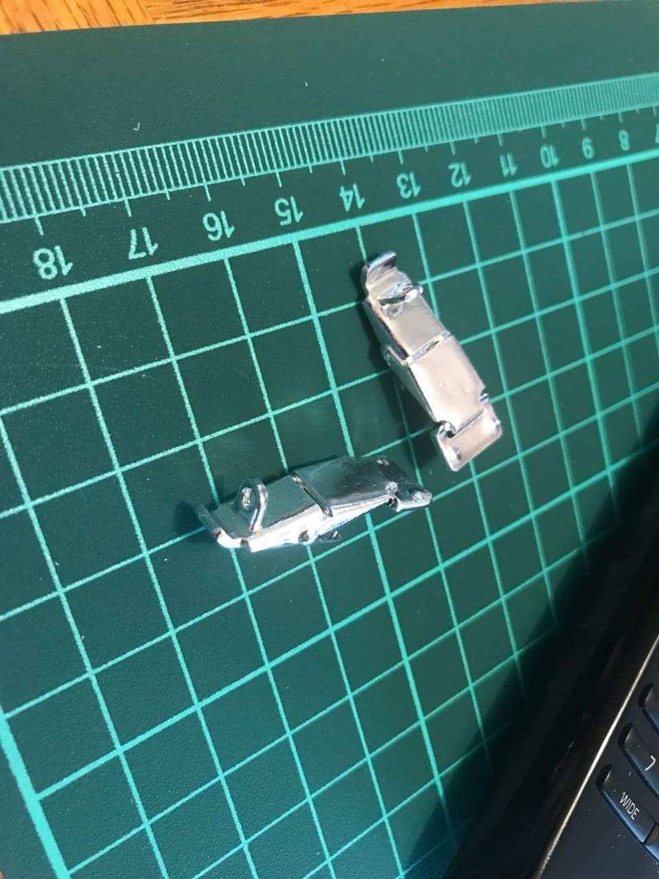

My experience with it is limited of course, but I did not find it thick, those 3D printed parts are less than 3/4” long and you could still see flaws in the prints and such. I forget how many microns thick they said it was. I’d think that by the time you put conductive paint on it you’d add an equal thickness or more to the items. I can take pics of them beside a vac metallized part to compare colour
