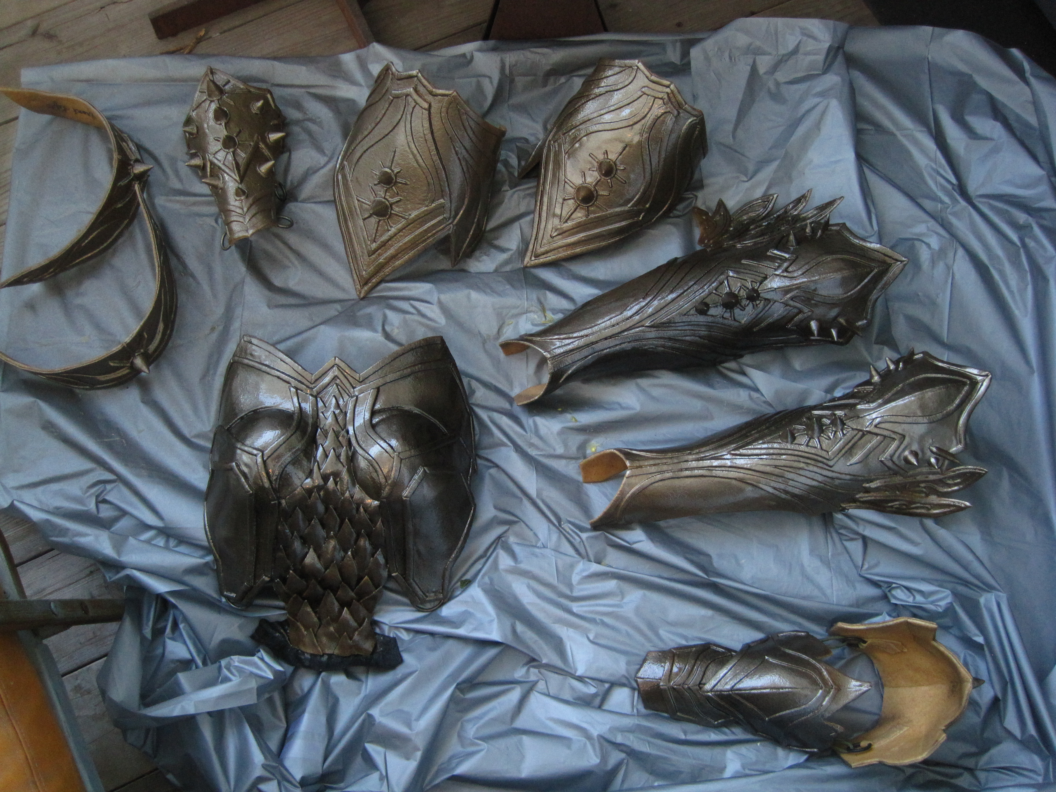

Finally, all the armor is (mostly) squared away!
I primed the Worbla with two coats of Titebond wood glue, which gives it a nice smooth surface with no sanding; wood glue is sort of self-leveling, so it spreads out super smooth with no brushstrokes.
After that dried today, I threw on a coat of Rustoleum's hammered finish spray paint. I was looking for a pewter or bronze, but settled on this "chestnut."

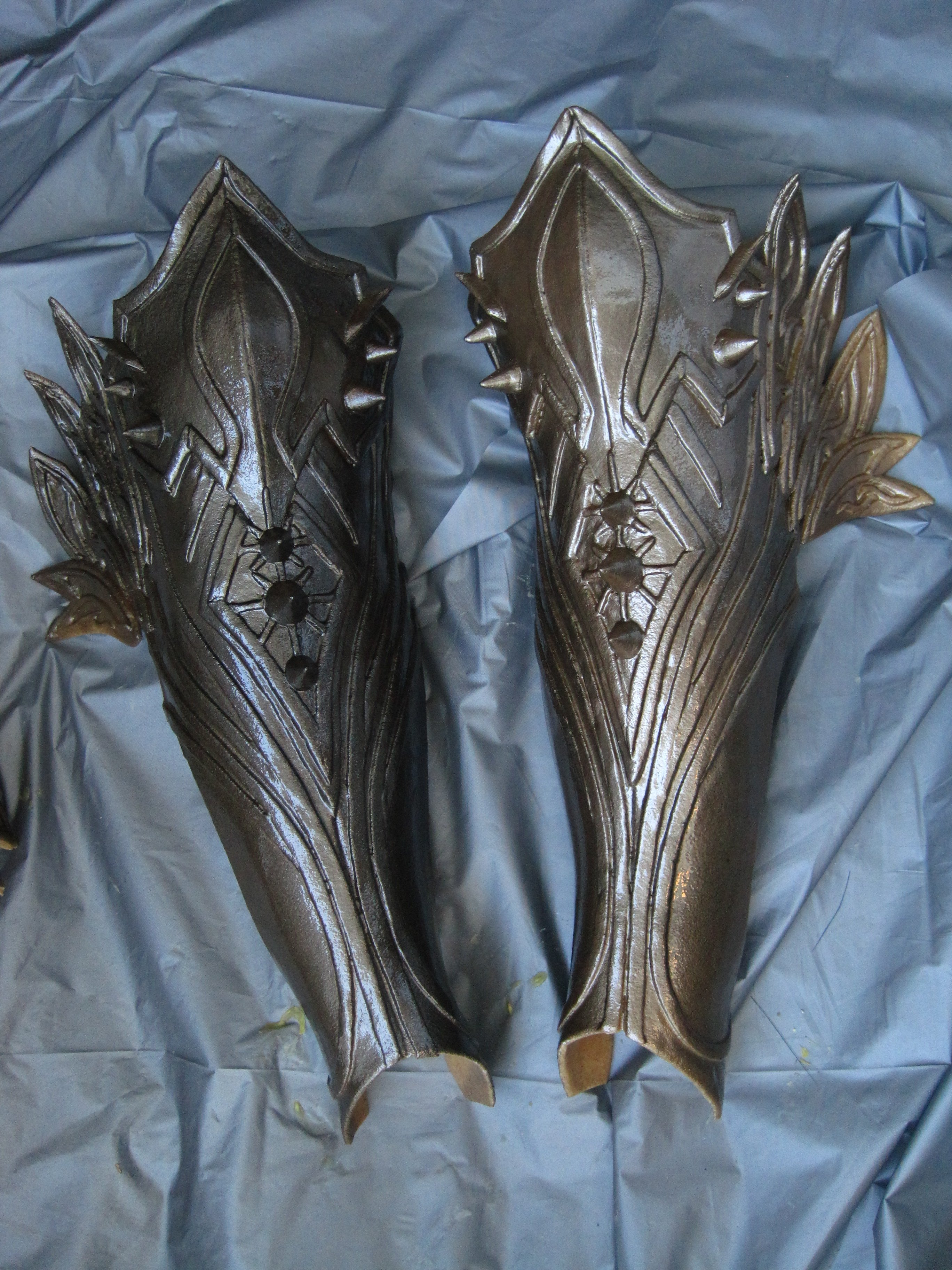

It looked great until, what the hell, the color changed!
Anybody use hammered paint and have this happen to them? I rattled the can more than enough, but apparently the results beg to differ! It'll work out fine, but I'm still a little annoyed. Hmm... I would like to use Volpin's technique of layering sponged-on metallic paint with weathering, which will hopefully brighten the darker pieces up.
Why yes I have. Check the manufacture date on your can's. If they aren't the same then there is your problem. I didn't even know they had that the paint guy at the Home Depot had to show me.
Eventhough it turned out different from what you intended,to me the result is still amazing,Spring :thumbsup
I hope you can find a solution for this situation.
I think they turned out awesome spring! If it were me, I would dry brush gold on the darker pieces in the areas where armor would be naturally highlighted, and call it a day.
I think this is going to turn out to be the best Hawkgirl costume ever.
Well, this was from the same can; color just changed mid-spray. I'm assuming I didn't thoroughly shake it, and the multi-colored hammered effect required a good mix.
Thank you! I'm really liking how it's (slowly) turning out! And I think I will just brush in some hightlights/weathering and not worry. Once the golden details and weathering are added, the difference in color between pieces won't even be noticeable.
Thanks everyone for the feedback!

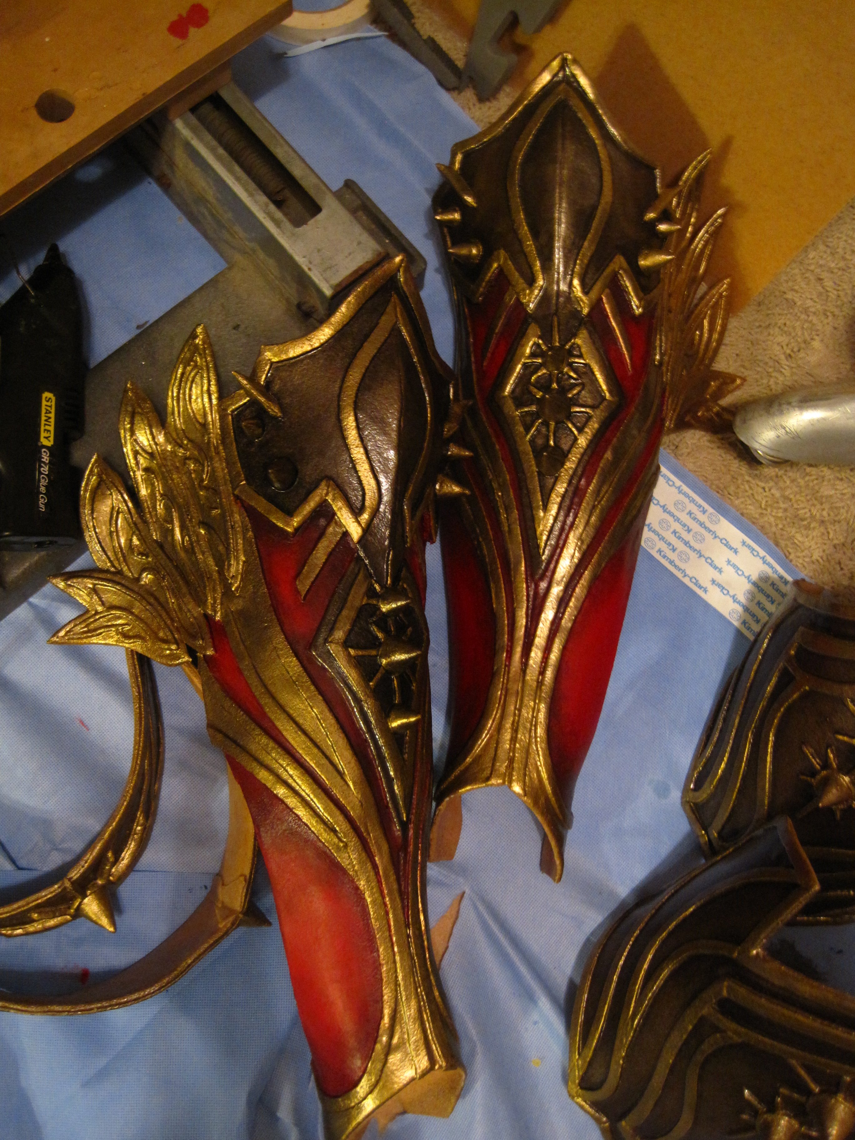

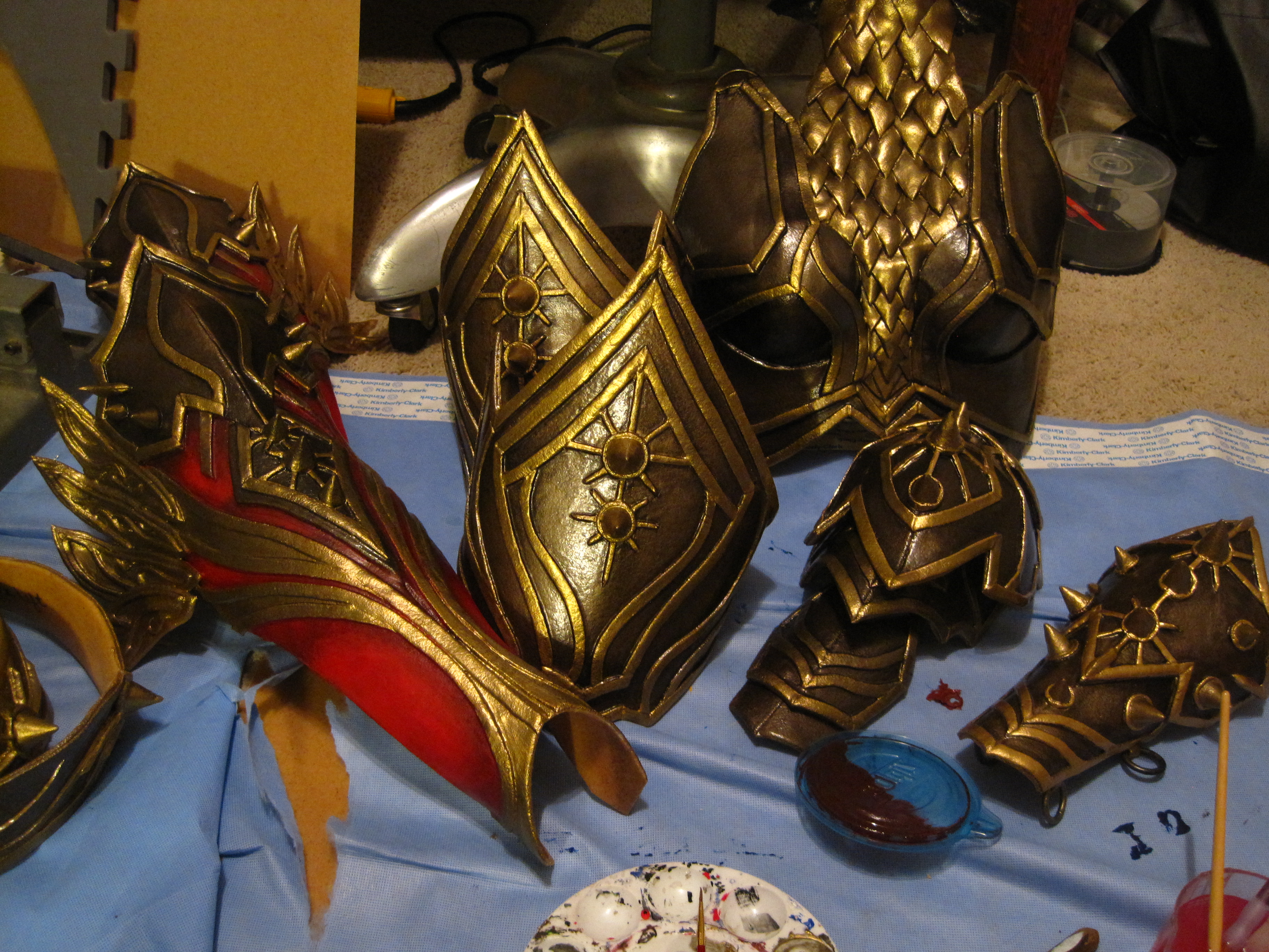

And yeah, no noticeable difference in paint color once the weathering was added. Today I painted up the details in gold acrylic, and plan to highlight the edges with some Testors gold enamel model paint - it's ultra-bright and super metallic, and really makes the edges crisp. I'm also planning on adding a glossy clear coat to the red on the leg armor, and the scales will likely be a metalic ochre yellow.

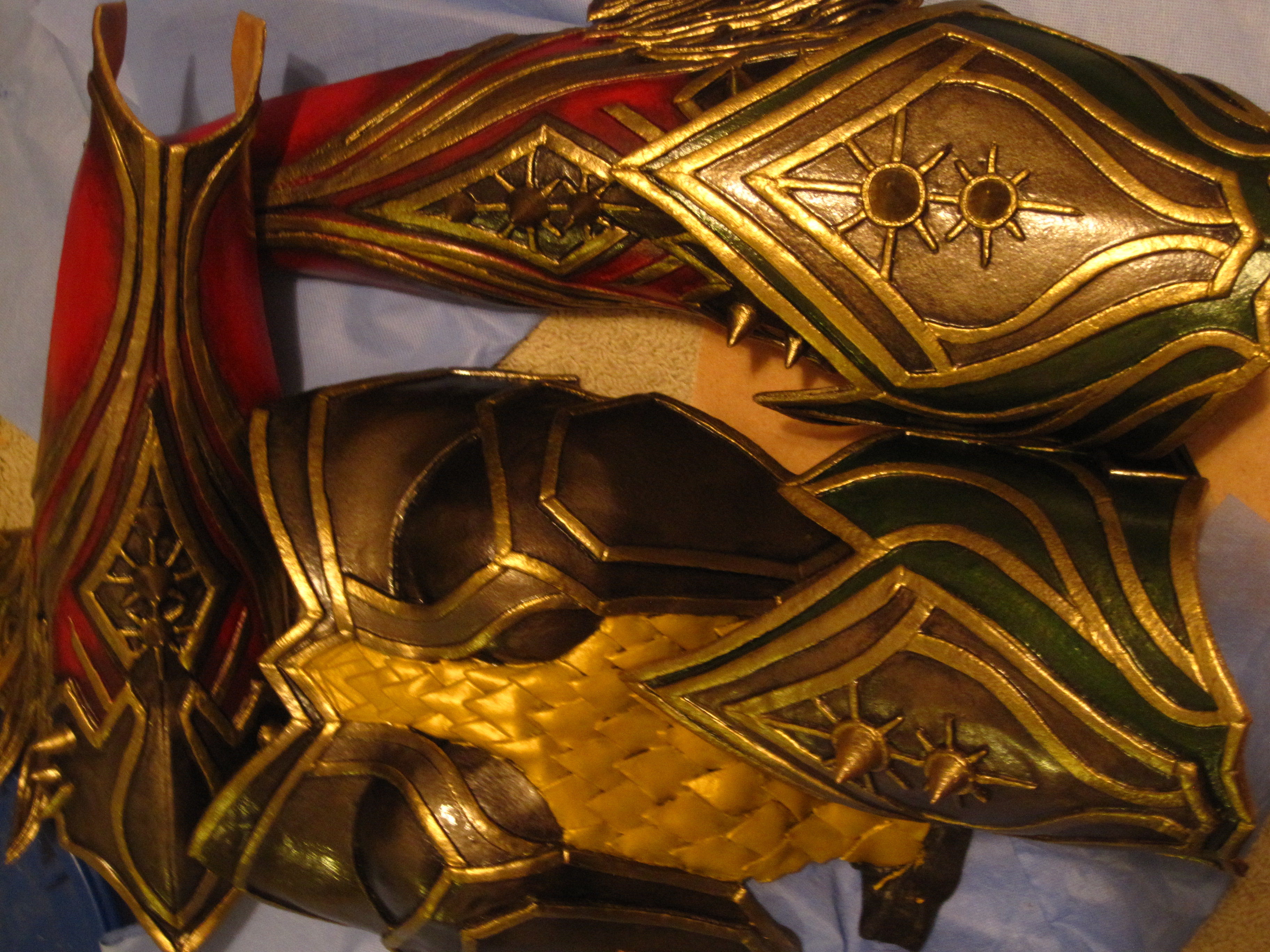

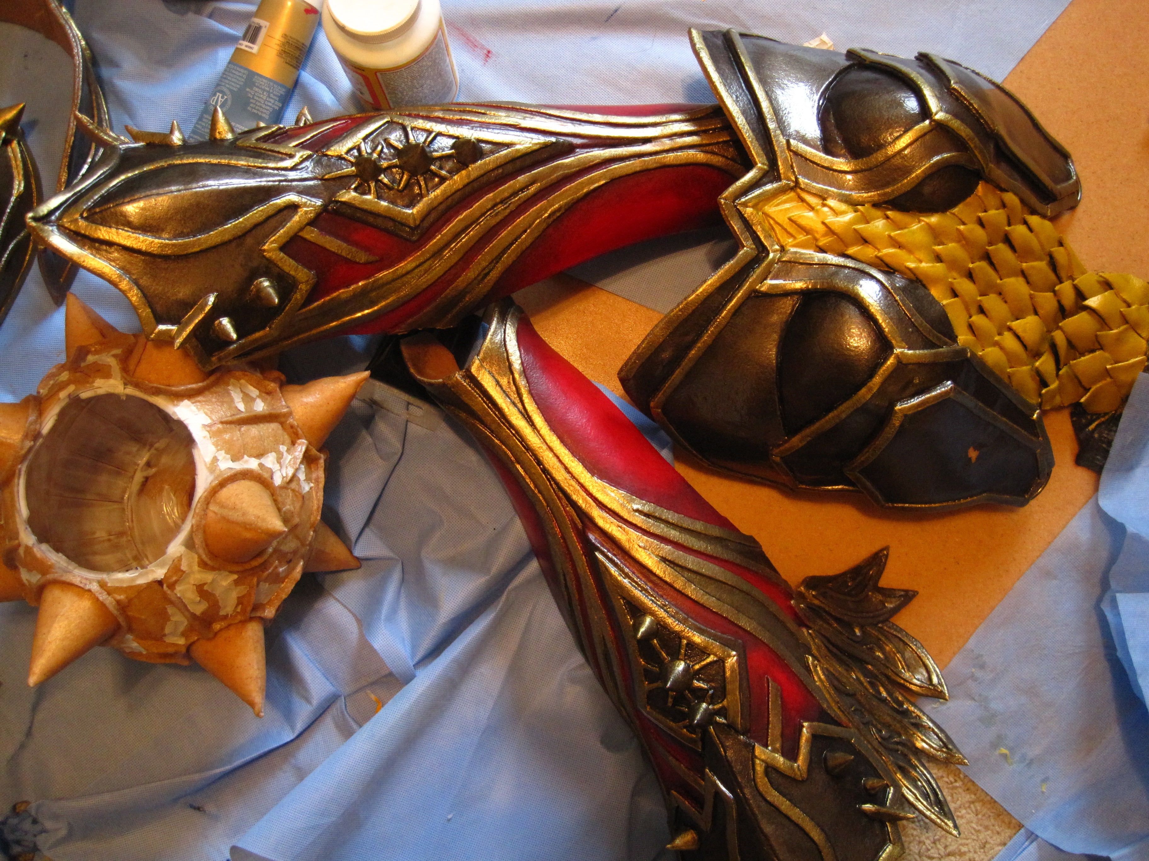

So today I added some extra details to the armor. As much as I liked the plain metallic look, I also wanted to incorporate Hawkgirl's classic colors into the mix. Once I've added in weathering and highlights, I'll coat the colored areas with several layers of clearcoat to give it an enamelled look. I did this with the flat red on the legs, and it looks so much better. I'm not convinced by the additions of yellow and green yet (both mixed with gold to add a bit of shine), but once the weathering goes on, they'll incorporate much better.

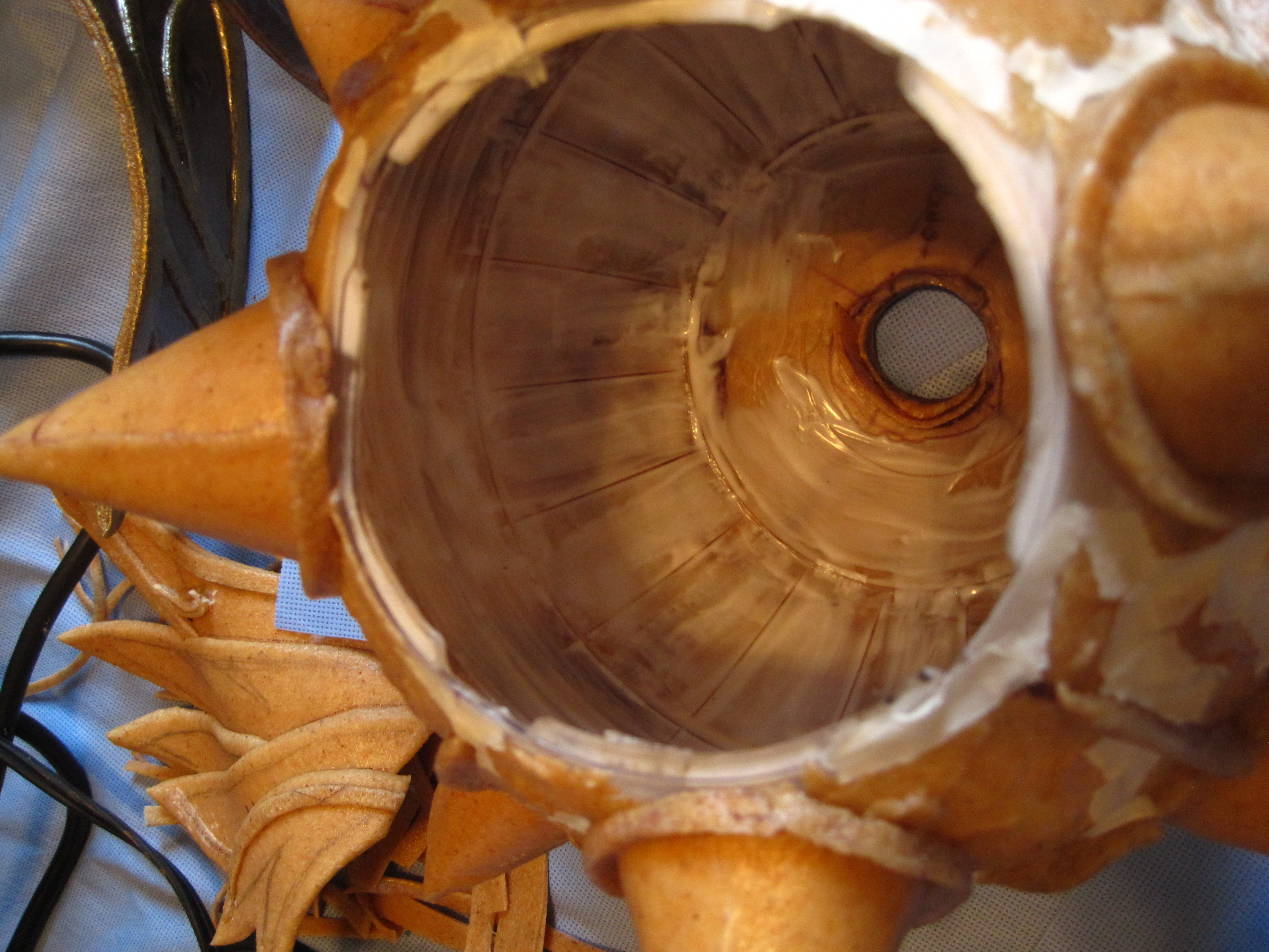

I also coated the interior of the mace with a cornstarch/glue slurry, to help diffuse the light inside. In hindsight, I wish that I'd sanded the exterior and interior of the ball to help with that. Another option would be to spray window frosting on the inside, but I'd really have no use for the rest of the can.
Once I receive my AMAZING high-powered star LED module from @Canobi, I'll rework the handle and stuff the globe with some organza or other sheer fabric to again help with light diffusion.
