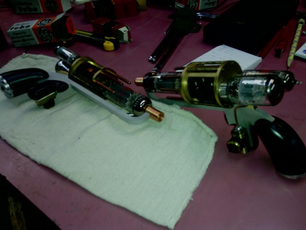

trying to figure out what tubes I should use for the back part. anyone got a good data base of physical sizes of vacuum tubes? I have looked far and wide but can't find one. or if you have recommendations for what tubes to use.

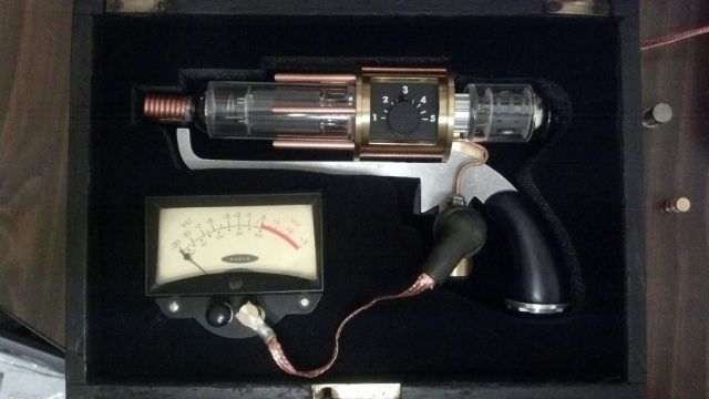

Almost there. I sent the box to My Case Builder and had foam cut nice and smooth. Good news for you is, I let them store the details so that if anyone else want's them to cut one, they have a template which should save you a bit of time and money.
The foam has a black velvet surface and I have used self-adhesive backed black felt on the sides and top of the box. Here it is with out the meter buttons and cable assembly. I'll post final shots when that's done.
Okay, this should about do it. The original has no actual lock mechanism. And I'm not completely satisfied with the black knob on the meter. I'd like to find one that matches. But for now:

For the main tube I found PL500 or PL504 tubes look great.
For the rear tubes a few would work. For the short fat tube on the left you could try a 5HA7 or a 6AG11 (I think that's what it says).
For the thinner one on the right try a 6CM7, a 8FQ7 or 8CG7.

Looks like they have just completely removed the lock from the box as you can see where it was, Maybe they had no key for it or it was removed when they found the box. I was told by a friend that he has seen them sold as "tea boxes" used to hold a selection of fine teas.
As for the black screws I'm still looking for where I put them. Obviously I put them away too carefully.
Looks like they have just ompletely reoved the lock from the box as you can see where it was, Maybe they had no key for it or it was removed when they found the box. I was told by a friend that he has seen them sold as "tea boxes" used to hold a selection of fine teas.
Actually, Artie uses a key to "open" it in ep. 1. They are all simple skeleton keys, so any one that fits in would open that kind of lock. But, yes, they did remove the lock mechanism inside. Guess no one was supposed to notice that. I"m still hoping to find the correct black knob for next to the binding post on the VU meter
Two quick questions: Are people removing the lettering from their vacuum tubes (GE is bad but "Marconi" seems really inappropriate on a gun made by Tesla!)? If so, how are they removing these letters? Goof Off doesn't work, that's for sure!
Second, what are people using to glue the base of the glass tube to the aluminum or brass? Hot glue? Epoxy?

Those valves aren't really suitable as they have a heavy plastic base on them. Better off with a PL500 which Tesla does make as well.
Use a Tesla one and keep the printing on it or just shave/scrape it off with a razor blade or very sharp knife edge. Comes right off.
You could just use silicon sealant. That way you can get it back off if it breaks or needs removing for some other reason. On the rear ones you could also use foil tape stuck around the pins and aluminium parts they sit on. Of course if you never want to remove it a bit of epoxy will work.
Mine all came off quite easily with a strong alcohol like nail polish remover. That on a Q-Tip works like a charm.
Yup - just pointing out that Tesla is actually a brand, and it would be a neat twist to actually have that on it as an original detail.
