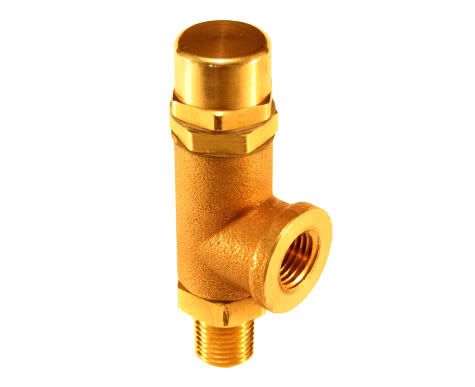

Look up "Thermocouple gas control valve". I've seen several "close" ones, but can't find an exact match yet.
Remember that the valve used might not have looked exactly like it ended up. It might have had a bit cut/ground off one end or side. The "tap" part might have come out of one end or the middle. There seems to be both types from what I've seen online.
Have we ever seen the "top" and "bottom" of this valve properly? It might have a plug in both ends and one in the side port, and a a reducer in the top plug.
Maybe if this gas pressure relief valve would work. Unscrew the threaded parts with the hex heads and then grind off the flanges from the holes and add appropriate plugs.
I found the picture completely out of context so I'm not sure if small like gas fittings or bigger like water pipe fittings. I have sent the appropriate part of the Tesla picture that shows this bit up close to a couple of friends who might know someone who does gas fitting or something similar. It's all foreign to me as I was an electrician.
