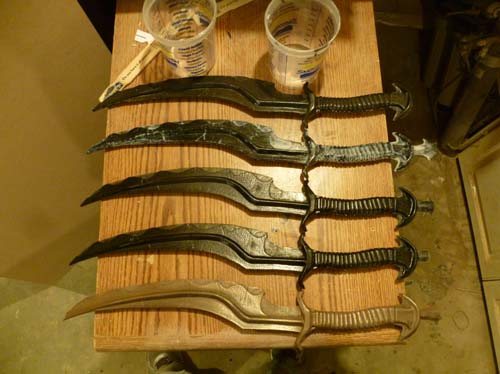

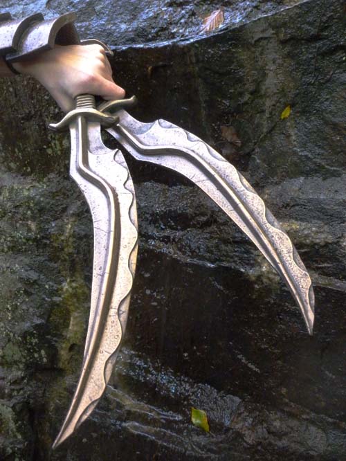

Daggers
The original dagger was 1/4" MDF, 3/4" plywood, plastic and body filler scaled from an in game image to about 22" overall length. I couldn't find any profile images, so guessed at the depths. I then created a mold and cast it. This was my first time making a mold and I made a few mistakes, the main one was not using mold release between the silicone rubber pours. After fixing that, I cold cast the pair of daggers and added weathering. I've made a lot of daggers since then (I just can't stop!).
I used Mold Max 10 and Smoothcast 325, dusting the mold with bronze powder. For the in depth process, check out my blog post.

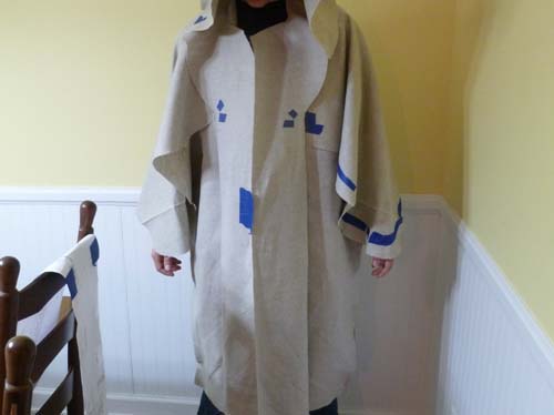

Robe
I used a linen material, basing the pattern on in game images. I started with what was in essence a sleeveless dress with a zipper down the front. I then sewed the cape to that. The hood and strip down the front that covers the zipper is a separate piece. I dyed it wine and then black to approximate the in-game color. It still came out a little light.

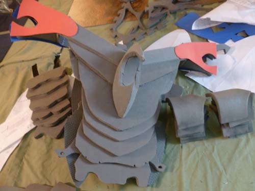

Armor
The armor and bracers are EVA foam. I approximated the size of the armor. From the waist down the plates are rigged with nylon strapping so they can flex. I used elastic banding for the bracers.
