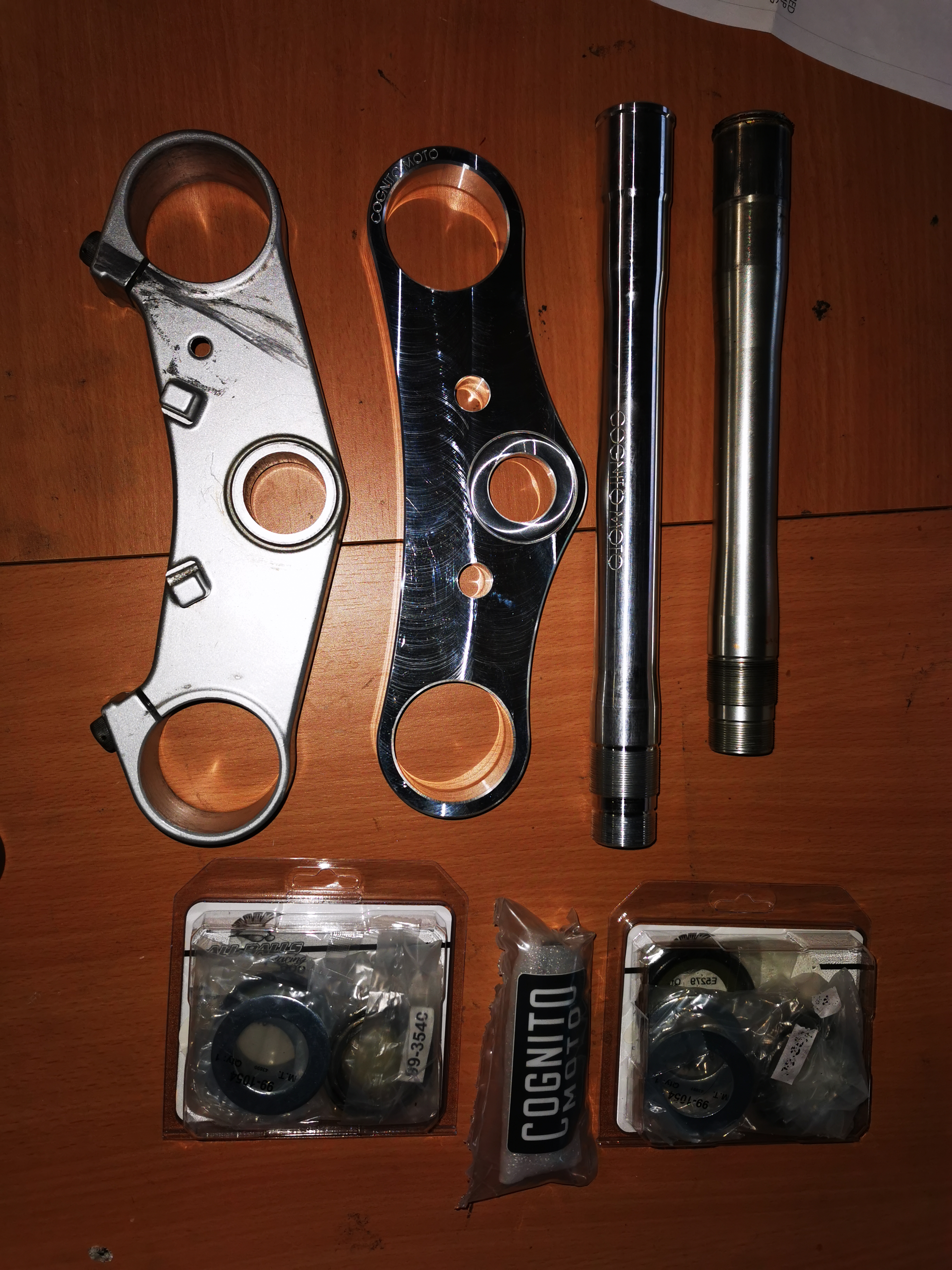

For the R6 front end conversion, is it correct to say that normally we would send out our Nighthawk lower and stem and the R6 upper clamp to Classified Moto, CM would do their magic and send it back...but because they are incommunicado right now, a work around would be:
Have a local shop press out the stem from the Yamaha lower, and replace it with a stem conversion from cognitomoto: STEM CONVERSION
and then buy the upper triple clamp from CM?UPPER TRIPLE CLAMP
Would that work?

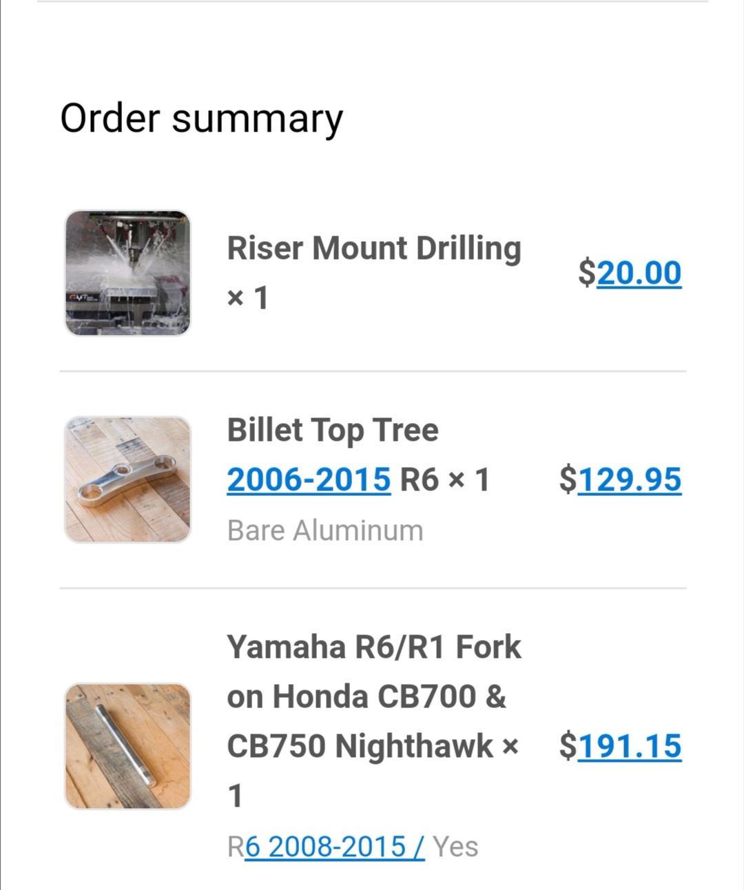

I bought my parts from cognito Moto. Very fast service.
If you already have the lower yoke from the r6/R1, press the original stem out then press the longer stem in .
You'll need a new top yoke for riser mounts.
You can either drill the riser holes or select it on the website.
See my order.... It included the new bearings in the stem price.
Thank you. Sent them an e-mail.
Wow, they were super fast, had an order in within 5 minutes. Of course, I'd prefer the real thing...but lack of communication during this pandemic is a barrier. :)

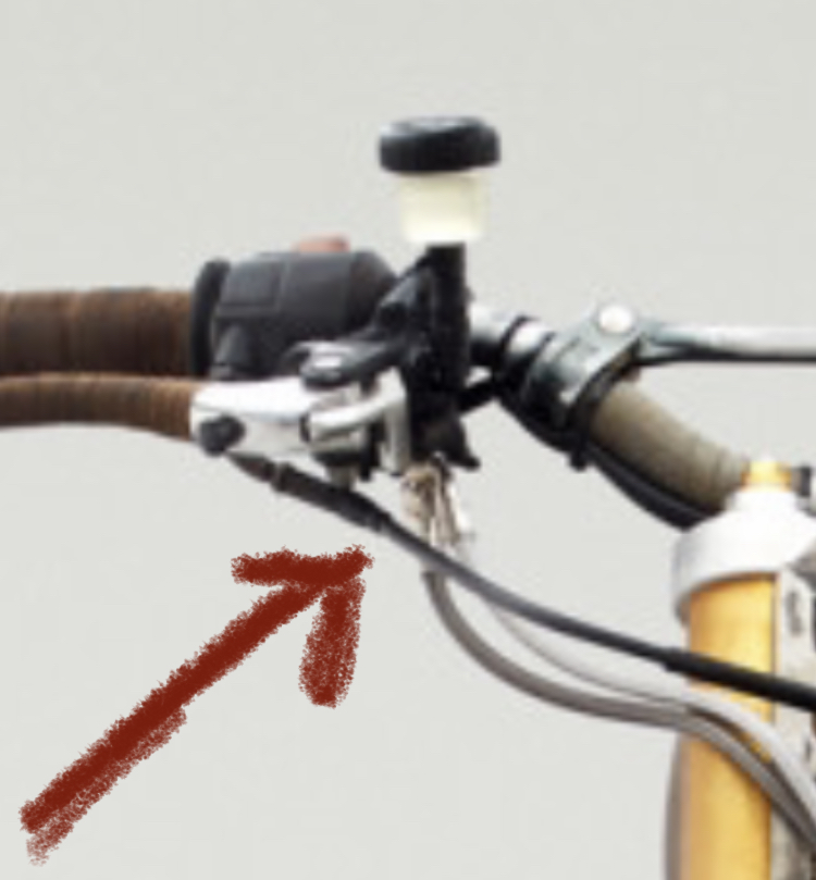

But one dumb question, how are the two lines connected at the top?

Ok guys last dumb question (until tomorrow, lol). I pressed out and then pressed in the new stem from Cognito Moto... then I realized there was a retaining ring on the old stem. Was that supposed to go on the new conversion stem? I don’t remember a groove for this- could have been there, but I don’t want to press it out again if I don’t have to....sigh. Sorry guys.
Are you meaning the spring clip on the very bottom of the original stem or the interference fit washer under the bearing? I didn't reuse that washer. There's a diagram with the kit.. I used one of the new thick washers under the bearing to space it to clear the frame headset tube

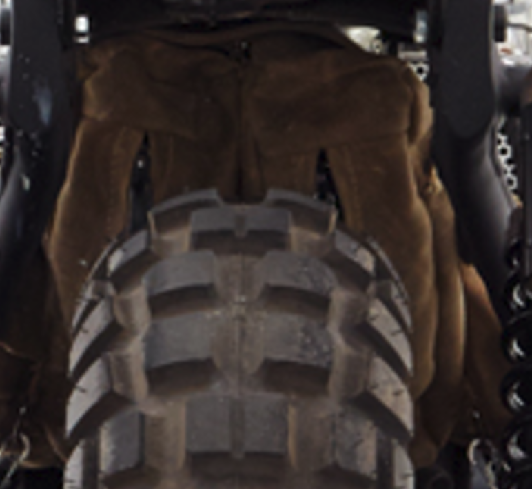

OK, guys. We are not doing a full carry bag, right? RIGHT? ;) At least for the scene in Season 6, Episode 6, the bag looks more Olive drab than tan, is constructed like a saddlebag and has a weird zipper on the bottom of each bag. Plus the strap, and what looks like a wire handle.
