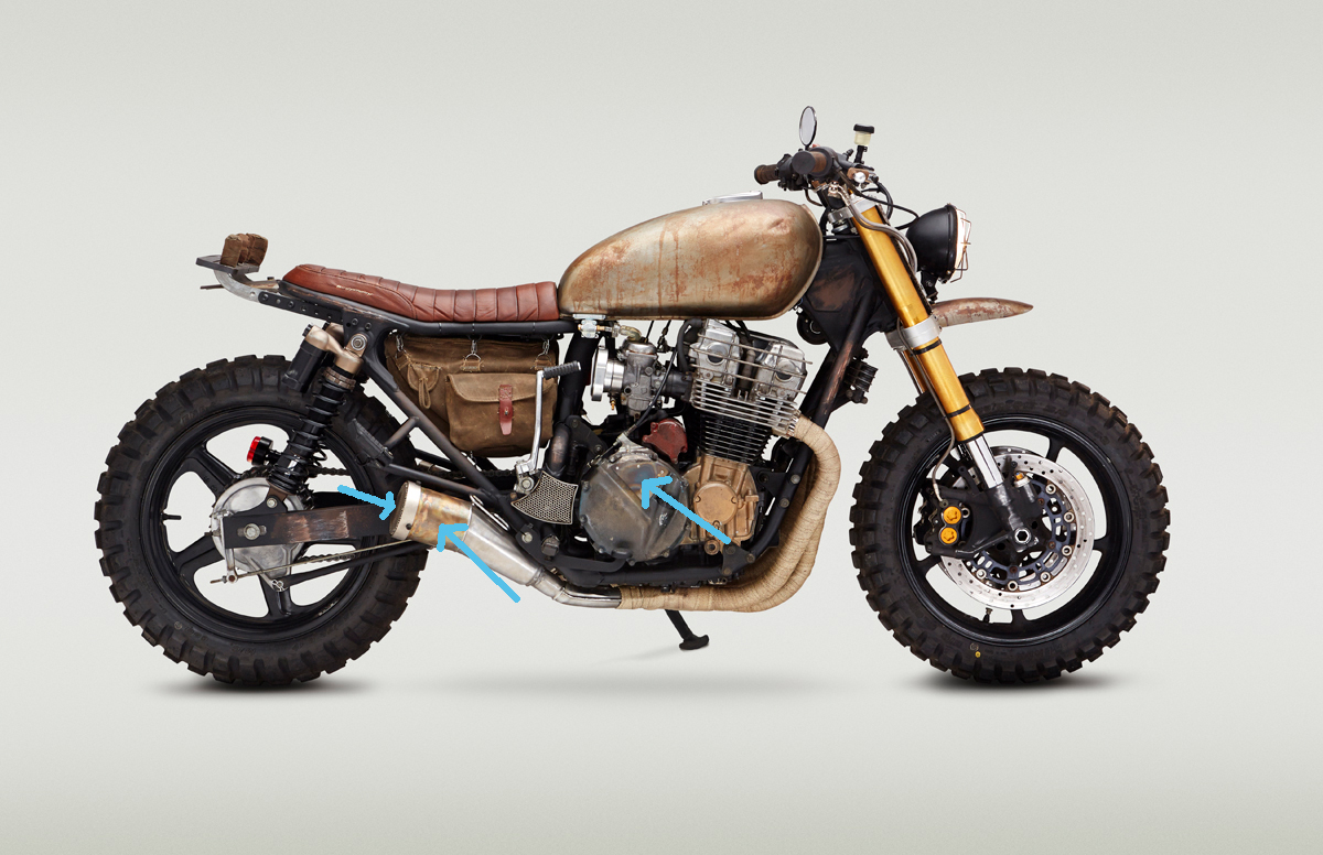

Also, I used to make knives, and I can tell you, on the brass plate on the engine, the perforated screen on the muffler, etc. it looks like the coloring was done with a torch...and then clear coated. Does anyone know how the "repair plate" is attached to the engine cover?

The engine cover plate is attached 2 ways. First it is welded to the clutch cable bracket, then riveted to the cover.

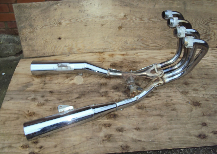

Sorry to bring up an old post. I recently *finished* my build however I plan on adding an R6 front end. I’ve just purchased a full exhaust system, which don’t normally pop up in the U.K., my question is, who is running straight through? My bike is already running the RAMAIR setup and straight through generic stubby exhausts, so I imagine it’s a case of chopping the new exhaust and removing the baffles? Thankyou in advance.
Mine is straight through as you call it. I have the pods and an open exhaust (baffles removed). Just needed a jet kit and some shims and she runs great.

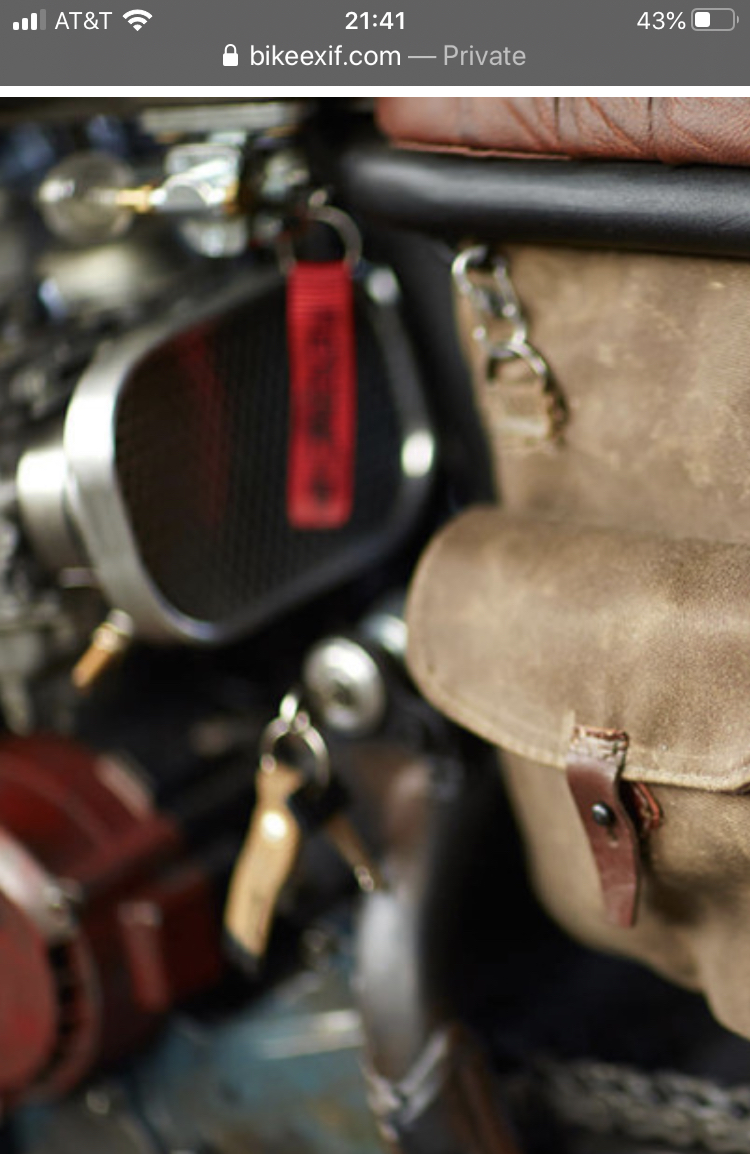

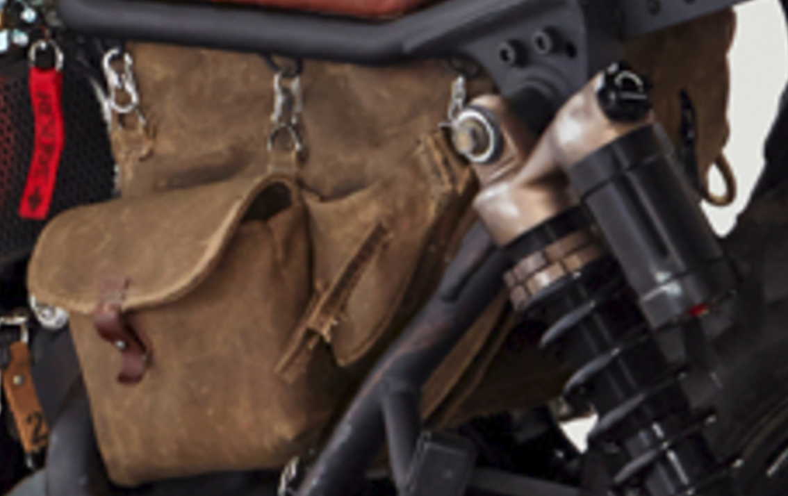

does anyone know what this red tag is?
Its a piece of red webbed material attached to a key ring, that is connected to the petcock. It says Reserve with a downward facing arrow written in what looks like black sharpie. Pretty sure there is a clearer shot of it on one of these pages.

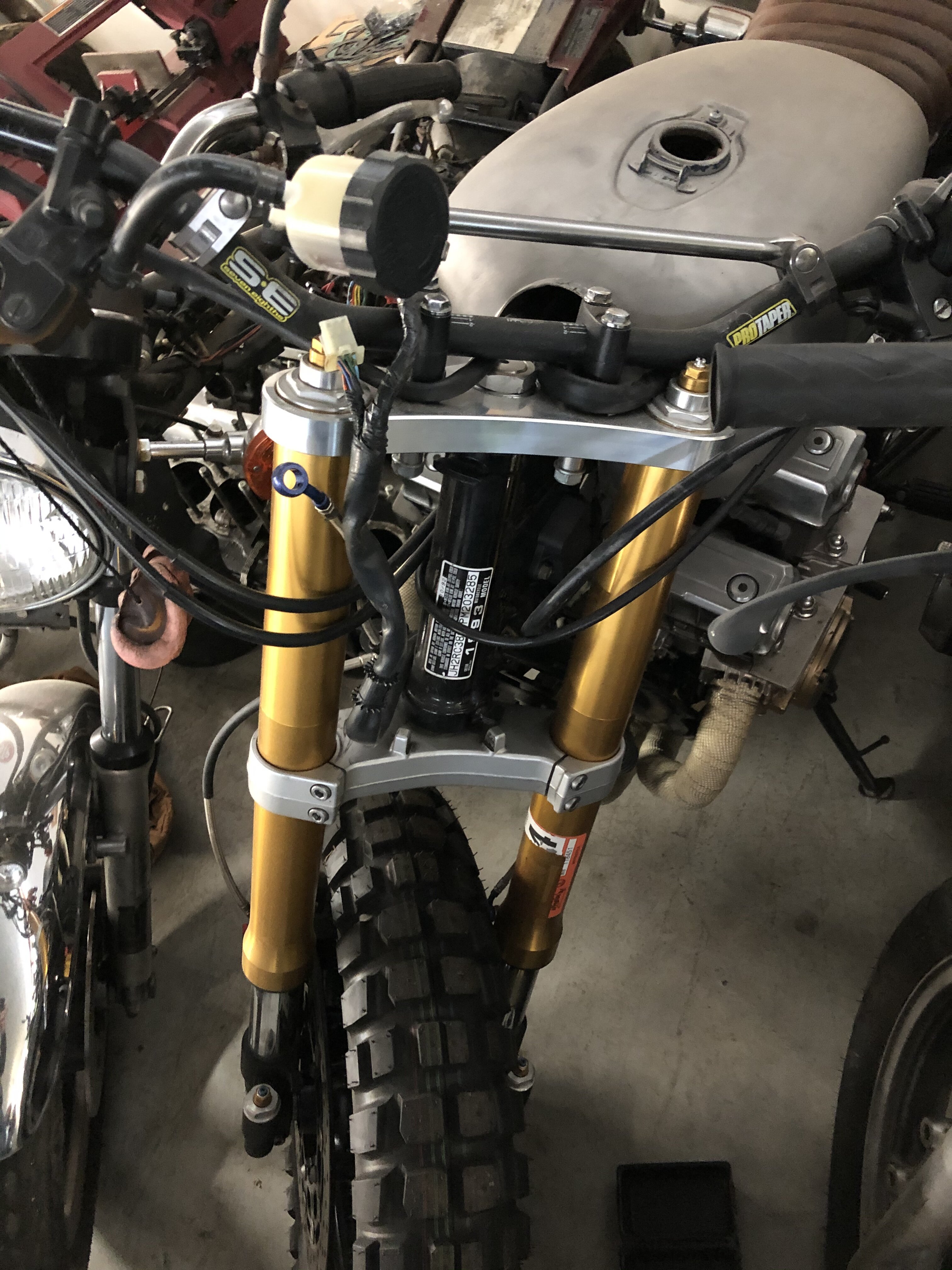

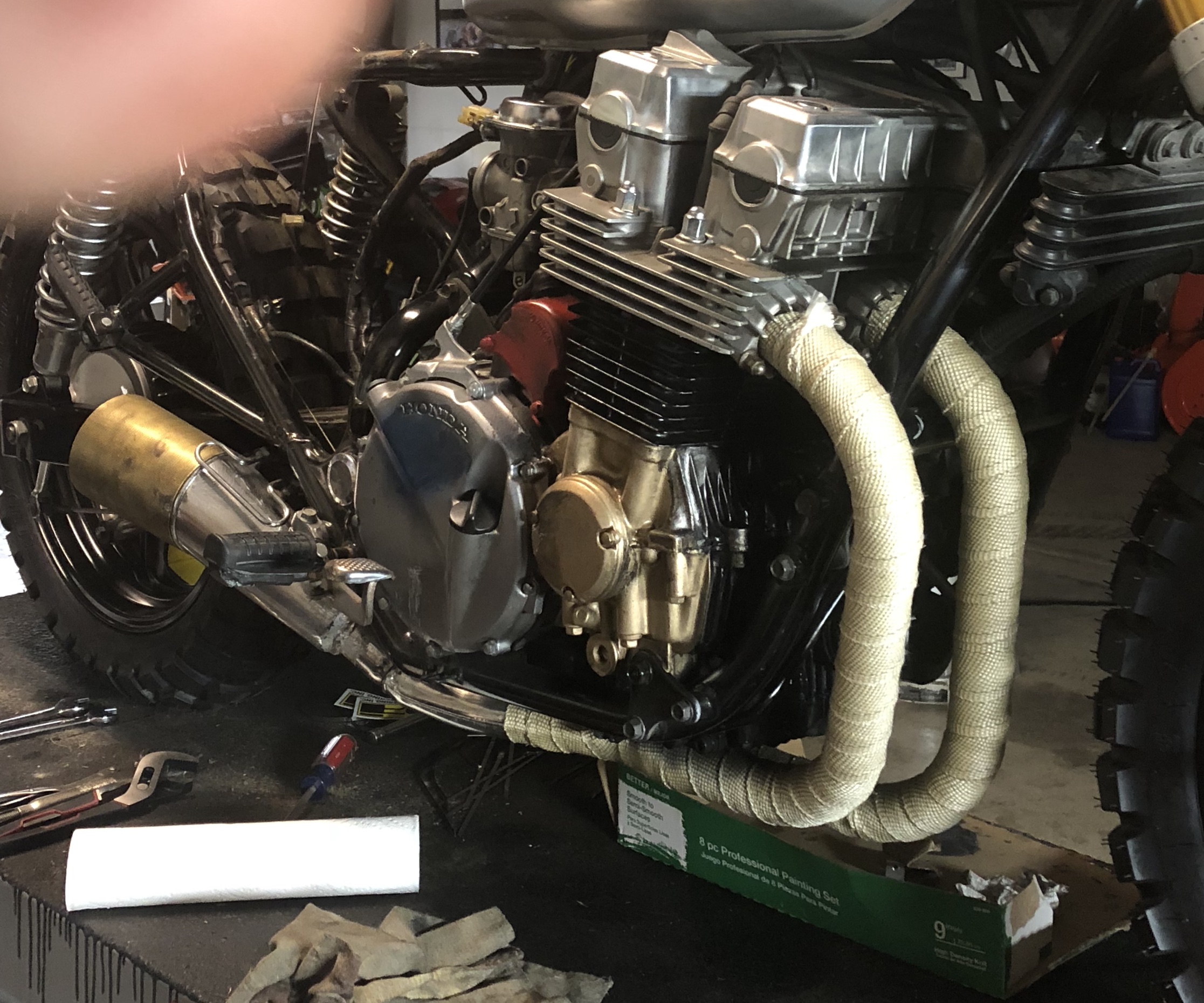

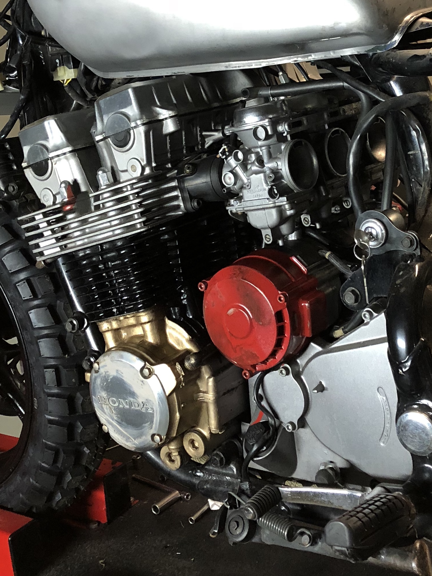

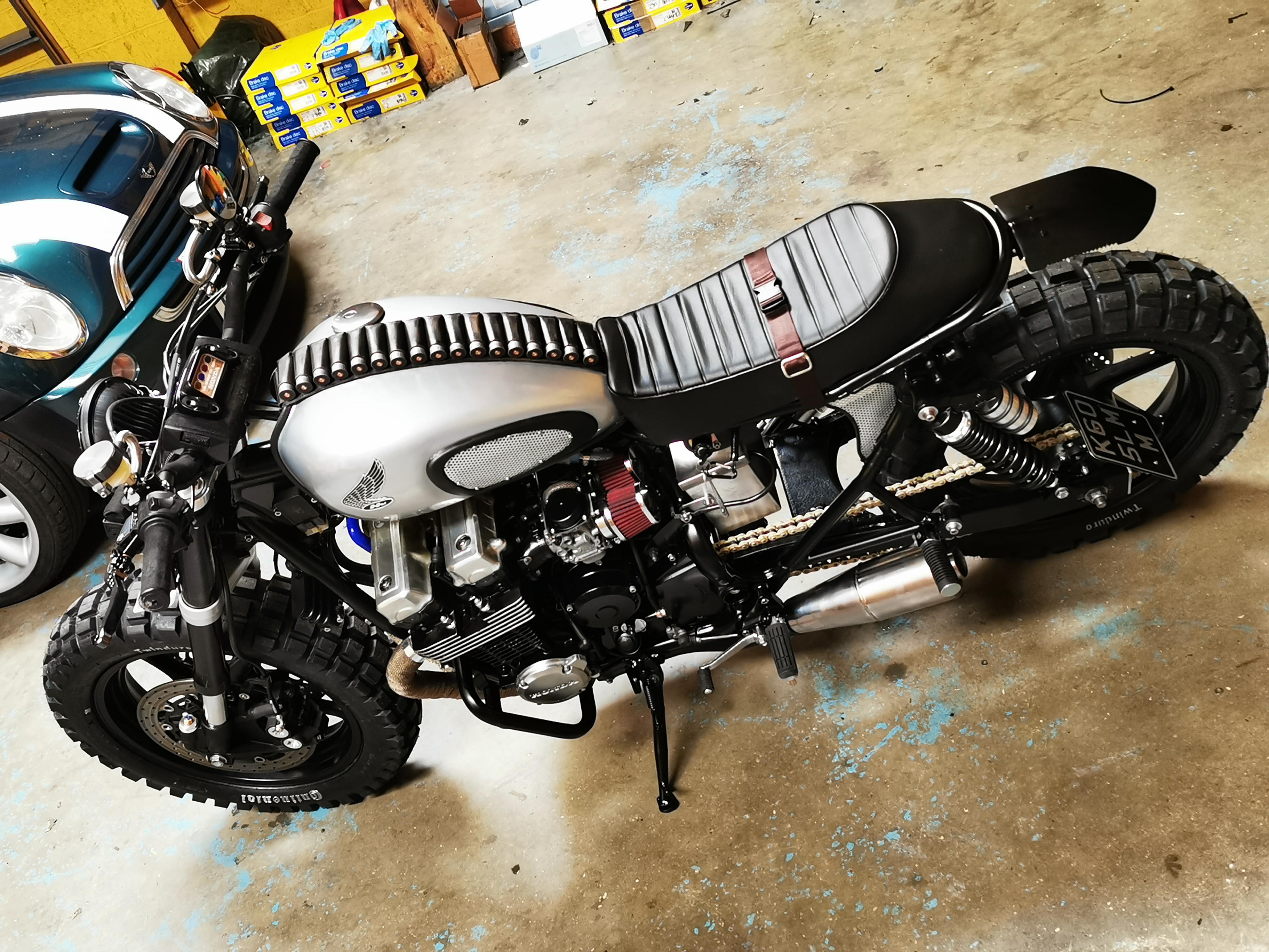

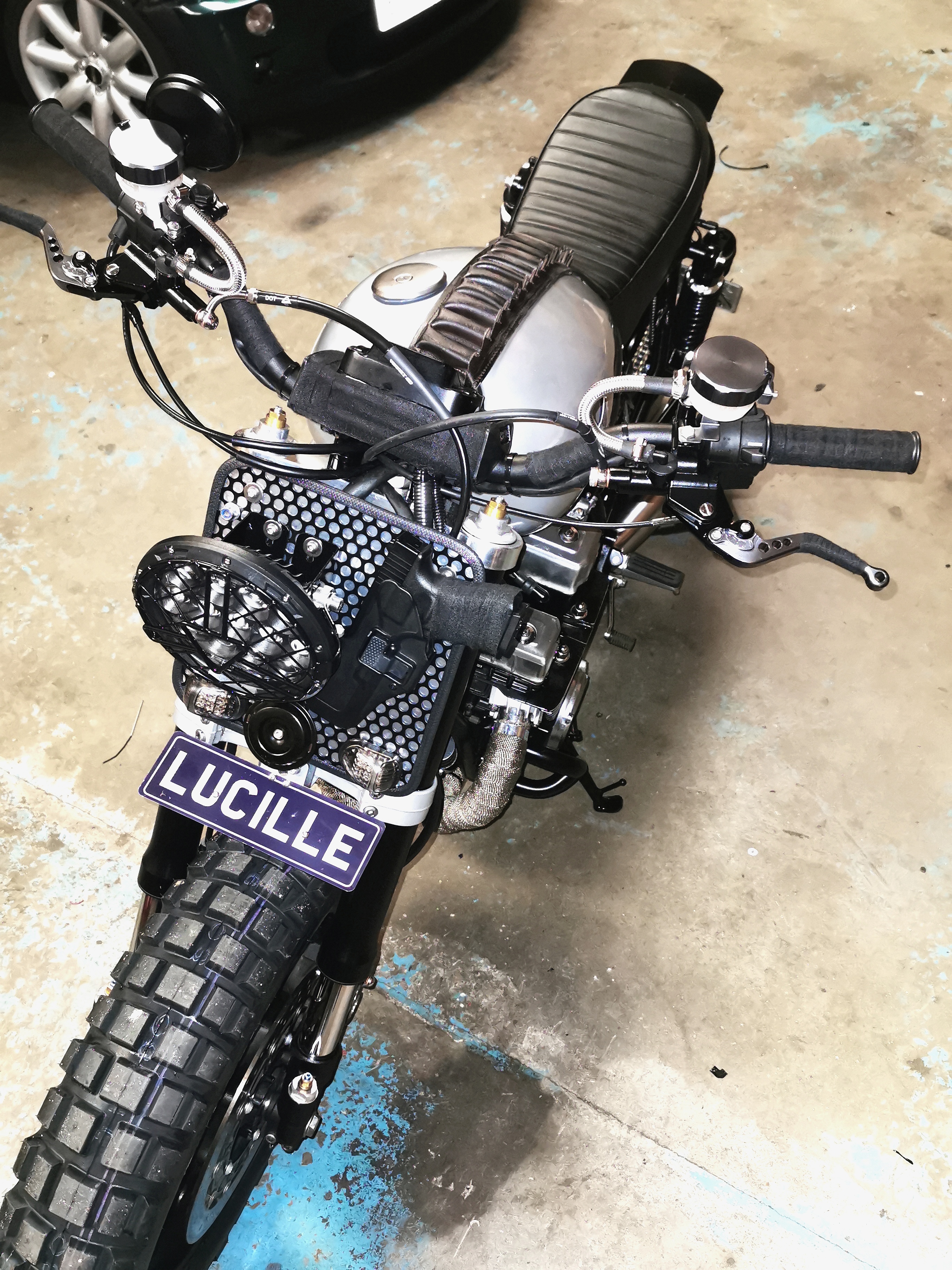

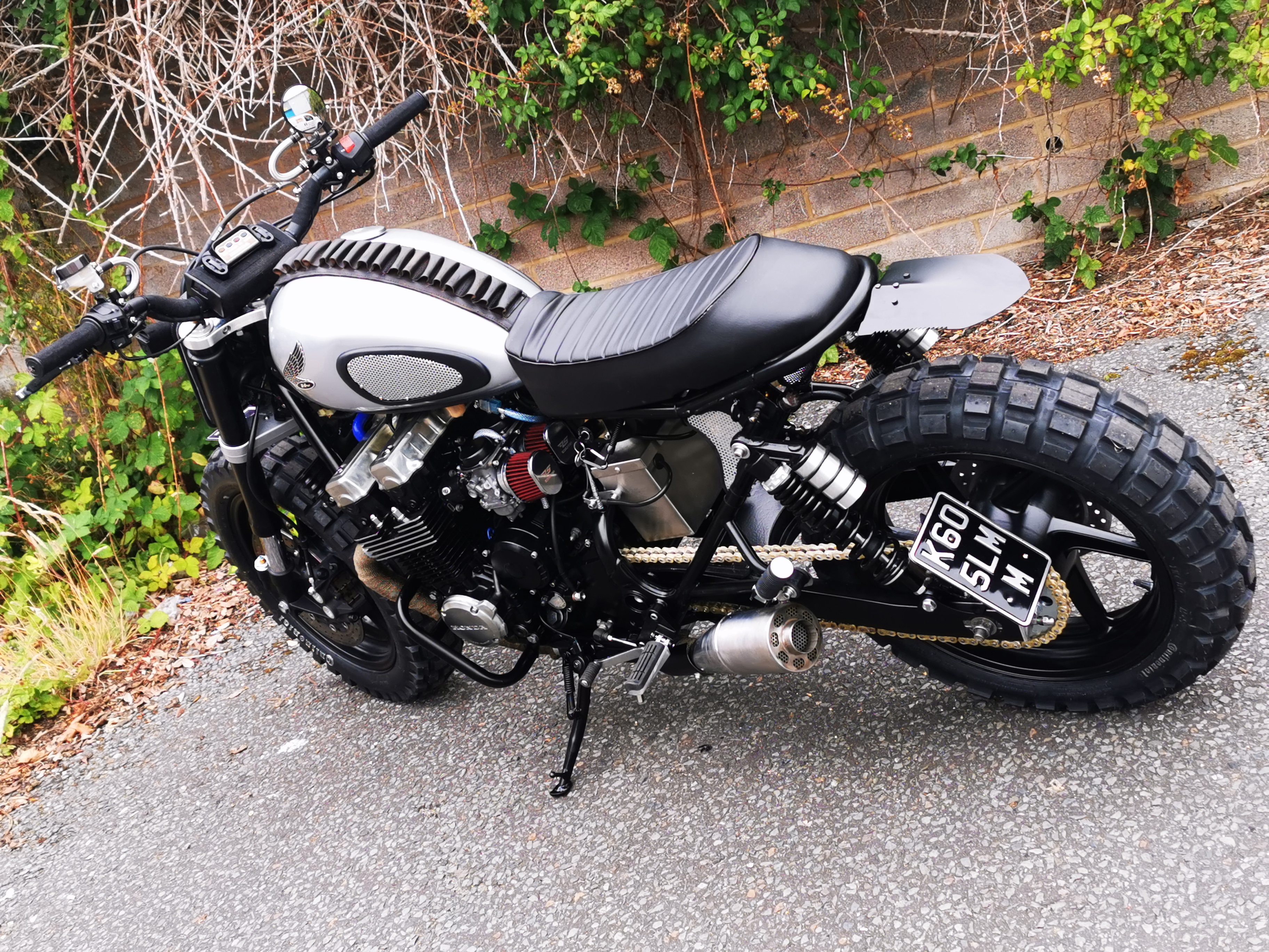

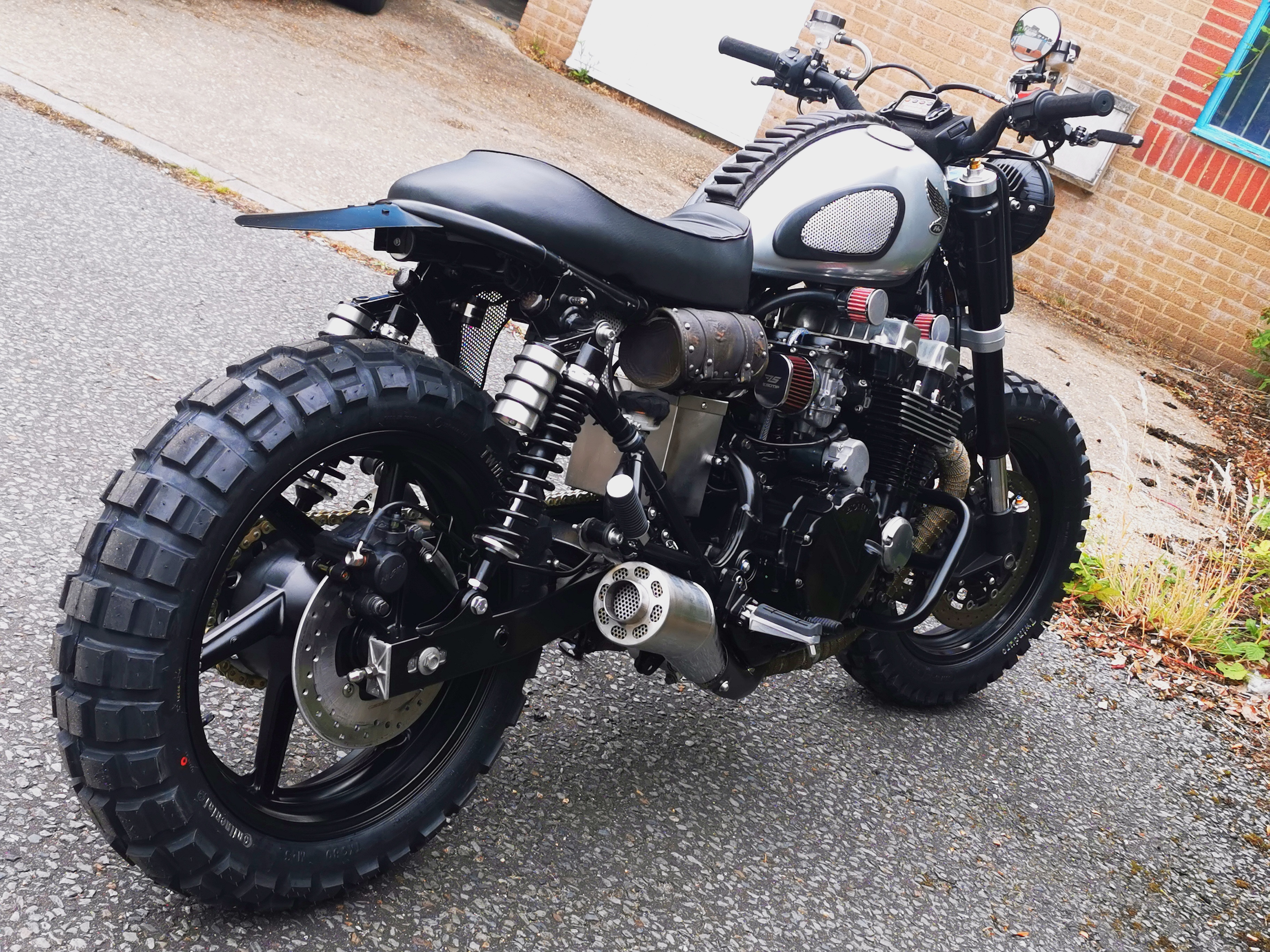

I've just finished my apocalypse themed CB750 (seven fifty) 1992.
I knew nothing about the bikes, bought a frame and rear wheel in February and went from there.
Going to make a front fender next but needs to look right.
Got some inspiration from the guys on here.
My engine is a late import 2007 Rc17E with hydraulic clutch.... Similar to the CBX but this is 5 speed.
I used a R1 front end.
Features usable/removable shovel rear fender.
Glock 17/19 holster that you can easily access when riding (left handed!)
Shotgun bandolier on the fuel tank.
Modified standard exhaust, sounds so good!
Continental tkc80 twinduro tyres.
Pro taper contour fat bars.

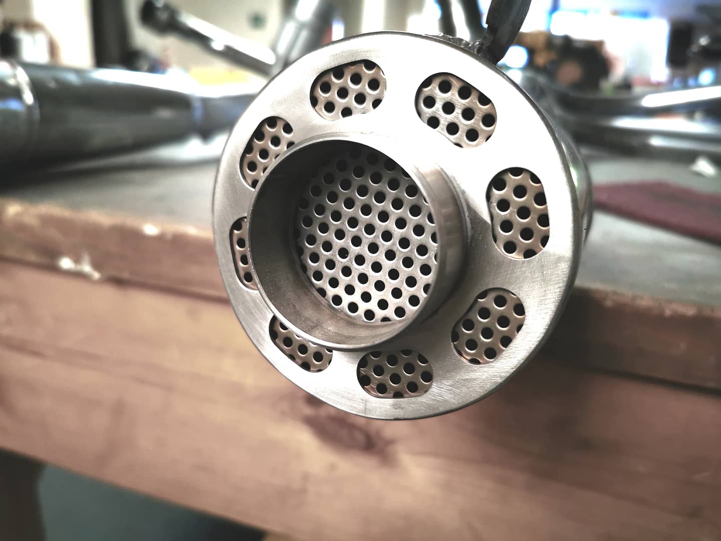

Cut it just behind the rear baffle plate. There's a pre-muffler in the tapered parts anyway. Don't need to bother with baffles. Watch my video with the sound clip

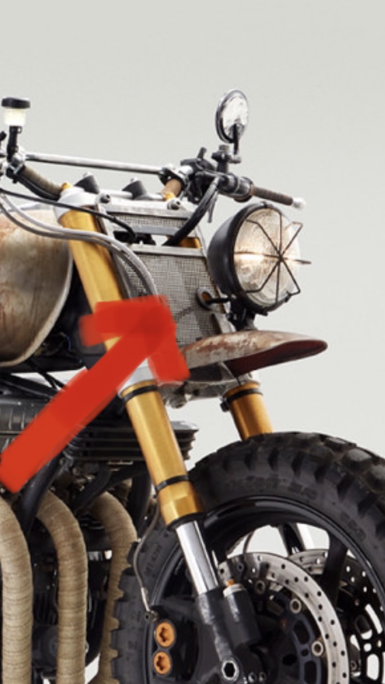

Can anyone tell me the dimensions of the custom front grill?/headlight mount perforated plate thingy? I don’t have the front end yet...and I have time to make this. Thank you in advance ! I am trying to do my own homework (I’ve read this entire thread 5 times lol), believe it or not. :)
