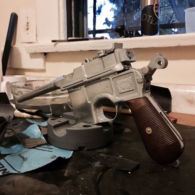

They have risen!
I got a bug up my butt to put these back together. I was so heartbroken when they were initially melted down that I didn't even want to look at them. But here they are back from the dead! Ugly as hell, but... dare I say maybe salvageable? The only thing flat out broken is the screw that holds the trigger spring in place. Those threads are just gone. Totally dissolved. If I tap them for a slightly larger screw, though, I think I can get this workin. The biggest bummers are that some of the parts are scarred beyond anything some filler is gonna fix. But it's like... doable. I dunno, I'm somewhat encouraged by all this lol. My ugly ass zombie MGCs.
So they're a little pitted... maybe it's sacrilege to some, but I'd hit them with satin or matte black and I bet they'd look fine.
I kinda took the least destroyed parts and put them into one, while the other got the left-overs. The rear leaf-sights are the worst. They're wrecked, and totally illegible. I have some real Mauser spare parts that I could always retrofit, though. I'm gonna do a clean up pass on these parts, and see where that leaves me. Smooth out some stuff... sharpen some edges back up... I dunno, could be ok. Definitely for a custom at the very least.

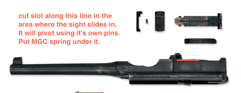

The rear leaf sight can be replaced, which I did on 1 pistol I had.
The bolt can be swapped w/ a real one if you don't care about it working.
Did you modify the sight? I was trying last night and couldn't see an easy way since the MGC uses a roll pin to, vs. the real sight having lugs on the part itself.
I used a complete rear leaf sight.
It is held in place by a piece of spring steel. That it exerts too much force on the die cast metal. Use the tiny spring that came w/ the MGC.
You will need to cut a slot on the inside area where the sight locks up w/ that hole. The slot will be parallel to the body of the pistol. Now you can slide the rear leaf sight from the rear of the pistol to the front of the pistol, and the holes where the MGC pin went is where the pins on the steel sight will go.
Look at the photo and cut the groove along this line.
When you have a sight in hand and your MGC broomhandle w/o it's sight, looking at the two will explain it more clearly.
No this makes sense. When I was messing around last night that's what I was thinking of doing, but I was curious if there was another way. Thanks dude!
This is gonna take a lot of elbow grease. :facepalm First rough whack at cleaning up one of these things.
