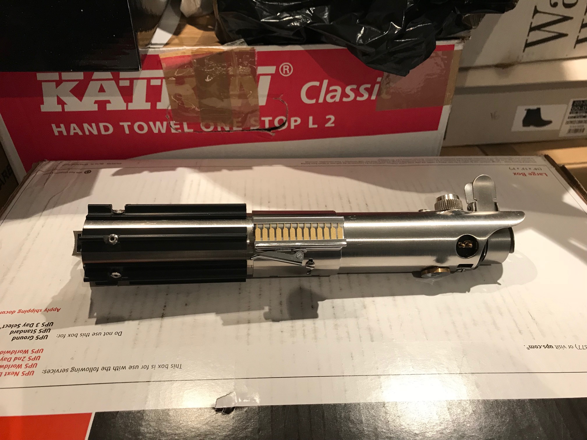

Thanks to mgoob's idea, I tried some indoor 3M double sided tape I usually use to install Led strips...
I would definitely recommend this. In my opinion it holds up as good as the 2K epoxy I tried first, without the fear you might have using permanent glue on a vintage Graflex. :rolleyes
This way you can easily correct the position of single grips until you reach something you like. First thought about redoing it when my new glue arrives, but I will probably stay with this technique. I used a 3D printed tool for getting the positions right, will upload this to thingiverse after some corrections in CAD... There is also one on shapeways if you don't want to do your own - this really helped me.
Quite happy with the result. So thanks Roy for selling these beautiful parts. :)

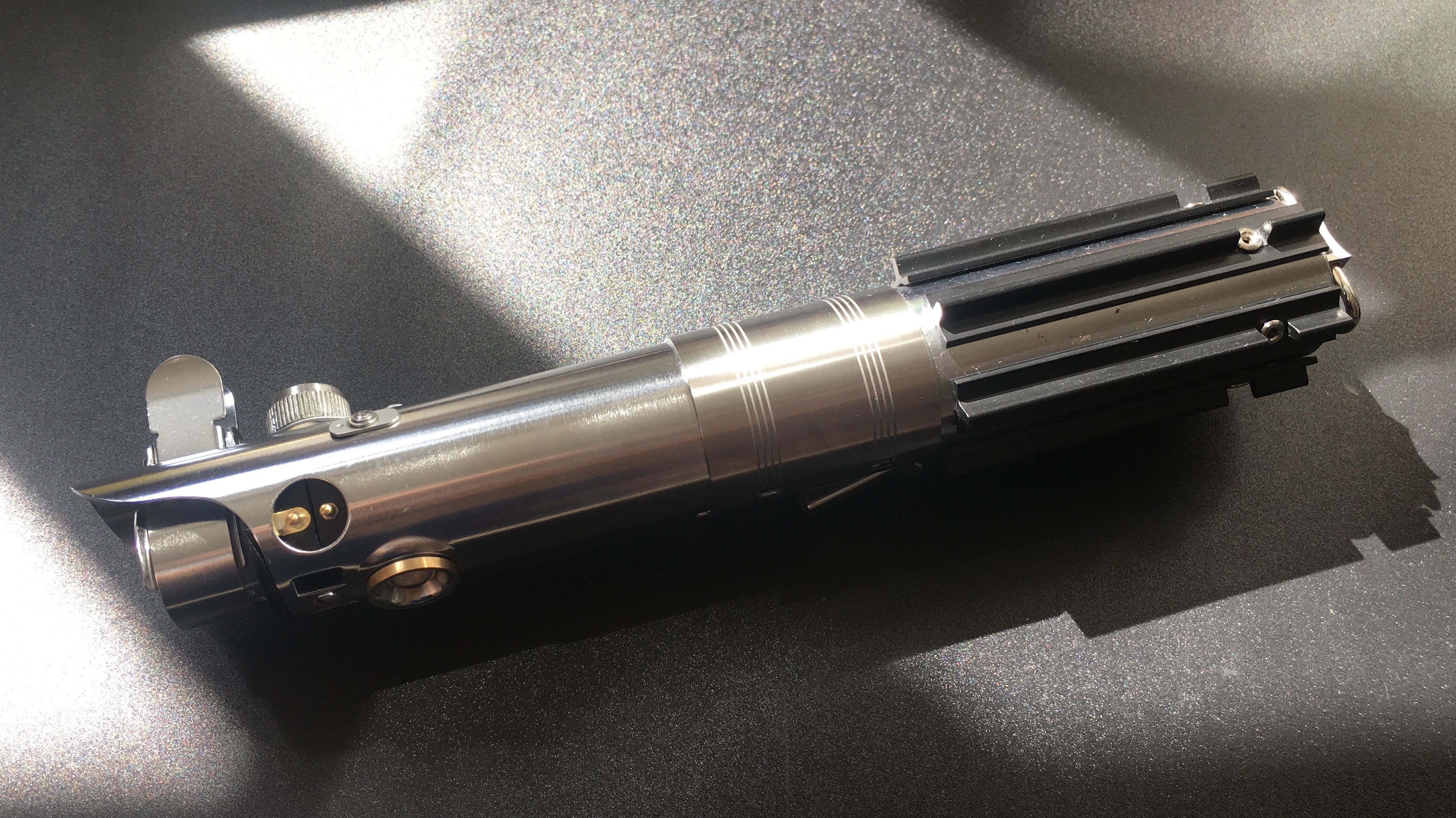

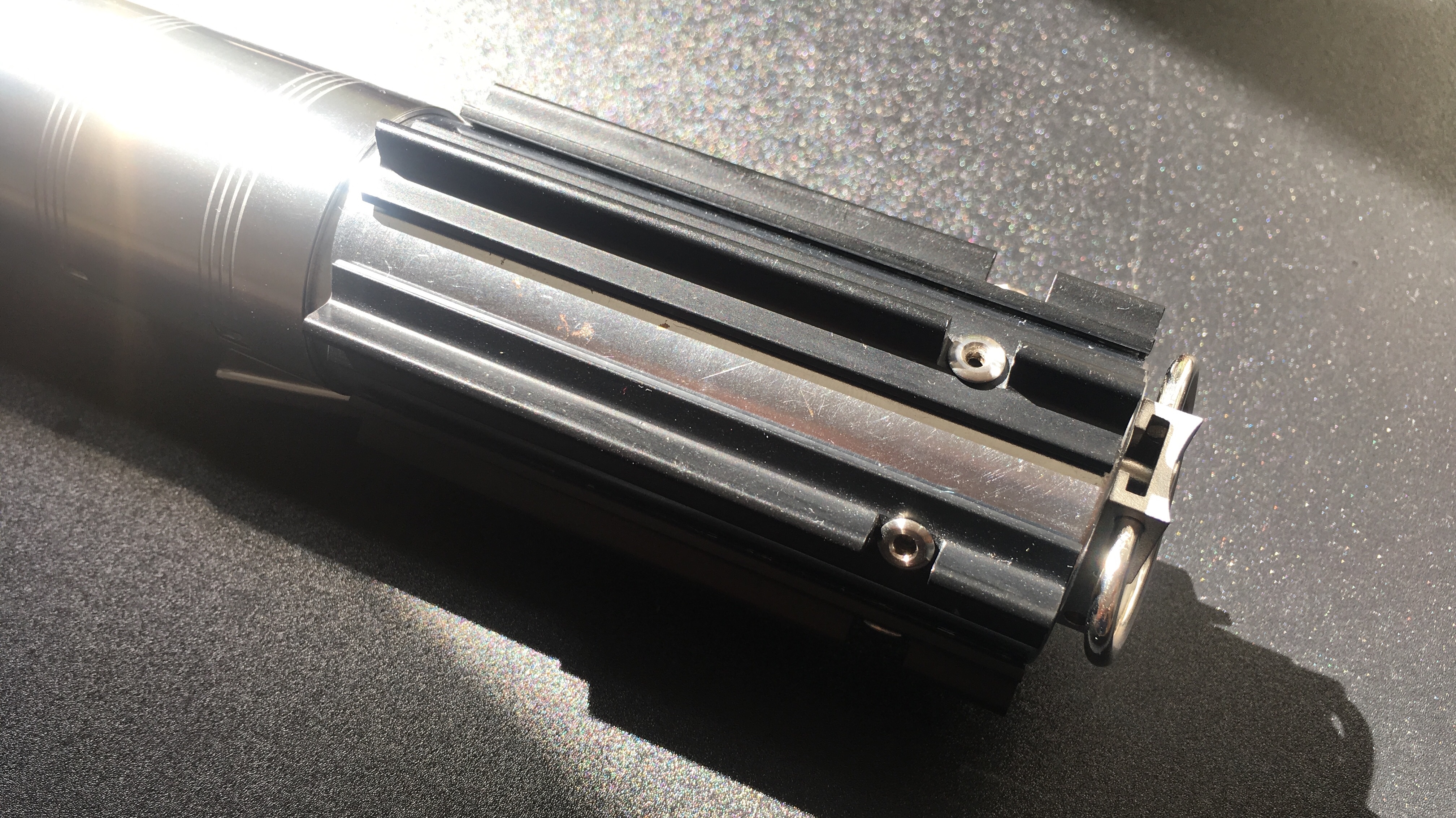

View attachment 810954View attachment 810955View attachment 810956
That looks great. I'd be happy if I could get my notches cut and grips installed as well as that.
Haha, I had a friend do the notches for me (using a needle file)... Ruined 2 sets of grips prior to this. So don't hurry with this... ;)
Btw: When riveting the D-ring to the bottom of the saber, start with the outer one, to prevent the Graflex' bottom from bending - resulting in a gap under the not riveted side of the D-ring... I had to remove inner rivet to fix this. This might happen only when using steel rivets, but maybe this helps someone to get it right on the first try.
