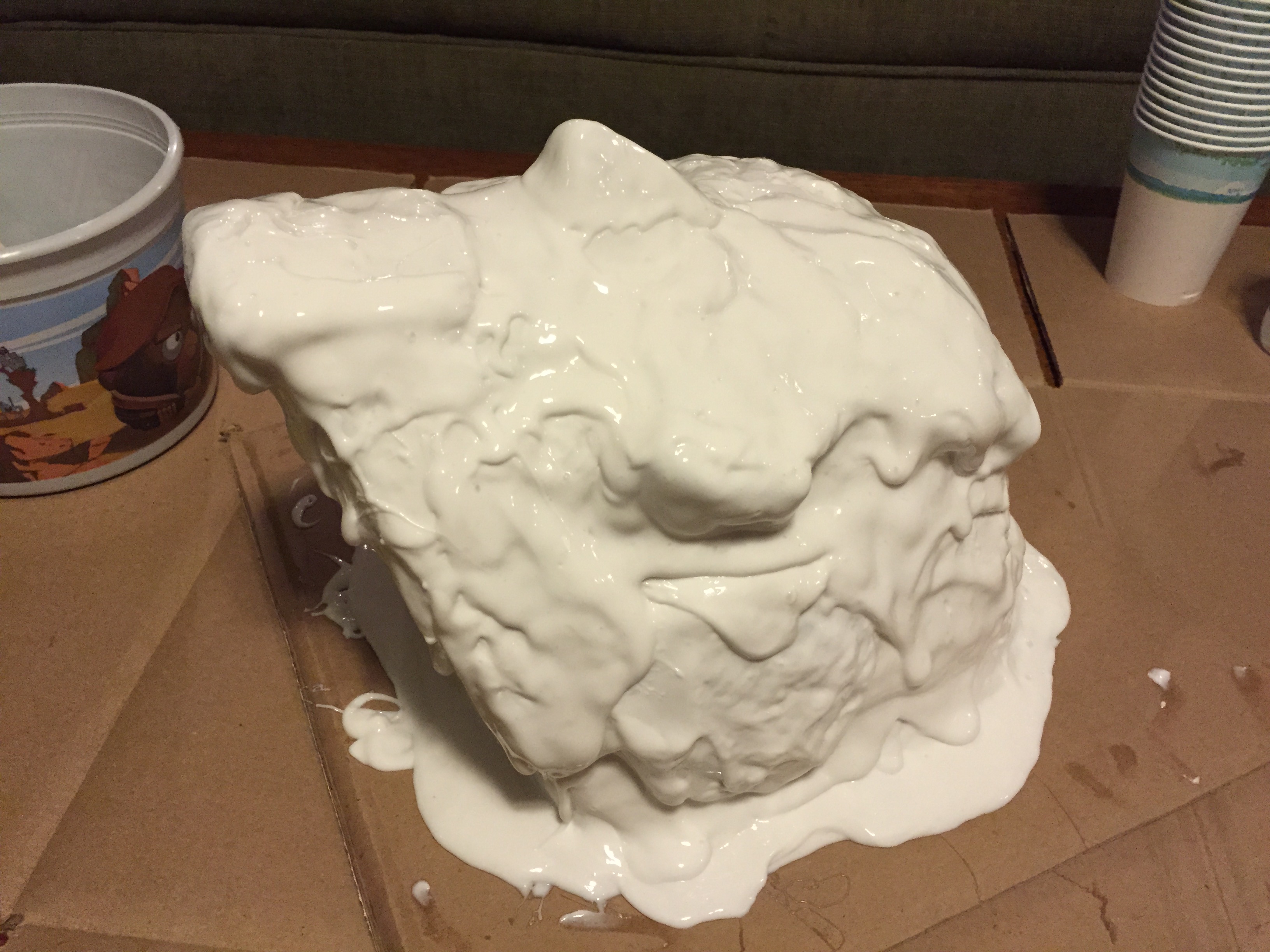

They say if you are cold you should dress in layers. The mask seemed cold so I put four layers of Mold Max Stroke silicone on!
Next up, making the support jacket once the layers fully cure (16-24 hours). It's like watching paint dry....

Ha! Yes the Scooby Doo bucket was borrowed from my 5 year olds collection of little buckets. When he saw me using it he said, "Hey, that's my bucket! But you can use it as long as you don't break it.". :lol The good news is that the silicone just pulls right out once it's cured! So he got his bucket back!!!
After letting the silicone cure I made an old fashioned two piece jacket with plaster gauze and pottery plaster. Works great for indoor builds as there is no smell, unlike fiberglass.

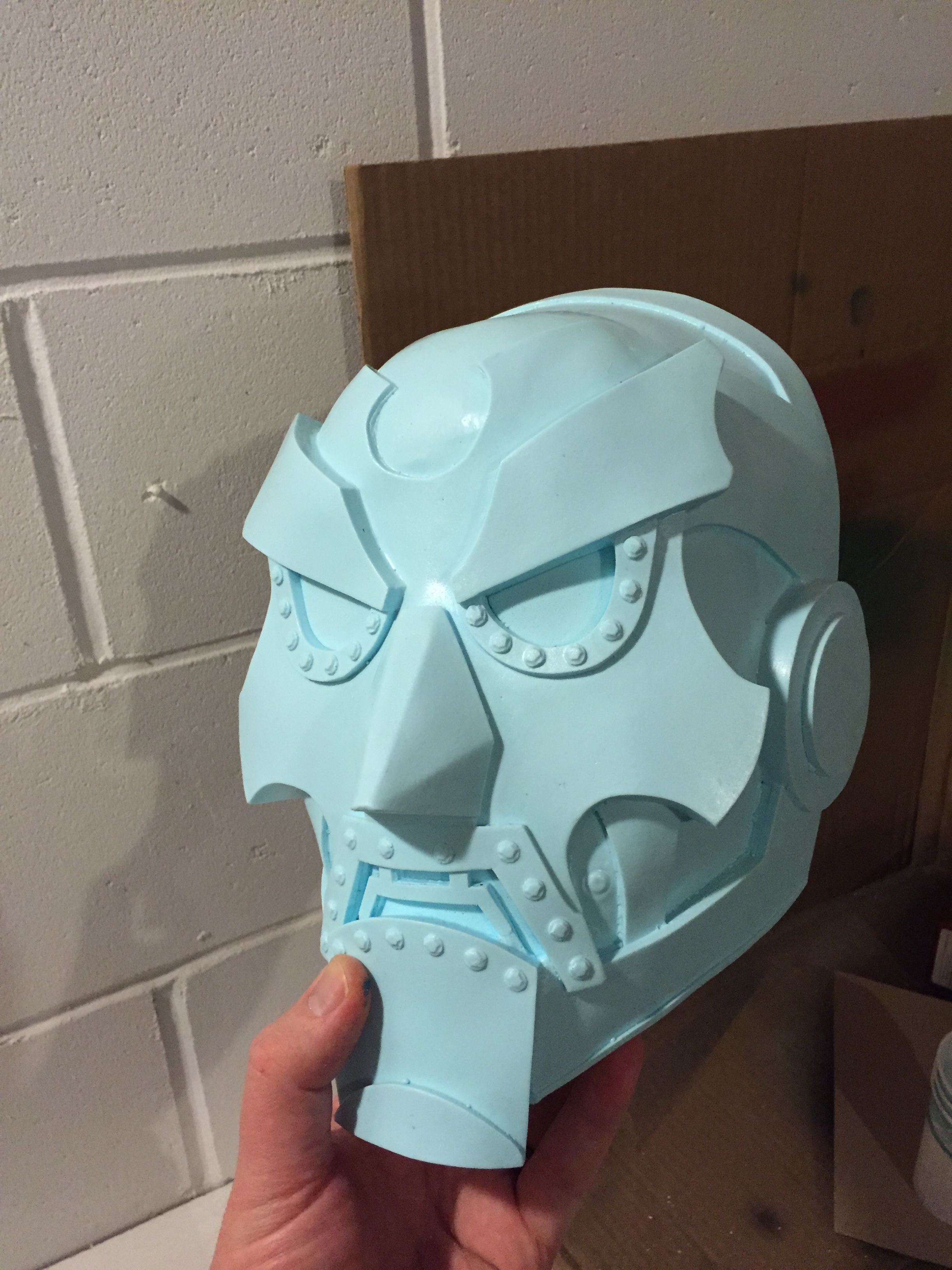

All Right!!! I was finally able to get the masks cast! I did the first cast in Smooth Cast 300 and tinted it blue to see the layers better against the white silicone.
I then did a second cast (for the client) in Smooth Cast Onyx.
Brothers - "Blue Boy" and "Blackie"!
I trimmed up the Onyx and started the prep to get ready for painting. We are close....so very, very close!

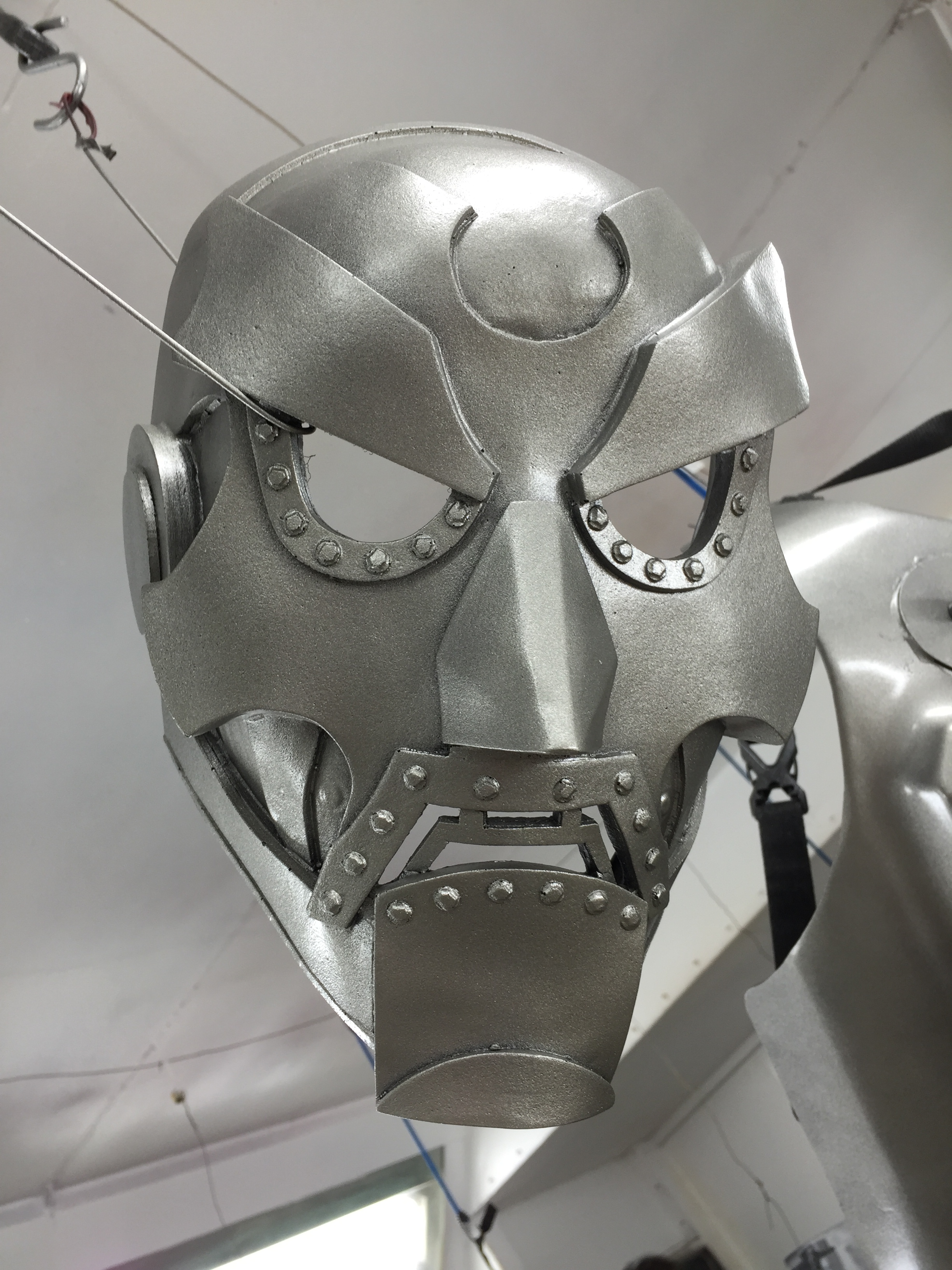

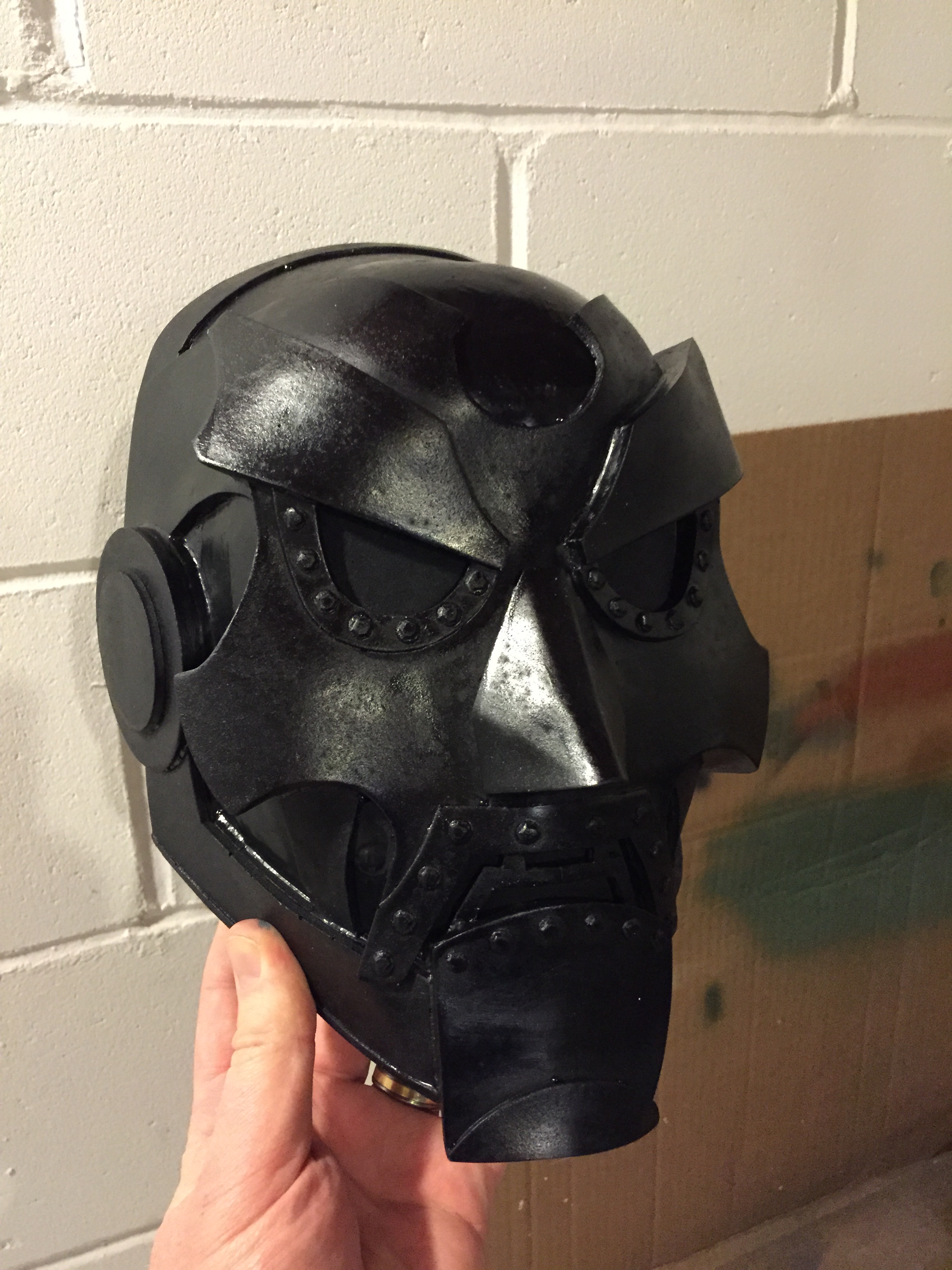

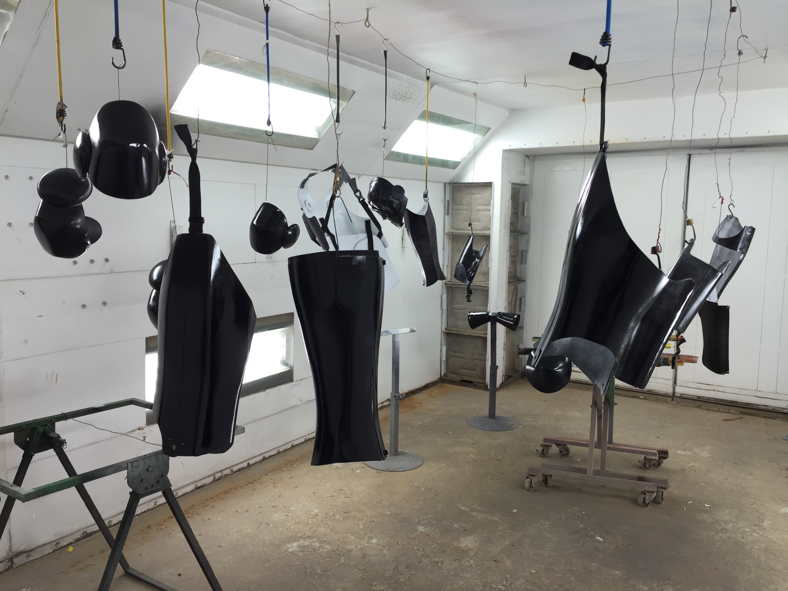

Whew! Friday was a busy day! The client I am building the costume for had a contact that allowed us to use his automotive spray booth for the day. We started out early and hung each of the pieces on wire and prepped everything for the first layer. We started with a base coat of gloss black.

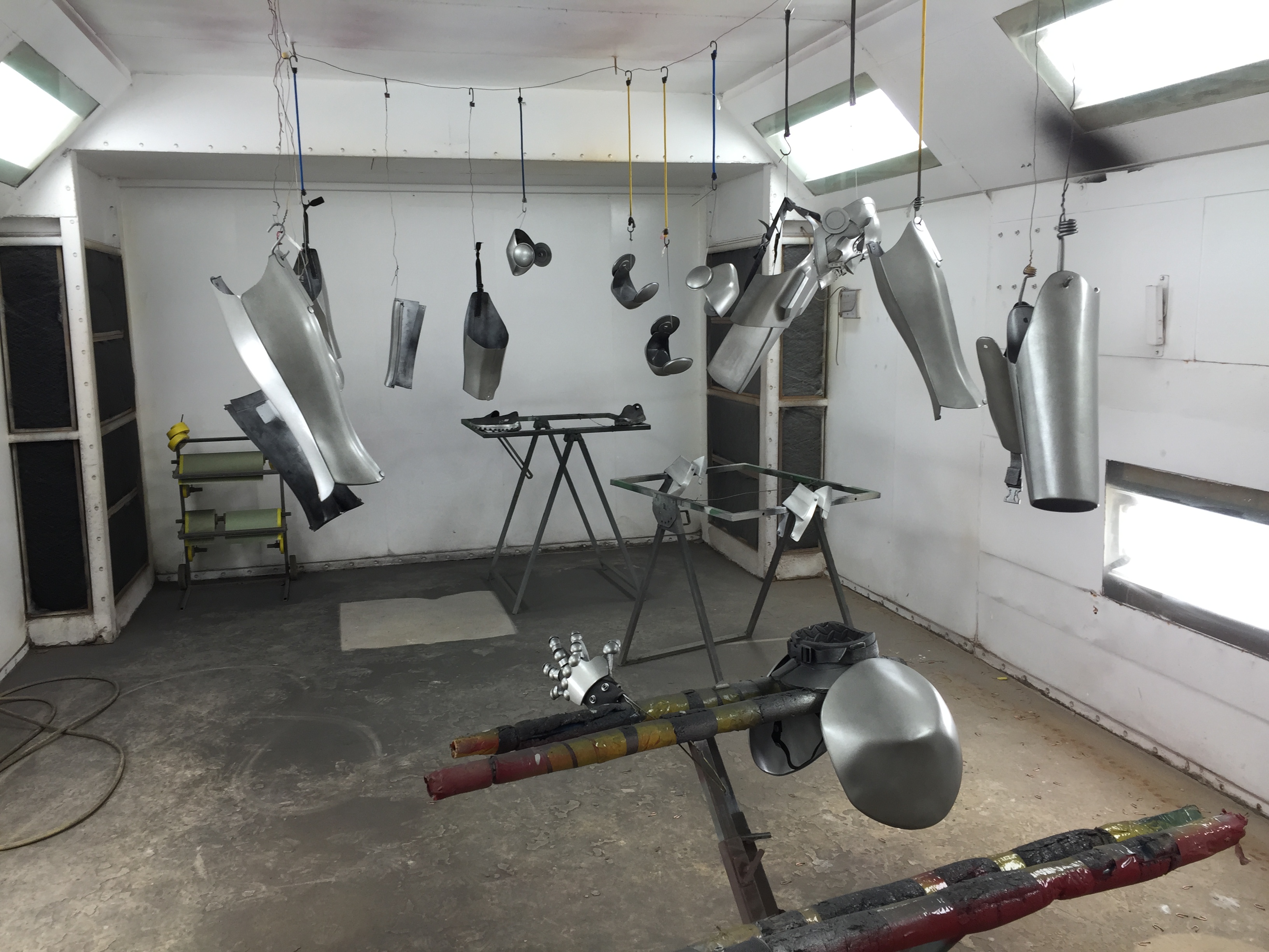

We ended up a little short on black paint and had to run back into town to pick up a couple more cans. After a few more coats we took a break for lunch. When we came back we added several thin layers of Satin Nickel. The allows some of the back to still show but keeps the metallic sheen. I think it turned out great!

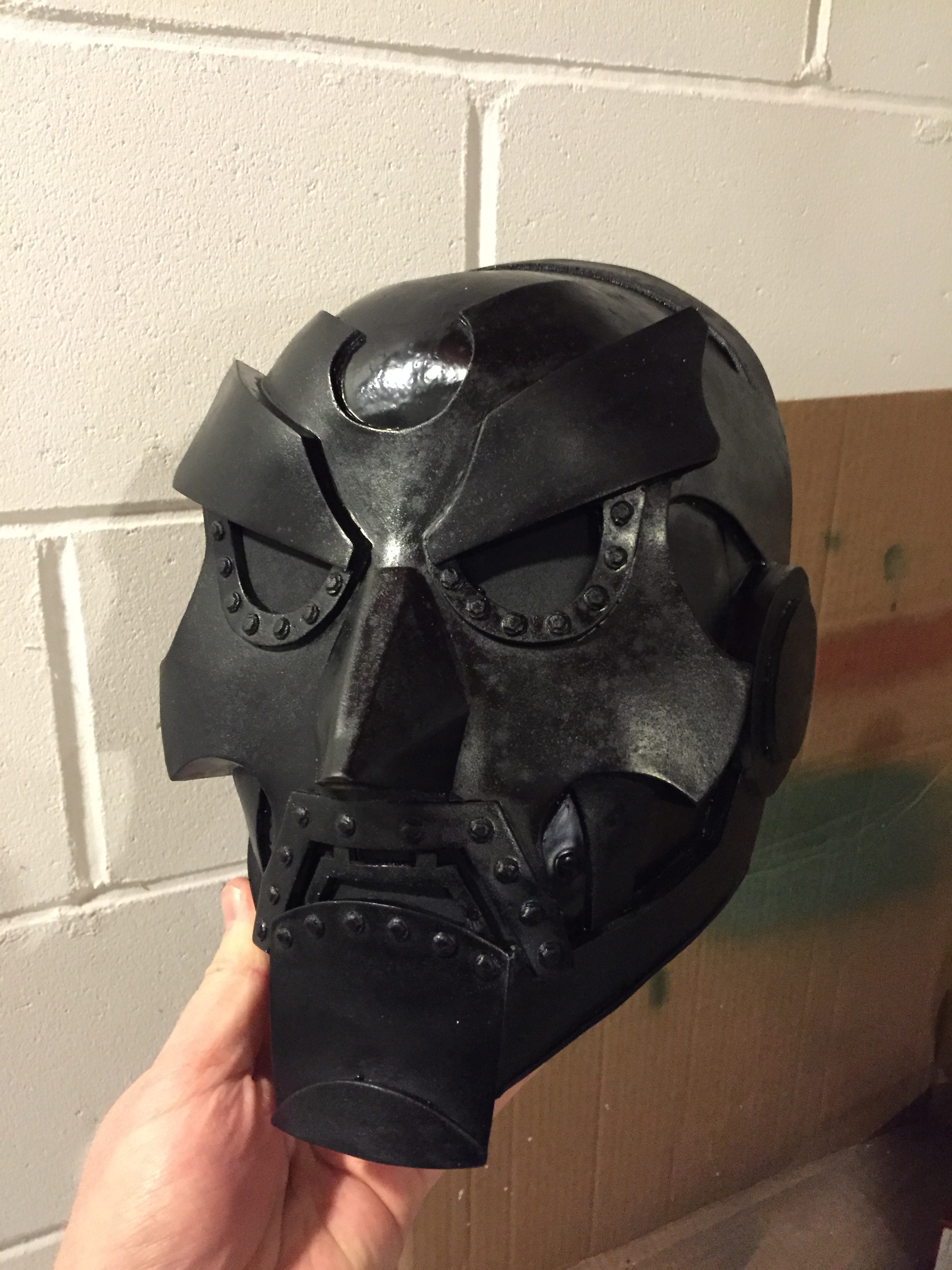

Here is the mask!
I have let the pieces cure over the weekend and on Monday I will get back to assembling the pieces and adding the details. A few places will need to be touched up and the chest rondels will need a coat of gold paint. Almost there!

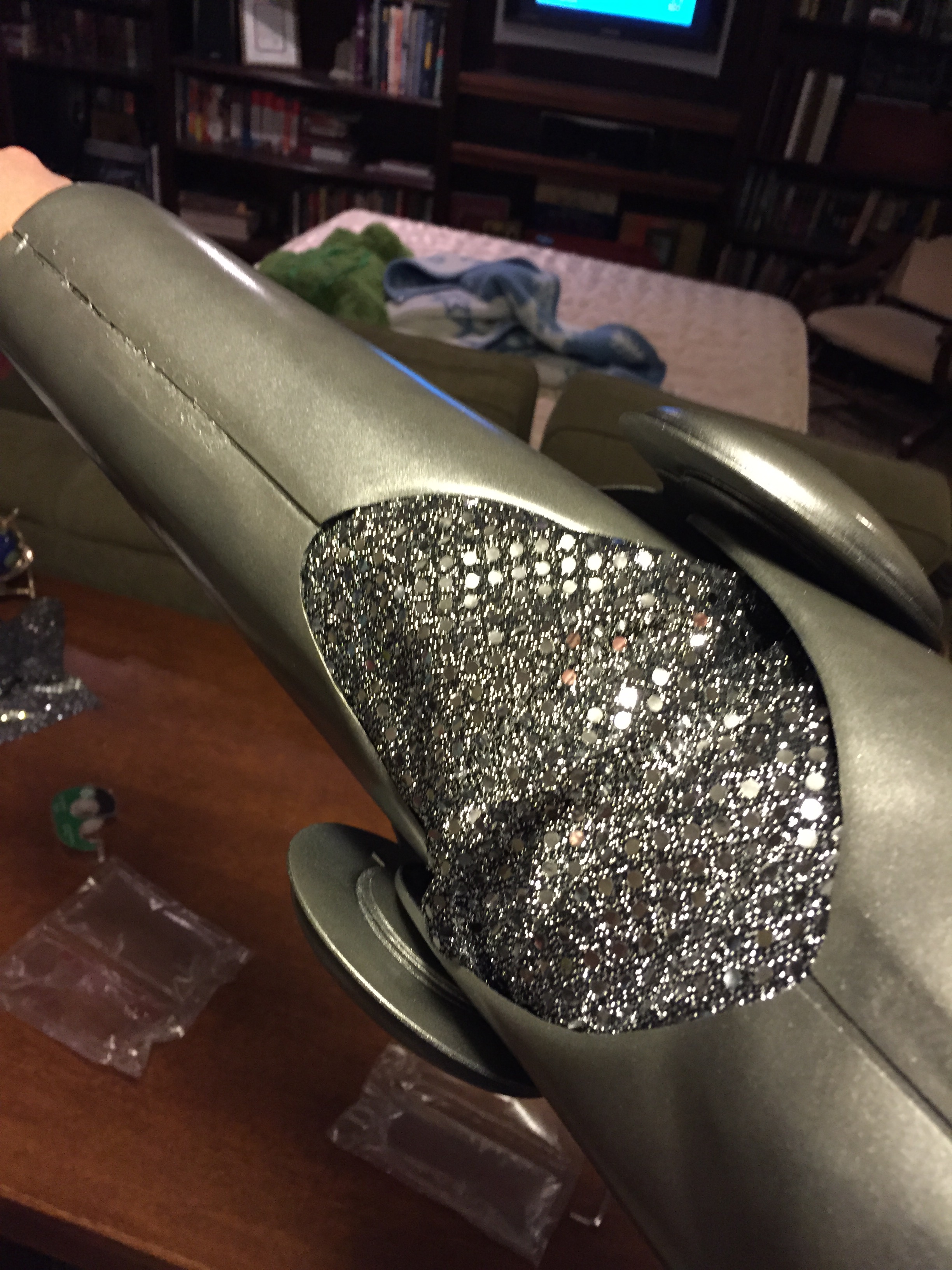

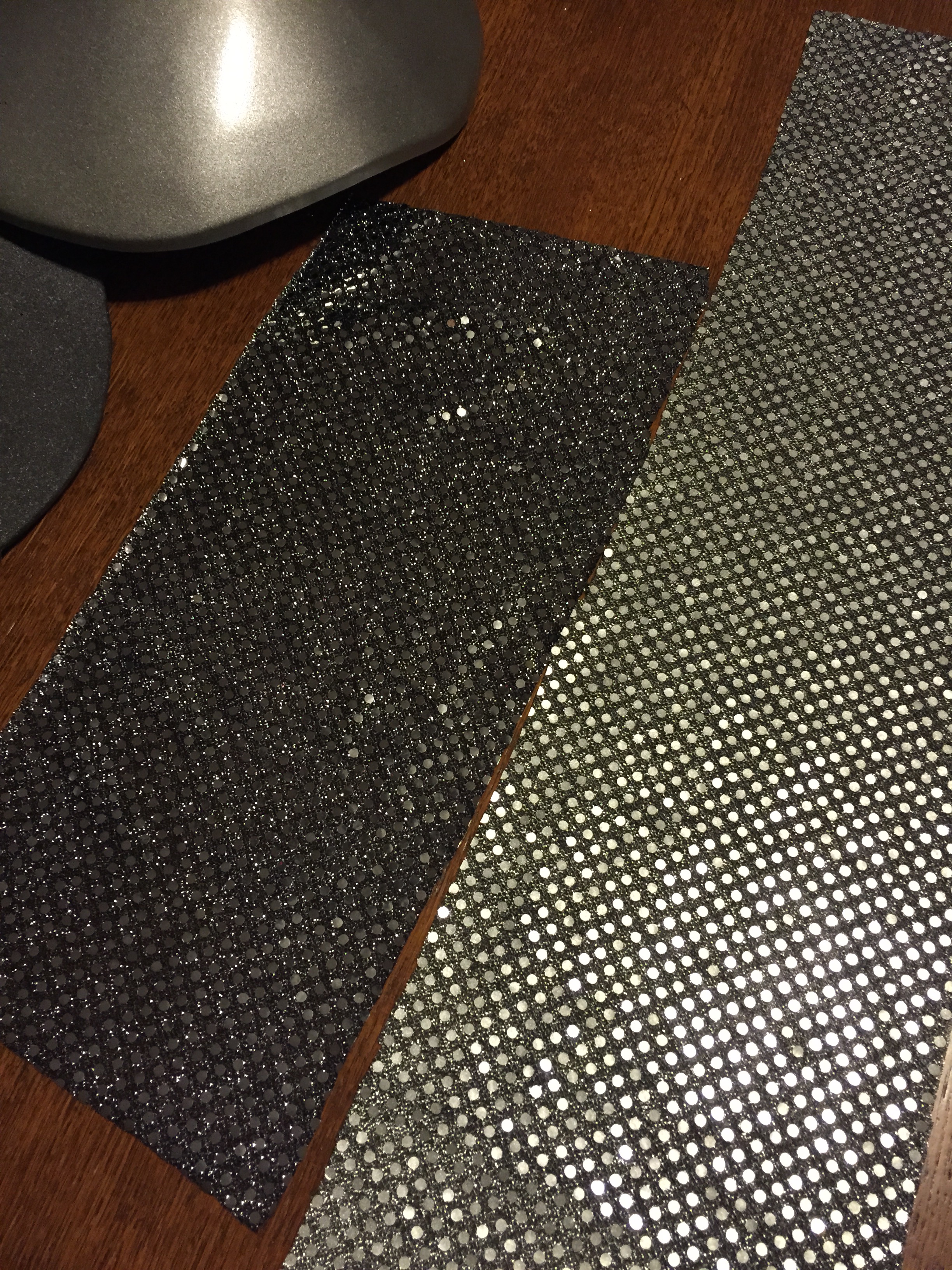

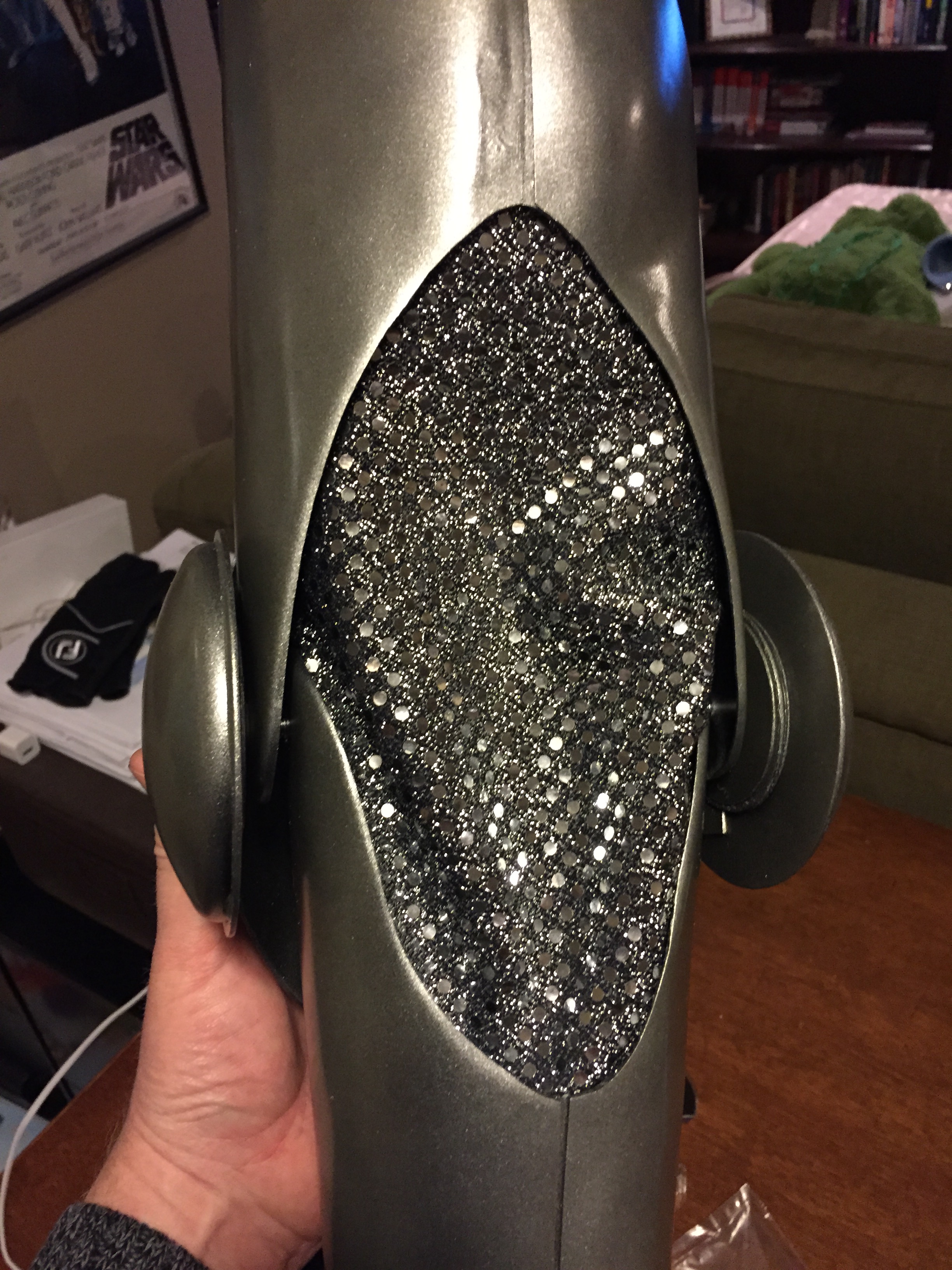

Trying out the fabric insert to cover the inner elbow. I will spray this fabric with the same satin nickel color I used on the armor to help it blend in a little more.

Here is one of the "chain mail" pieces painted on the right next to one unpainted on the left.
I also finished the gorget, wrapped in the painted piece of the fabric. Just a little bit of this will stick out above the tunic and below the mask but I wrapped the whole thing just in case.

Ha! Yeah, old theater trick, fabric for chain mail. I have used old knit sweaters too, but this is nice and lightweight to keep the wearer as cool as possible.
