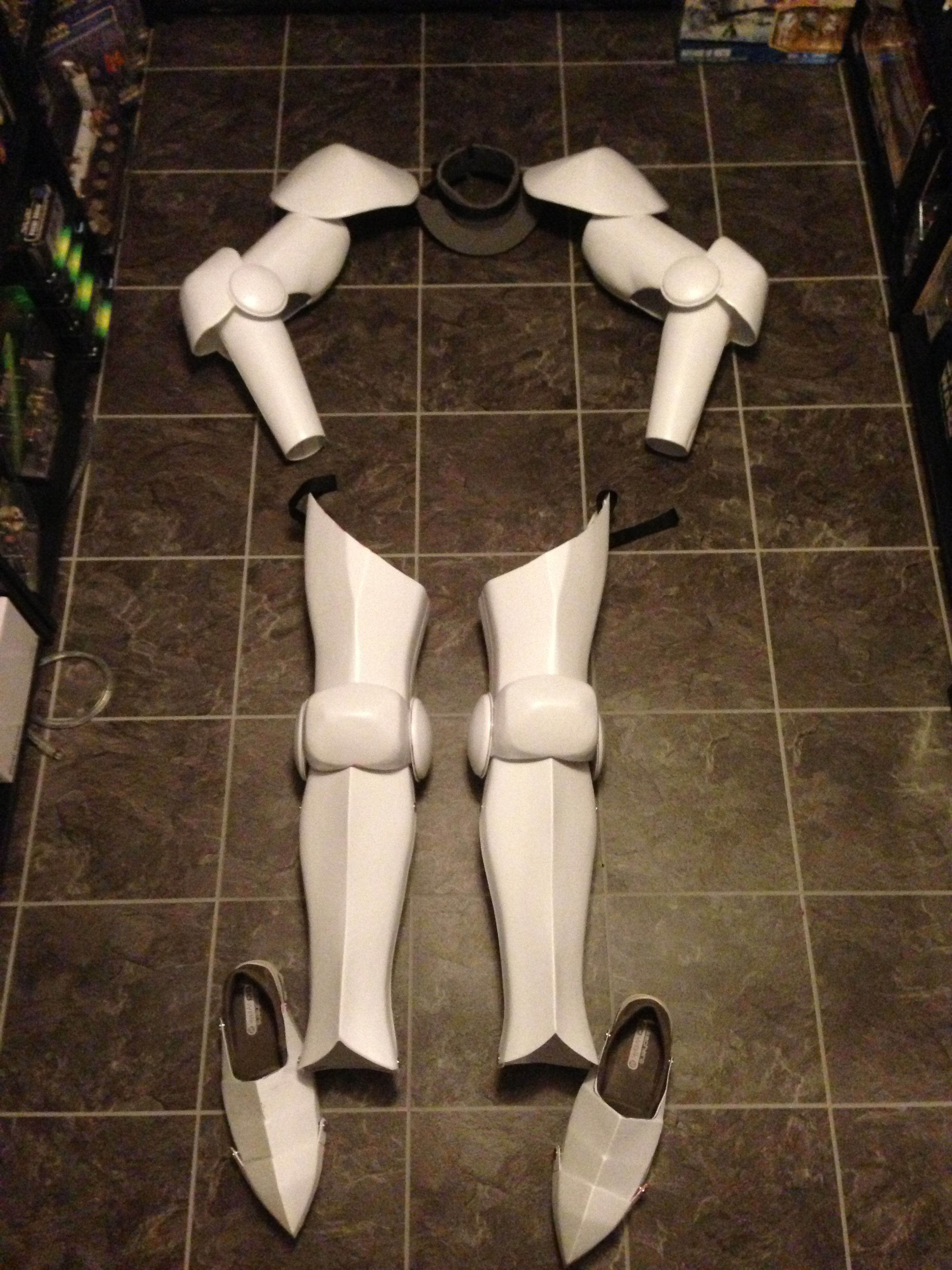

Here is where the armor sits right now. I have both arms and shoulders done as well as the gorget/harness to support them. I have both legs done and the shoes. The abs are done but the breast-plate still needs to be pulled. The buck for that needs some more work.

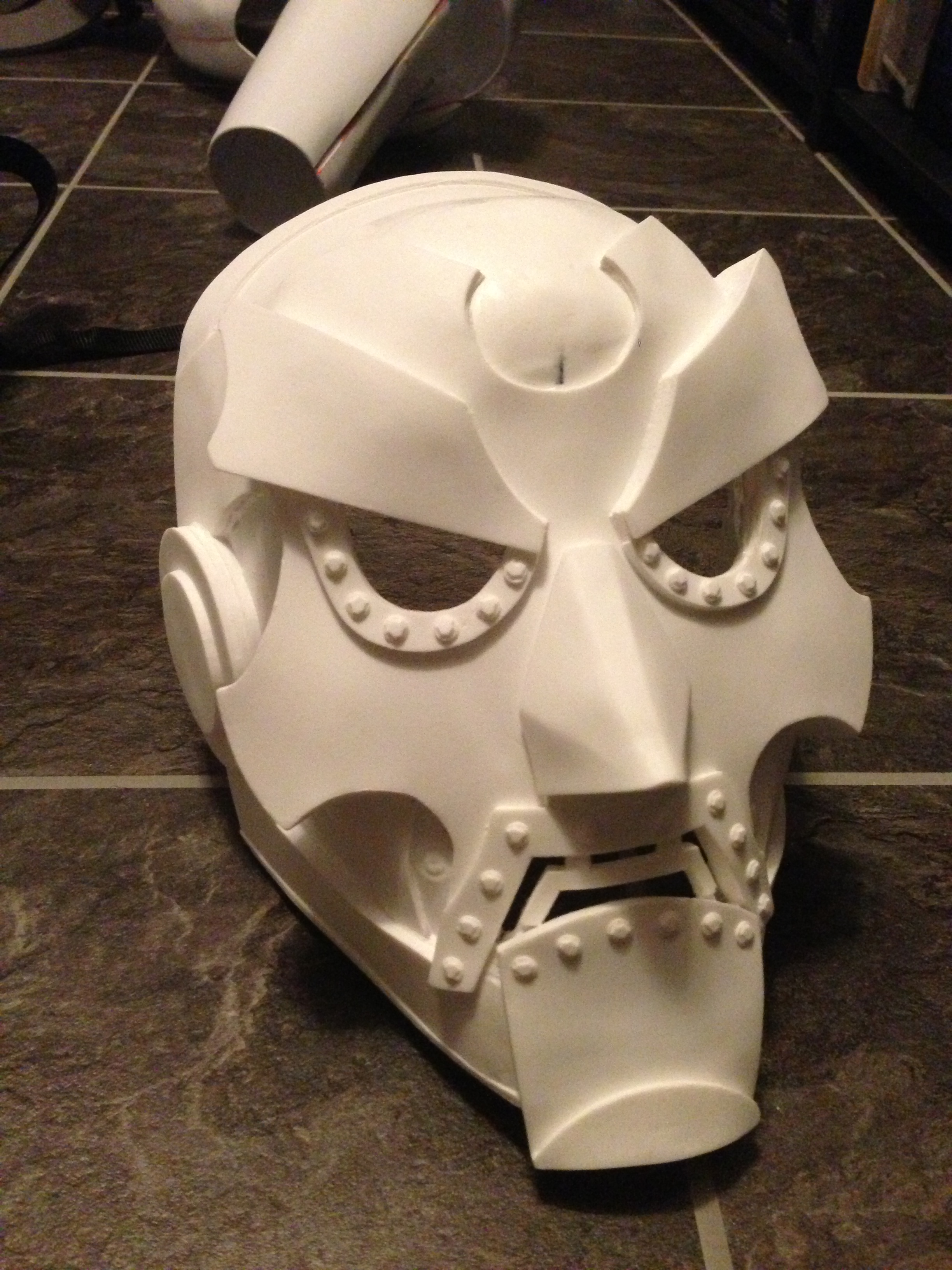

The mask is still in process of being filled and smoothed to make it ready for the master cast. Not sure if we are going to cut holes in the nose for breathing or leave it flat. Doom never seems to have nostrils in the comics! :lol

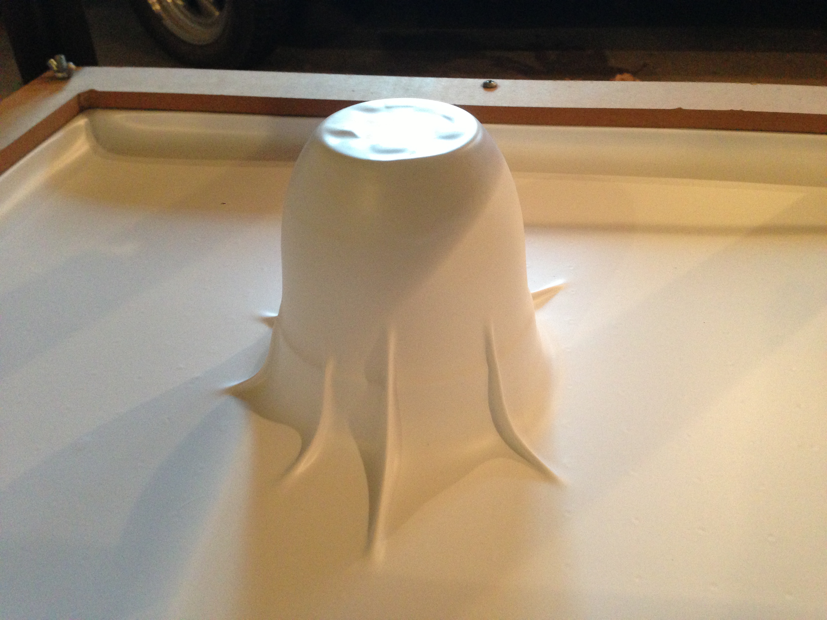

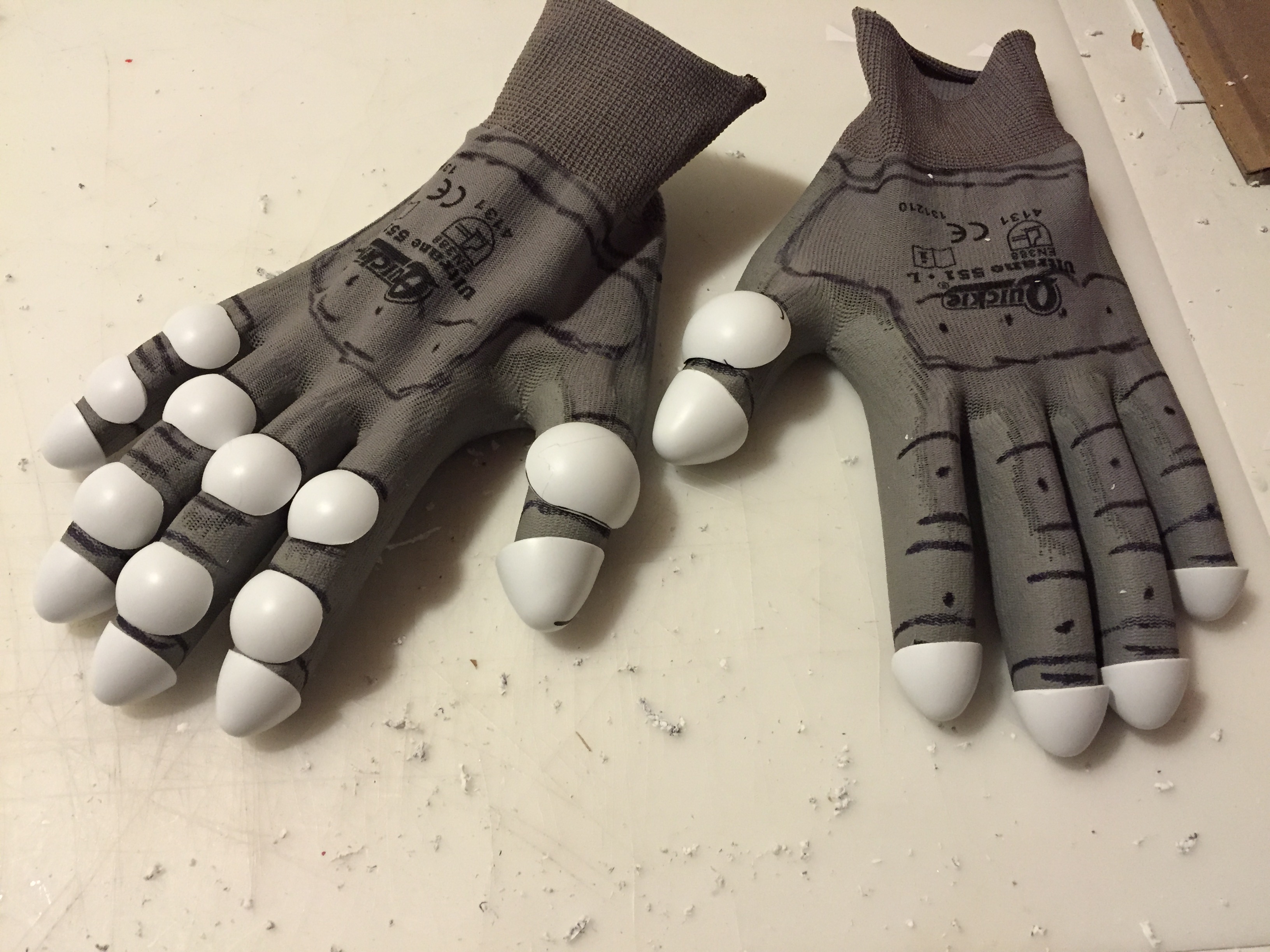

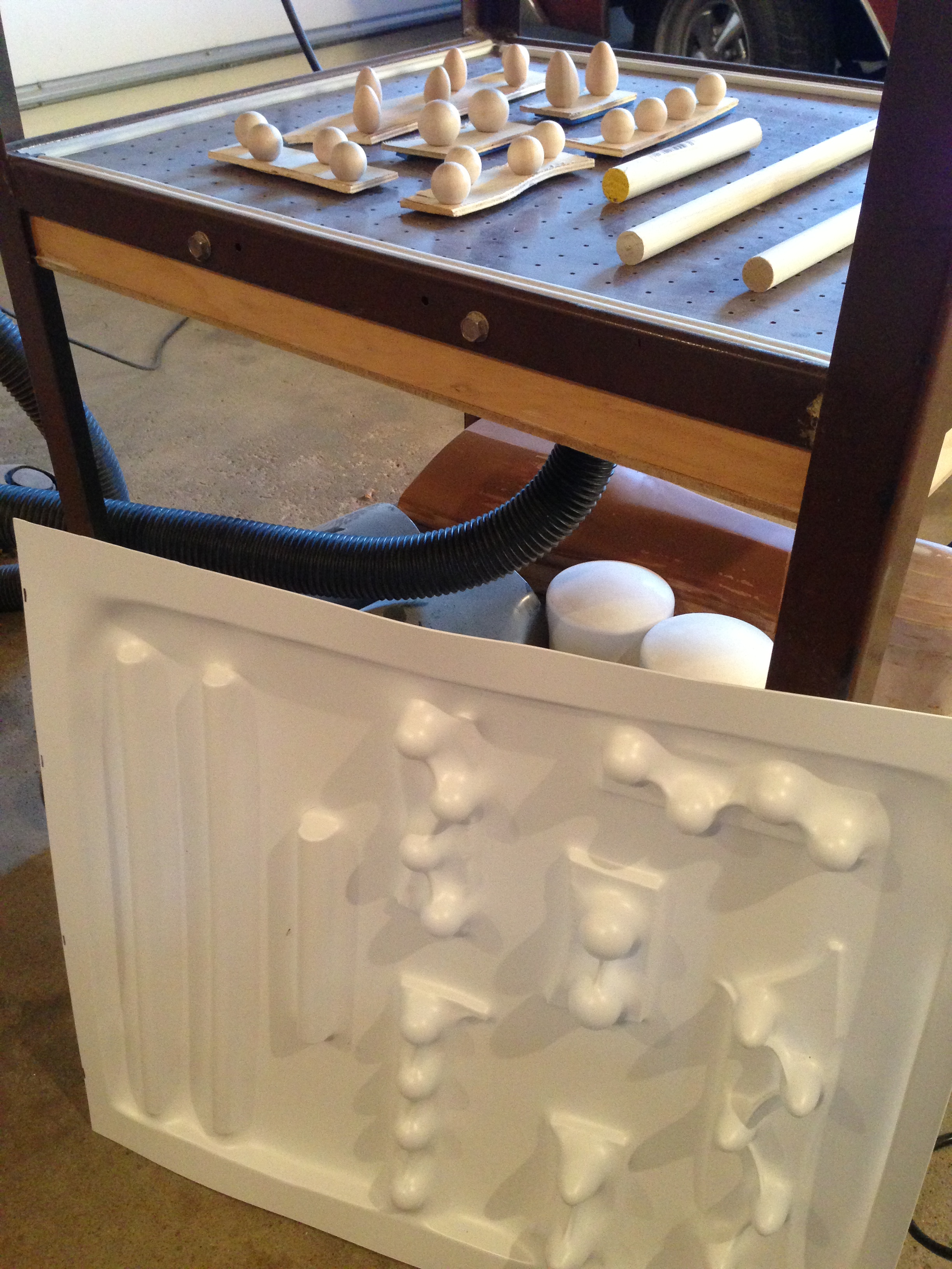

I started pulling all the little parts for the gauntlets. Those should be fun to cut out! I have had alot of webbing issues with the pulls of the gauntlet cuff. I assume it is due to the super-cold weather up here and my unheated garage. I will try a few more and then move to plan B if those do not work.

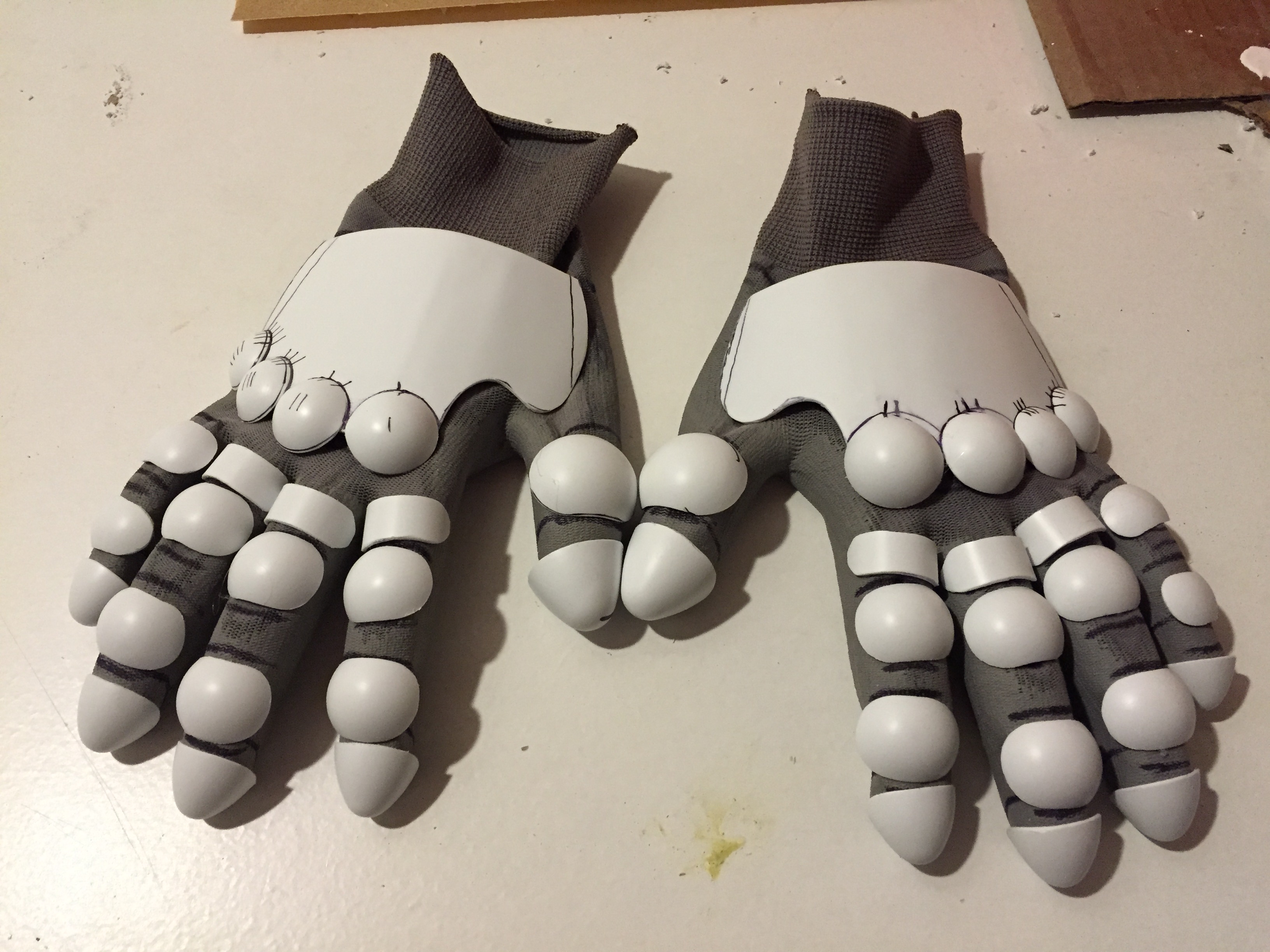

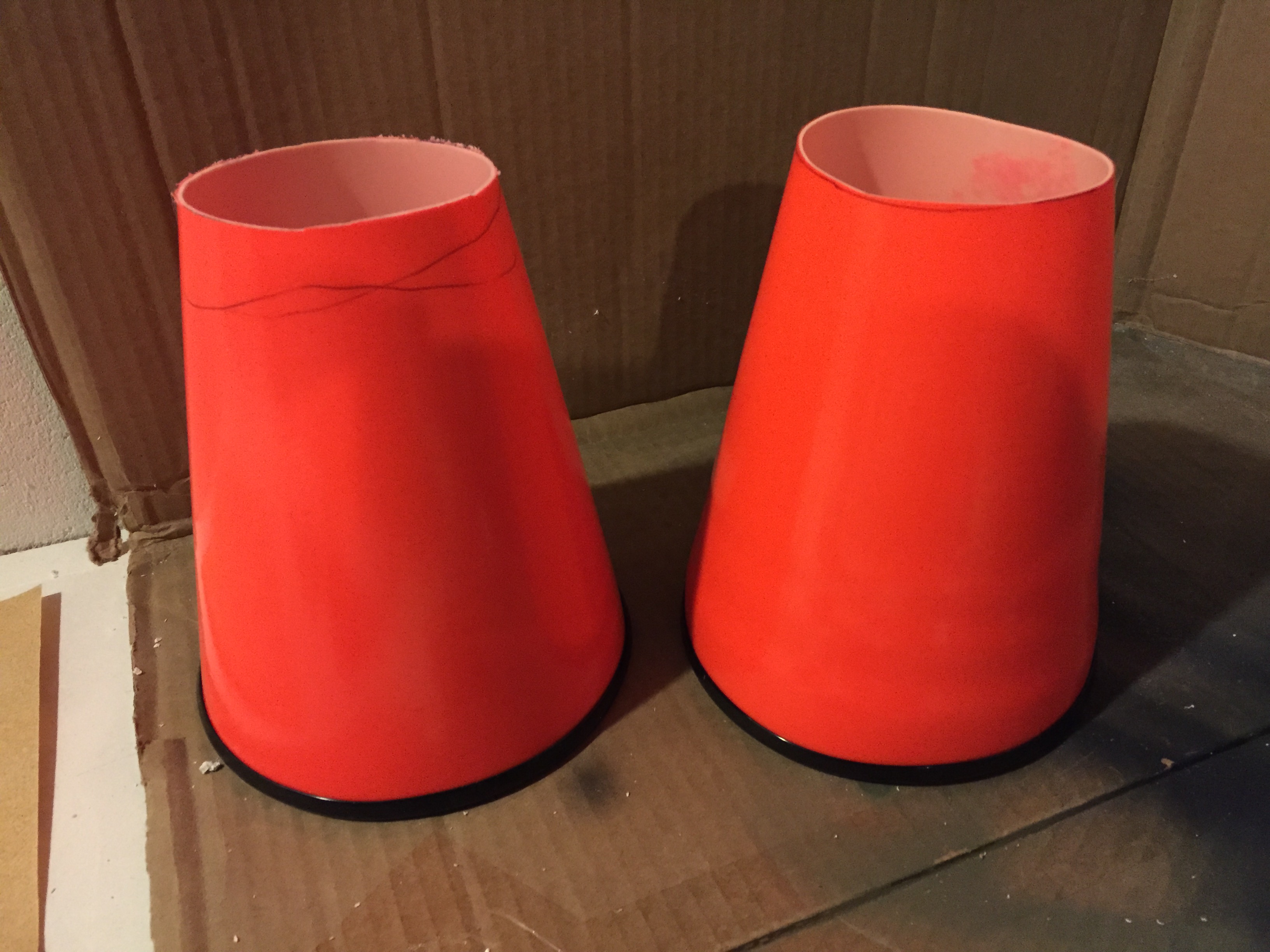

Here are a few progress shots of the gauntlets. I used a small traffic cone for the cuffs as my pulls never seemed to turn out. I stiffened them with automotive door trim and they are quite firm.

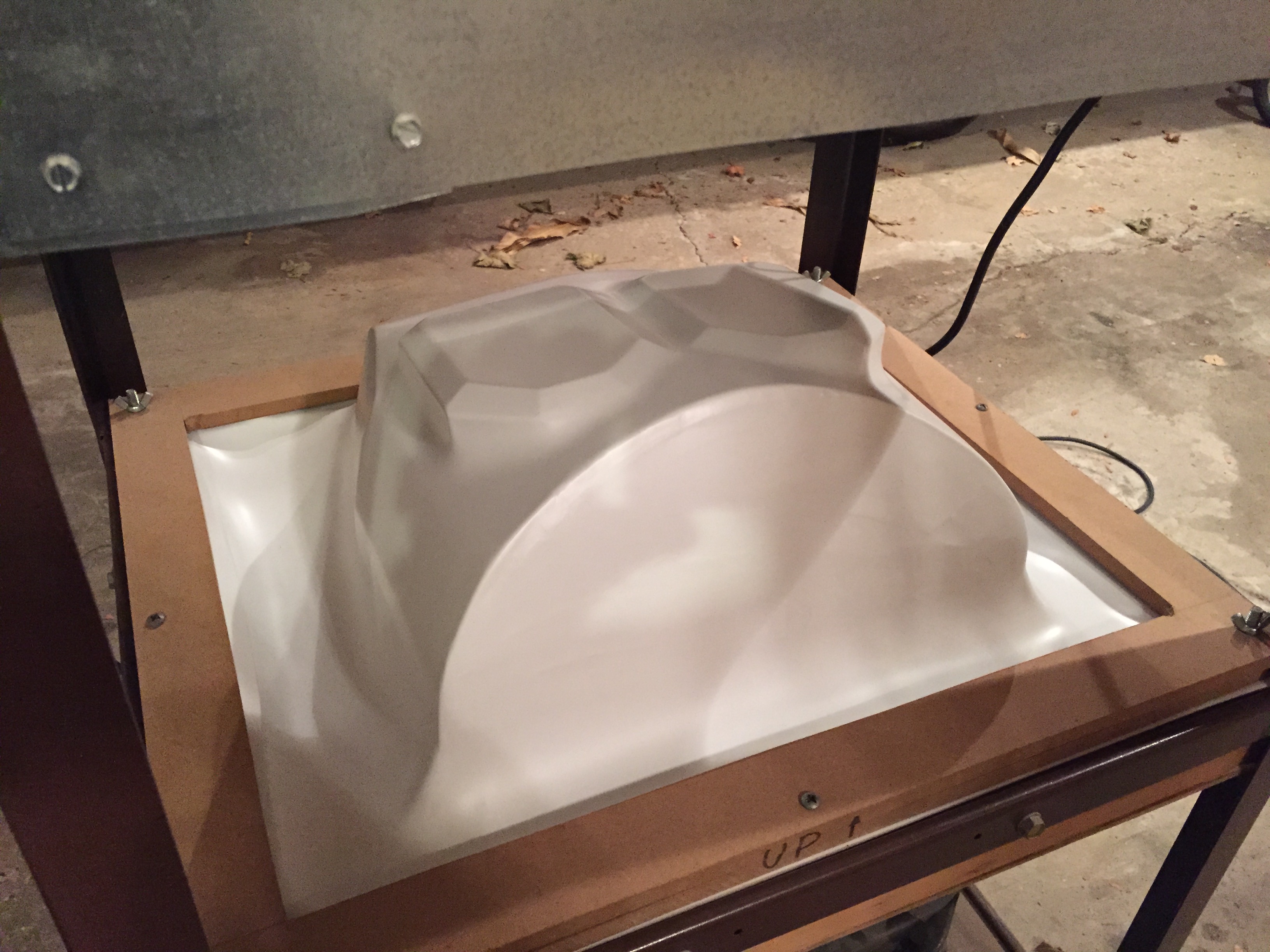

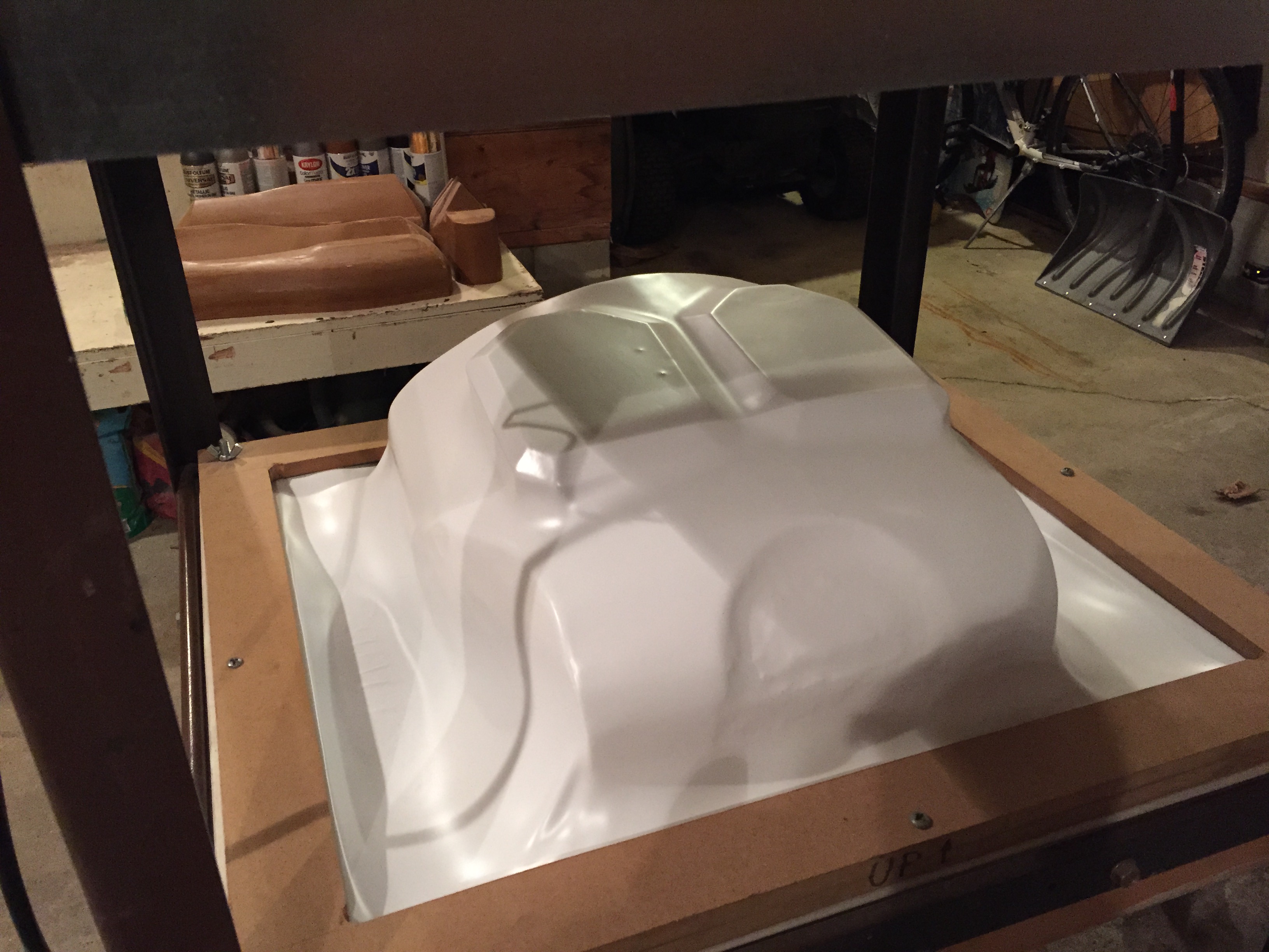

I was also able to pull the breastplate. It is the largest piece I have pulled in my machine and it just barely fits!

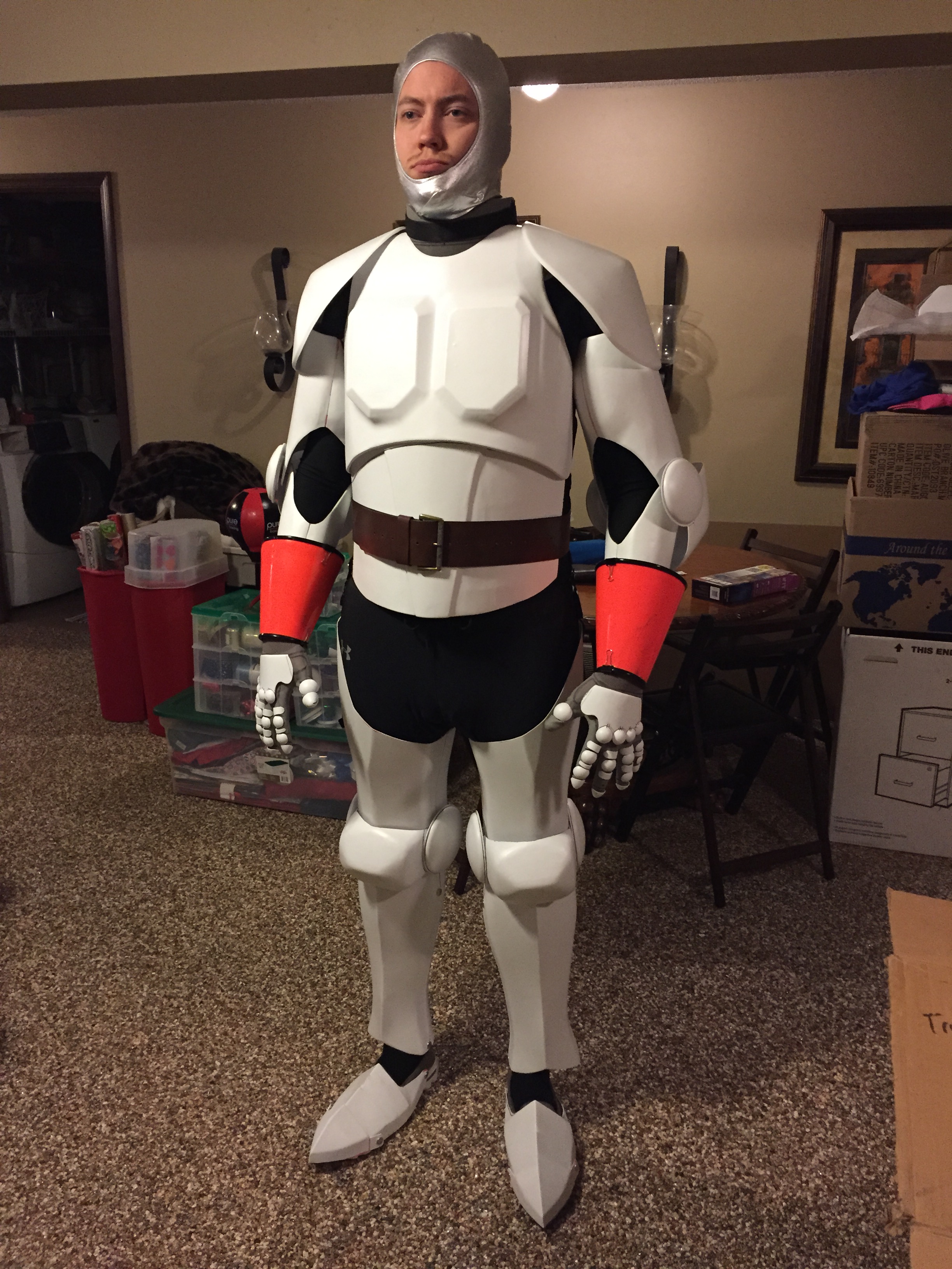

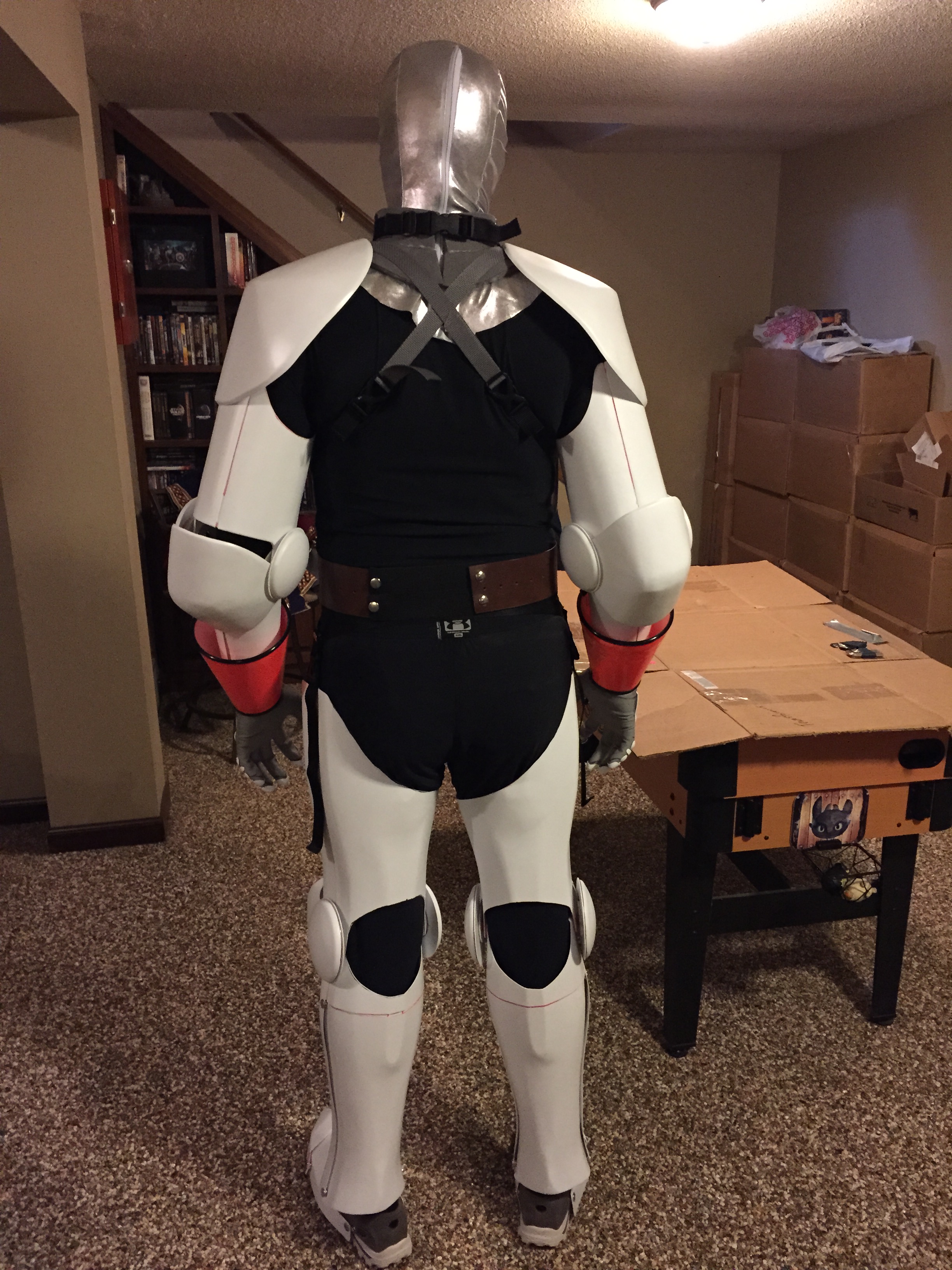

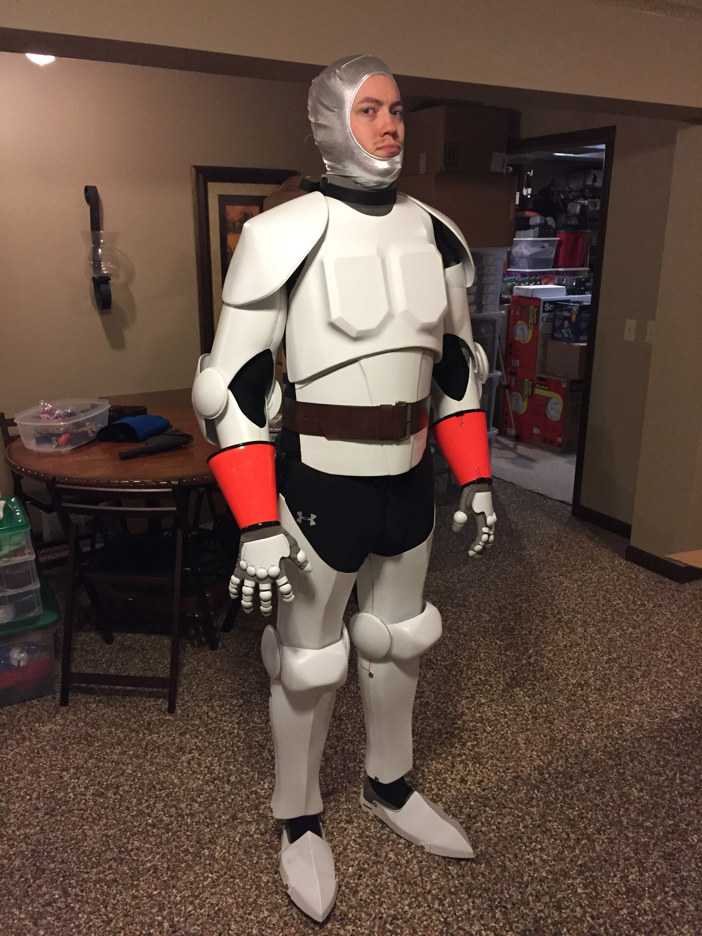

We had a good test fitting and we were able to get all the armor pieces on. With just a few minor tweaks it is all good to go! This week I am working on the tunic and the cloak with hood. The following week I will get back to the mask and get a new master mold made and then on to making the production mask. The shots here are without any tunic and you can see the breastplate and abs that will be covered by the cloth.

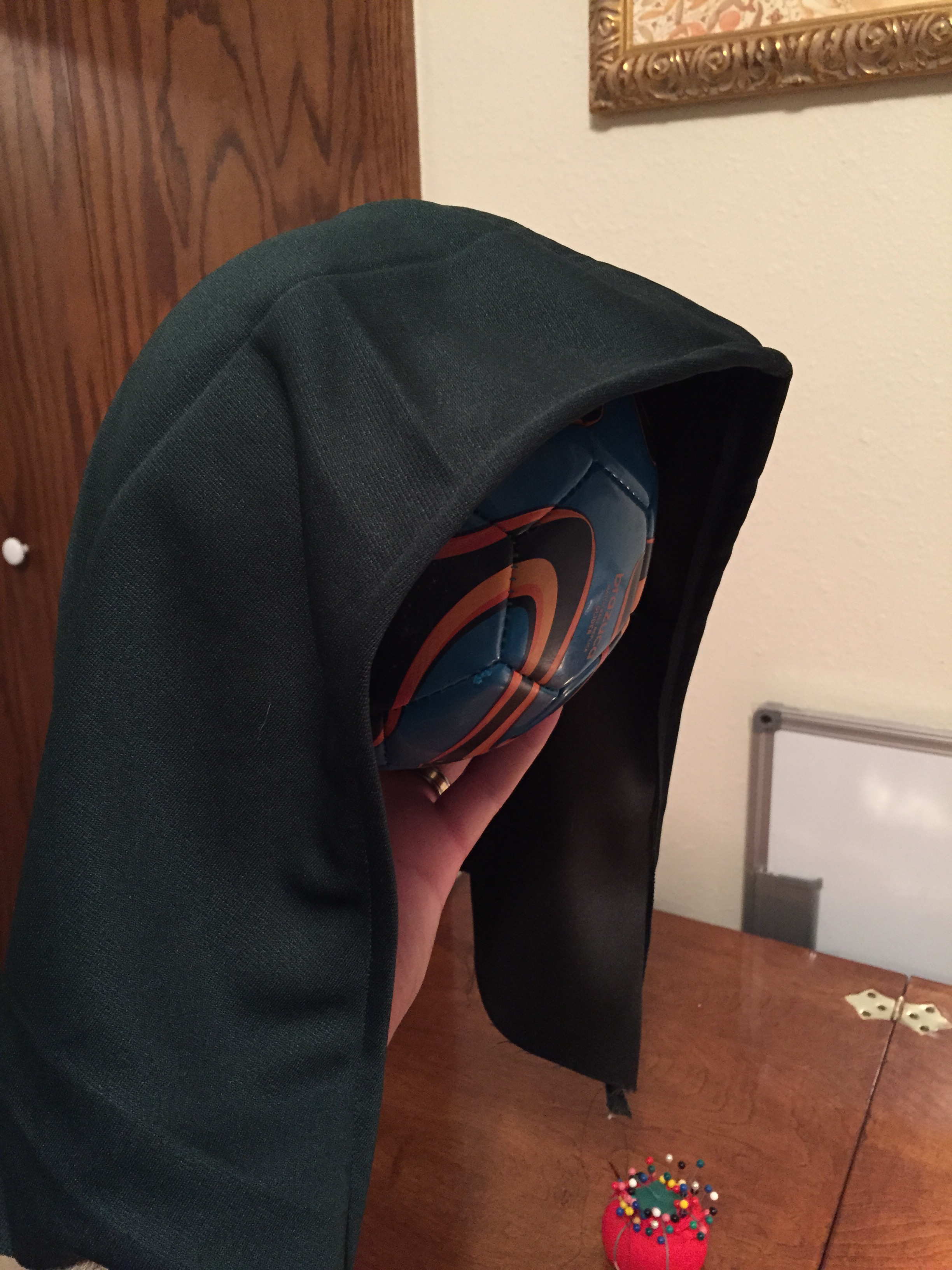

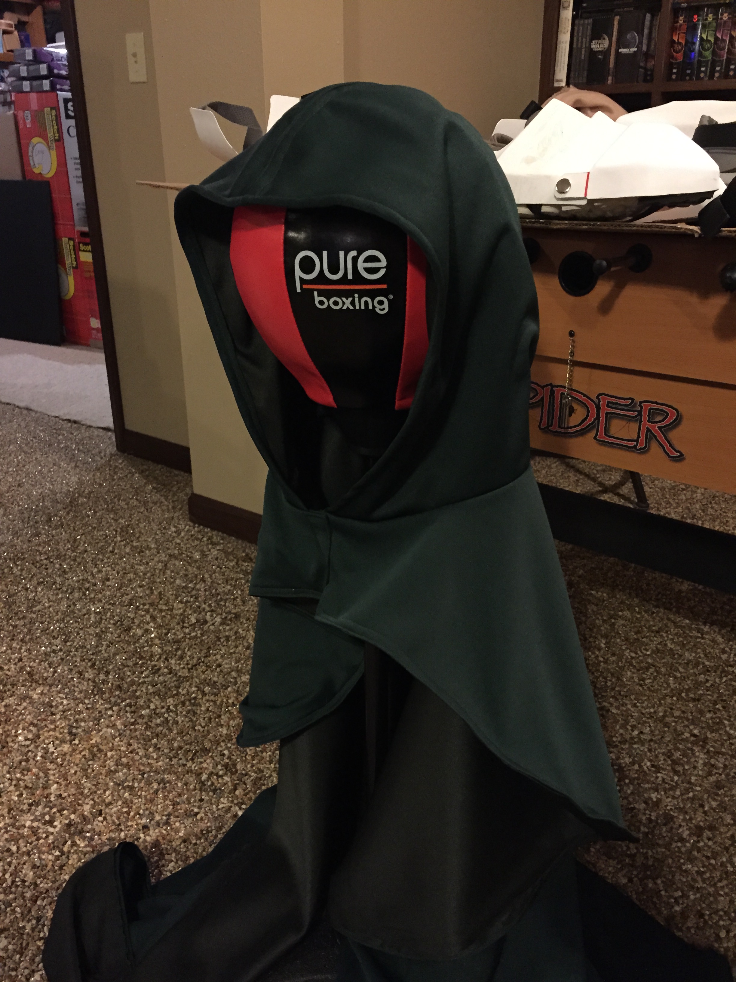

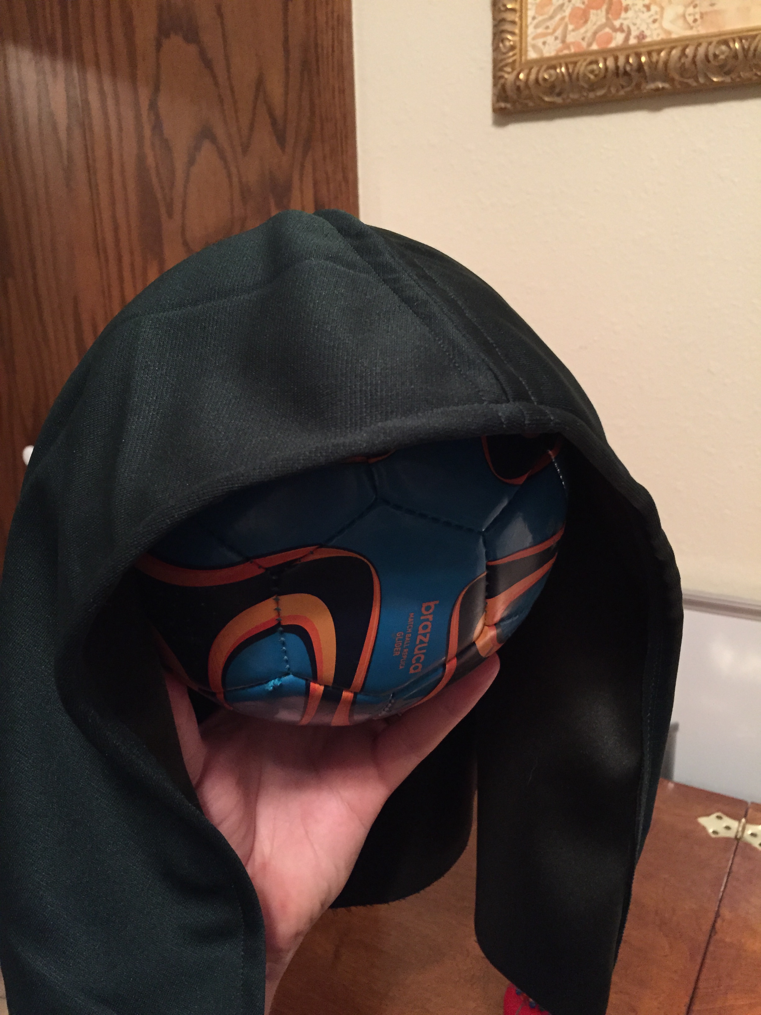

Getting to work on the soft goods! I started with the hood for the cloak. Is is lined with a darker satin fabric.
I then finished up the rest of the cloak and attached the hood. I will have to wait for the next suit up to determine the placement of the rondels to hide the cloak attachement points to the breastplate. Next up is to work on the tunic and then a whole mess of adjustments to get the soft goods and the armor to play nice with each other!

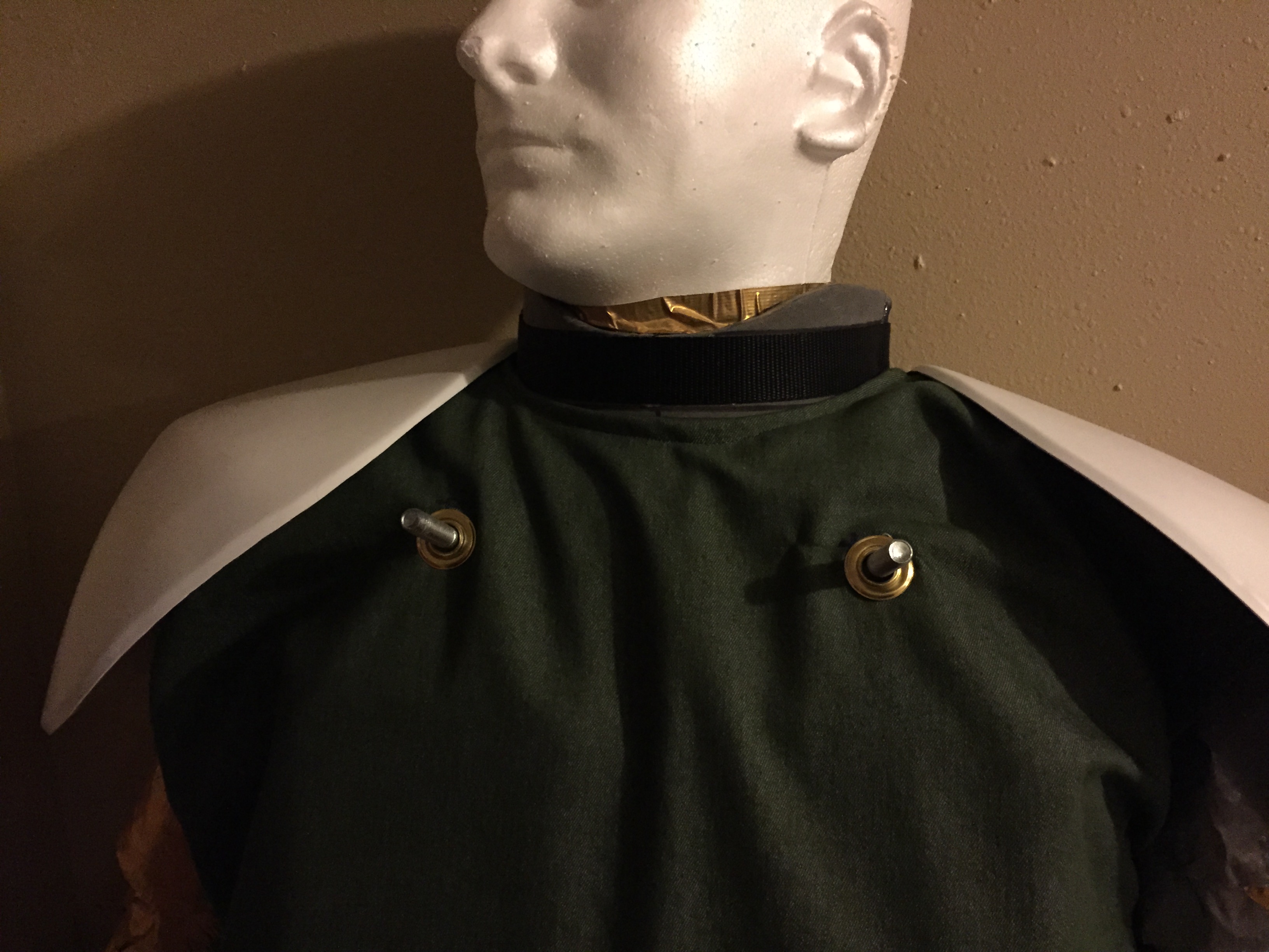

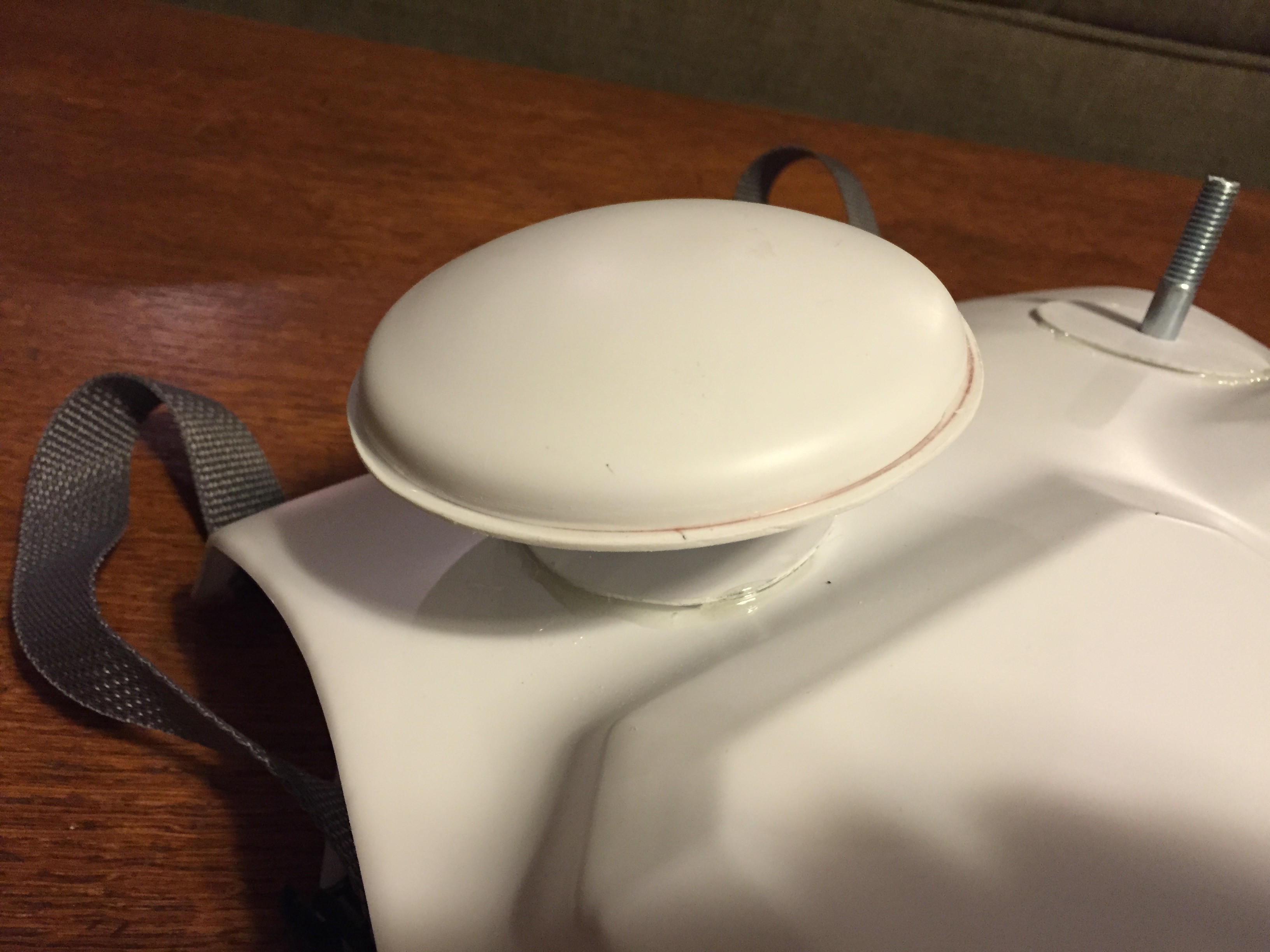

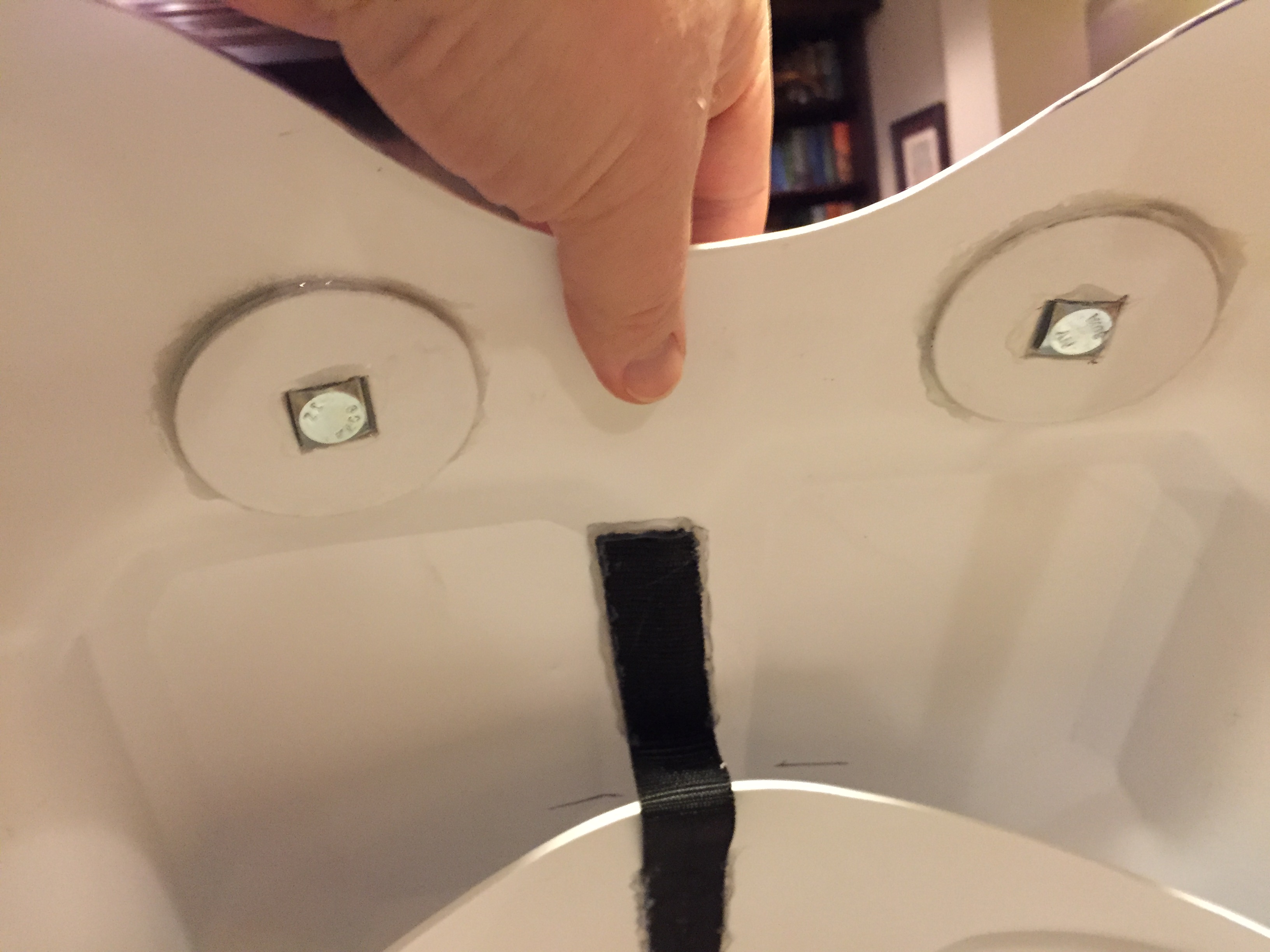

Over the past few days I have been glueing up the disks to hold the nuts and bolts that attach the rondels to the chest plate. I will be putting grommets through the tunic and the cloak. The bolts in the chest will go through the grommets and the chain will go over the bolts. Then the rondels will be screwed on over those. This will support the weight of the cloak and keep everything in place.
You can see it all together on my dummy before I add the fabric pieces.

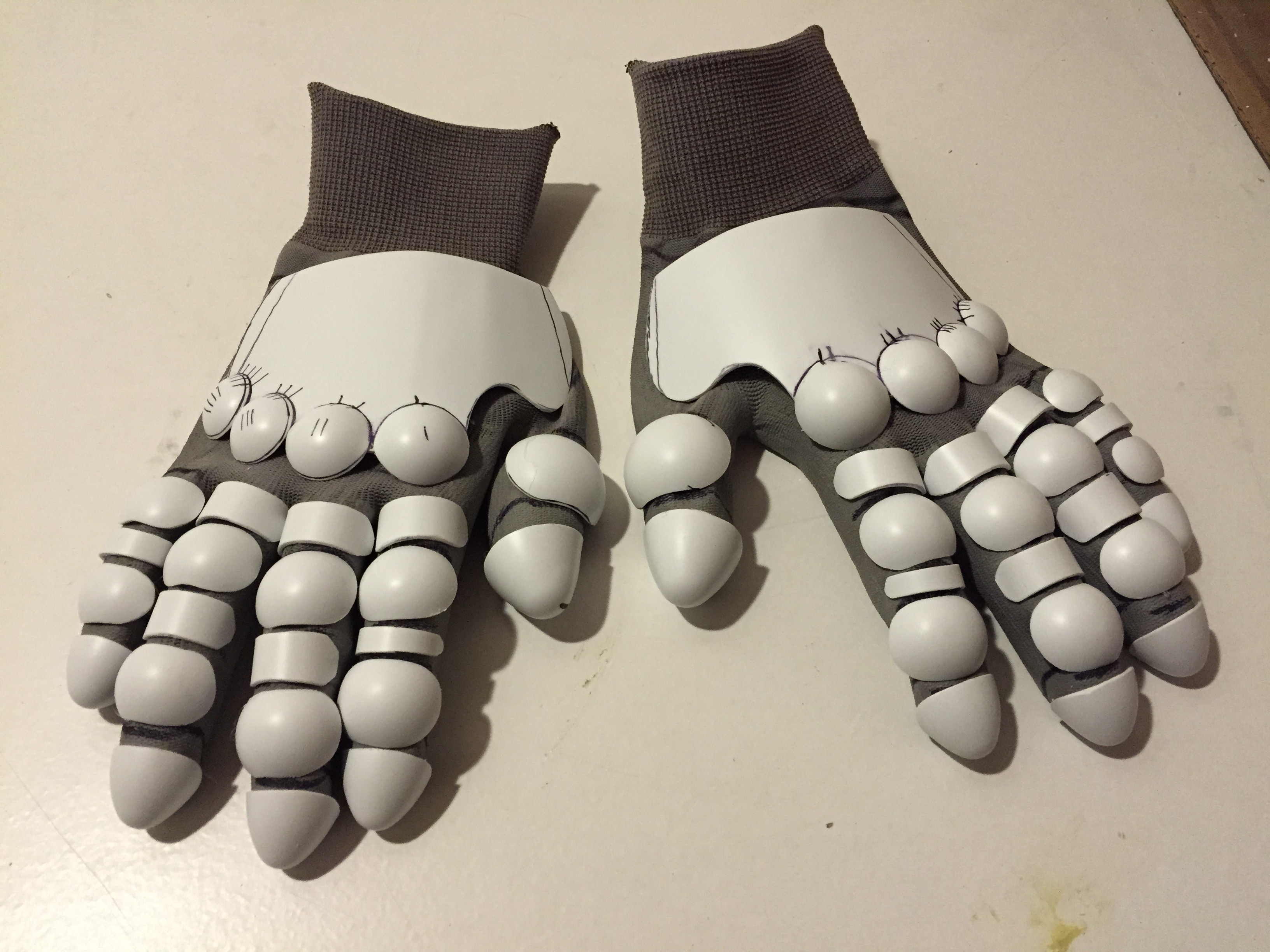

Both gauntlets are done! (Only one pictured because, well, I had to take the picture somehow! :lol)
We are going to paint on the 23rd and the only part left is to mold and cast the new mask! Hopefully, that will be done in the next few days.

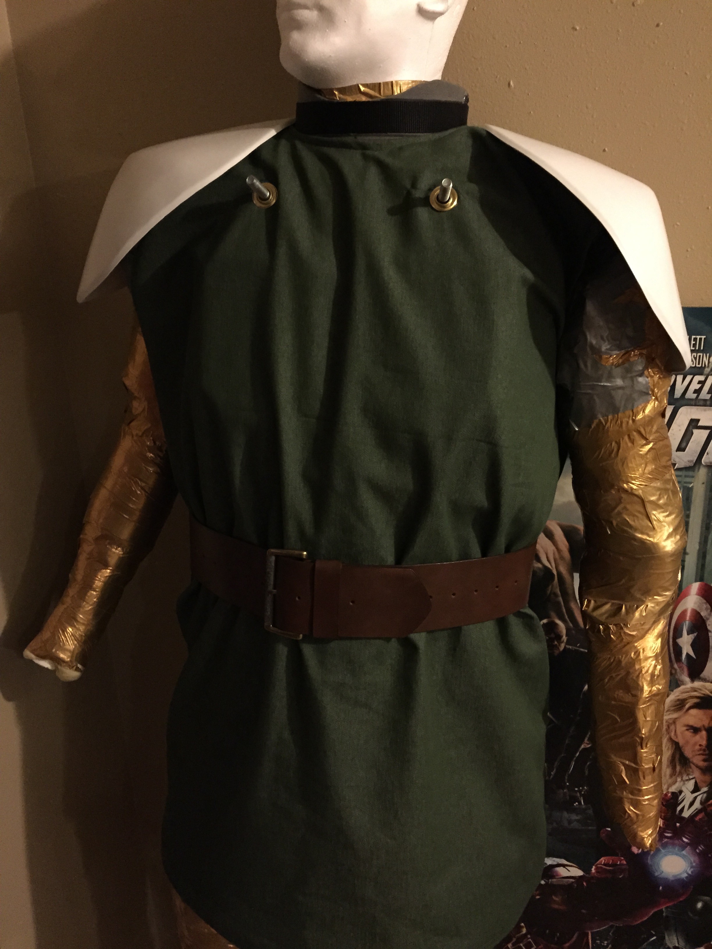

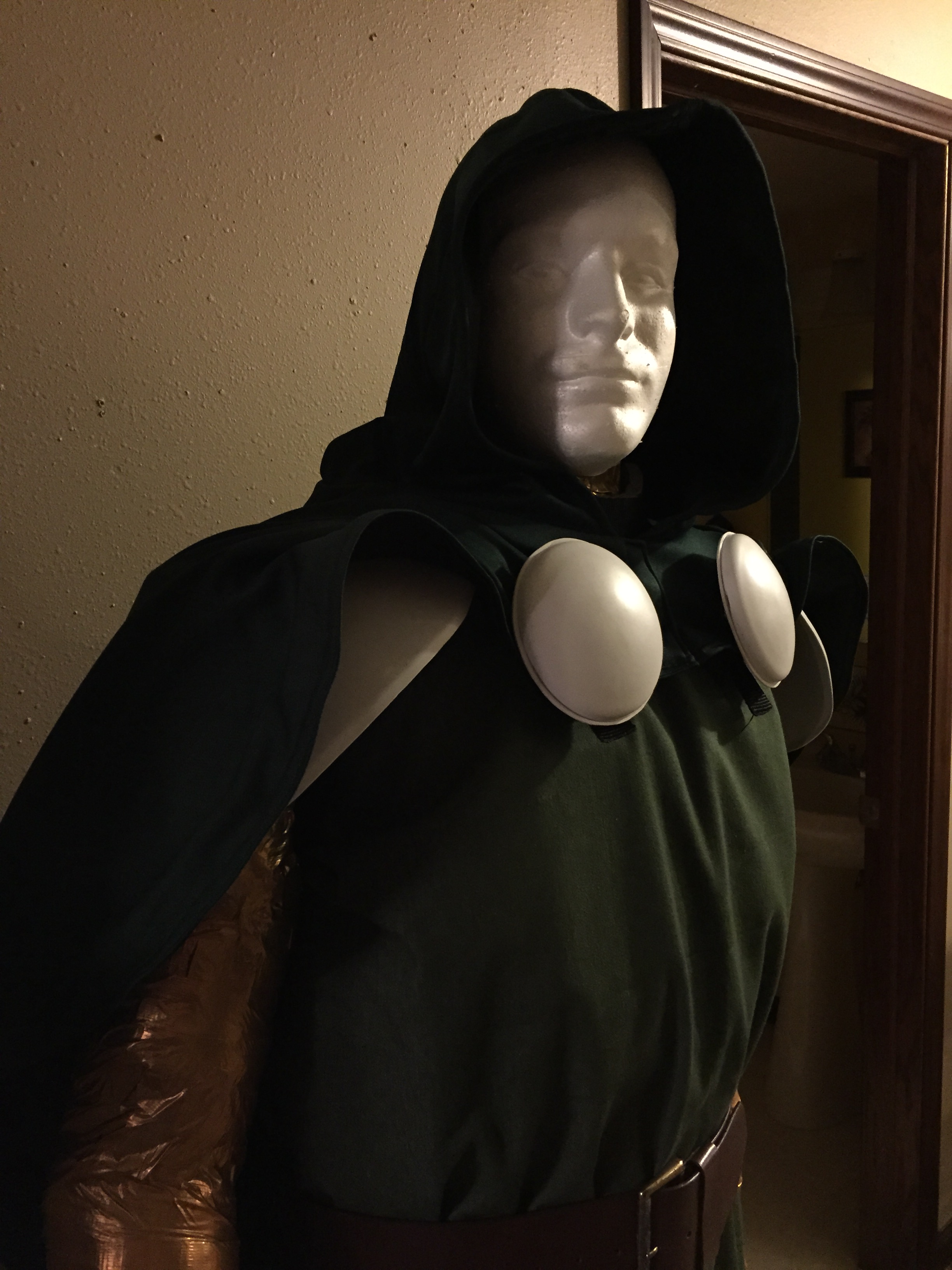

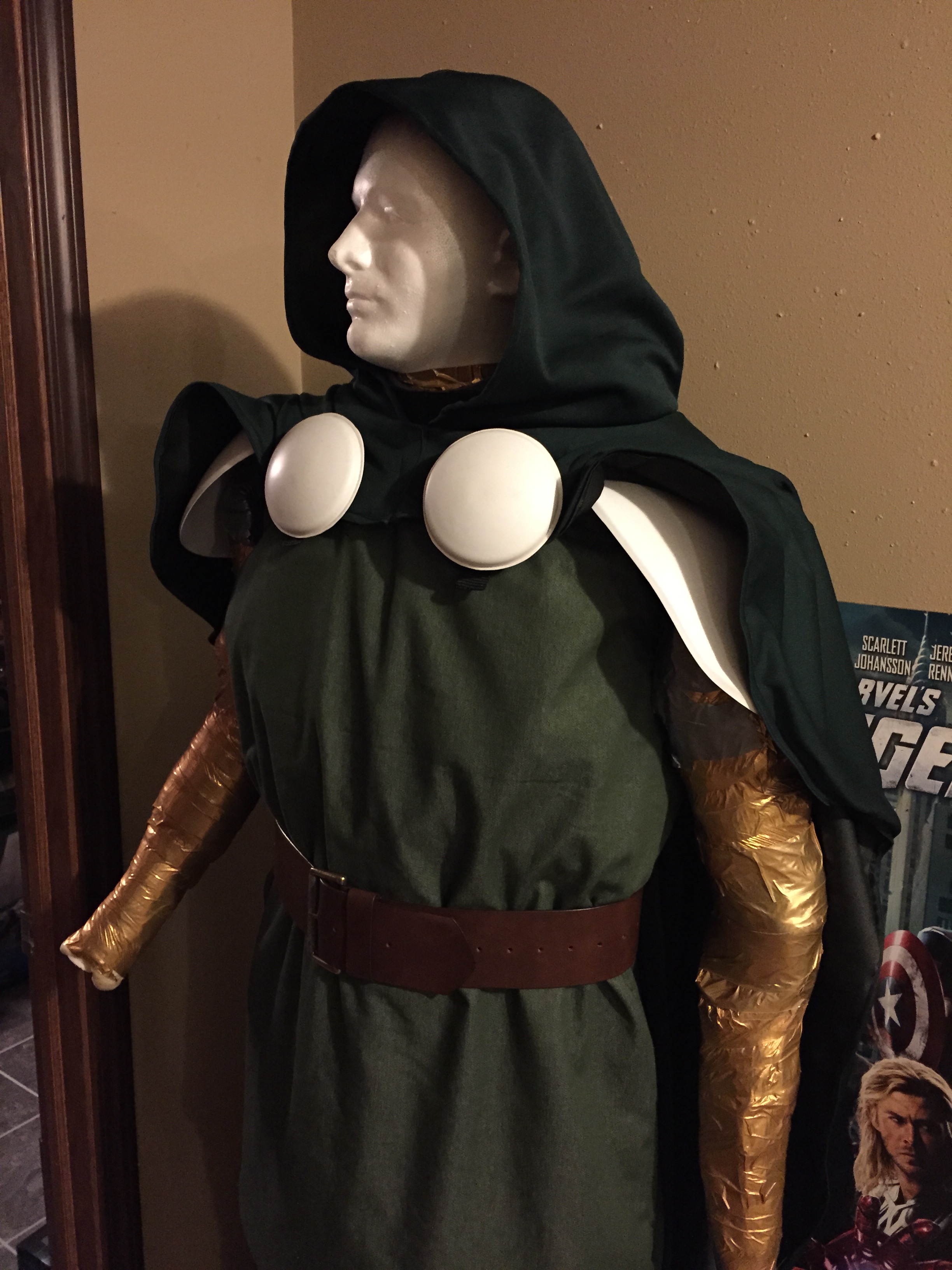

Over the weekend I finished up the tunic (fully lined, hemmed all the seams and added the grommets for the rondel posts. Here is how it looks on the dummy with the belt.
I also finished the cloak. The cloak also has the grommets and fits over the same posts and then the rondels screw over that. I added a three pleats on each shoulder to pull the cloak back and give it that "comic book" wave as it goes over the shoulders. Between that and the cloak being attached to the breastplate the look should remain the same as he walks around and poses for pictures.
