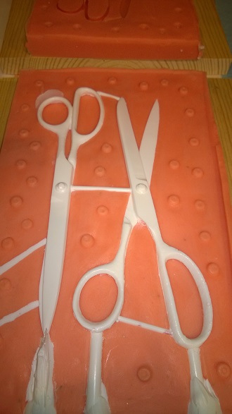

Definitely taking this thread to heart now. I've been getting by without a vac, or pressure tank, but I did some casting last night which really highlighted the need. I'm making some scissors for a costume (SmoothCast 65D, so they're slightly bendy), and they were really tough to get right without a tank. I finally got some decent ones by cutting in more air channels, but sure would have been nice to have the tank. Yeah, I could have made my life easier by adding more channels when molding too. :)
Am I assuming correctly that a pressure tank would have fixed this problem?
Bummer
Better
Sinned - no doubt a pressure tank would have helped but what you really need to do is give the trapped air someplace to escape as the resin filled the mold from the top down. What I would do is cut little tiny bleed channels, not even 1/32" wide from the very bottom most parts of the mold, the tips of the open scissors and the bottom of the handle loops of the closed, out to the edge of the mold. Yes, a little bit of resin will leak out before it sets, but your fill reservoirs should hold plenty of resin to keep the mold from "bleeding out". I would also consider widening the fill inlet on the pointy end of the closed scissors to let the resign in faster, while it still has the least viscosity. Yes, you'll have a littler bit more to trim and file off the finished casting but that won't be too bad.
Good luck!
DaveG is right. I think setting up your mold a little differently would make a difference in how it pours up. You need to give the escaping air a way to get out, which is really hard if the air is trying to get out the same hole the resin is coming in.
I'm a fan of running a "fill" sprue down to the bottom of the part, so that it fills from the bottom. The "vent" sprues can then easily allow the air to escape out the top.
