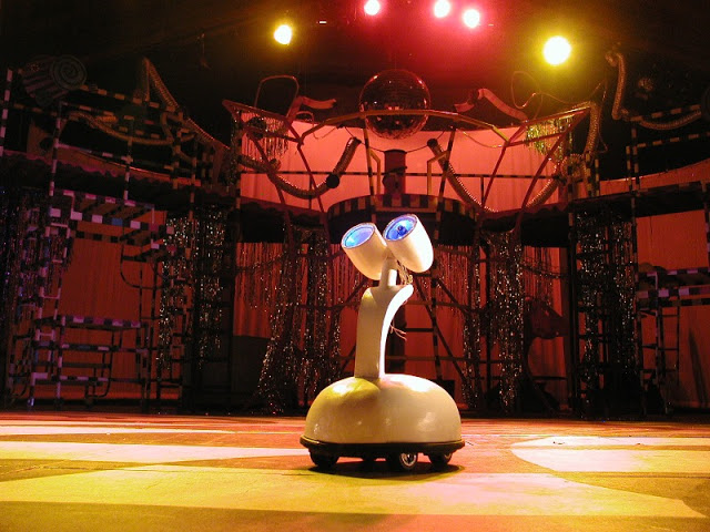

    Did it: EV-E01.jpg
    I used a cheap RC car -- stripped off the body and hot-glued it inside. The weight of the robot was almost too much for it and the speed made it difficult to control, but it made it (mostly) through a four-week run.
    Used it for Willy Wonka. Besides the LEDs in the eyes, one eye held a cheap wireless video camera that was played back live on stage. The actor driving the prop from the wings also provided vocalizations on microphone.
    I would strongly suggest paying for speed control, and looking into a tank as Tedzz suggests; otherwise it is just too zippy to control. Unfortunately, although there are a lot of nice robotics chassis out there, they tend to be crawlingly slow, and once you get above the footprint of a paperback book, unfortunately expensive. The main advantage to a full modern R/C car rig (costing around $400 to put together) is controllability, power, range, and the ease in adding on additional channels for tricks like eye lights, ear servos, K9's head bob -- as if you had time to do any of that on your schedule!

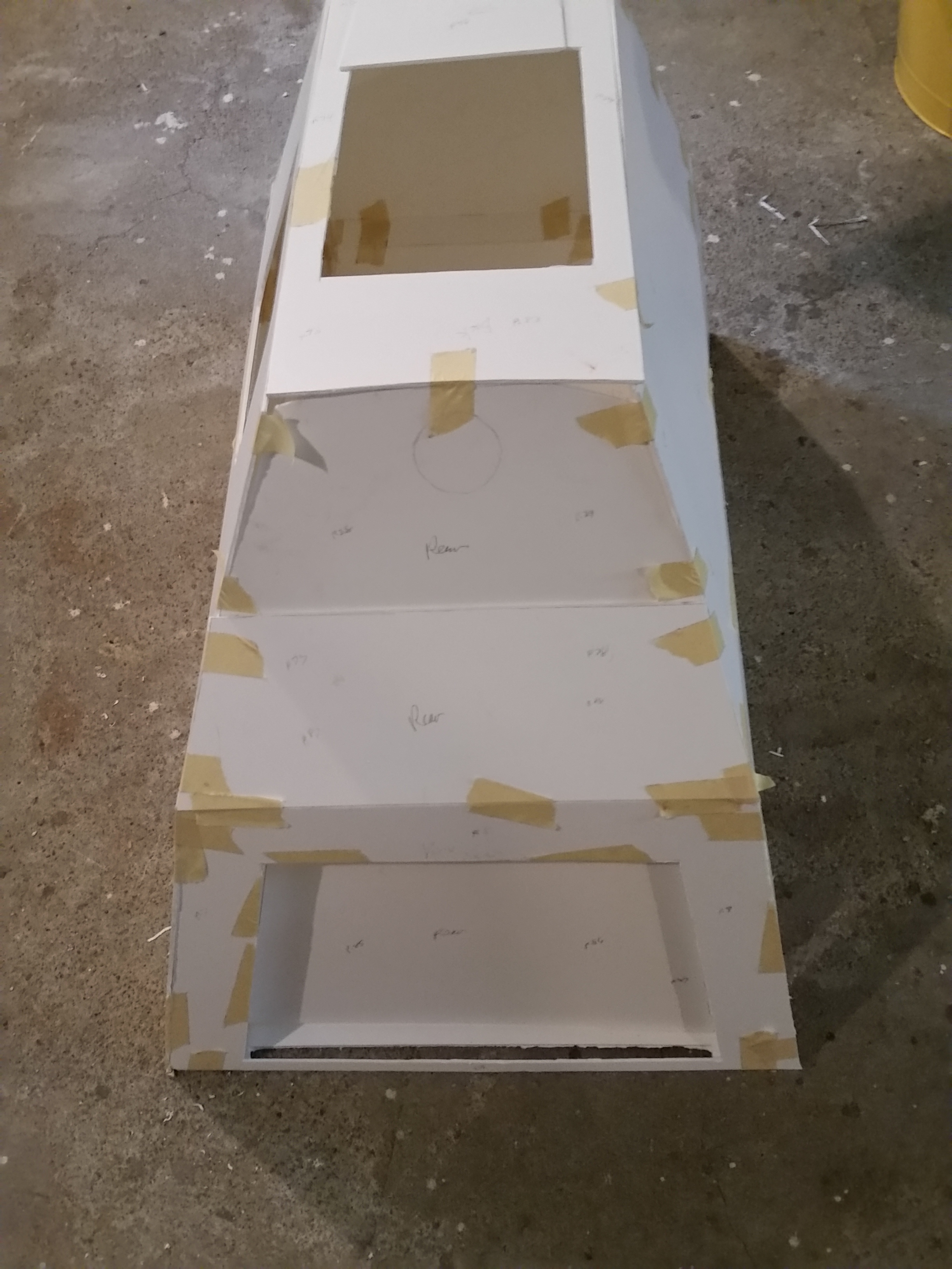

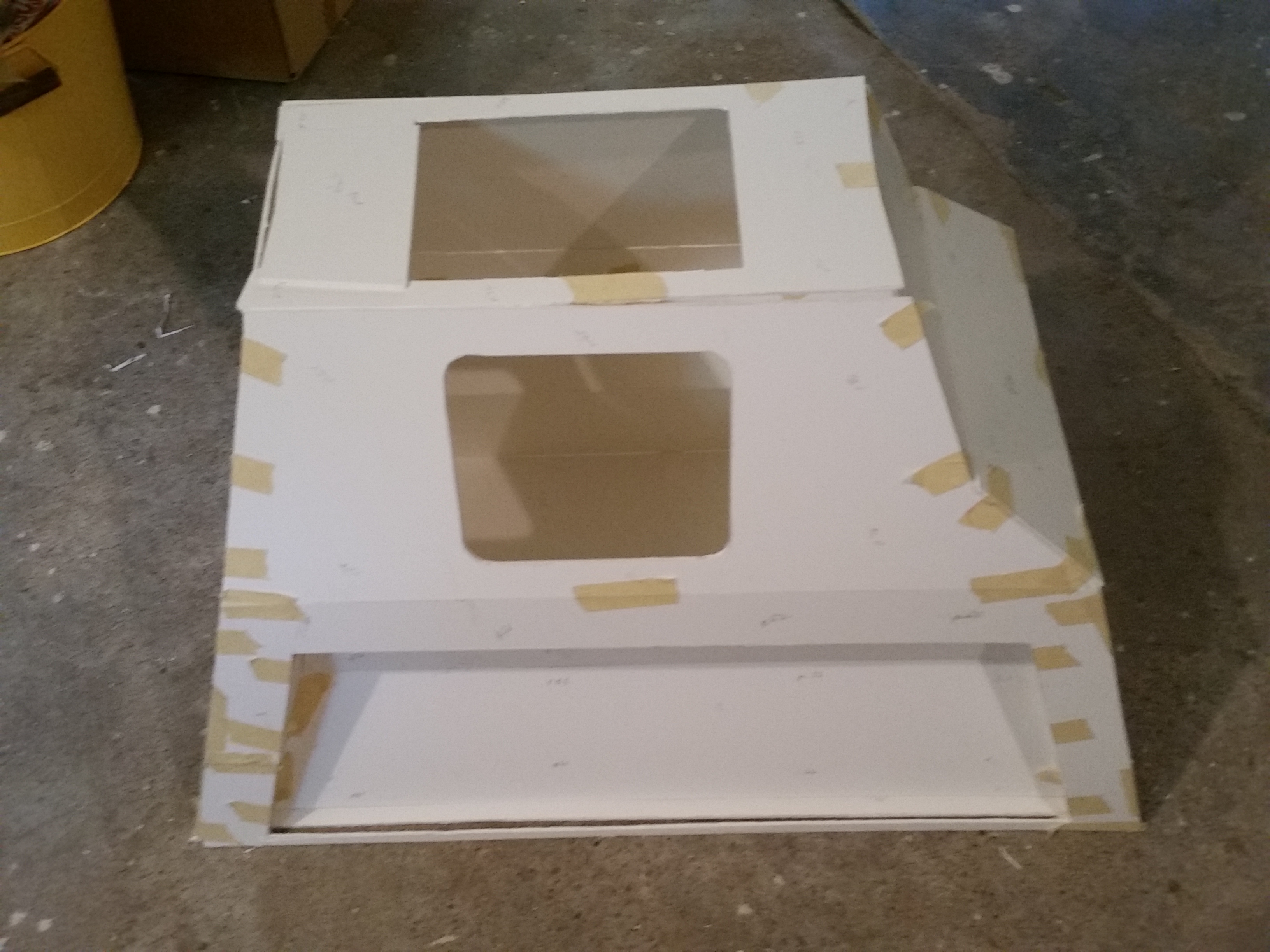

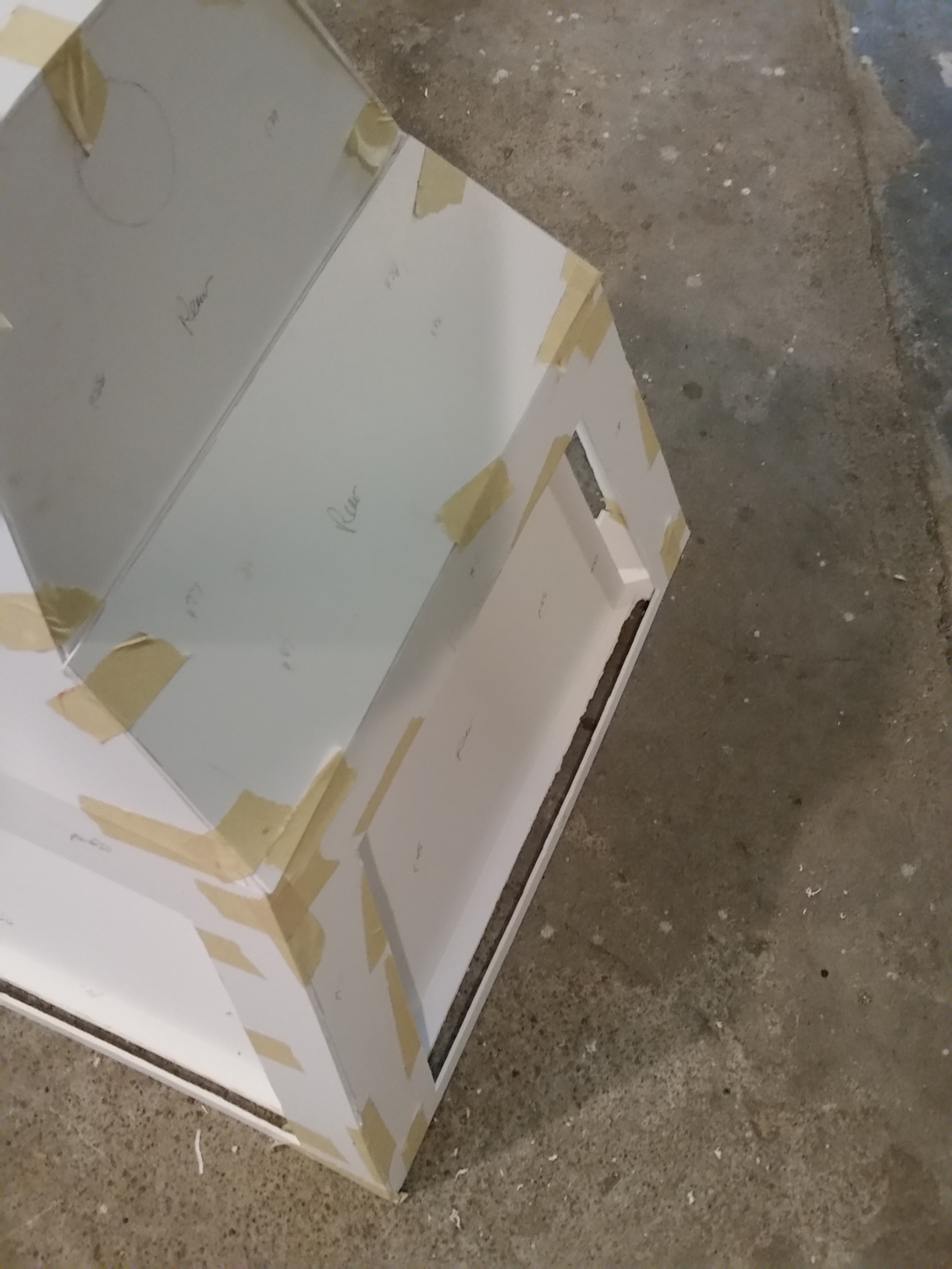

    OK, here's an update.
    I'm attaching some photos I took on Monday night. These are simply showing how I've taped a lot of the body parts together, just to see how things line-up.:
    2015-08-10 15.36.30.jpg 2015-08-10 15.36.41.jpg 2015-08-10 15.36.47.jpg 2015-08-10 15.36.54.jpg 2015-08-10 15.37.04.jpg 2015-08-10 15.37.11.jpg 2015-08-10 15.37.23.jpg
    Now, I've assembled this stuff after printing off the Pepakura files onto cardstock and then only cutting out the larger pieces, tracing them onto sintra, and then cutting them out. I've included photos showing that there are some minor problems with the Pepakura plans: Two sides end up with a thin bar on the outer bottom edge. Two sides do not. There are a few gaps where some pieces, roughly an inch or so wide, are missing. I know two of them are missing because they're a part of a much, much larger piece that I have not printed off, as it became apparent to me that within the Pepakura plans, they sort of repeat the entire bottom piece a second time, plus I think there's another horizontal layer they shove inside it that seems to be unnecessary. So, I'm going to have to measure and custom-cut a few odds and ends.
    My big concerns.... keep in mind I have until August 20th to complete this:
    a) Mounting the head. Sorry, I haven't included any head photos yet, as it's still half-assembled. I have to take a heat gun to a few key head pieces, in order to curve them, before I can continue much further on that. BUT, I did purchase a "Lowe's Flex Drain Downspout Adapter" that has a 4 inch diameter. I'm thinking that should just be an outer piece "for show", while inside it, I use a piece of PVC pipe to do the actual support. My concerns are how to connect it at "both ends" so that the head stays up. Yeah, maybe just an adhesive connection between the base of the head and the PVC pipe will suffice there, but I'm not sure how I'm going to connect or support the other end that's inside the body.
    b) Overall structural support. I feel like I should be gluing in some sort of supportive plastic beams inside, as the top half of the body seems very flimsy. I did a brief look around my garage and the only thing I had on-hand was two plastic rods... the kind that come attached to window blinds and act as "turners" for them. They're hex-shaped, actually. I think I need to spend a good 30 minutes running around at Lowe's and using my imagination... see if I can come up with some lightweight plastic beams to use on the inside.
    c) Buying a car to motorize this. I went to Walmart before running off to work yesterday morning. I looked at the $30-40 price range cars, which were similar in size to the one I posted from Amazon in my previous post. However, on the shelf underneath those were larger $60 cars. They didn't seem to have a prominent brand name, but they WERE larger than the 12 inch long ones I was looking at. But I just can't justify plopping down $60 at this point. (You see, in addition to materials and tools for this K-9, I've also spent $60 on a pair of maroon Converse shoes... plus another $100 on a 10th Doctor coat.... and then there's the $20 on the Sonic screwdriver... and I still have to buy a dress shirt that fits. <sigh> The costs just keep climbing. (Ideally, I'd wanted to buy a digital photo frame to use as K-9's side display screen as well, but very few of those are battery operated... plus it seems like I'd be looking at spending another $40 on that.)
    And I'm still looking for a stupid red suction cup / dart tip. (You'd THINK I'd have spotted one in a dollar store by now!)
    So, that's where I'm at. If anybody has any advice for me, please post!!
    Tonight, I won't be around the house very much, so I won't get much gluing done. But I hope to be cutting out K-9's mesh ears and the red acrylic that covers his eyes. I will be ordering about 15-20 white LED's later today.
    Thanks!
    -= Dave =-

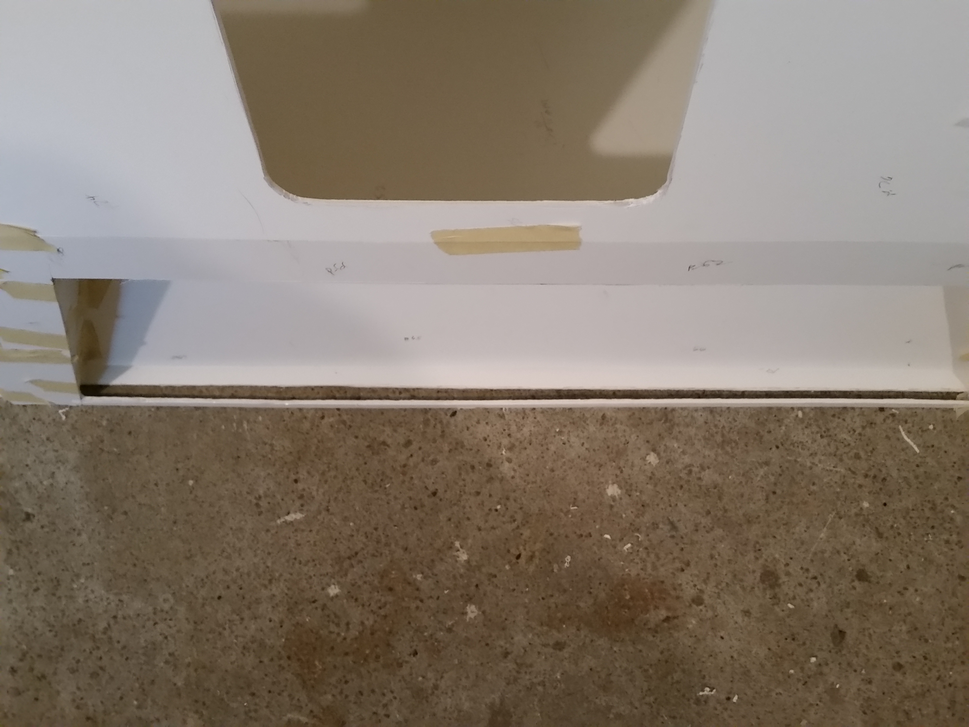

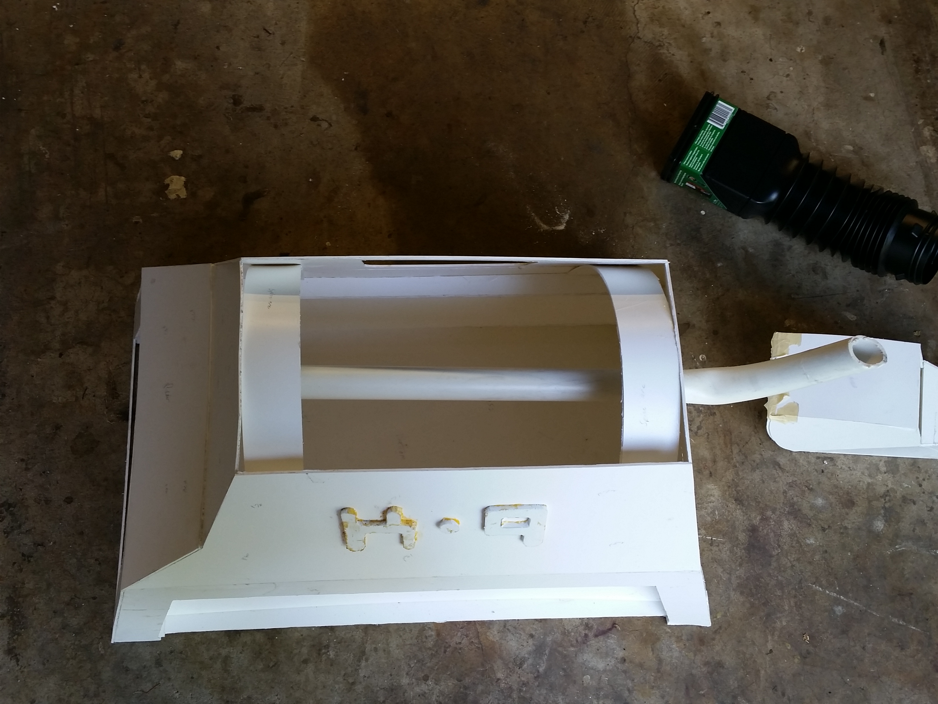

    20150816_181119.jpg 20150816_163122.jpg 20150816_163110.jpg 20150816_163100.jpg
    Well, I'm almost done with assembling the main structure of K-9. I need to recut and refit the back piece, plus I'm hoping to attach it with magnets. A few issues:
    I had purchased some white wood filler to smooth some borders /edges and fill some gaps. But it came out so chalky, it was hard to spread...so it was basically unusable.
    I'm also not sure how to attach the PVC neck into the hole in the head in such a manner that it doesn't drop below a certain point....and yet, it sure would be convenient if I could detach it again, if I needed to.
    If anybody has any thoughts on that, please let me know! I have to have this ready by early Thursday.

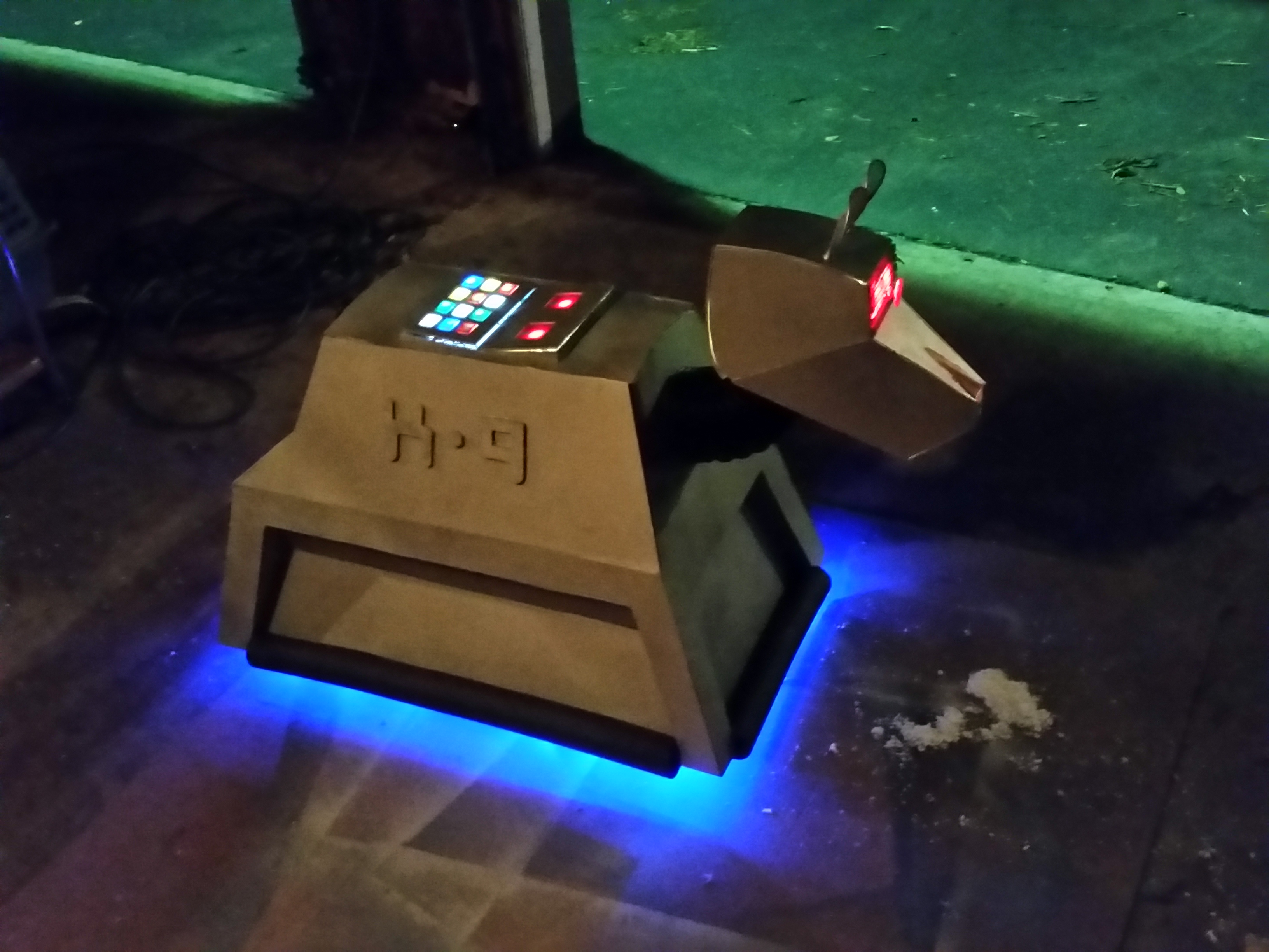

    So, with tomorrow being my deadline, here's what I've got:

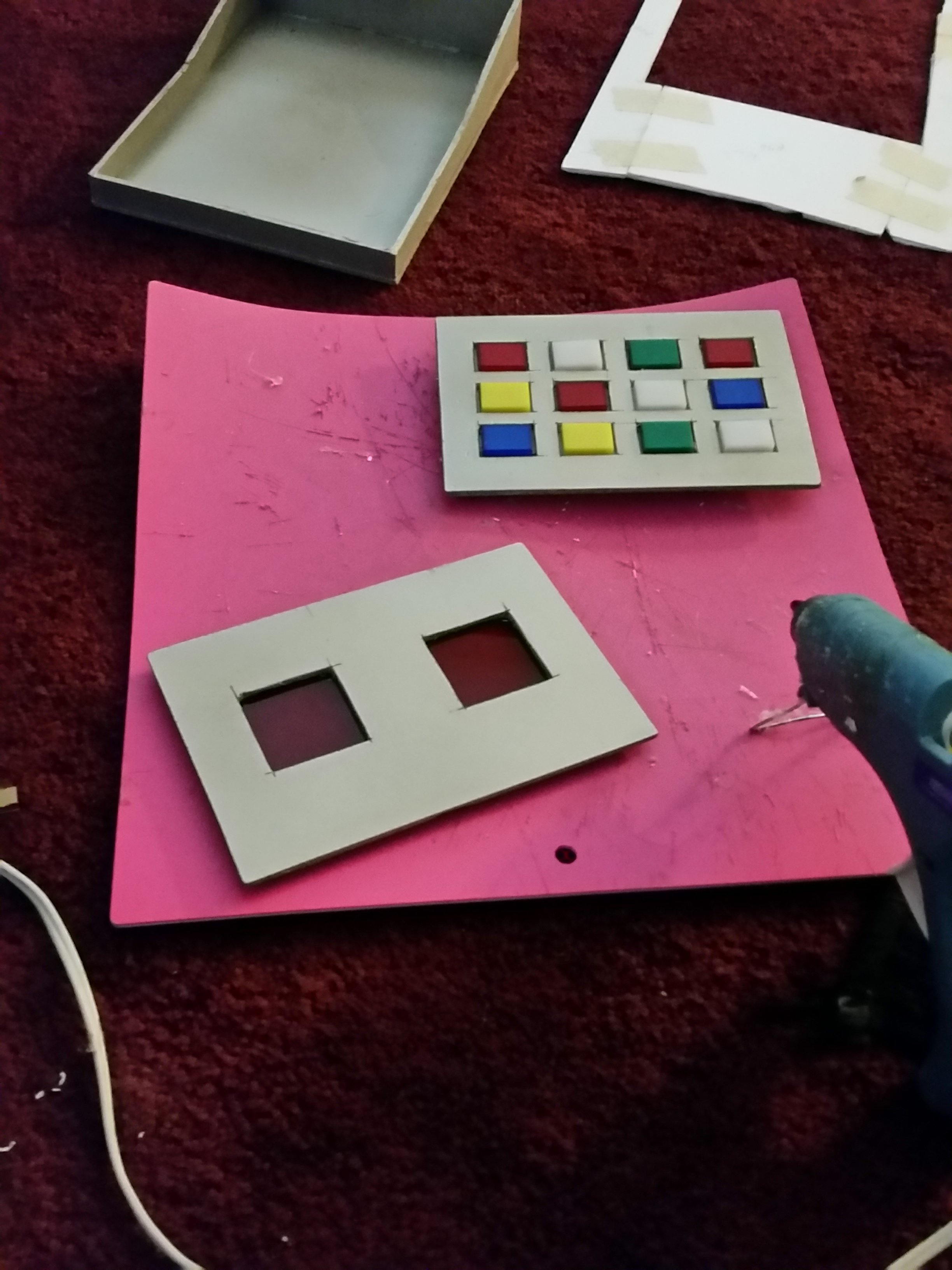

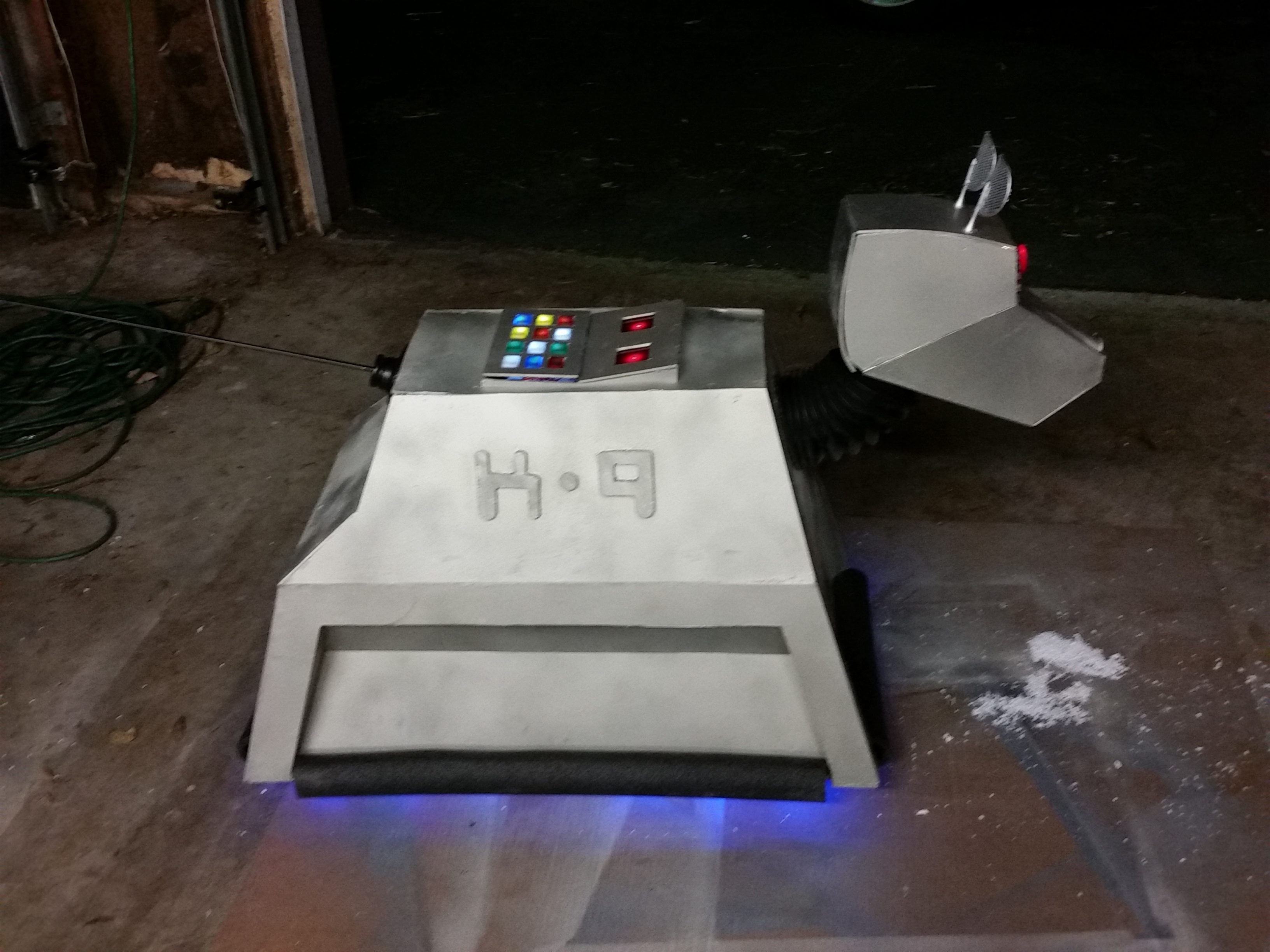

    20150819_205720.jpg 20150819_205825.jpg 20150819_205730.jpg 20150819_205849.jpg
    Hot glue turned out to be my best friend, as the plastic adhesive I was using for the body just wouldn't stick to other materials....and even that E6000 adhesive didn't work on a lot of things.
    The so-called "warm white" LEDs I bought off of eBay really were "not very bright" LEDs. I used them in K9's 12 control buttons, but I'm not exactly thrilled with the results. So when it came time to do the two big red control lights and the two eyes, I wanted some other solution. So, just this morning, with one day to go, I bought 4 of those hockey puck closet lights and raided them for their LEDs and switches. I wasn't looking forward to using electrical tape to make the various connections, but I recently learned that ine can use hot glue to do it! That sped things up considerably.
    A cheap but long string of bright LEDs I bought off of eBay make for a nice glow effect. And as for the gaping hole where the display will be, well, I need that hole to turn on and off the under-chassis LEDs, so I'm just going to try to tape in a good photo from the TV show.
    Gotta run!
