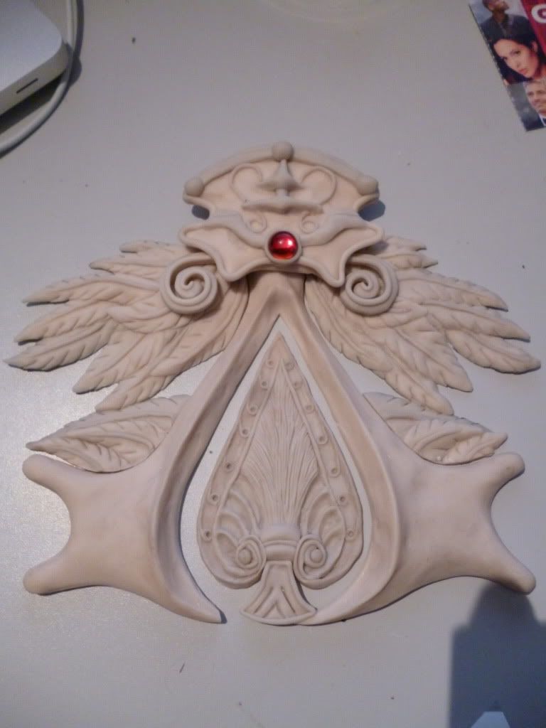

I got started on the belt emblem, and was taking pictures all the way, but yesterday my bag was stolen with my camera in it :cry . Here is what I have done:
Thanks to Fevereon for some good reference
Its my first time using polymer clay (bit stiff) and I'm really happy. You can see a little chip in the bottom, but I have that peice ready to epoxy back on... next up to epoxy it together and onto a base then paint... My current plan is spray it silver, let that dry, then black but before it dries whip it all off so all the cracks and details will stand out. My one problem with this is that is maakes the silver look more dull. I'm thinking I might then go in and drybrush over with a lighter silver again... Any suggestions?

Nice sculpt. Looking forwards to seeing more. Do post what ideas you've got for the hidden blade, I'm trying my hand at making a DAOTF as well. Trying to get the mechanism working for a convention this month, then I'll try and slim down the design and incorporate a gear and make it duel slide.

Man it's been a hectic week! I got my camera back so you can see the photos from the start. SO what I did was print out and laminate the line drawing, law down some sculpey, stencil over that the general shape, build up the sculpey, cut out, lather rinse repeat.

The green stuff is called green stuff, its an epoxy modeling filler. I used it to smooth out certain areas.
http://i155.photobucket.com/albums/s298/ciwi286/P1030548.jpg
http://i155.photobucket.com/albums/s298/ciwi286/P1030549.jpg
http://i155.photobucket.com/albums/s298/ciwi286/P1030550.jpg
I'll have painted pics up tomorrow but the real reason I posted is I need advice. For the vambraces I made a cylinder of cardboard, covered it in expanding foam and sanded it so shape... my plan is to cover that in Bondo, sand and paint... I need people advice though... will it be OK putting Bondo straight onto the foam? Please help... 9 days to the con!!!! :eek
