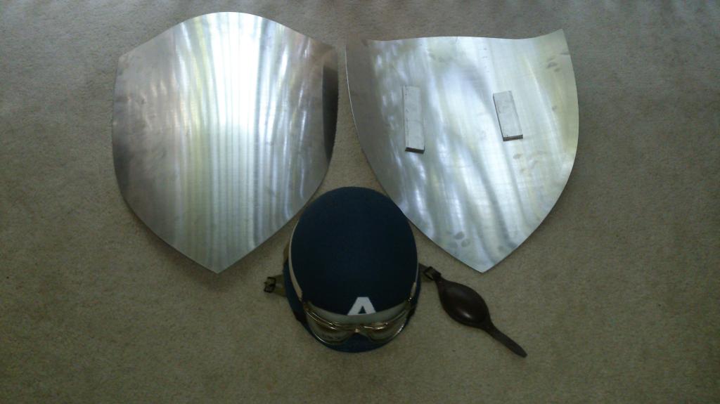

Steve, I picked up the shields from the shop today. The guy that handled my order got a real kick out of it - told me they recently handled a job for Marvel's premier of Spiderman 2, and that one of his employees built an Iron Man suit.
Anyway - your dwg images were perfect. Brought one into my office after visiting the shop, and blew the minds of two friends (one a former machinist, the other a 50 year old comic geek). Couldn't have achieved these results without your help - thanks once again!
Next steps - electrostatic paint, strap hardware, and starting my own Cap A Rescue Version thread.

Valor, just searching info how to attache the brackets, I saw this one of yours and that's how I want to do with my classic cap shield. Instead of what everybody are doing ( movie version) I prefer the way, like in the comics.
here are some questions and I would be grateful if you could help me out.
Where can i get these, how thick are they and how can I cut them or where can i get them cutted or it can be acceptable to use less thickness ones ? ( brackets )
did you used jb, tape to glue it ?
hows the process of attache the bolts?
Okay ... well, let me try to answer that. I don't know where you can get them. I had a local lasercutter make them for me. That same company used an industrial roller to curve the shields. You might want to research laser cutting, or waterjet cutting in your area. Mine are almost 1/4" thick, you can make yours thinner if you wish. I used 3M Outdoor Mounting Tape to attach the brackets to the shields. THe bolts are attached to the brackets by drilling a hole and tapping threads into it for the screws.
