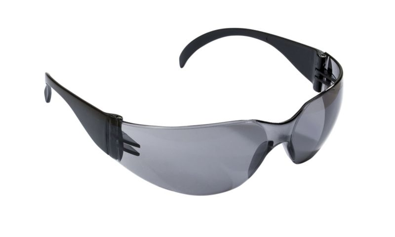

I moved on to Fierfek's ANH TK.
Dont have to worry about finishing other then lenses and already bought a set of smoked safety glasses from B&Q that I hope will work
