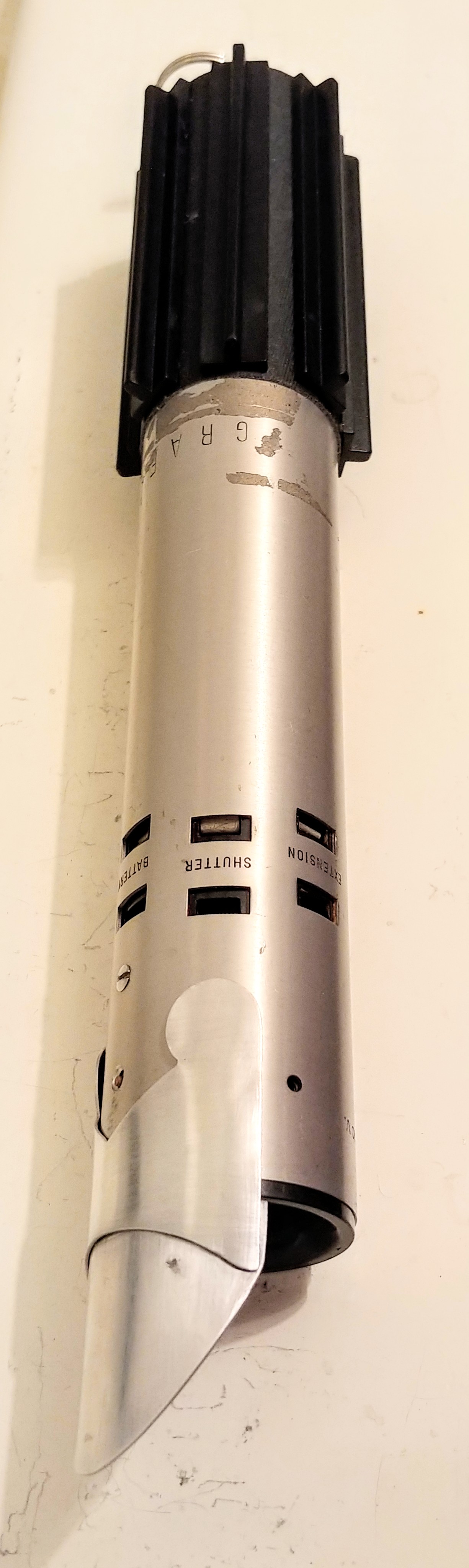

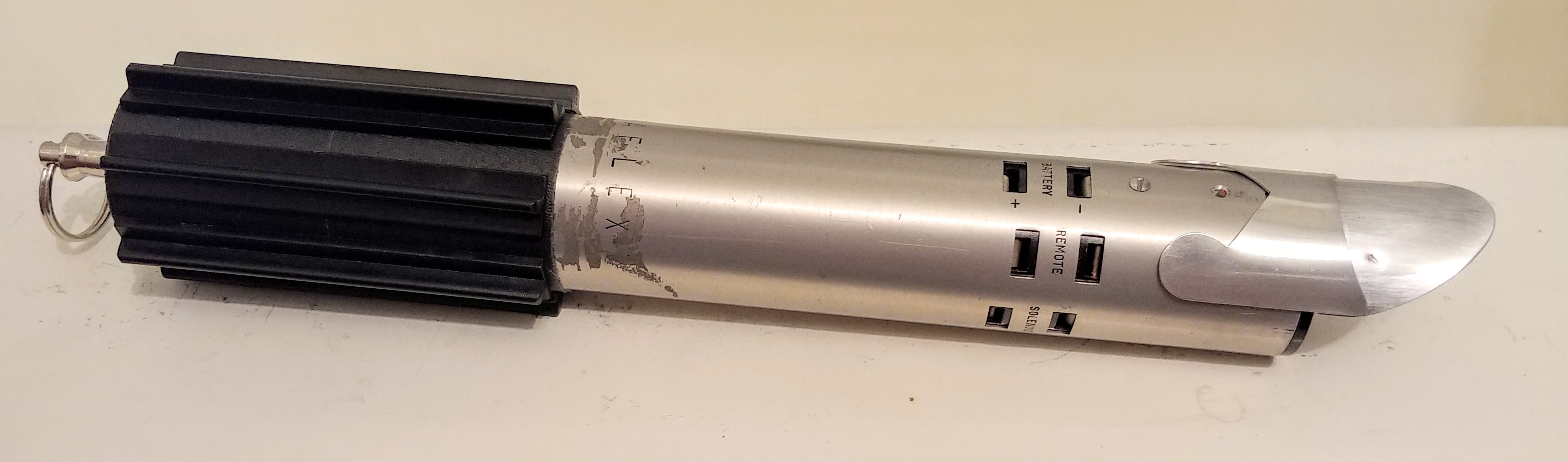

So, was this already discussed, the placement of the GRAFLEX lettering? I feel like it was.
Mines a little higher up than Danny's in his video.
Or did you use Vader grips?
I'm not finished with my shroud, just had to see how it would look on there! Few tweaks to do on that, yet. Need to paint, too.
