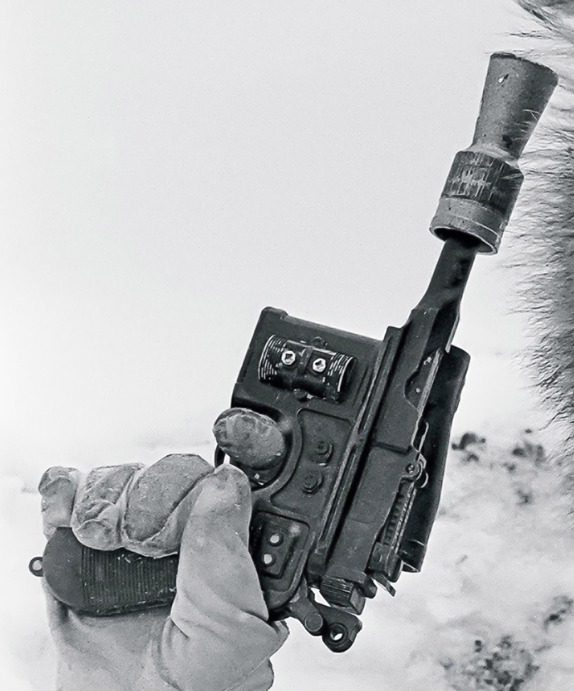

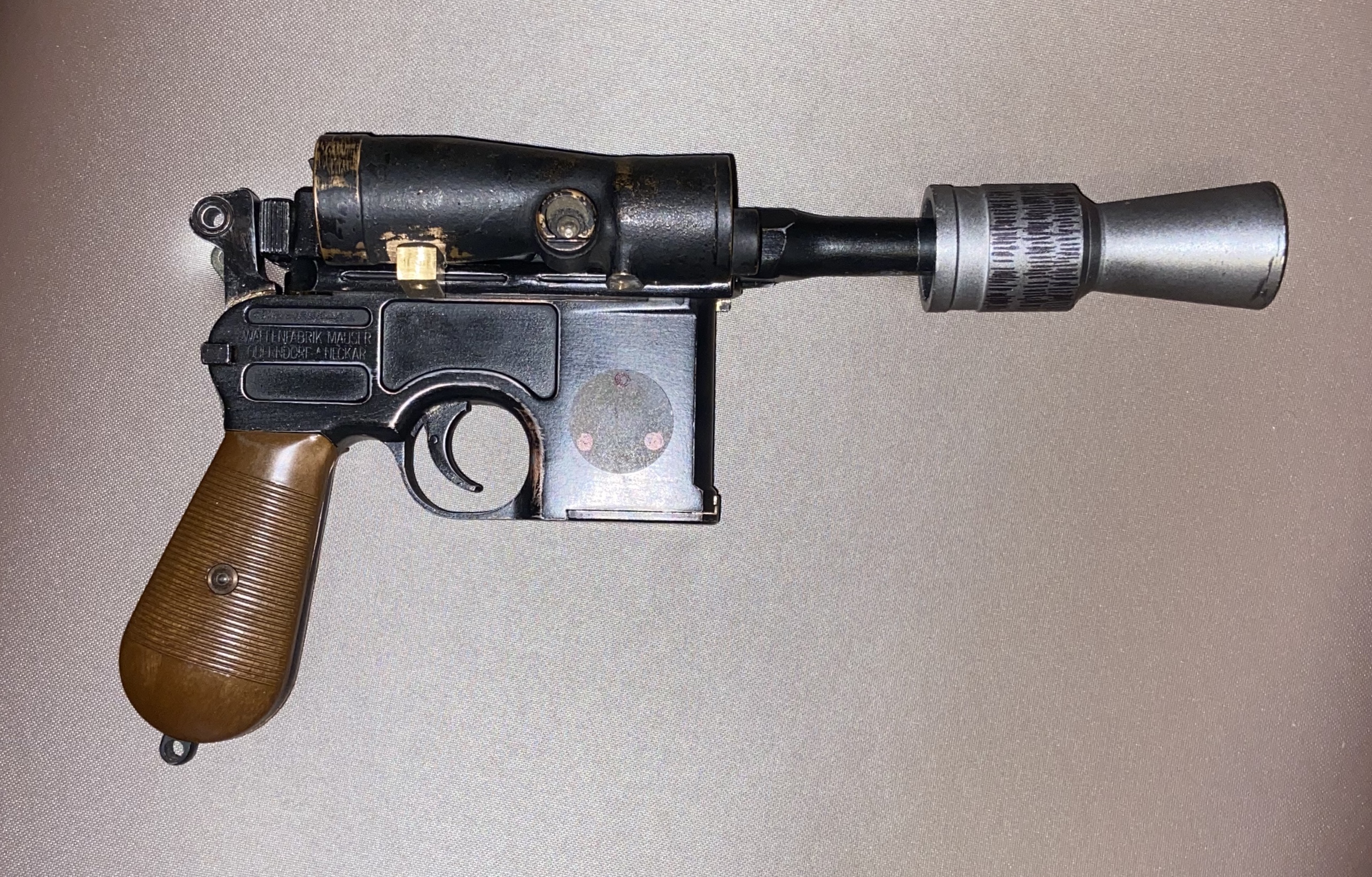

I did some more detective work today, because the spacer is weird
i used (I think) Scott J's photo, Mortifactor's show photo and the NBC stuff.

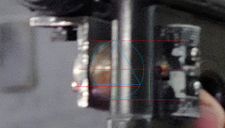

First, I traced the damn thing by hand from two similarly-sized blown up photos
Then I sort-of did the same thing with Photoshop. I traced the nuts on one side and laid them on the bracket side
Same general thing, the rear screws hit eachother.
So, then I did some investigation on the spacer to see if it better lines up with the nuts or the disc screws. It's not 100% but educated conjecture that what it really lines up with was "on purpose." Seems to line up squarely with the nuts on the other side, and not so well with the 3 screw disc
Though it's really close, honestly. While I'm not in the shop, I'm modeling what I think is going on. Unless there is something in the magazine (metal, a bracket inside?) the spacer has to be solid. now, Scott lined his up perfectly so the screws just miss eachother. I'm thinking screws that don't go all the way through the spacer.

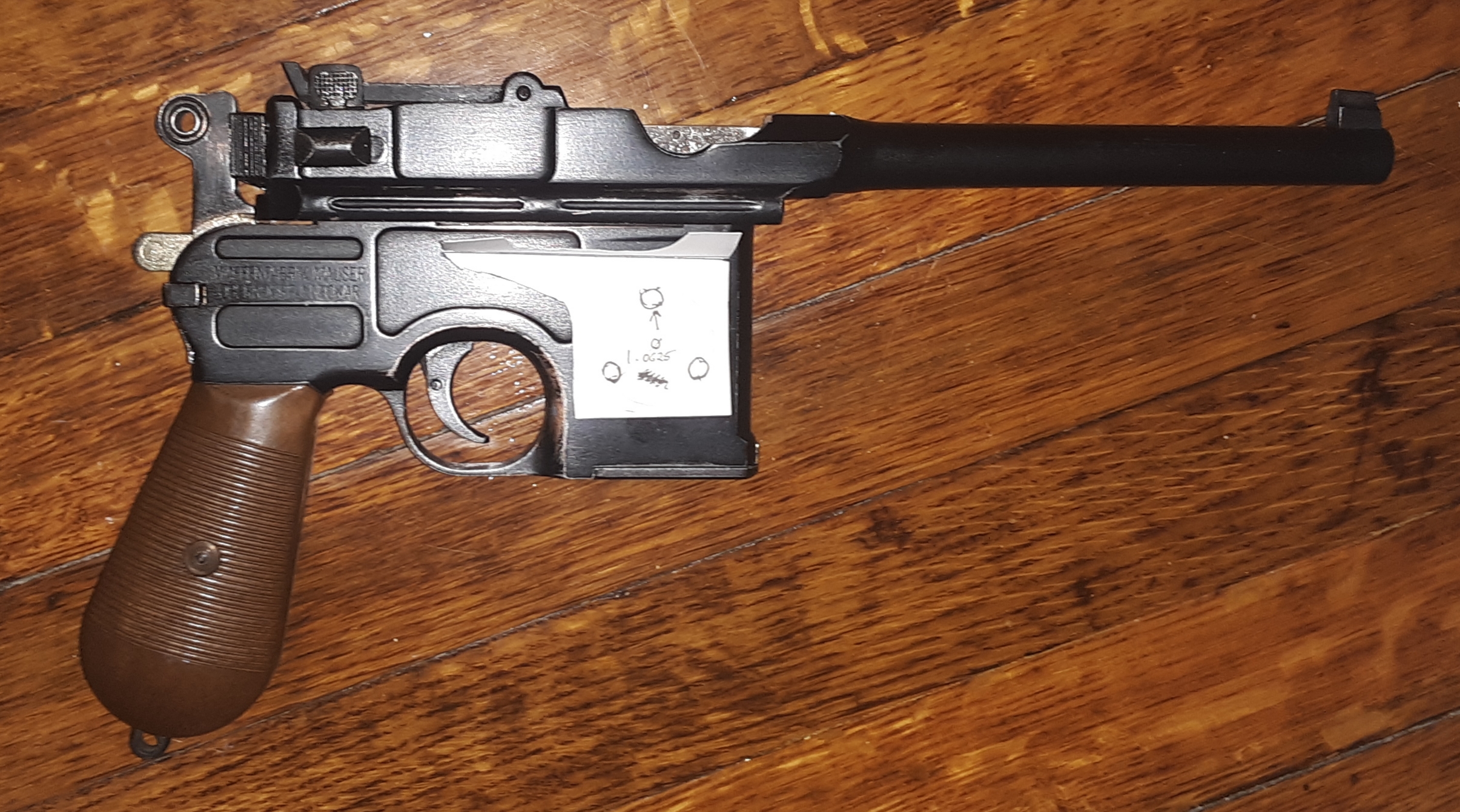

Using mortifactor s photo... i pinch zoomed it to the same size as my MGC. Then i traced the bracket and disc to my liking.
I had to mostly eyeball the top of the brwcket using that 3/4 view and a real M19 footprint, taking into account the extra 1/8.. the thickness of the vertical side
I did it. And yes that disc is probably 1-1/16" which doesnt line up to an easy whole mm size. This is an estimate though, dont take it as gospel
I traced each surface and then patched them together on cardstock and folded it. Now ill have a template to slide onto right angle stock and cut!

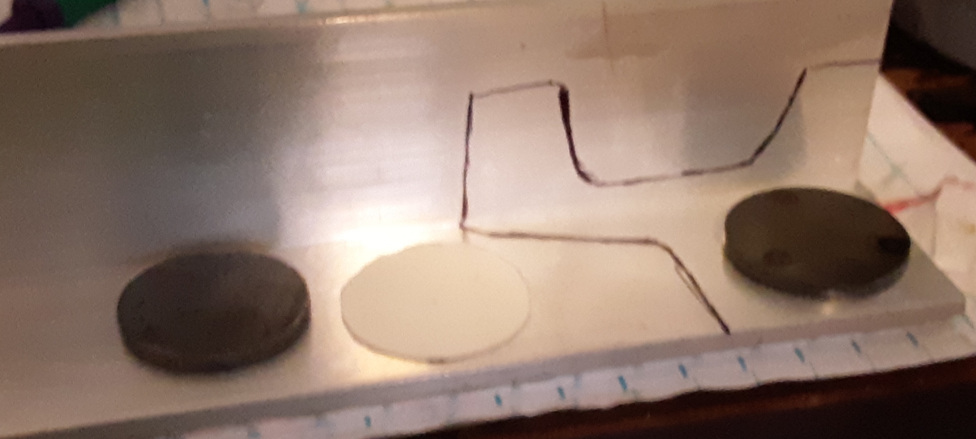

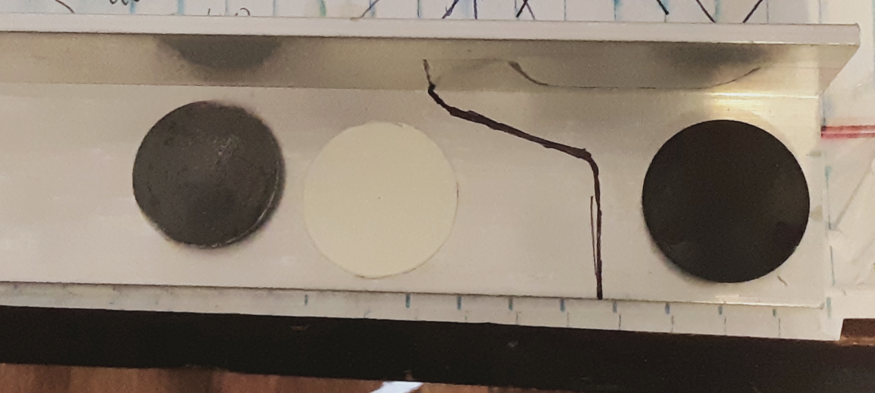

This is a long story - ive xacto cut probably 7 or 8 templates for the bracket. Tracing some, eyeballing others, etc.
Today, after getting the wrong angle stock in the mail and mailing it back i went back to look at the prop. Looks to me like the piston set is similar height to the back of the bracket. Thats an inch and a half. So thats the stock i bought to replace it.
That would make the face of the bracket with the disc on it 1 3/8. It turns out the large part of the bracket is square. I made a line in photoshop and it matches the width and height (though the bracket isnt perfectly square.. crooked sides)
Around 2 1/2 in width too.. got some other guestimates and used these to correct some shapes on my template.. but my latest one still needs fiddling especially with the shapes of the inside of the upper feet... the dimensions are really close

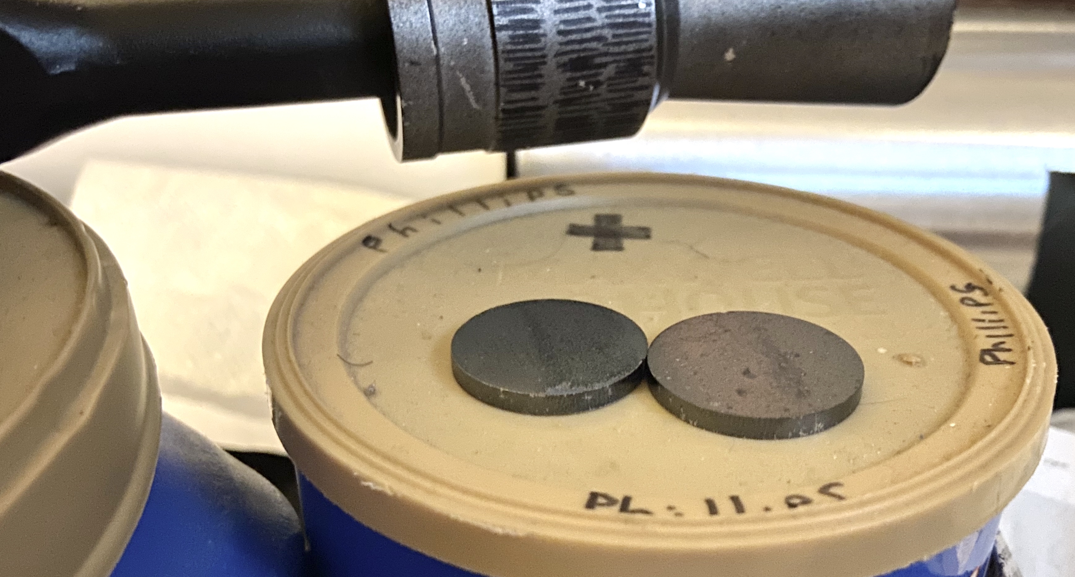

mortifactor said the disc and bracket were two different metals. So, i found a metal designer that sold some scrap...
1" and 1 1/16" steel 3mm discs!
seen here with my Denix hoth gun

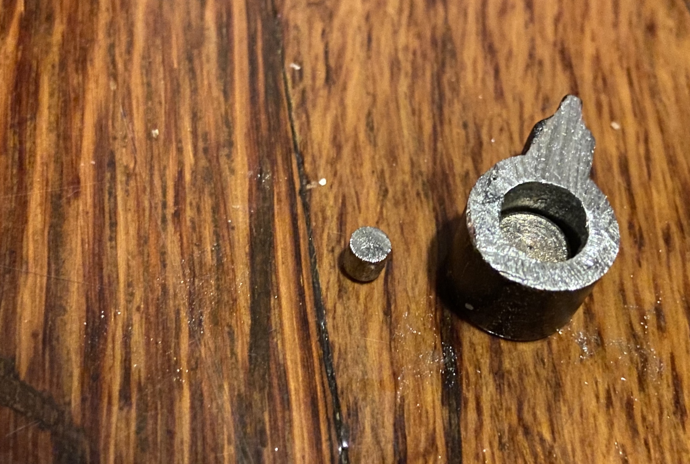

Since this is a rare item, I decided to go slow with a hobby metal hacksaw at the longest estimate for the barrel length, just behind the sight. So... it was precise but took way longer than I thought! Like 2 hours....
there is some metal rod in the barrel, doesn’t seem to run through to the magazine area. The rod ends underneath the front sight.. floating. The barrel has a very short metal plug too, right at the end. By cutting behind the sight I cut the tip off the internal rod.
some sample angles with an Anakin Starkiller flash hider, I kinda want a fresh one for this build eventually, a bare metal finish to start with
View attachment 1319153View attachment 1319154View attachment 1319150View attachment 1319151
View attachment 1319155View attachment 1319156View attachment 1319158
Damn man... good for you
Weird... there's at least 4 variants of barrels then. Lol... The hardened rods in them SUCK to cut for REAL. hahaha
