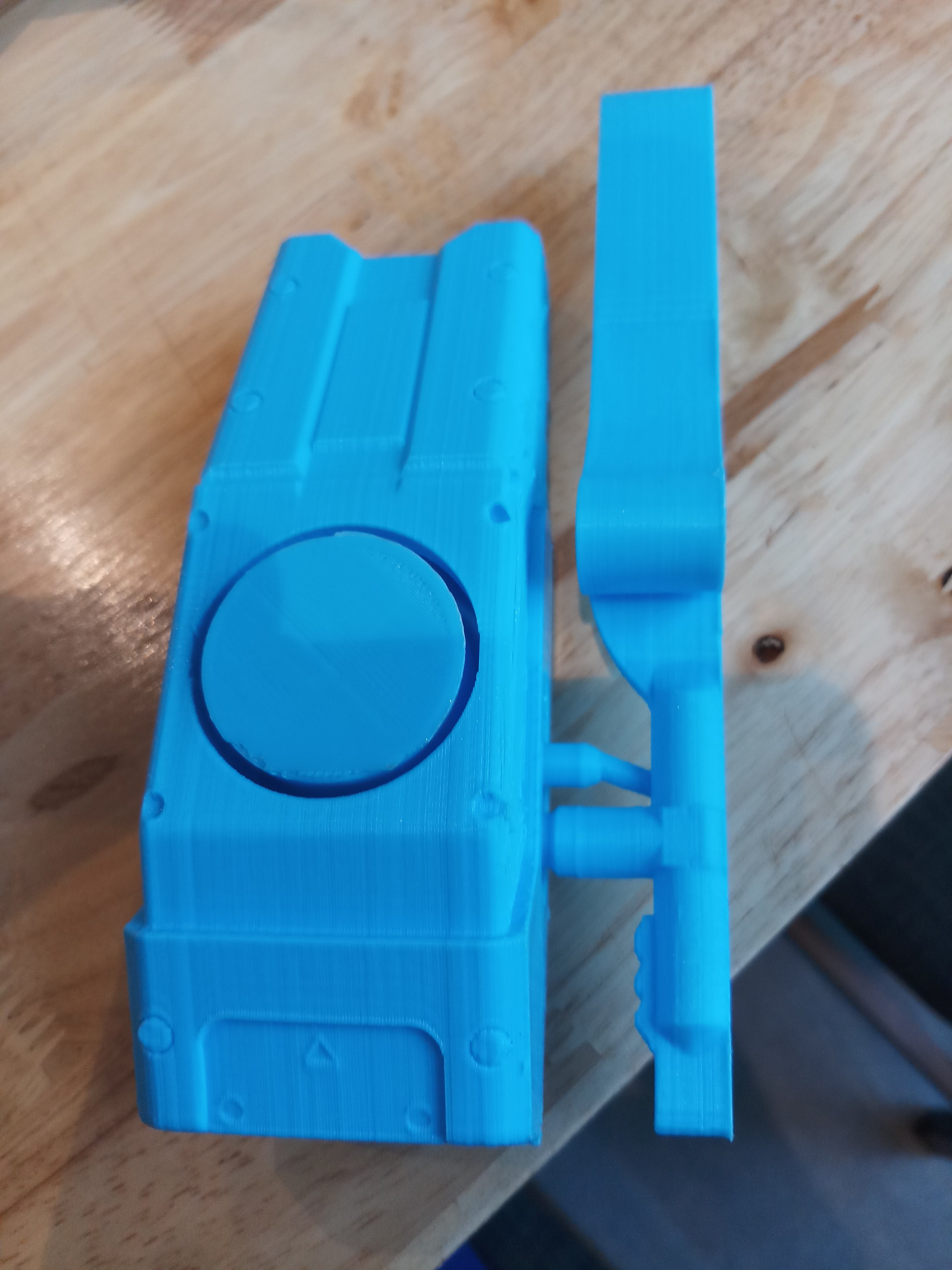

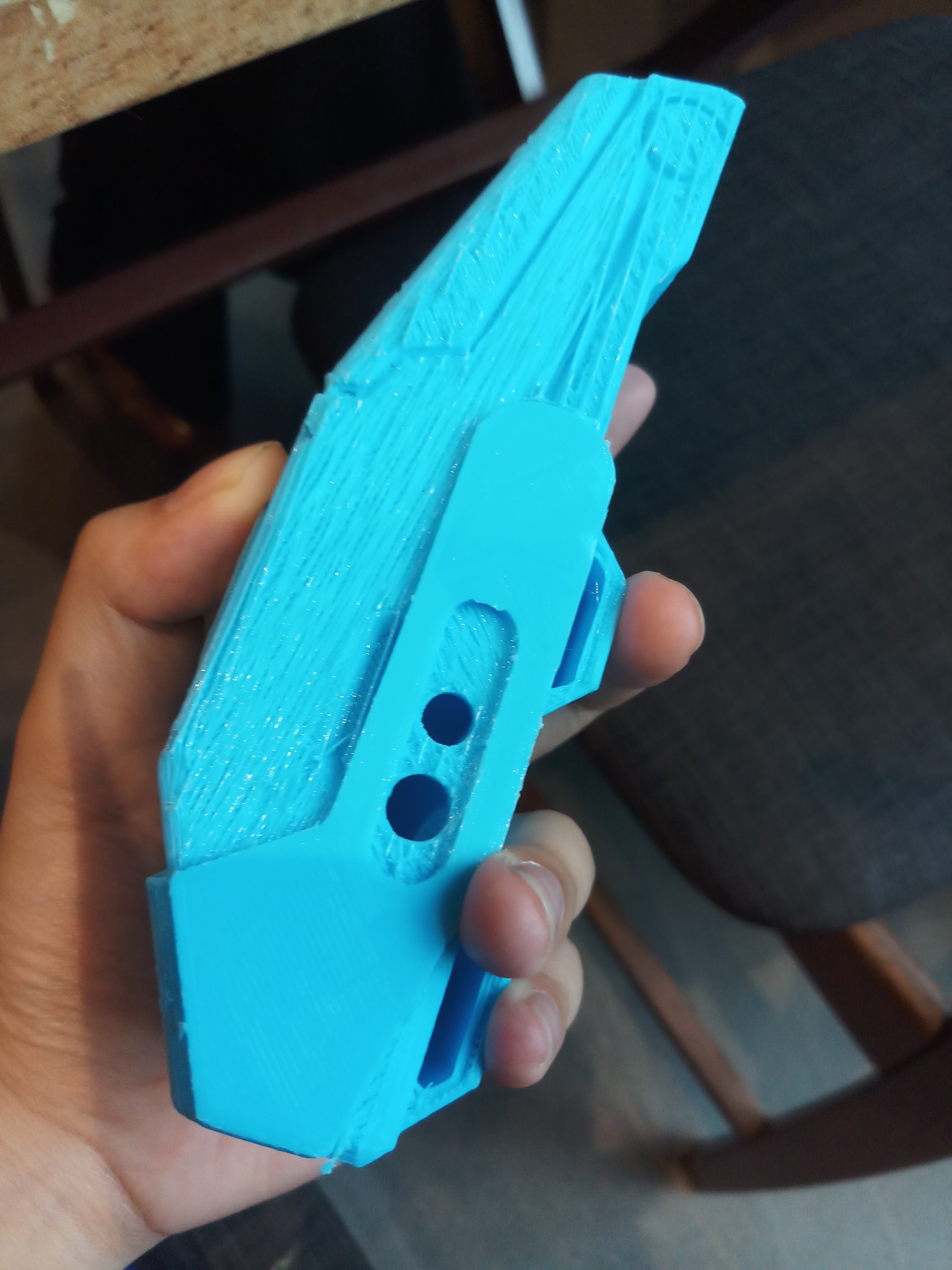

This is me Kornhomie just having alittle problem so I use this account

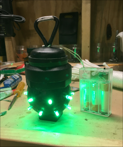

I just printed the ISAC Device but , I was wondering How can I connect the wire to the light inside the body itself???
I can put it in the anthena hole but the anthena it self will come out
So how???
Not sure how to do it with that build of the ISAC, Korn. The one I did, the top was a hatch that opened, so I could put the EL wire through and then close it. It looks like your's is one sort of solid piece? Without a way to access the inside and close it back up, not too sure how you'd accomplish the light feature.
Thanks anyway Keelan

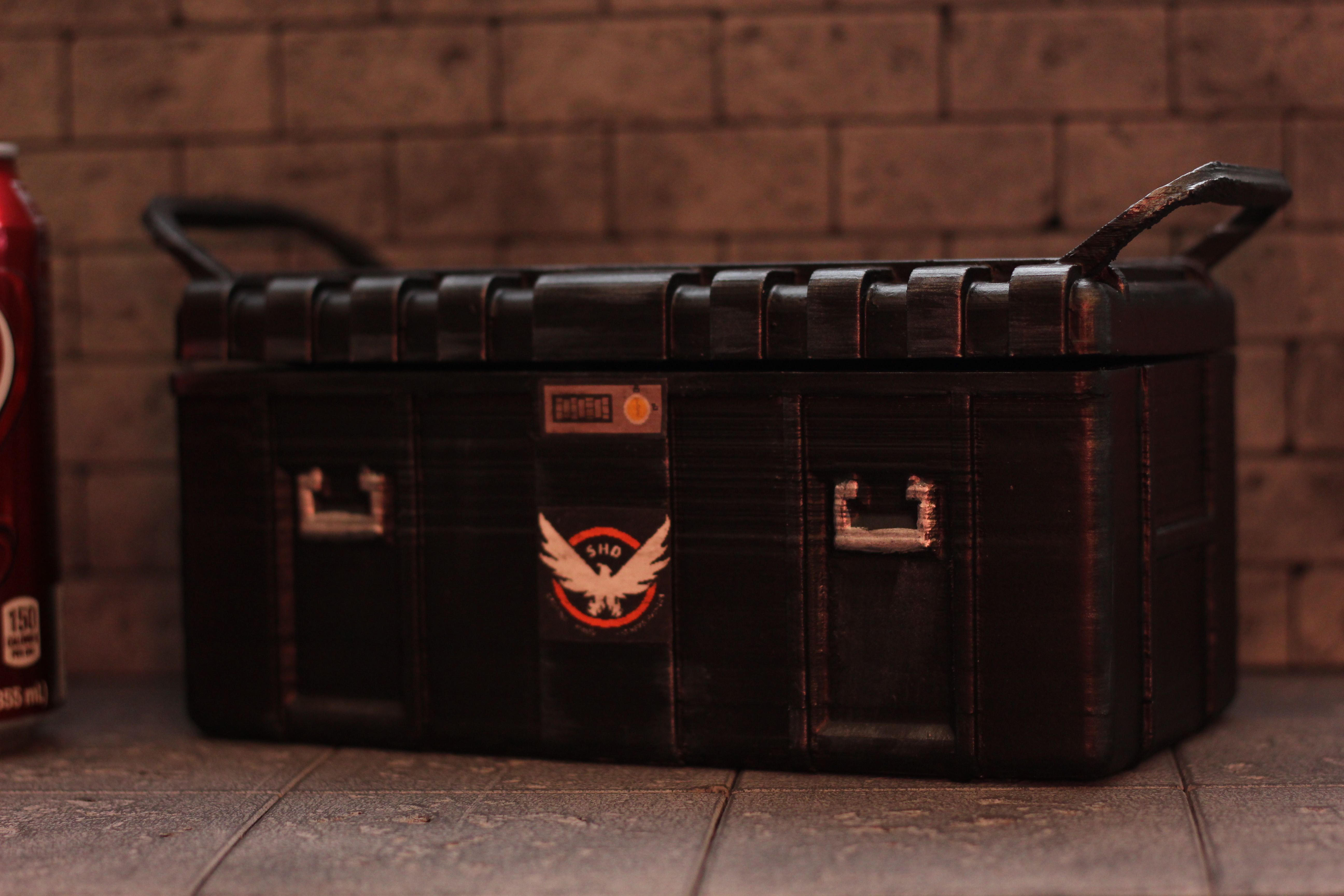

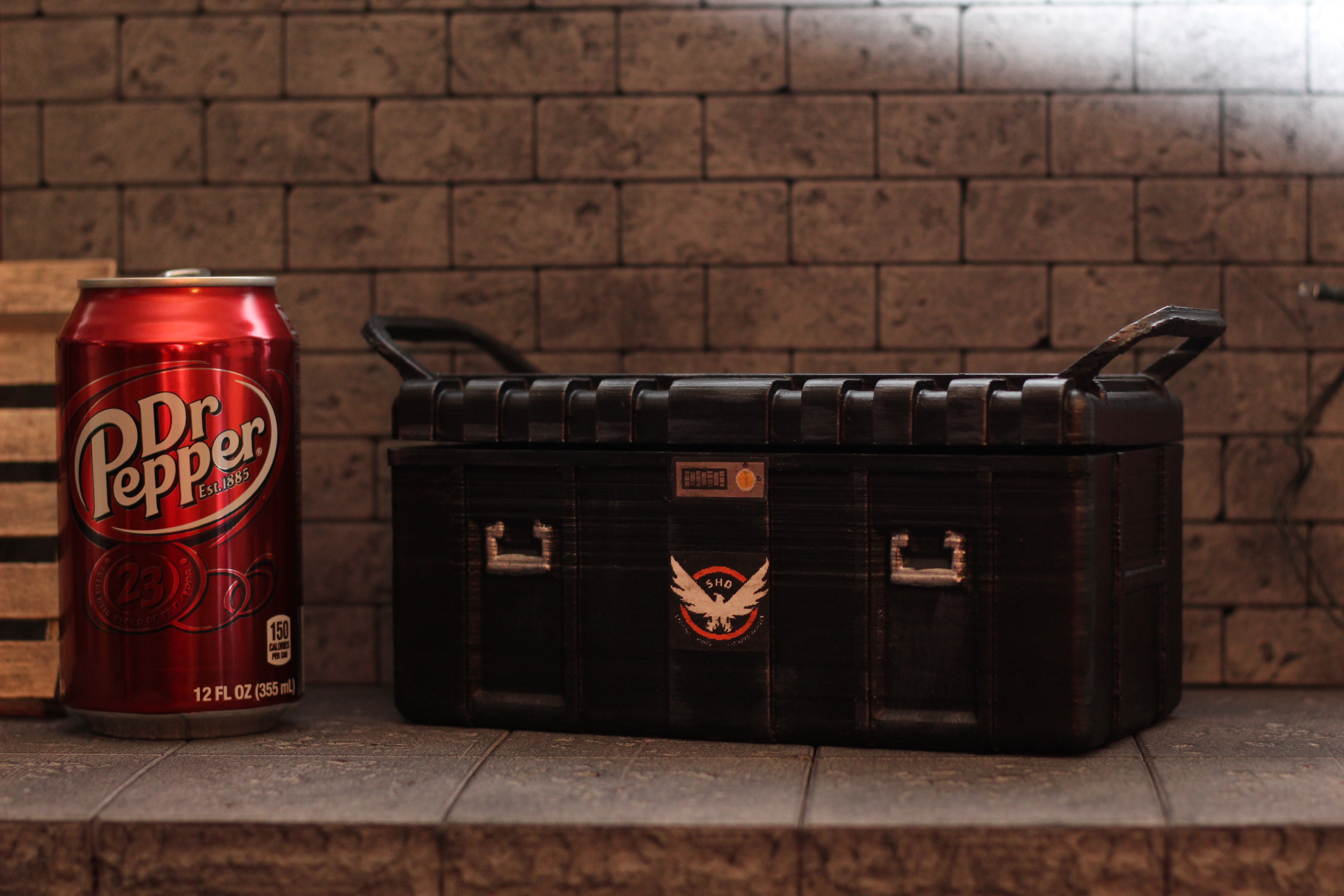

No problem!
Here are a couple of pictures. I mostly got it for use with a diorama I'm working on, but since it's essentially a jewelry box it works for when my best friend comes over to work on projects (she's always forgetting her earrings or rings, so now she has a place to put them :p ).
The second pic shows it next to a standard 12 oz. can of soda so you get a feeling of the scale of it.
The only detail I changed is that I went and did a different paint job on the silver handles (they're just raised parts of the 3D print surface). Other than that, I didn't change anything from how the shop owner sent it to me.

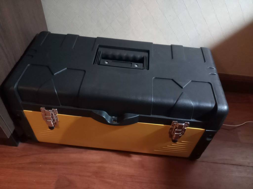

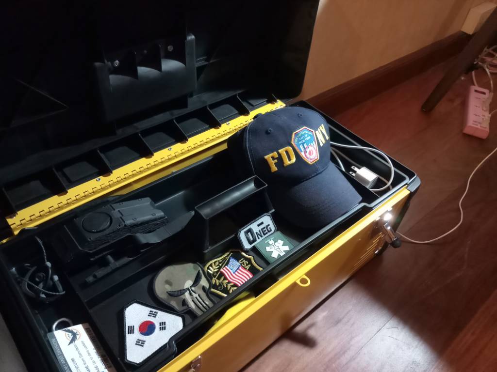

UPDATE #K1 | (WIP)loot box from The Division!
Inside filled with some other cosplay props!!

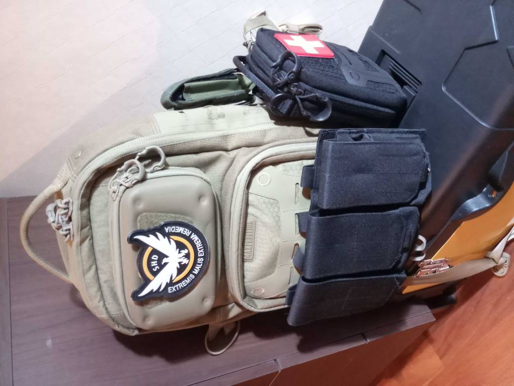

UPDATE #K1.2 | (WIP) Slinger bag with SHD patch , magazine pouch , med kit , flashlight pouch
__________________
Important!!!!- I am not korean hahahaaa , I just love the 707th spec ops
Note- still not sure... should I use the bag? [emoji14]
Thinking about Buying Maxpedition Sitka ,
Cause I don't like Maxpedition AGR GRIDFLUX.
If there is a good bag that fit... please notify me.
Thanks!!!
Personally I think you should go for the Sitka because it has more of a rugged military go-bag look that just shouts “I’m was prepared”

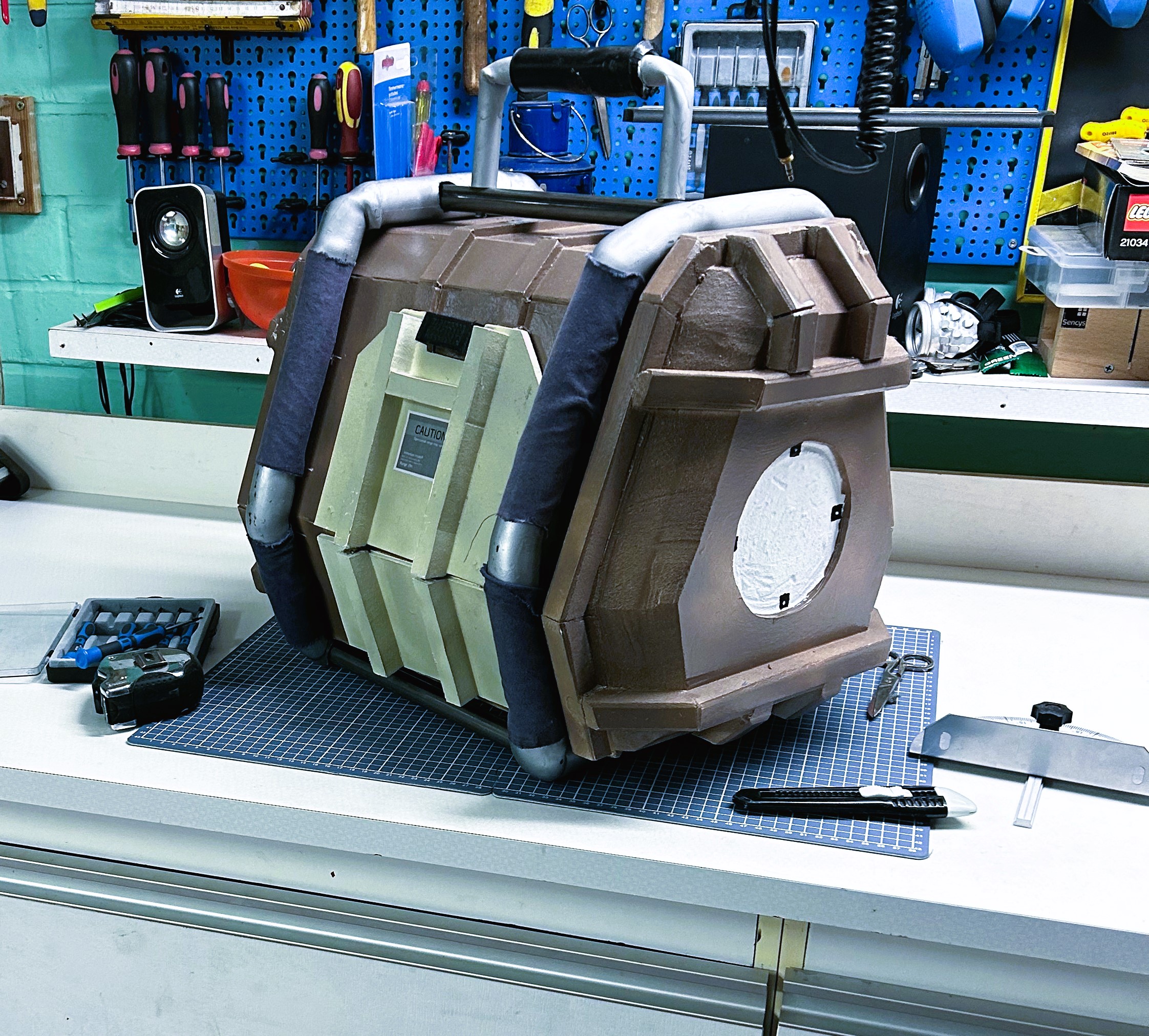

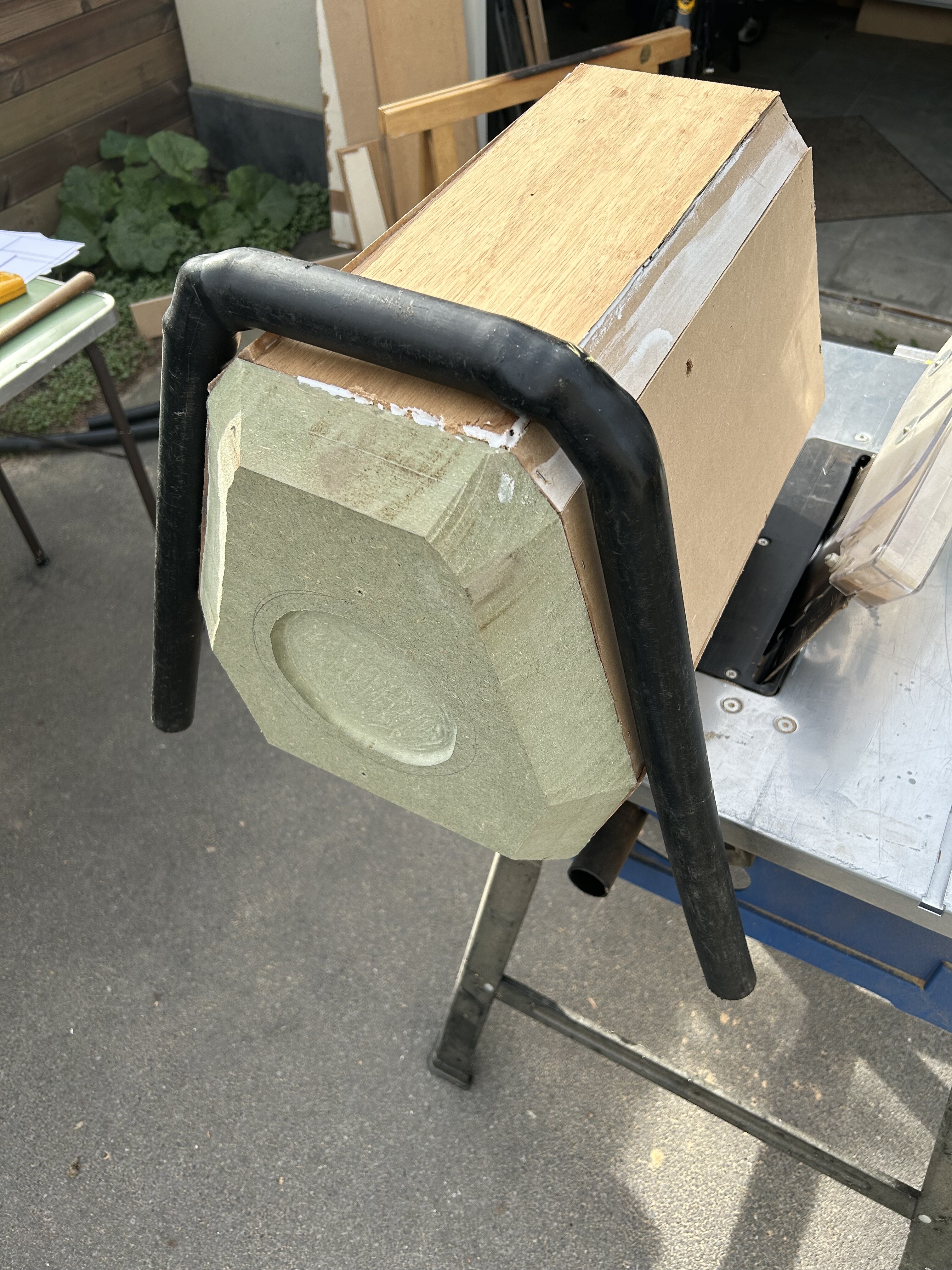

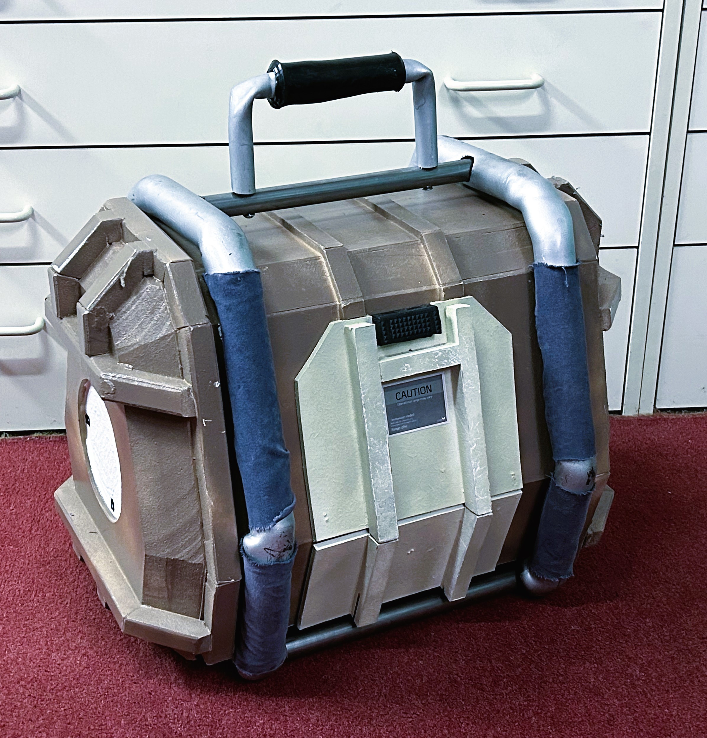

So I thought I'd share what I made for the local comic con last October. I'm really into the Reclaimer build since I'm not exactly a great gamer, my reflexes aren't up to par to those of better players. So I'm more comfortable hanging back a bit and providing support where needed and keeping team members alive and nicely beefed up. It then made quite sense to head out there as a real world Reclaimer sporting all sorts of paramedic gear (stethoscope, trauma scissors, leg plate with a first aid kit etc), a first aid launcher and, of course, everyone's favorite lunchbox!

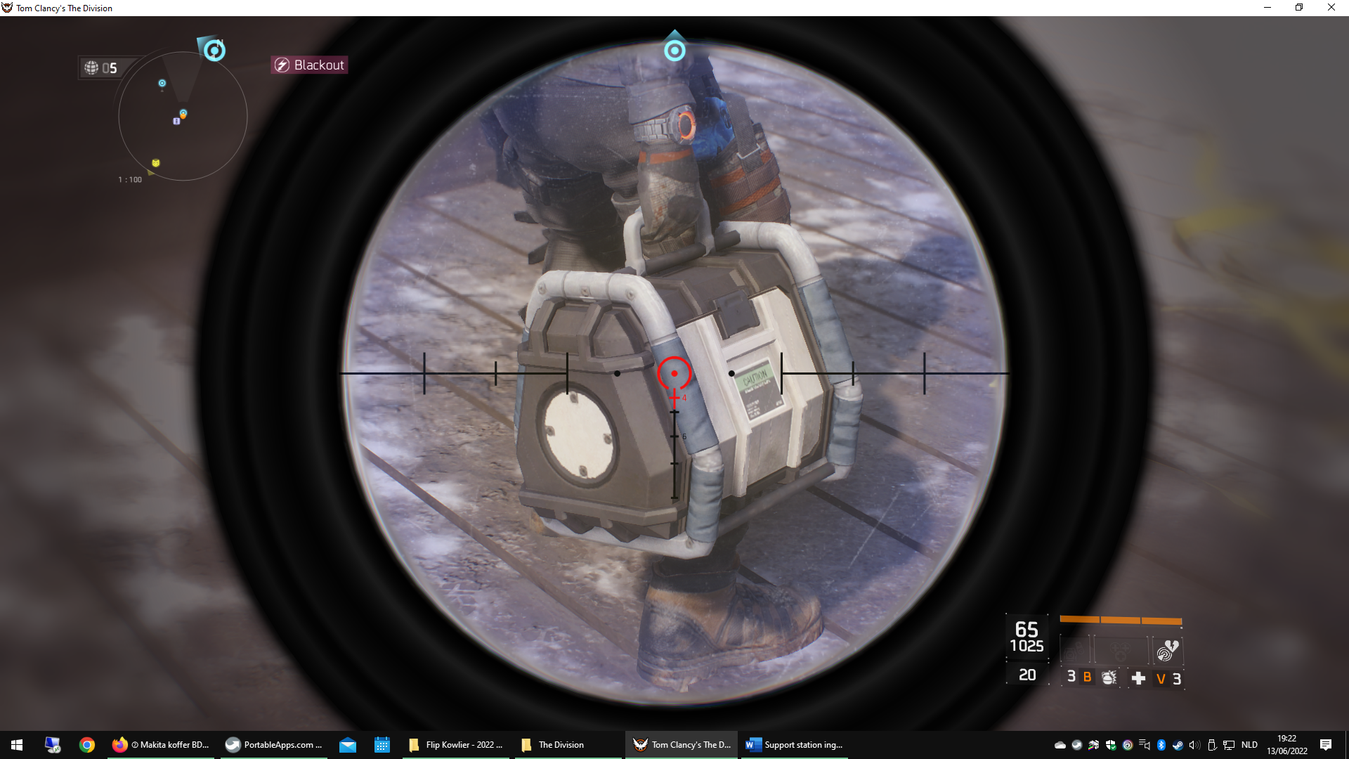

I set out wanting to fabricate a device that could somehow transformer-wise/Iron Man-like unfold from the rather small kit that hangs from an agent's backpack to the full in-game suitcase. That proved to be unrealistic quite fast. Another intention was to incorporate a green construction laser device that casts green circles around as a level indicator, mimicking the sphere in which the support station operates. That got scrapped, too. The end result doesn't even have opening sides or any other functionality like simple green LED lights, sadly. Still very proud though.
Asked Ubi/Massive for 3D files about the in-game support station model, but received no reply, so had to resort to taking screenshots and tracing them in Inkscape: link to resulting PDF.

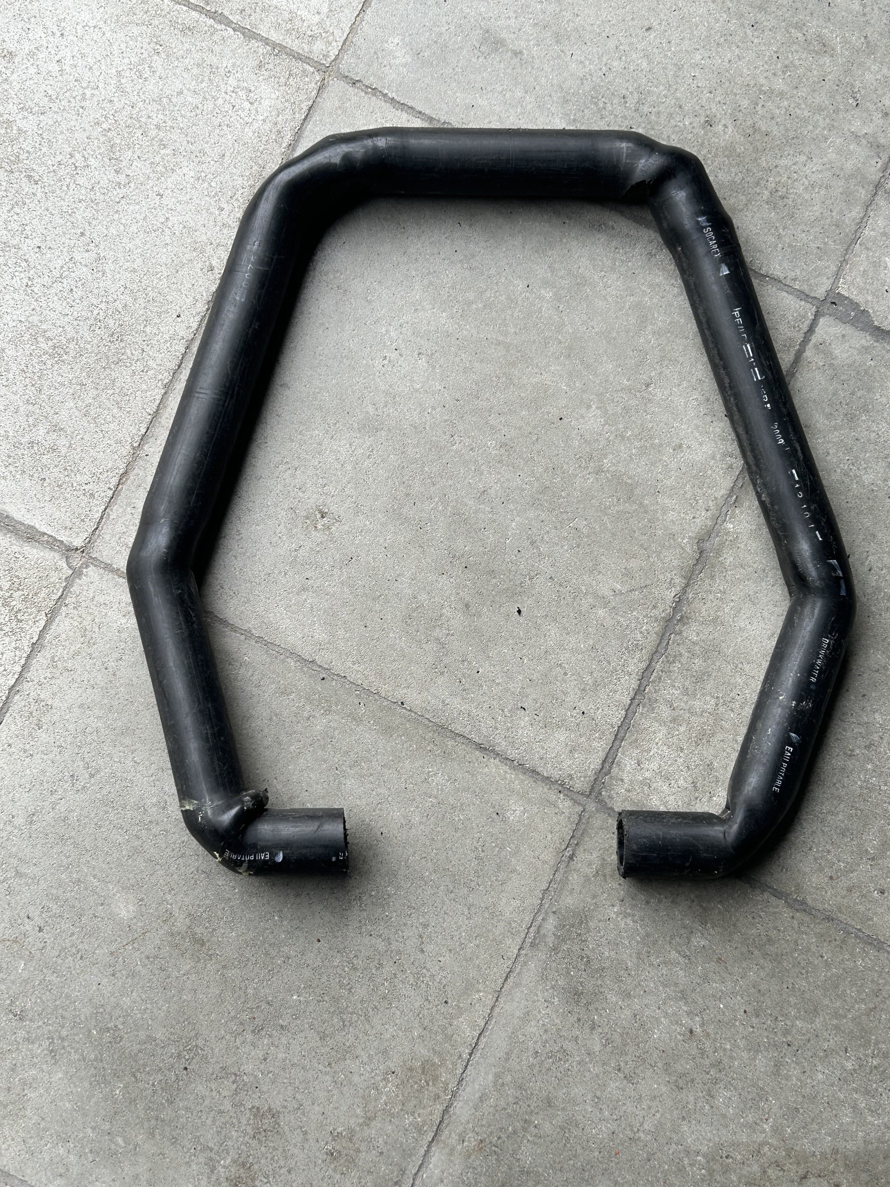

Made this during the better part of last week, mostly from spare parts:
  • MDF wood
  • plywood
  • plastic water tube
  • electric housing tube
  • old navy blue shirt.
I'm not a professional woodworker, rather slightly comfortable with DIY tools. Nor am I a seasoned cosplayer -- this was my first time.
Dimensions: 50 cm (L) x 40 cm (W) x 40 cm (H, including grip on top). This was maybe the hardest part to determine.
Weight: approx. 8 kg.

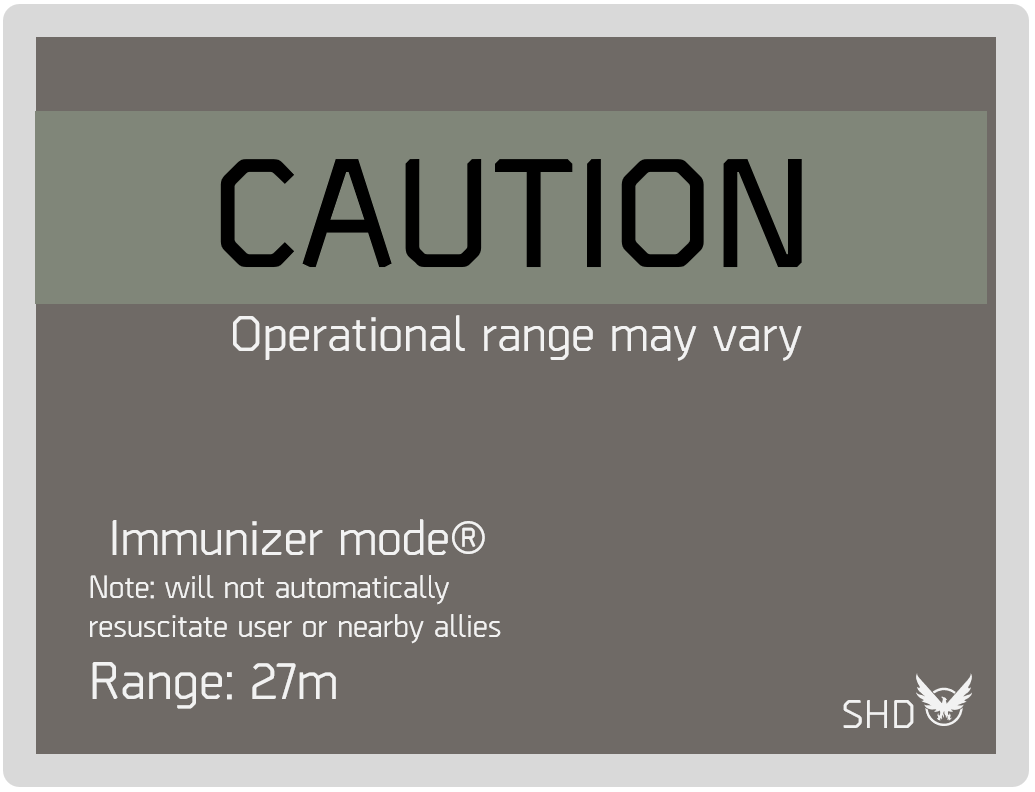

Colors used:
  • RGB 127 - 112 - 99 (Buffalo brown) for the dark army brown. Sorry, dunno RAL color; the color number 7274 doesn't seem to translate to any RAL reference.
  • RAL 7032 (Pebble grey) for the sides
  • Silver Metallic spray paint for the 'metal' tubes, which are actually plastic tubes, bent in shape around the box using a heat gun (paint stripper)
Tools used:
  • table saw
  • jigsaw
  • heat gun
  • nail / staple tacker
Beginner's mistakes made/to remember for next endeavours:
  • 8 kg is way too heavy to haul around on a convention floor all day. I'm not feeble, but my shoulders were aching until two days after the convention :)
  • Color picking is hard: not 100% satisfied by how the buffalo brown turned out. I chose to go for the Immunizer mod (and accompanying color scheme), mainly because of the navy blue shirt/rag I had lying around. The differences with other mods are mainly color scheme and greebles when deployed.
  • Should've sanded more inbetween paint layers. The gritty look may give it a 'real' feel but I think it's a bit too rough.
  • Curb my enthousiasm & lower my expectations! :)
  • Comic cons take place in heated venues! Being decked out in true TD1 blizzard-proof attire, I was waaaay overdressed :)
