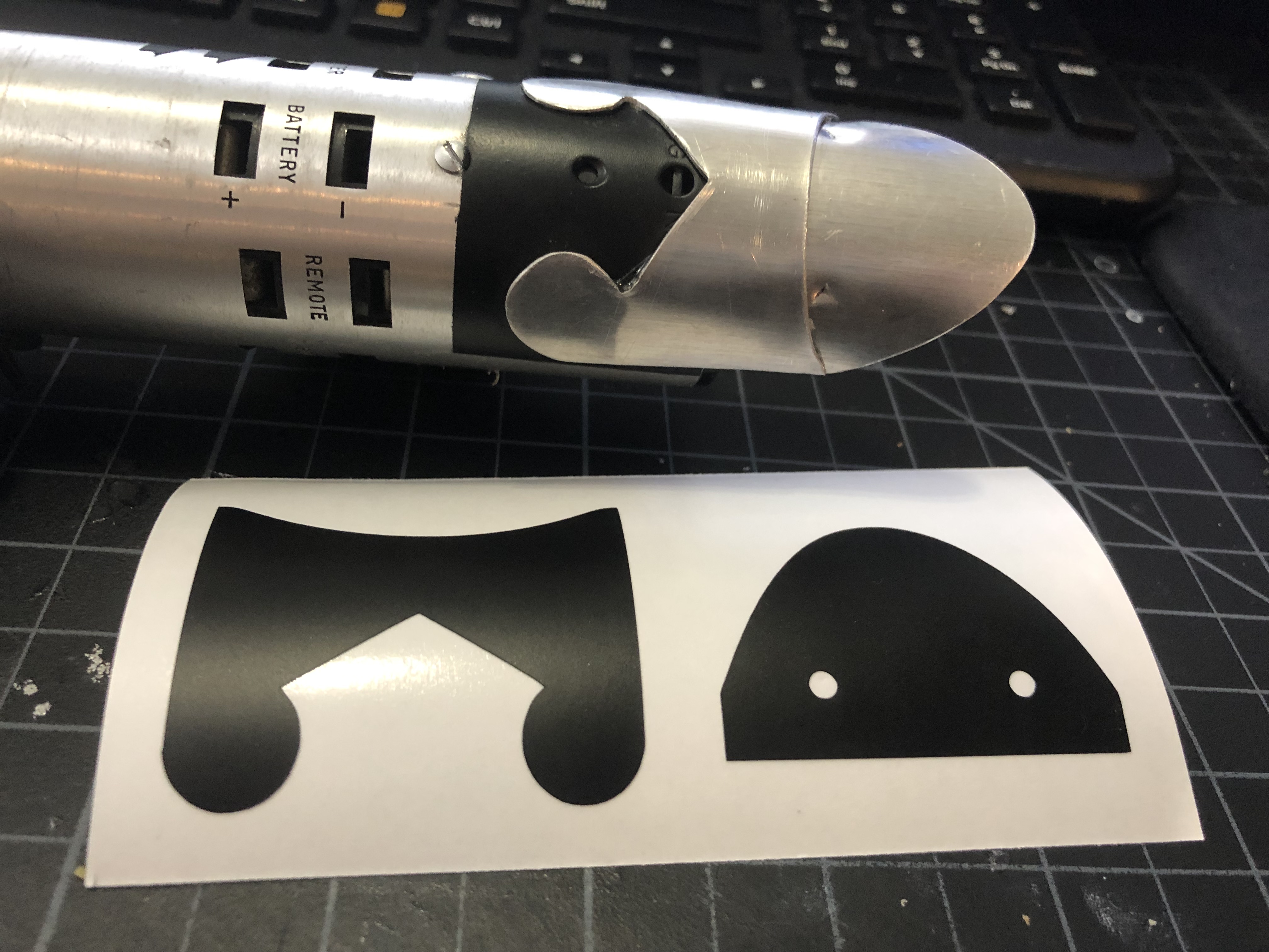

So if anyone is interested I can add end caps and these shroud templates to the kit. Basically stick them onto your sheet metal or aluminum tube and trace/cut.
I normally just use a dremel with a cutting wheel for the big cuts and then a cutting bit for finer cuts. cut proud, then grind/sand flush.
LOL! Yeah I'll probably list them separately. Not sure everyone ordering a kit would want the end cap if the existing one works to be filed down and crammed in.

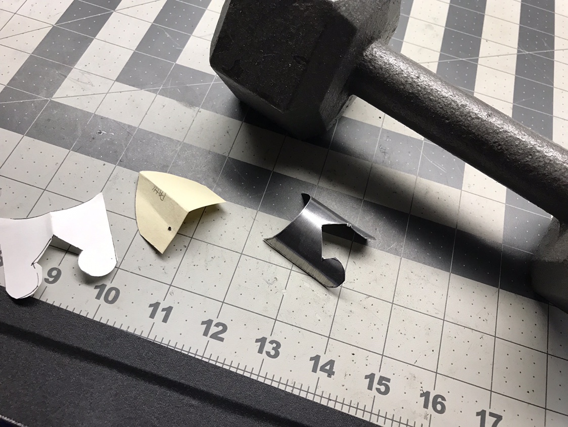

I ended up going back and just grabbing a small sheet of aluminum .025” thick
I drew some templates up on paper, cut them out with metal sheers, and filed all the edges smooth
Added two little dimples by laying down one of my automotive chisels on the emitter shroud and taping it to make the simple dent
Again the chisel was on its side
I then bend the aluminum over a 1-1/4 black iron couple pipe. It was the smallest and cheapest one at Lowe’s
You need to bend the shroud past the radius of the graflex, because it.. what’s the word I’m looking for.. springs back when wrapping it around the graflex
But if you wrap it around a smaller pipe it springs back to the graflex size and works great
Trent showed me his progress with the patterns, making them a sticker was genius!! Super freak’n easy!! Can I tell you what a life saver his arrows are?!?! Damn..
Can’t wait for him to lock in that bottom end cap, I love it
What I find cool about all this is, I sent him this as a joke xmas gift. Wrapped in lightsaber paper and all, and now he’s gone above and beyond with it. I would have never thought we would have such a accurate control box!! Wicked awesome!!
If anyone finds a solid aluminum sink tube, mind sharing? Or any 1-1/2 aluminum tube. It would be so much easier that way
This way you don’t have to bang it over the pipe. It’s very hard to bang the small circles “ears” at the bottom of the shroud with out creasing them..
I think I threw away 4 shrouds before I could lock down bending them
Seems like all sink tube today is either brass of plastic.. can’t really think of any other tubing..
It’s tough because it has to be the same diameter and gauge thickness.. not too many applications call for something of this dimension.. and gauge

Trent and I were talking and I do plan on doing a tutorial with his new stickers and end cap, orientation of the box and black arrows
