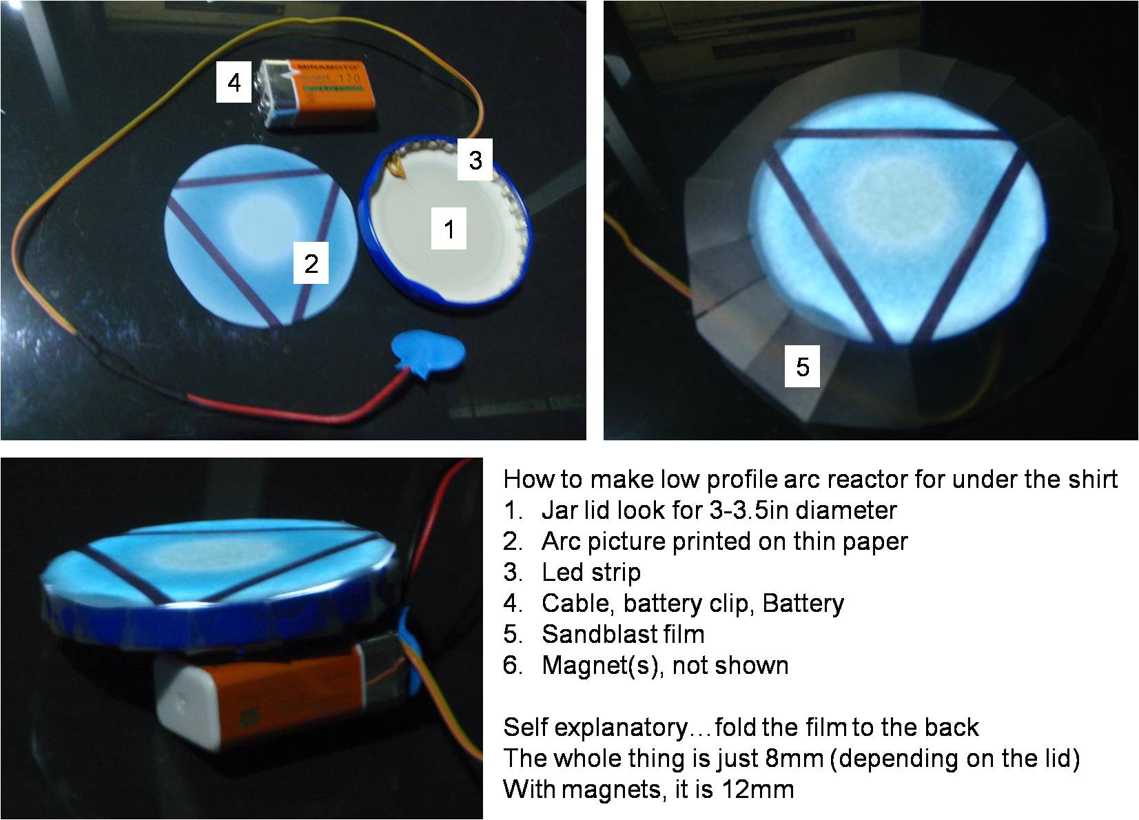

Tip #29 Undershirt glowing arc reactor 2
My second attempt making it thinner (low profile), only 8mm
Since the lid is made of steel, a magnet will stick, however, I find it not strong enough.
So I superglue two magnets to the lid, and using another two for anchors.

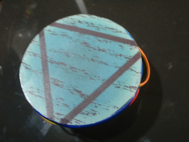

It was supposed to have it printed on sandblast film.
However, I do it with regular paper printer, plastic cover sheet and all being superglued to the lid.
It turned out to be quite strong and the glue became transparent.
This is what it looked like under dark environment
