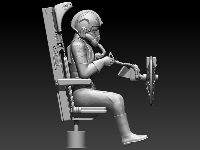

So, inside are; Chair/Pilot/Steering yoke/Steering hub

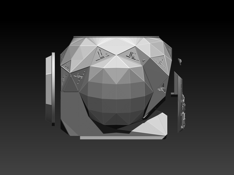

Then the shell itself; Pylons/Shell front/Shell back/Lid/Base Plug/Window
Or u can print the whole shell but not have the interior shell;

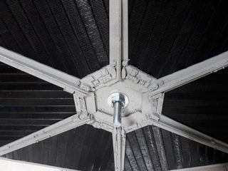

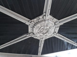

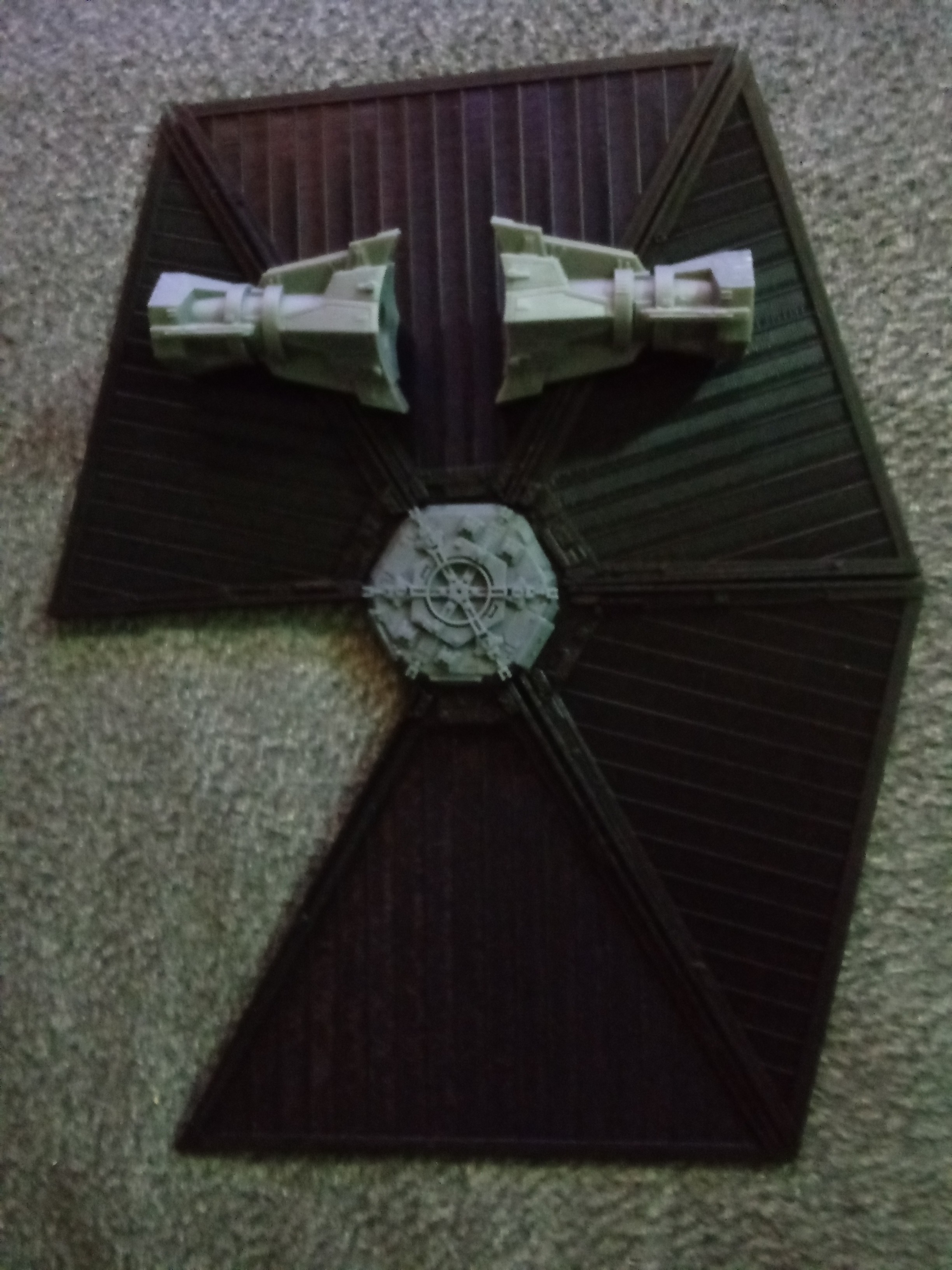

Then the wings are 6 parts split along the ribs with an inner and outer Wingstar

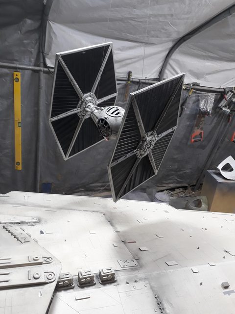

I have everything printed now so I will show my build process as I go
Hmmm...I'm not sure printing the main sphere in 2 halves in resin is a good idea...resin tends to warp a bit and deform when it cures from soft to hard. Probably be fine printing the whole ball in one piece though. For me it will be just the greeblies.

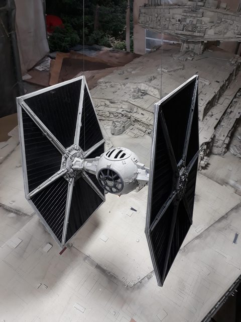

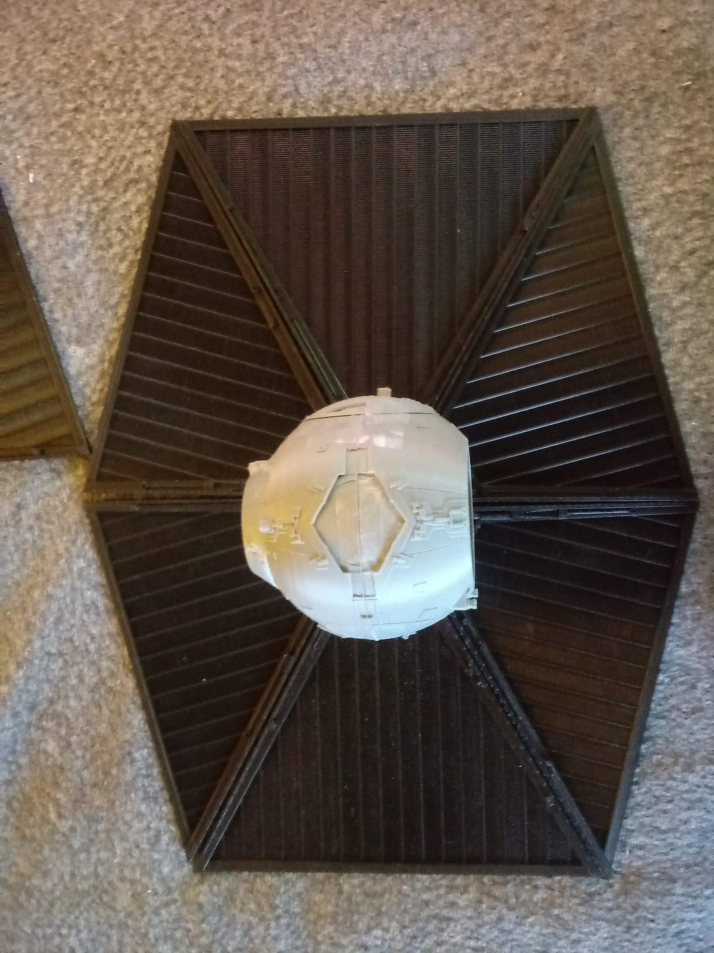

Here's most of the parts printed;

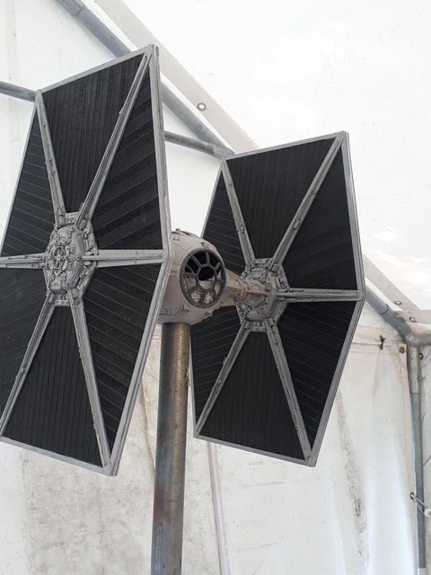

So, got the main components assembled. My approach for attaching the wings was to have 2 bolts to fix the wings thru the pylons into the shell. The bolts can be cut to length and the washer and nut tightened to brace the whole thing together and then fit the outer wingstar
All feels pretty solid;
I'm gonna hang it to display, once I've added the lights

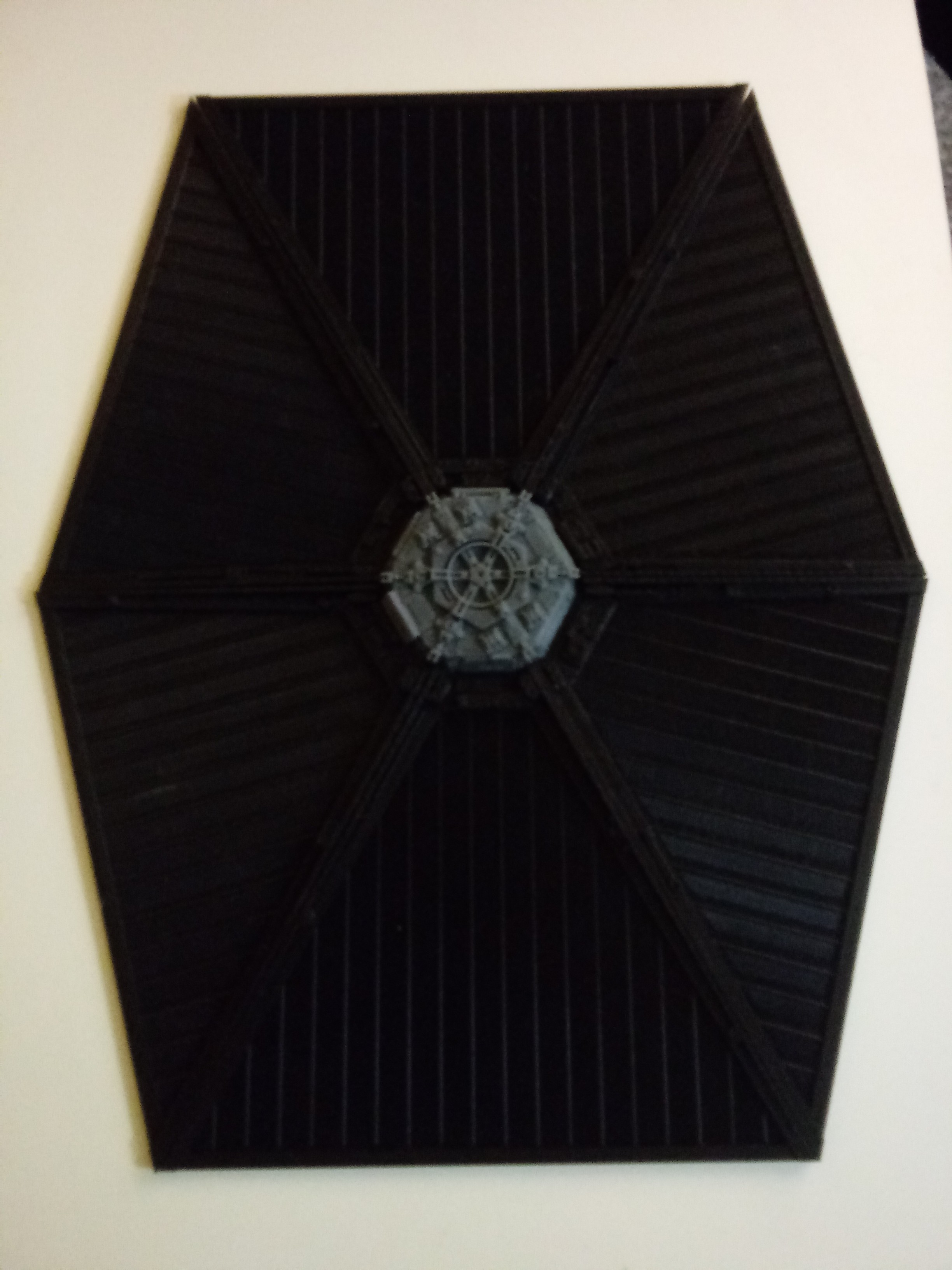

does anyone have photos of how many parts the wings print out in? example, does it print 6 "pie" slices and then the middle struts, so it can all be assembled? I want to get this for myself, but need to make sure I have the printer bed size it will print on
Each wing consists of 12 panels.
