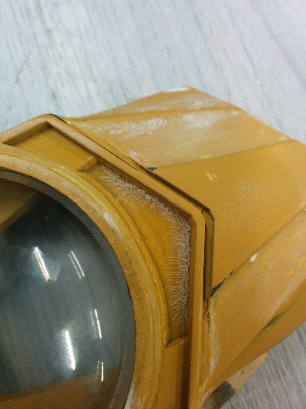

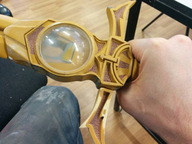

New update: Anyone remember the awesome test I did with super glue? Well It didn't work. I don't think the glue was deep enough on the actual piece to cause the wrinkle effect.
So I've had to scrape as much out of the gap as I can. It looks terrible. I've had a bit of a play to try to fix it but I'm still not sure about it.

Thanks Razorsharp. I was just hoping to get the optical distortion from the lens but these do look WAY better in profile.
Sent from my Nexus 5 using Tapatalk
Have you thought about trying water clear resin inside the camera domes? That may add a touch of refraction for them to distort the TC logo underneath... It could be worth a play about with :)

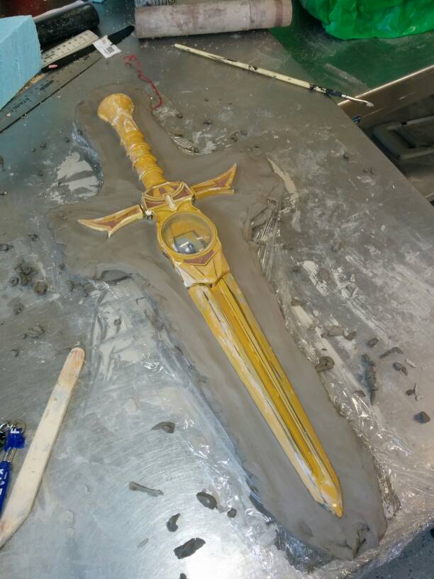

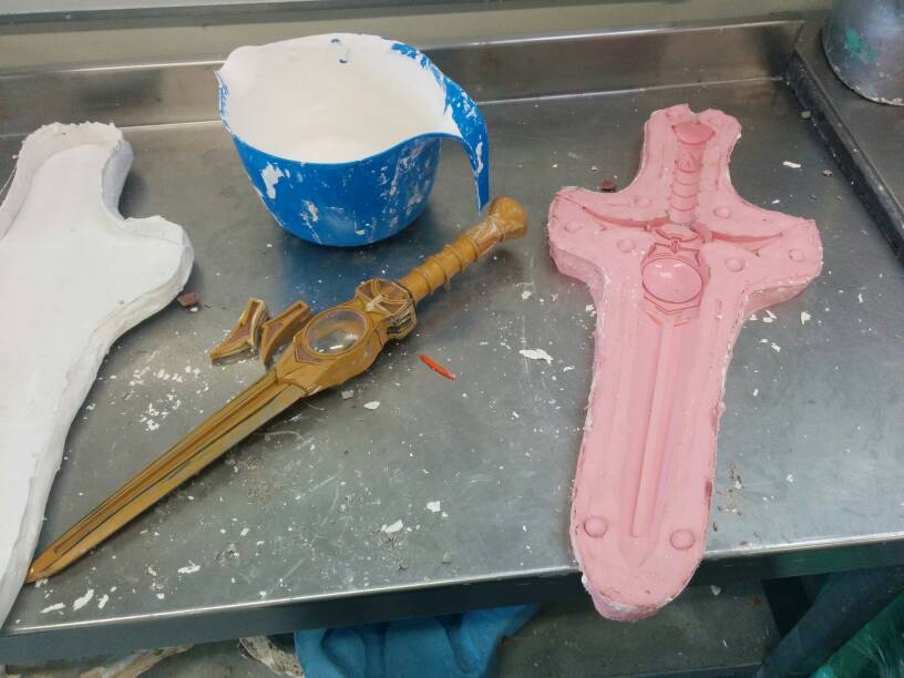

Rubber has been chucked! I was going to attempt a matrix mould but panicked at the last minute.
Should get a pull by monday...
looking good! any reason you've moulded the eye into it though? wasn't the plan to have the eye showing through the "glass" dome? moulding without the dome would've meant adding electronics would be possible too to make the eye light up, and you'd also be able to get a better finish on the eye having it a separate piece (could either tint or paint red from the inside, and on the outside it would look like red glass). Unless the dome was just in for the pics and taken off before pouring rubber on it, then ignore me :)
My thinking was by moulding it with the eye it'd be easier to pour and keep it strong. My plan was to drill out the eye on mine to place a clear version in. Worst case scenario I can remould it without.
Moulding began and finished this week and it will begin again next week.
My first mould was the worst I've ever made. I was a bit naive about the whole show to be fair. I did get some pulls which showed good detail but the form was awful.

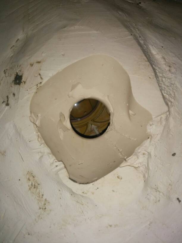

I'm yet to decide about eye inclusion or not.
If I leave it out there's not a lot of room for the resin to move through but if I mould it in then for most purposes it'll need drilling out!
Anyone have any thoughts?
I did start on my new super mould today and with a bit of help got pretty far.
More tomorrow!

Thats a mighty fine mold you've got there sir!
As for the with/without debate... I would be inclined to go for the WITH option, yes it means more work afterwards but i would take a 10-30 minute drill press session (depending on how giddy i got! =] ) over the risk of a the cast deforming/breaking due to weak points. The greater the mass of plastic, the better the exothermic reaction.
Just my two penneth though.

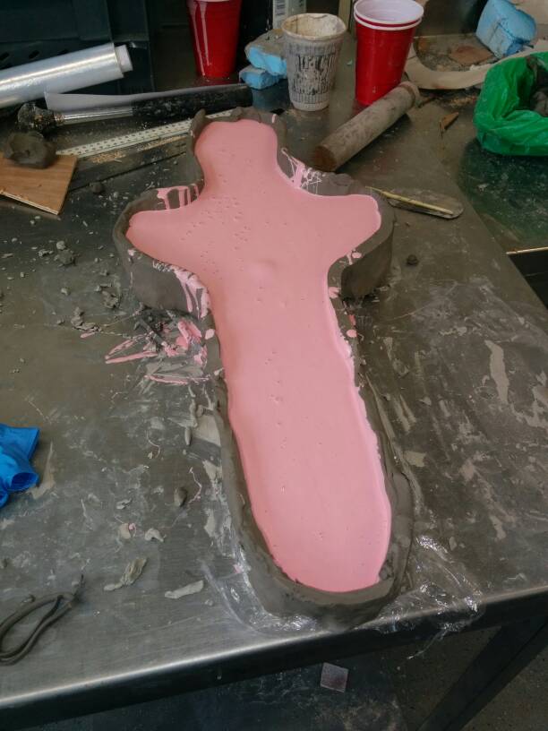

Today this was done...
... And I poured lots of silicone down here!
More tomorrow!

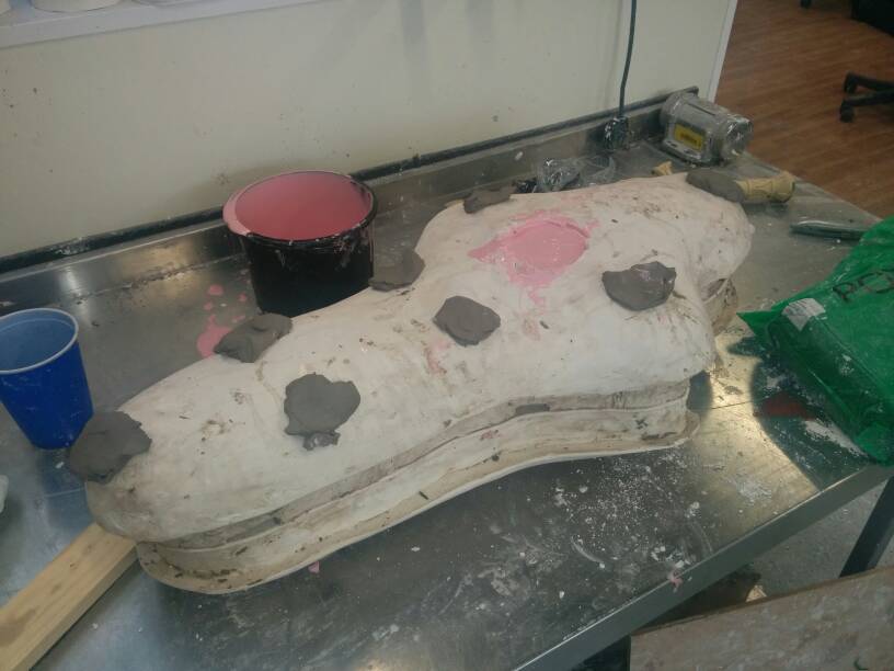

So this was this today. Not the neatest mould but WAY better than my last...
... So more rubber was chucked. Now for the bad news; I'm away all next week so I won't be able to open it til I get back. :-(

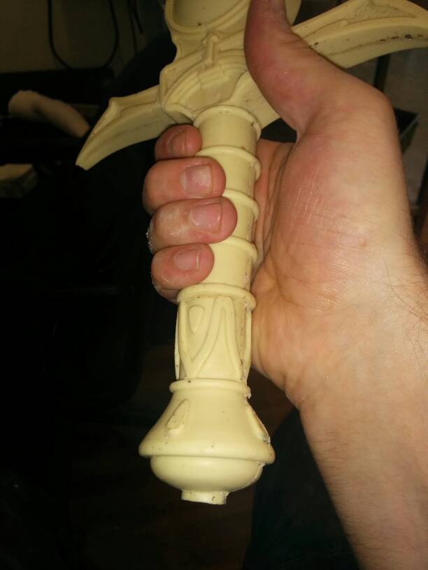

... So I couldn't wait a week. I went into the studio today and ran a "mould cleaner". Here it is:
I've done very little clean up here.
It feels SO good in hand.
One of the hand guard thingies broke off and skited off center a bit but its nothing a knife and bit of glue won't fix.
Some air bubbles in this run but again a bit more time taken during running would negate 95% of these.
