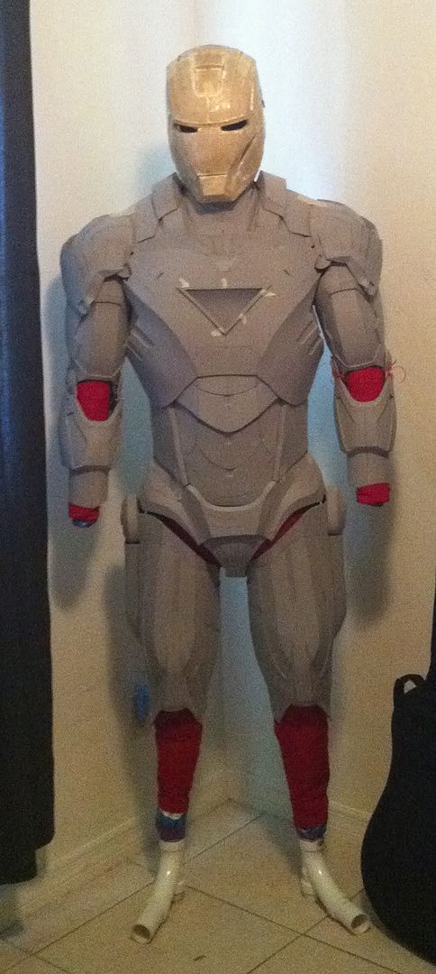

Small update.. Finished up the other thigh and worked on some of the wearability aspects. Pic...
