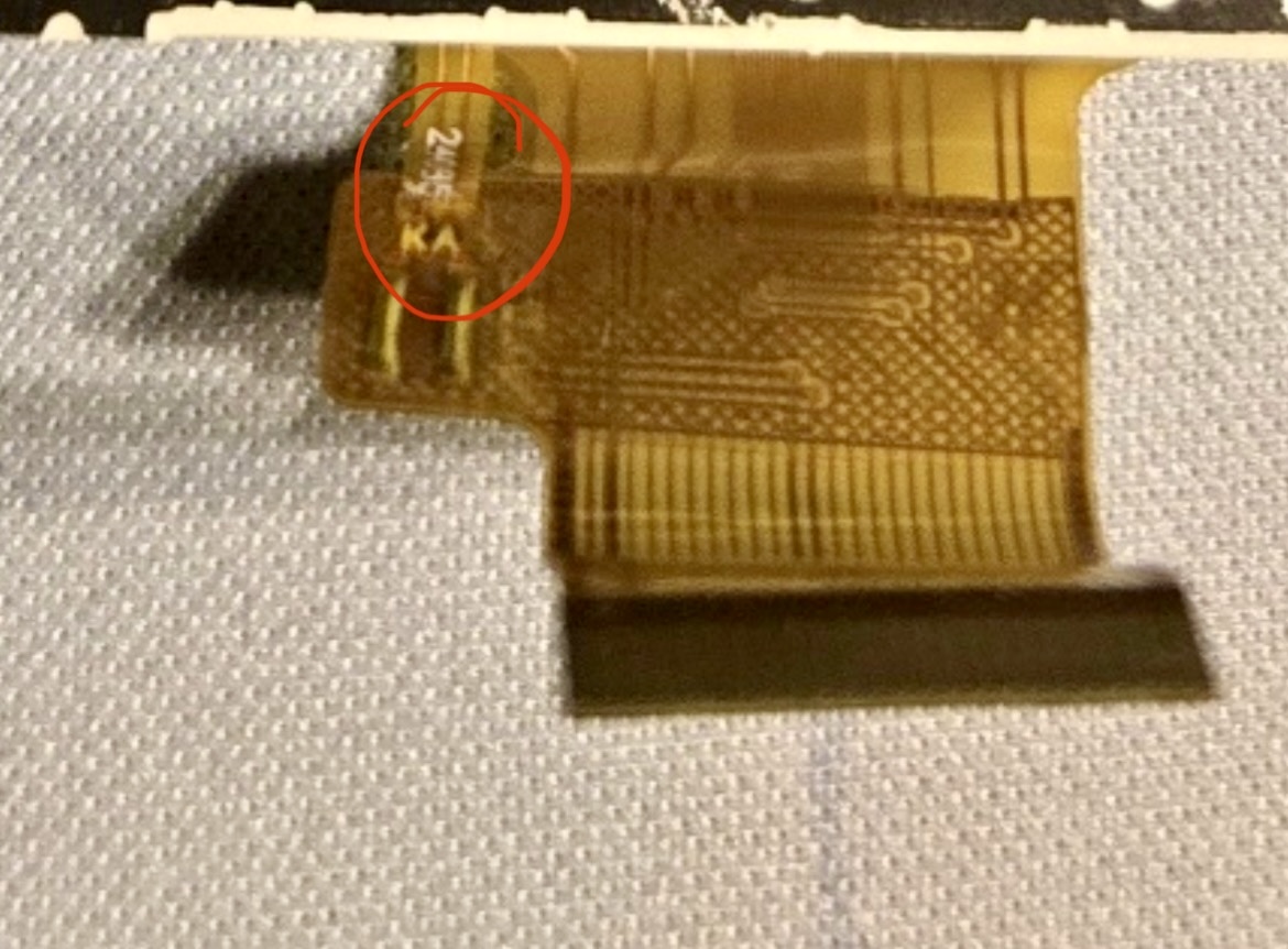

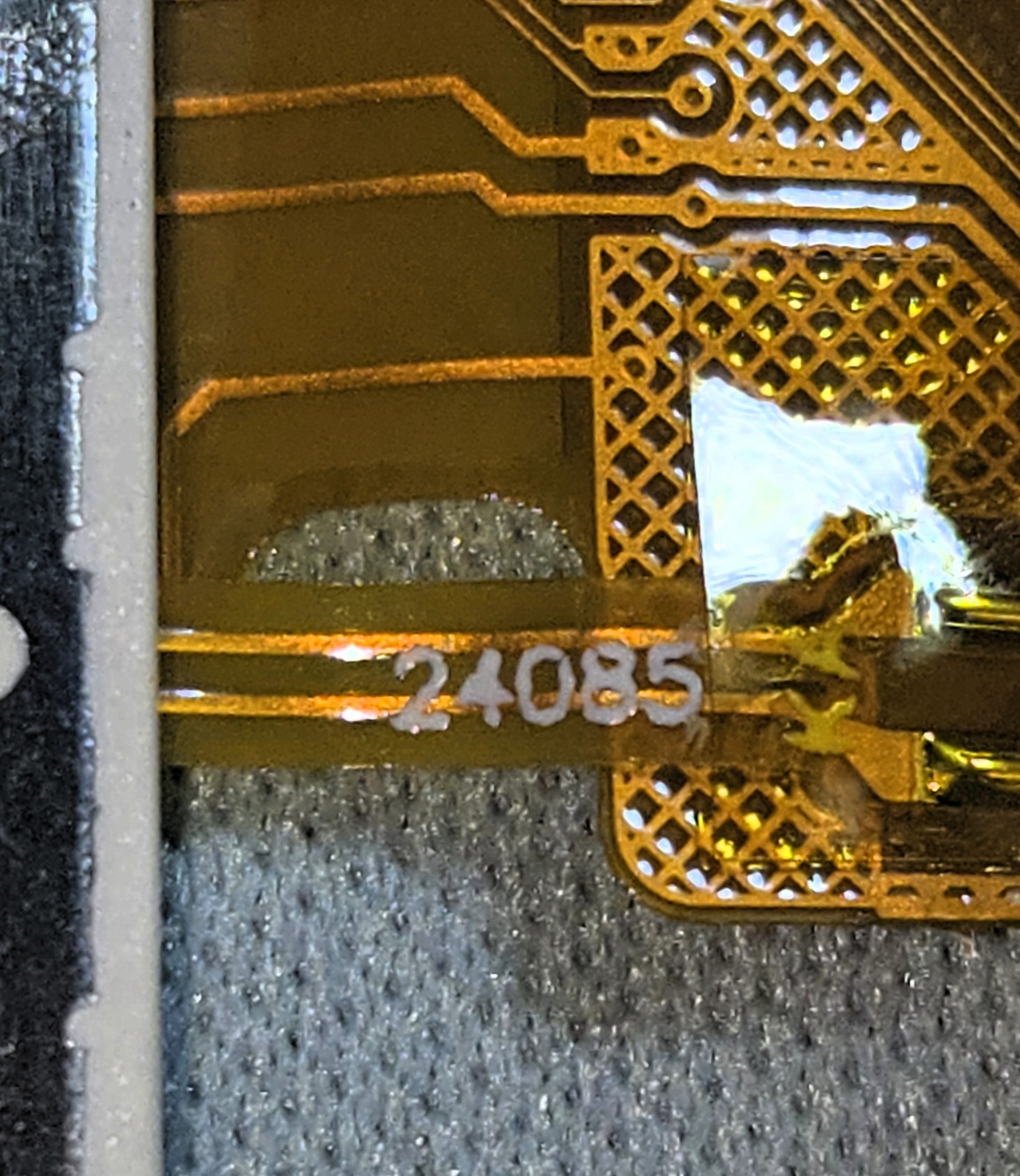

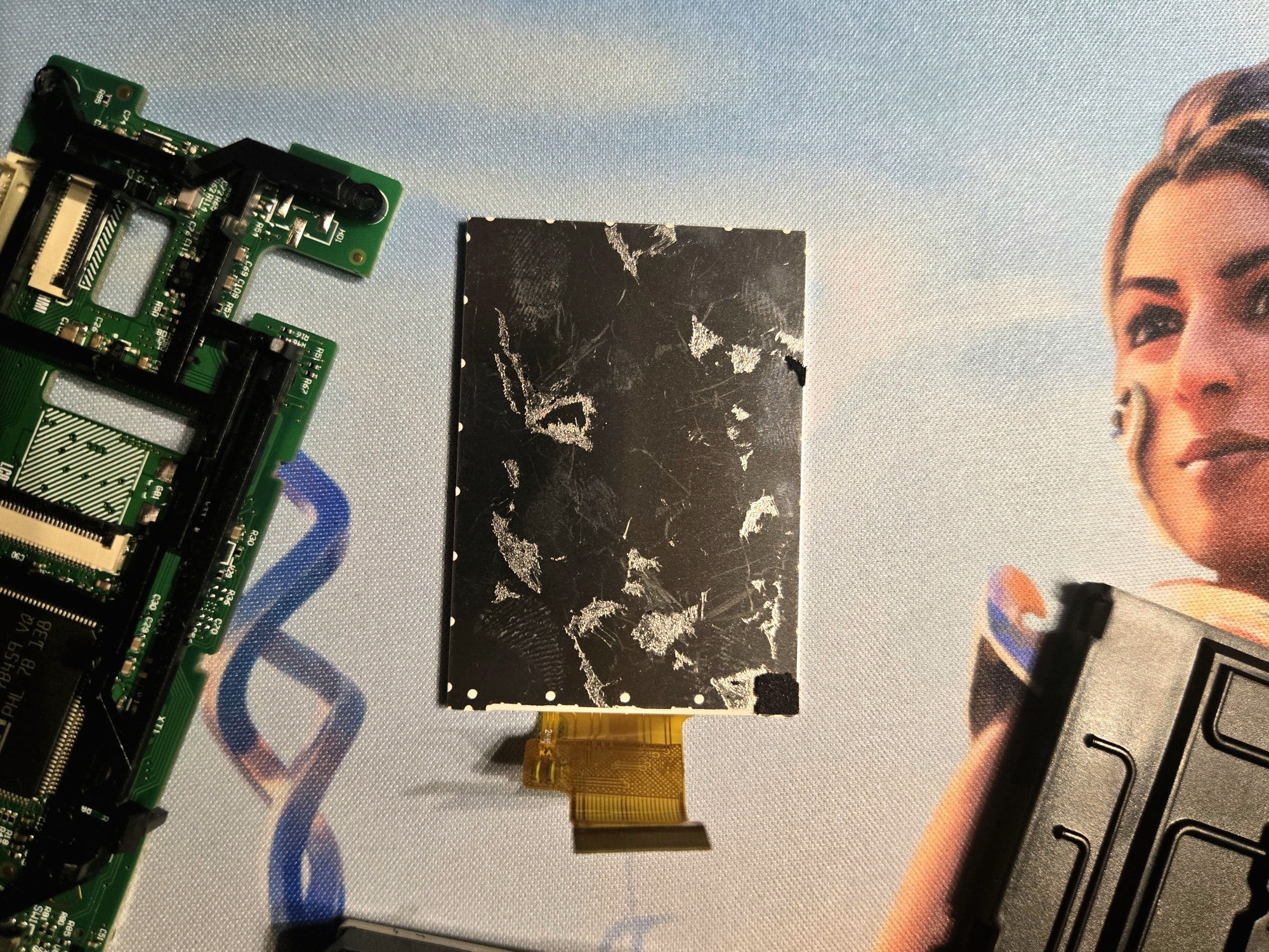

hardest part of the disassembly was getting the tape off the back of the LCD.
and of course, unlike every other lcd display for sale online, no model number printed anywhere.
:rolleyes:

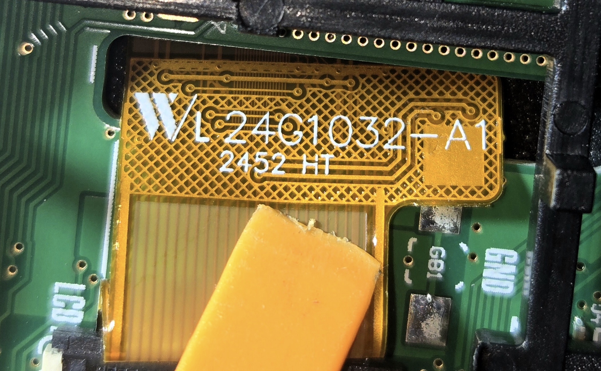

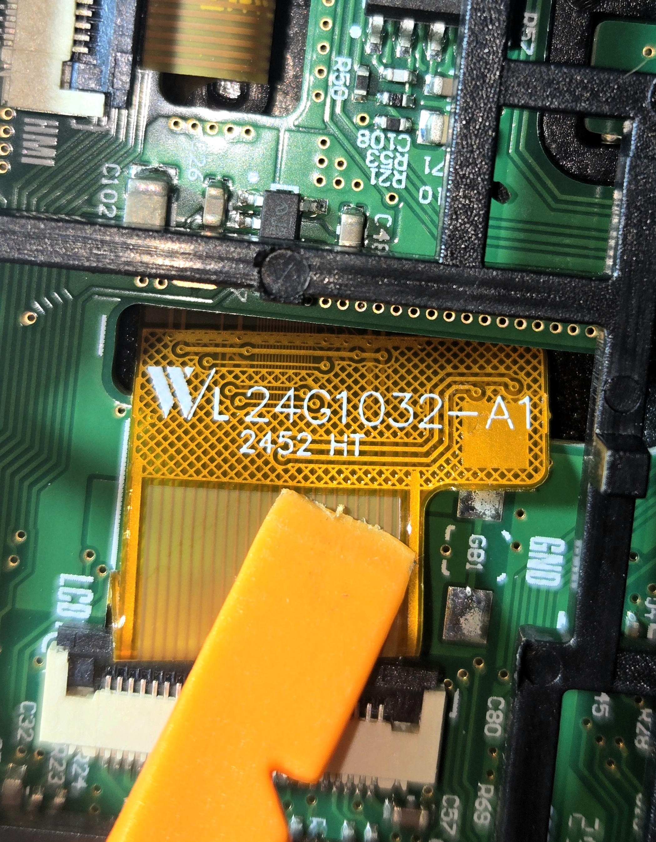

What do these signify? Is this just for the harness ribbon or the display?
I’m not sure since it’s folded this way and that way……
But since the only number on the entire module is….L24G1032-A1 (not including the company logo)….I’m confident it’s the part number for the whole assembly…..further below shows why I think this is so….

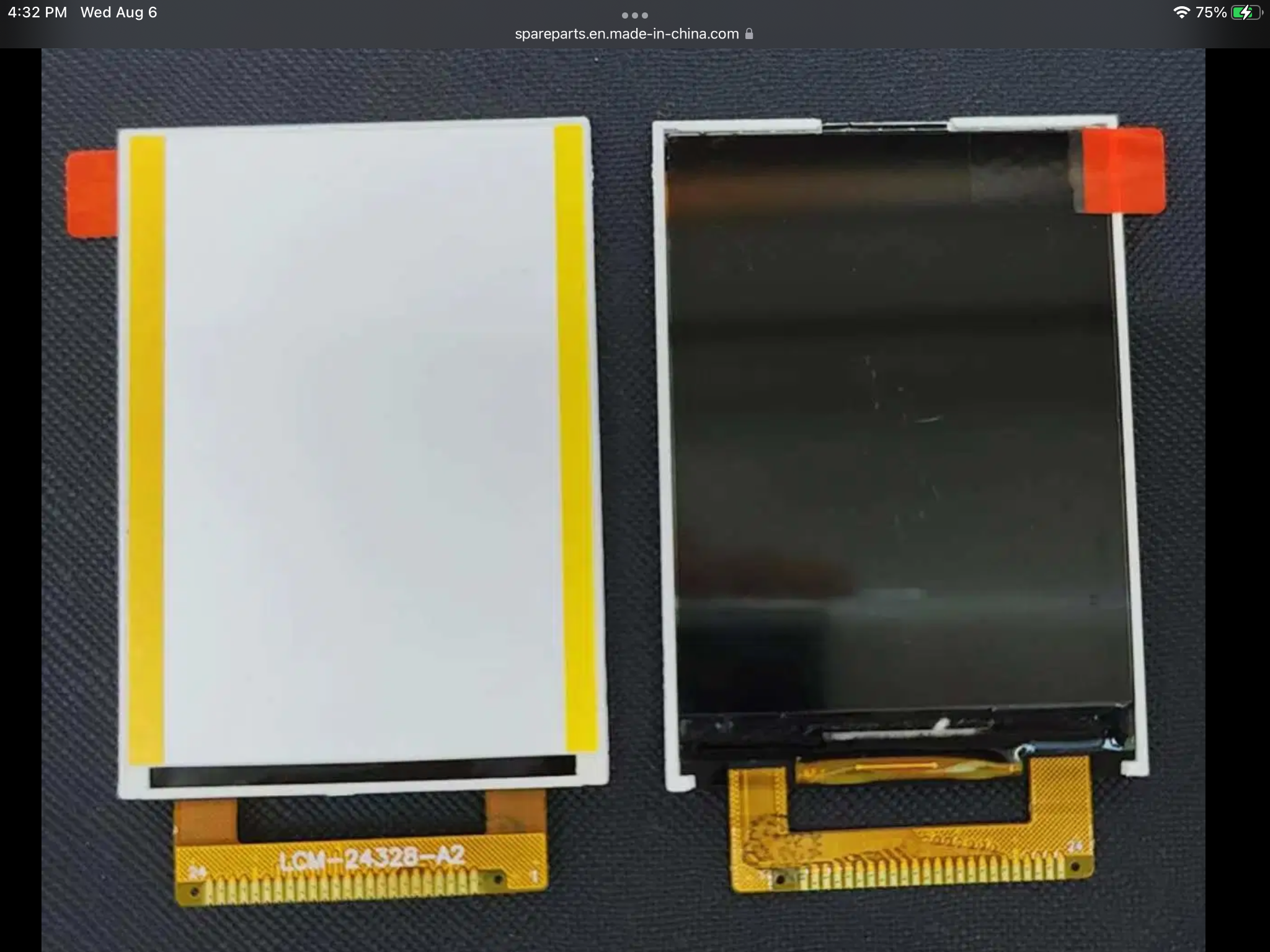

Look at this LCD module below….you’ll notice the only number is on the connector much like Wands…some characters are even the same ….L…..24….similarly -A2…..(24 is for 24pins)
Now Google the part number an add LCD module after that…..you’ll see that part number LCM-24328-A2 as the entire LCD module.
It’s not the case for the wand part number….it remains elusive, leading me to believe its a custom part number providing no info on the www as of yet…
It’s not the case for the wand part number….it remains elusive, leading me to believe its a custom part number providing no info on the www.

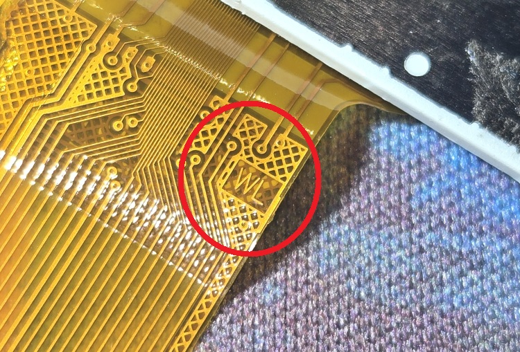

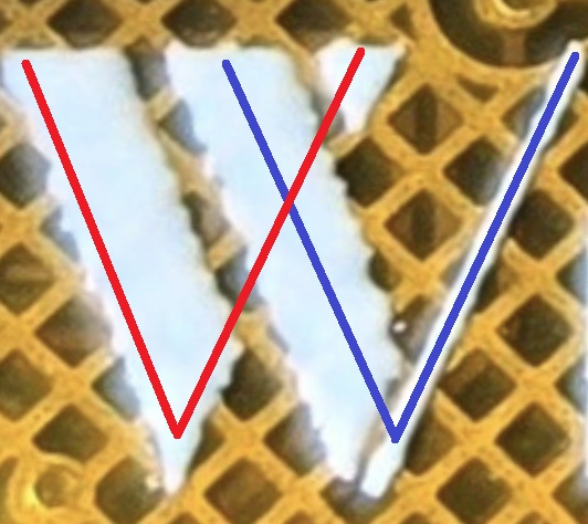

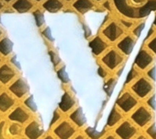

This logo may still be key to at least finding the mfg……
So far I searched L24G1032-A1….WL 24G1032-A1….and WL24G1032-A1 …….Squat….
