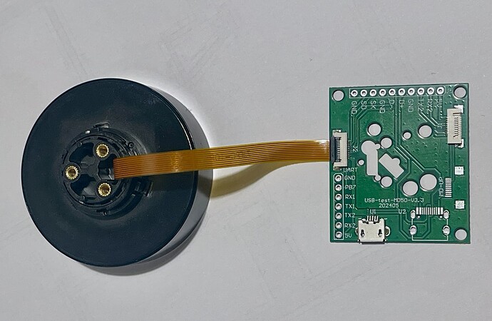

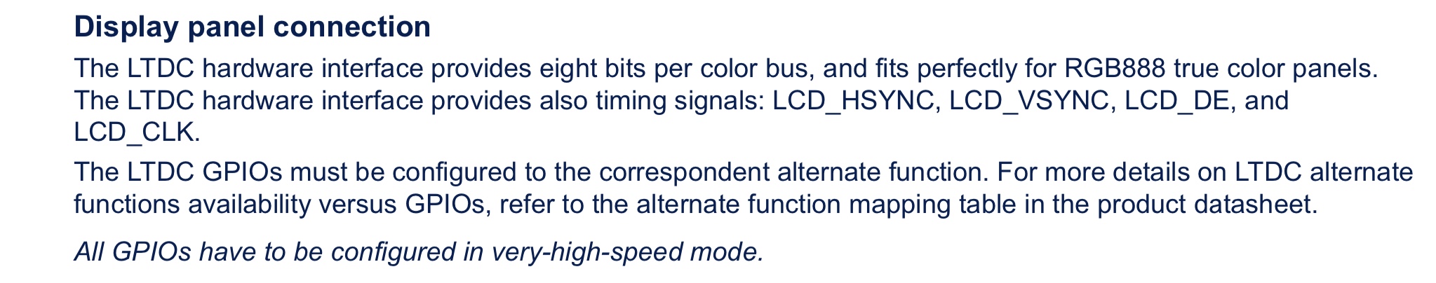

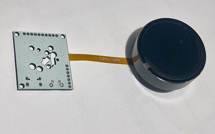

No... Ive spent the last 2 days looking at how to make a simple media player UI that works with the STM32H750 and YEAH its doable using MJPEG or some other formats like RGB565 etc... but my journey has brought me back to the display. I cant make anything work unless i know
1 - what pins on the microcontroller output to the display adapter and
2 - what pins on the display do what.
Fanatico you have figured out most of #1 IMO. Your post from a couple days ago was really informative, but its really only half the battle.
This morning when I got up i went looking for my torx screwdrivers... Thats the stage im at now.

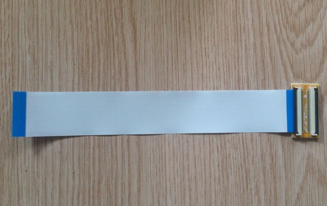

I guess could just use a couple extension ribbons 1 from the display and 1 from the mainboard so all the hookups are in the lower compartment, and then manually switch them to what you want.

How would one take ….at best an Rgb 3 wire (signals) output from an off the shelf player and expand it’s output to be distributed into 3 sets of the display Rgb inputs (R=0-7, G=0-7, B=0-7) that are required as the inputs of the lcd-TFT display?
That’s where MAPPING programming comes in and has to be programmed into the ARM LTDC Controller….
RGB888 is just one example display out of other that can be used….
This ain’t no easy walk in the park……..if the tric display just needed an RGB 3 wire input….then things wouldn’t be so complicated….but that’s not the case…

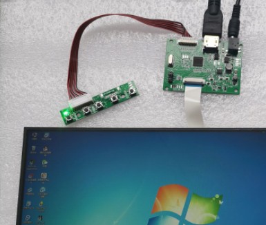

If we had the pin map for our display, I wonder if something like this would work:
EBAY LINK or another EBAY LINK
The description seems to suggest he can do custom display connections

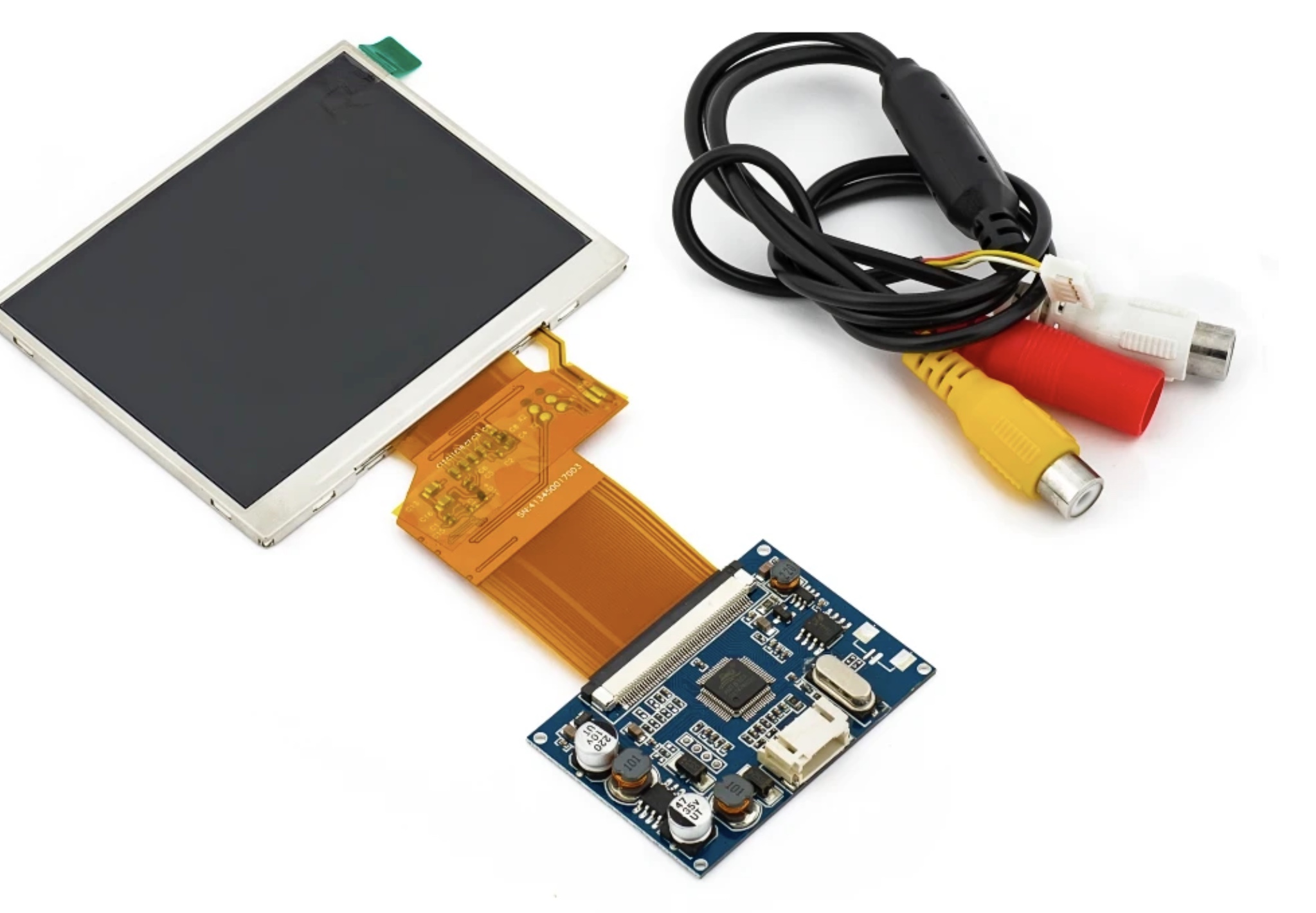

Datz funny…. I was lookin at something like this, but not actually using this…..
Using the A/V output of a video files player to a converter board that can output the right signals the lcd-TFT could display on the screen…
Of course changing out the rca connectors….for a mini plug that will go into the video files player.
Still going to need some type of switcher..
The part number and mfg to the tric lcd-TFT would expand the possibilities I presume..
