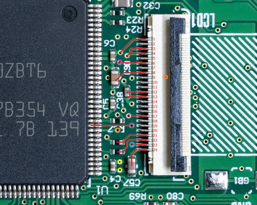

A 24pin ribbon doesn’t mean all 24 lines are used…

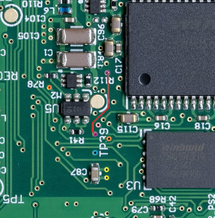

I spent some time trying to follow the pins around the board last night, and some of them seem to go nowhere, others go off and disappear under a connector etc. its a mess.
I don't want to take it apart. But I need to take it apart. I'm probably going to take it apart.
At your own risk….
Its a multilayer board and connections to other traces are probably on other layers you can’t see.
Edit: it’s a 4 layer board….
Plane layer assignments are not given that I could discern…. But.. one of them will be a power VCC plane layer, another Ground plane layer, another analog Signals plane layer, finally a Digital data plane layer…in my opinion.

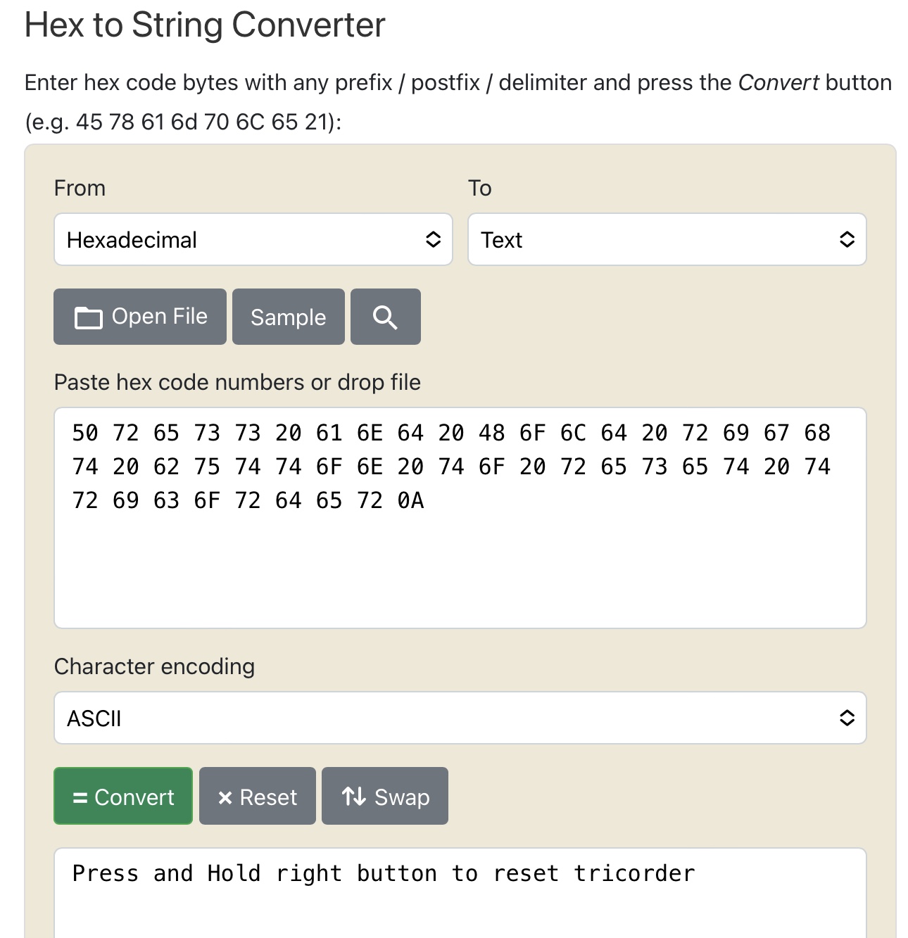

I managed to get into the tricorder and i now have a copy of the firmware that i can view. I dont know what good it is yet, but im currently perusing thru it... wish i knew more about this stuff
here it is if anyone wants to check it out:
*EDIT - I removed it because i suddenly realized it might be illegal to share?
This is the freeware im using to view it:
pretty boring stuff. looks like this:
From the little I can see it looks like it has the comments for the code. Maybe a good disassembler could decompile it into some understandable assembly language or maybe even into the C++ it was written in.
Multilayered CCA as we would expect, looking at the side might be able to tell how many layers . Not going to know where a lot actually goes without the layout diagrams showing all the traces and vias on each layer. One could use a multi meter to probe around doing continuity checks but that sounds like a horrible way to spend the day trying to map that out. But you could probably find a few that way if it was clear some where critical to know.
EDIT, I see i'ts found it's 4 layered. That's about one more than I expected. This thing is quite the design.
I edited my previous post about the layers….
