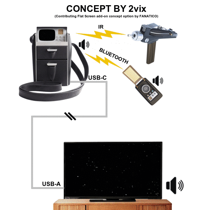

From Wand…..perhaps this will help…it should look like this when in motion
Alright so that tear-down video that FANATICO posted had enough information to not only confirm a way to give my tricorder video playback, but also showed me how to control the video with my phaser and hear the playback on my communicator.
Here ya go….. ;)
“Btw perhaps you can extend the video playback as an OUT to be watched through a big screen TV via USB-C to USB-A”….
Here ya go….. ;)
Thank you for this; it made me smile.
Your illustration shows two options I didn't think of. One is using the speaker on the tricorder as well as the speaker on the communicator. this would be better and give me "stereo" sound, however i fear that with one speaker wired to the PI and the other coming from bluetooth, it would cause the audio to be out of sync between the 2 speakers. I might have to try to make it work somehow, because having video playing from the tricorder but no audio without the communicator seems wrong. Second is the video out to an external display, which is a good idea. I really don't want to add an HDMI port to the back of the trike tho. Maybe I can add a module to the PI that will add the "cast to device" feature that my windows PC has? That would need to utilize a wireless network tho. I could also look at adapting the existing USBC on the trike for video out from the PI, but if i do that i may never be able to restore the original wand co. operating system. Im not ready to commit to modifying the internals so much that i lose the ability to return the trike to its original functions. Right now my plan only requires me to disconnect the display from the existing board and use it as the display for the PI. If I do it this way, I can always go back in and reconnect it to restore the trike's original functions. Although... one thing I do want is to be able to plug the tricorder in so it can play episodes without needing -the battery, and if im not willing to add a second power supply port to the back of it, I am going to have to figure a way to use the existing USBC port to power the PI. I guess the other option would be to look into adding a wireless charging receiver to the back of the trike, like the communicator has...
All good stuff….I do show the tric USB-C to output to the Flat Screen with a USB-C to USB-A cable……Yeah an HDMI port modded to the tric would be a bit much.
That wireless charging receiver you show, if it’s that flat …it could be attached to the opposite side of the tric back panel/cover so it will never be seen…perhaps.

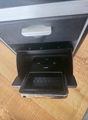

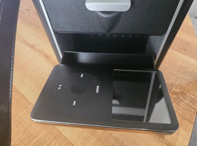

Thats the ipod's display ribbon hes holding. Maybe its 24 pins? Unfortunately my ipod classic will not fit in the lower compartment without modification:
But like I say maybe there is a little MP4 player available out there somewhere that uses a 24 pin display connection? this would make it way easier, and if it had IR remote and bluetooth capabilities, id be set!

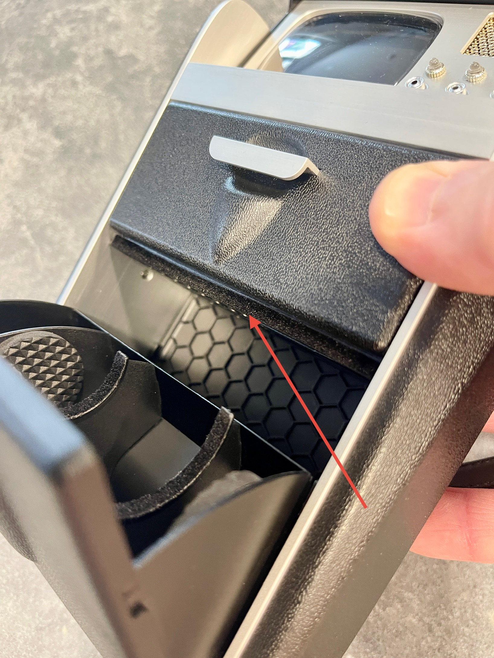

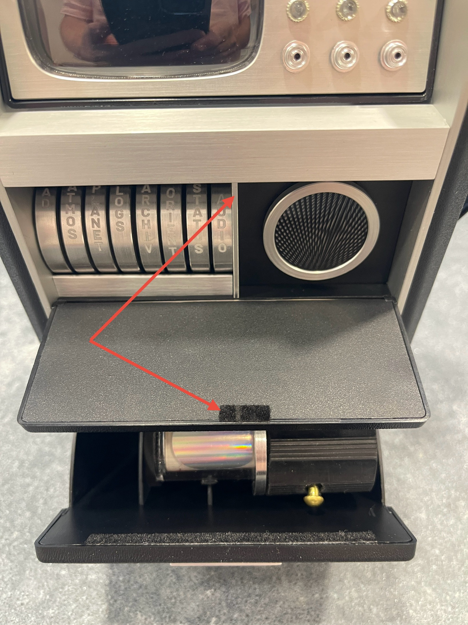

You all can work on your fancy pants electronics mods. I did something REALLY important today.
I added felt to the med scanner cradle and in the areas where the upper and lower doors impact plastic or metal. On the lower door I added felt to the body of the Tricorder and the edge of the door. It made it a “little” quieter when closing them. The med scanner is also nice and snug in the cradle, and the rubber is protected from the hard plastic.
Someone here earlier had done something similar and I thought it was a good idea.

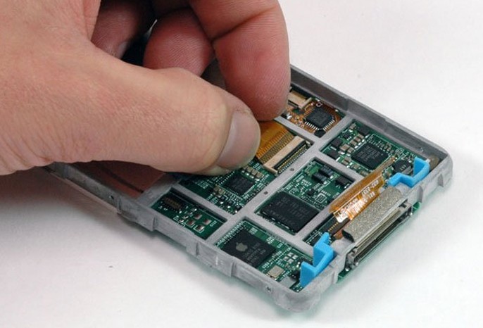

The video clearly shows the LCD screen connects to the main circuit board via a 24 pin ribbon cable:
If there is enough room for it, I can connect that cable to a 24 pin extender:
