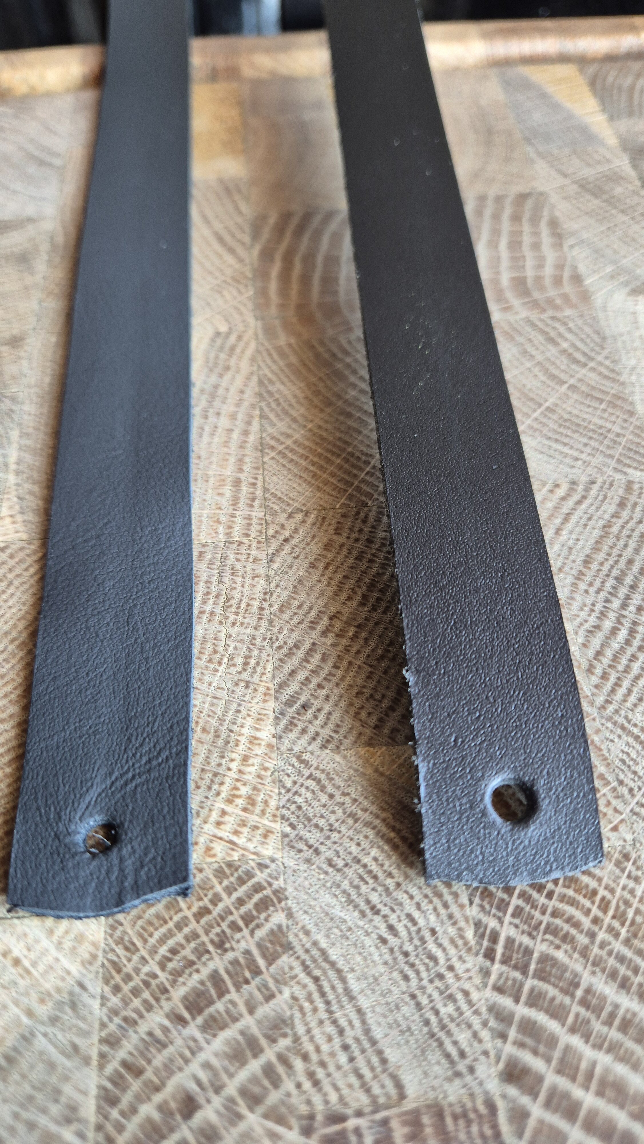

Personally I would go with (and have gone with) real leather. It's inexpensive to purchase and I find it more durable, especially since the faux one that the trike came with started cracking and splitting on me in no time at all.

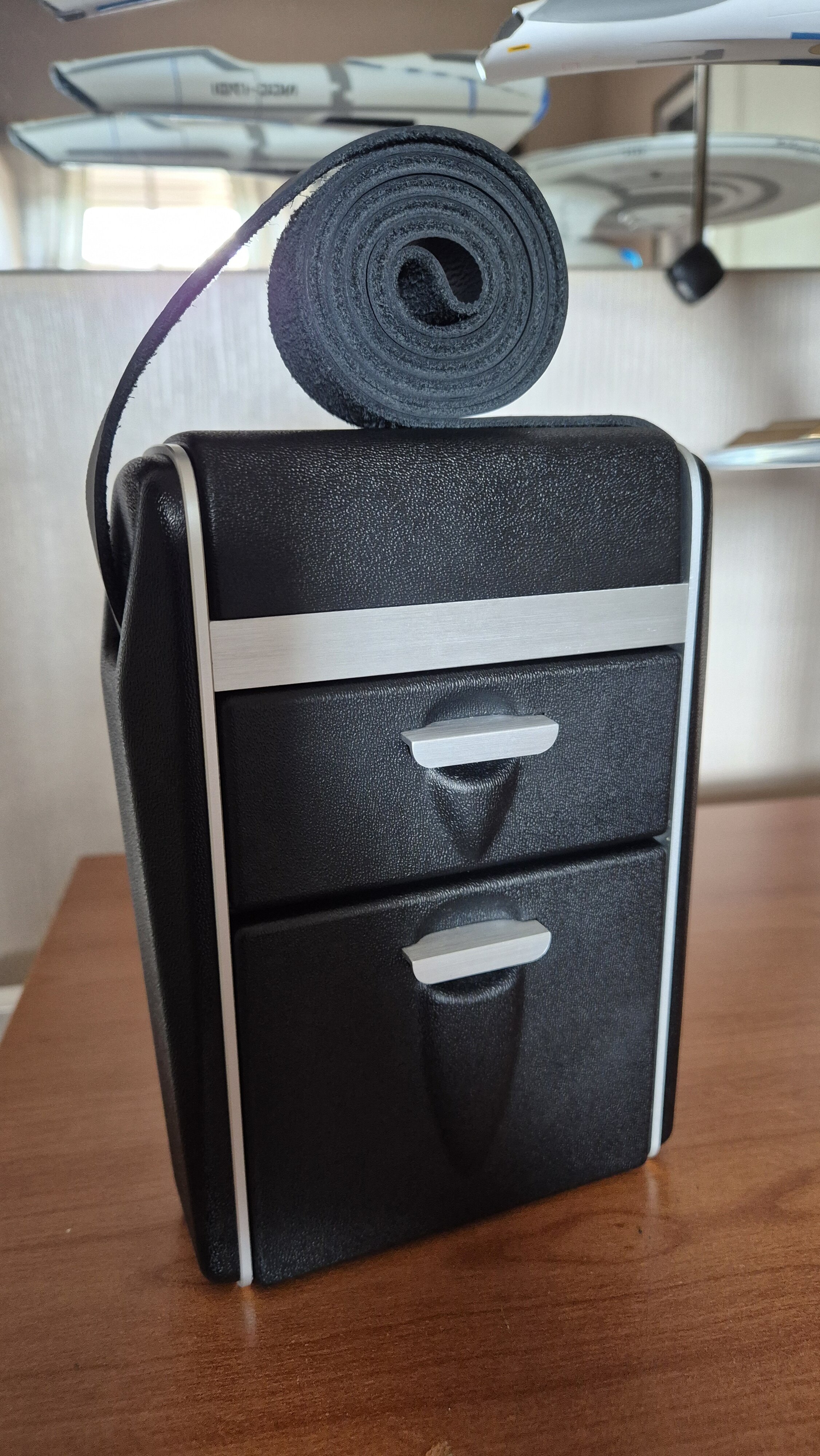

There are different types obviously. The one I have on now is a softer leather that will roll up nicely while still being very strong and is one side finished other side nubuck. I have another piece that is more rigid and more finished both sides. Going to see about getting them stitched later today.

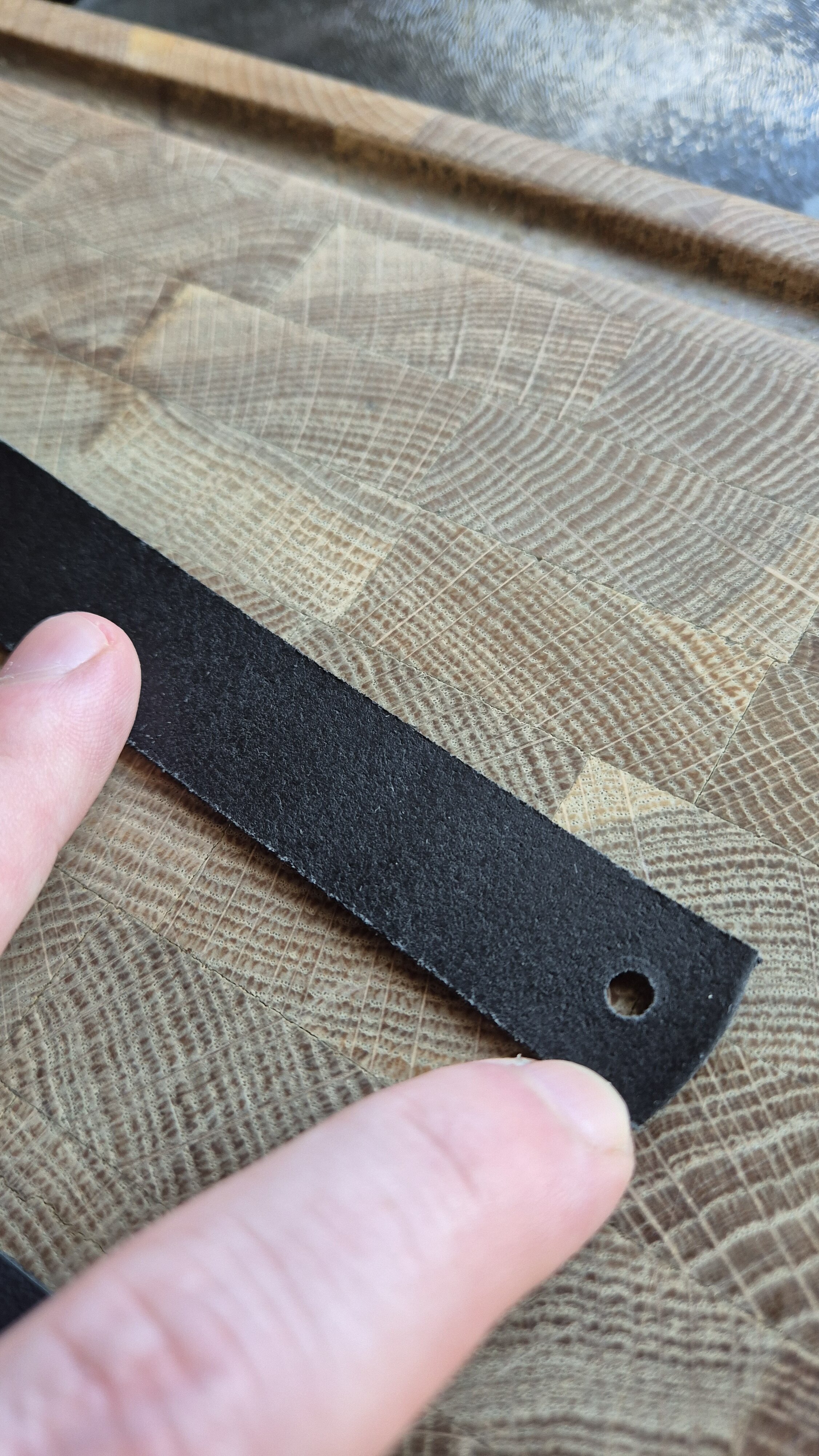

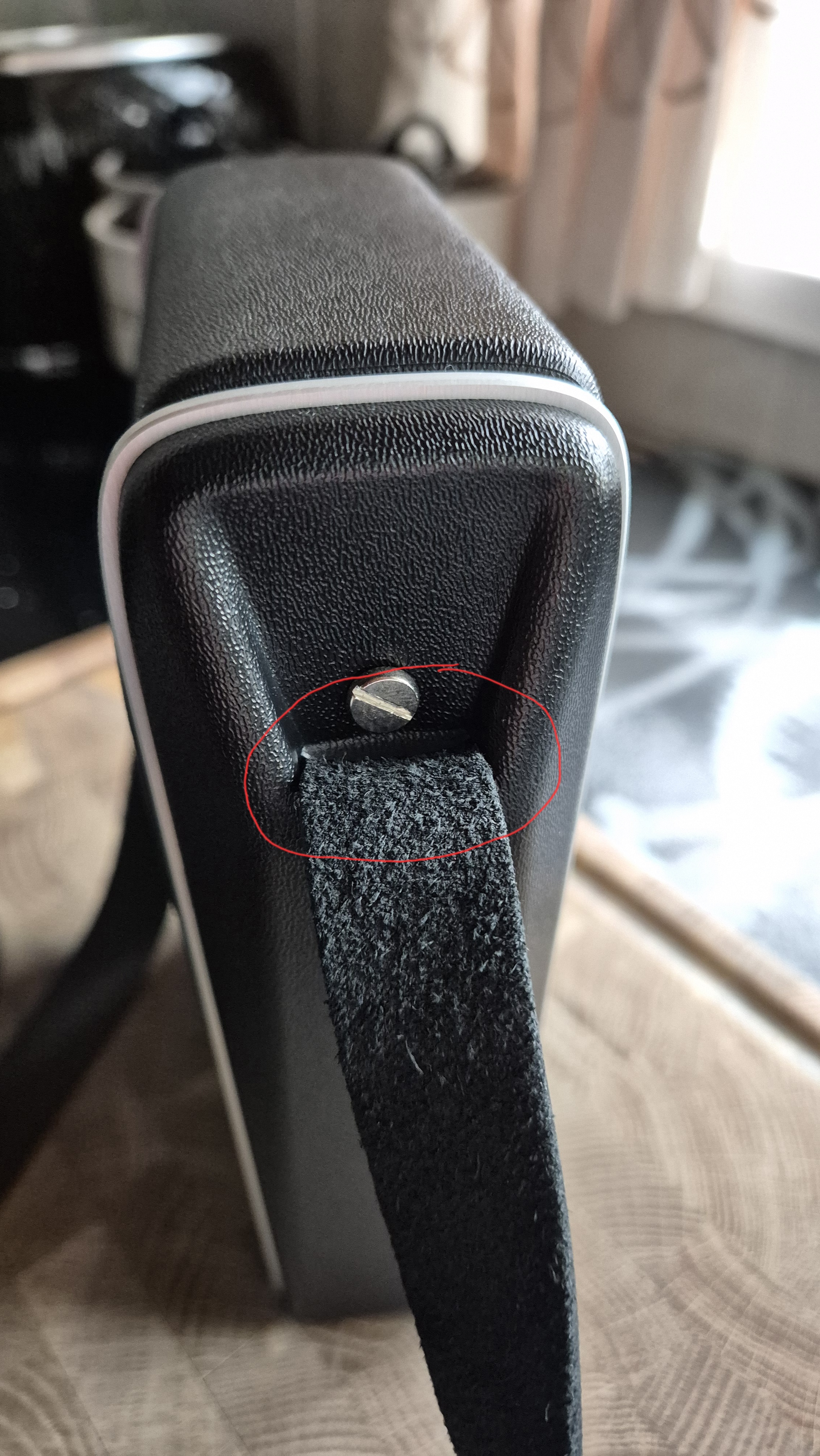

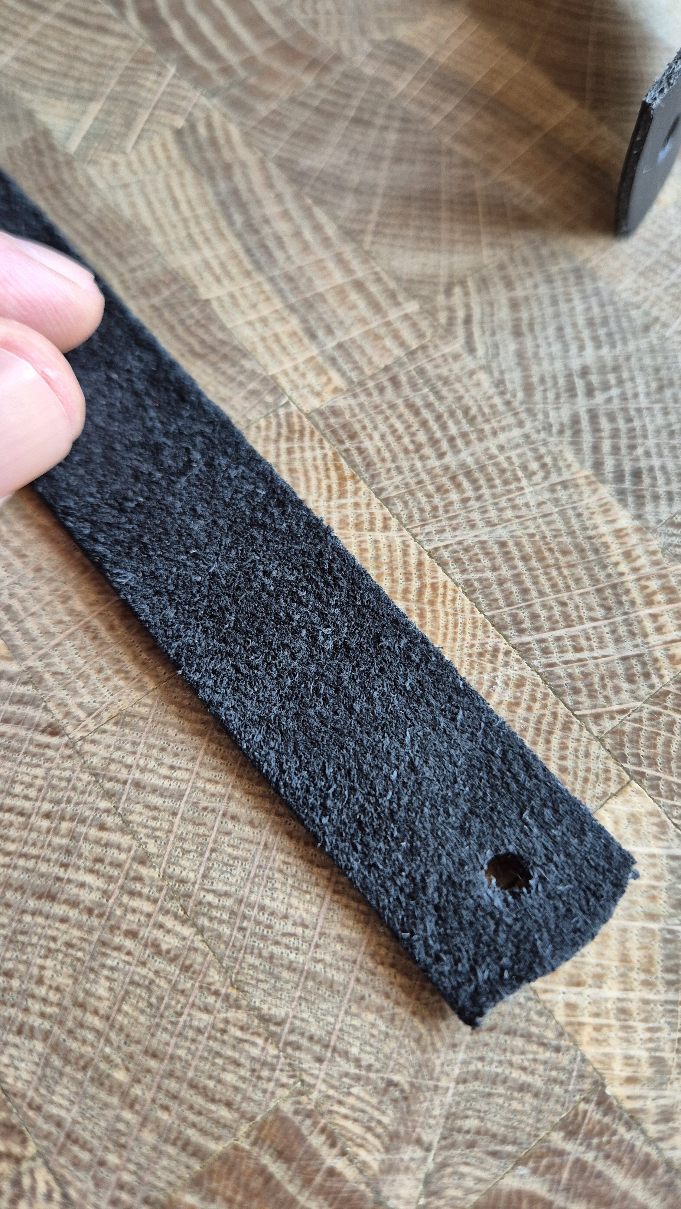

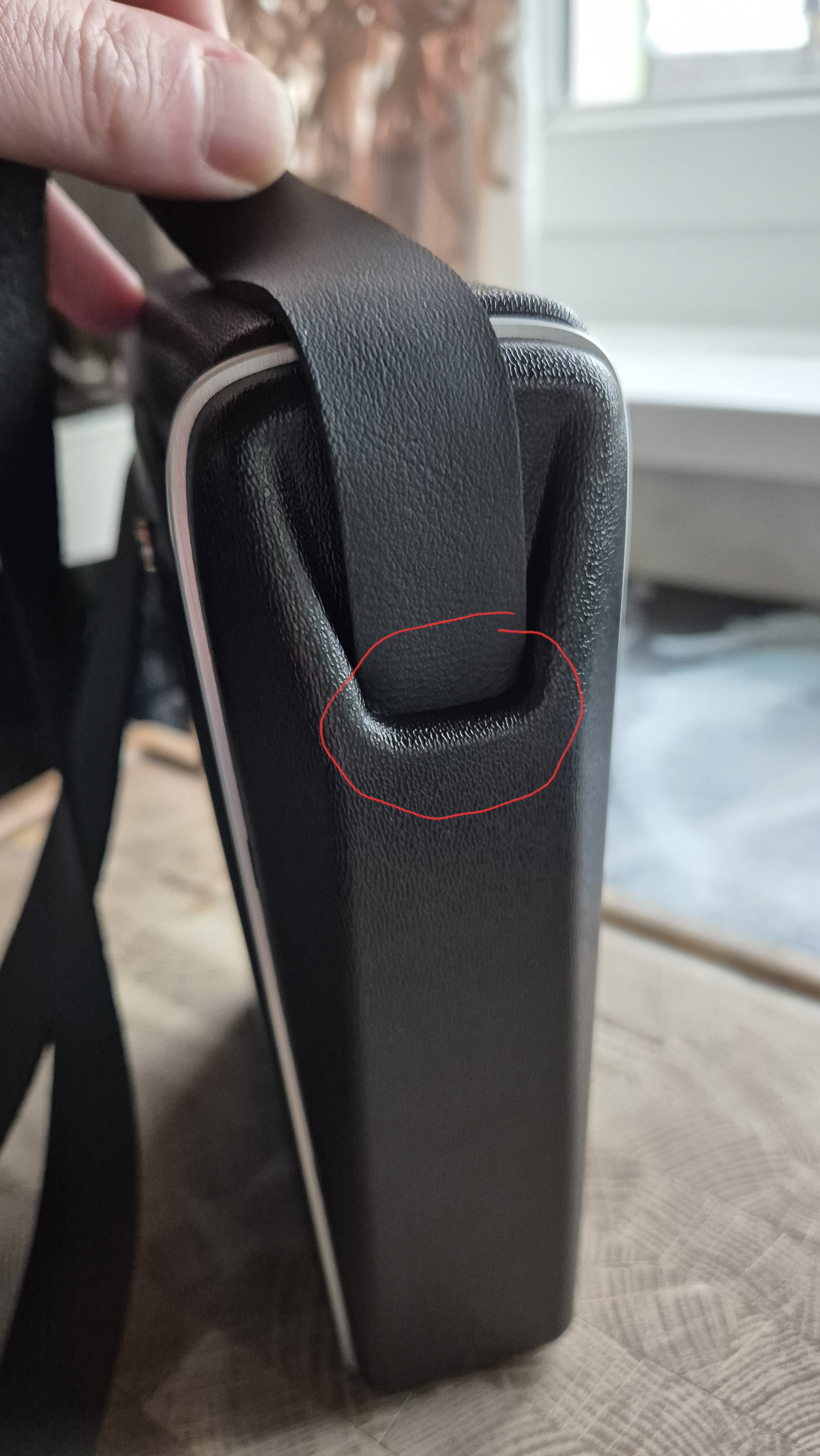

Yes it's easy enough to get 19mm width straps and they fit perfectly but if you have a strap that's even remotely too thick you won't get it through the side panel slots.
The one I currently have on is as you've described and as pictured but has a black raw nubuck inner and not brown.
I have 2 I'm getting stitched. One is identical to what's on my trike and the other is slightly more polished and the inside is not completely finished but smoother than raw nubuck.

A suggestion….since the strap openings (cutouts) are at the bottom of the strap wells in the side panels….and are not seen in general, you can always file them to accommodate strap thicknesses and widths if desired.

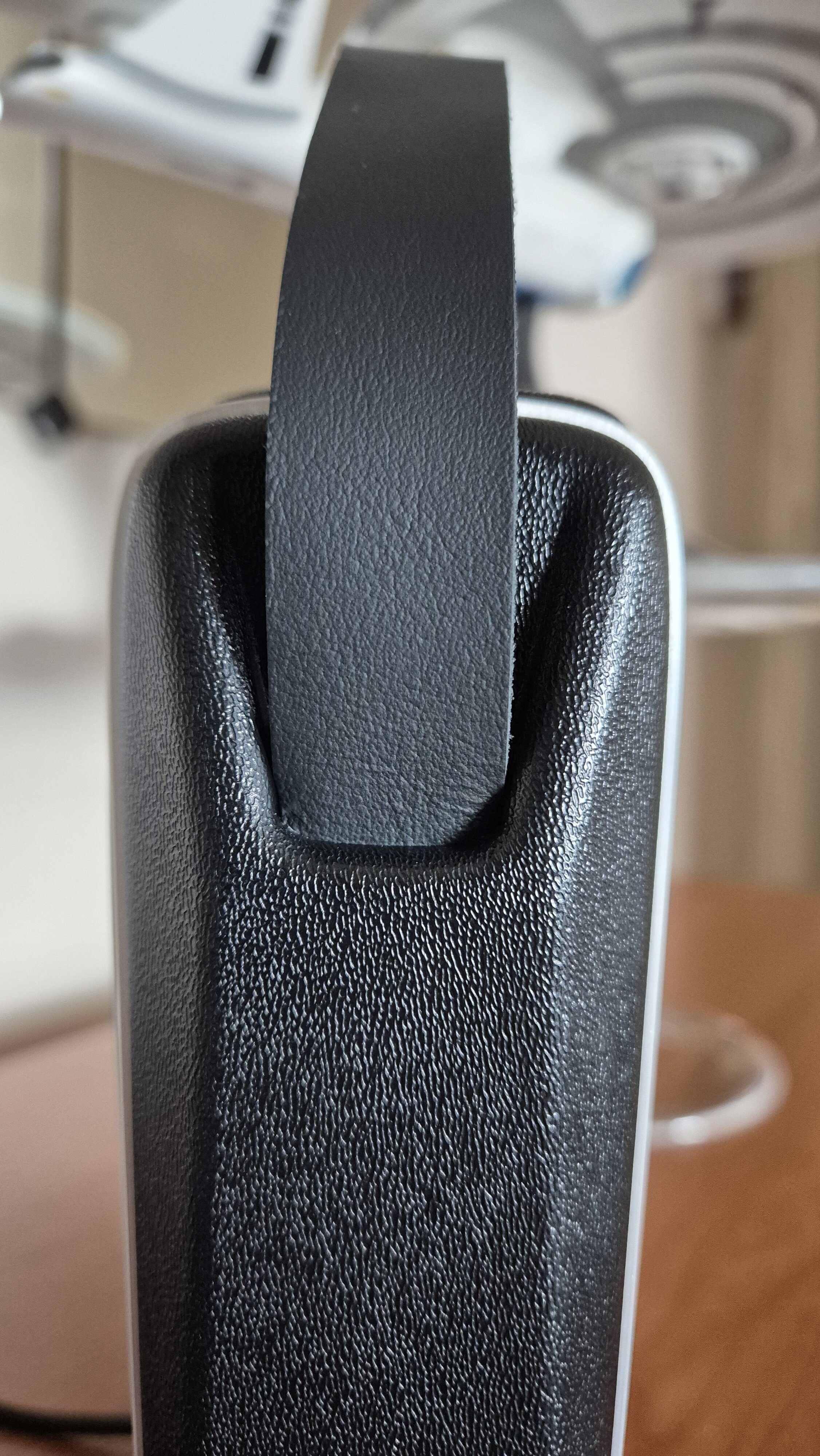

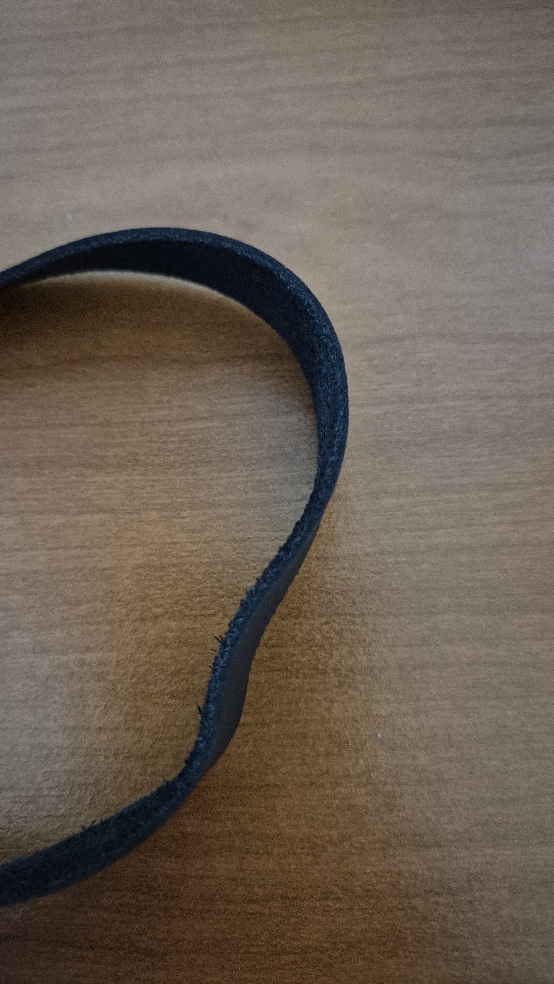

The strap I have on now is 1.5 and is very sturdy and not too thin, however if you were to use a simple nappa soft leather it would likely stretch too much.
I wouldn't go anywhere near 3mm thickness, wands faux is 2.5 but I have tried a little thicker and it won't feed through.
Depending on the type of leather I'd say 2mm is the max but if you can get a sample to test first would be better, I had to go through a bit of leather to get it right.
I've included a short video, at the end you can see the leather stretch slightly because of the force I'm using but just in carrying it doesn't budge.
