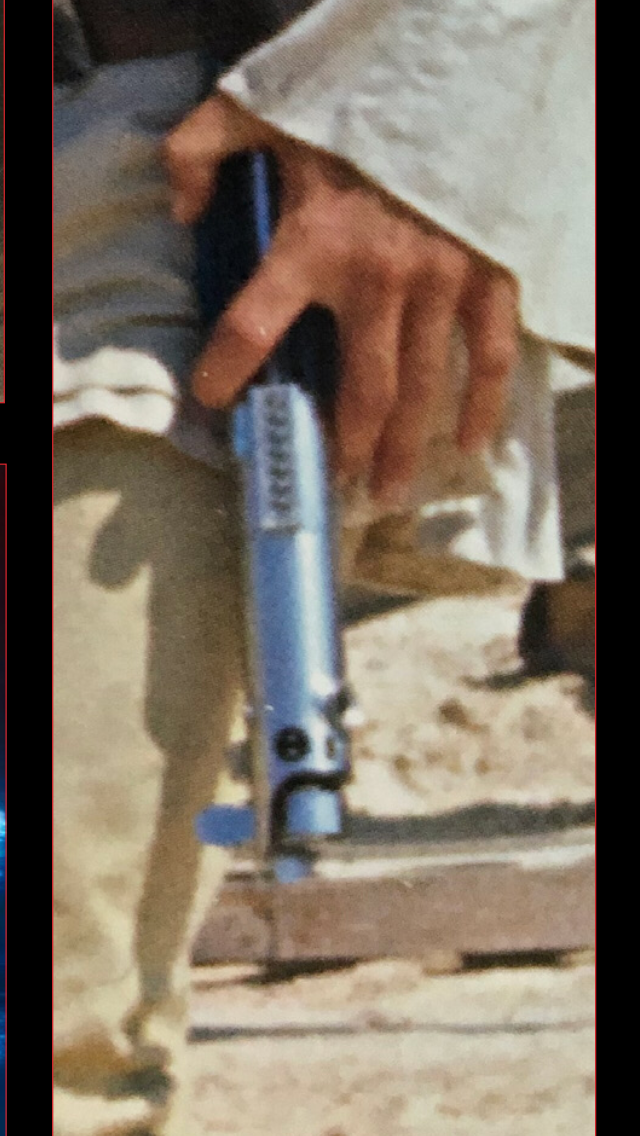

It is seen closed in one picture that is in Seth's book
It’s possible that it broke during production.. Anyway, since I don't know the photo you are talking about, could you show it to me? Thanks!
It's a screenshot of it so not the best quality

It was a theory a while back that with the washer missing and maybe something mis-aligned with the clamp, the lever wasn't able to lock, and would frequently fall open
I still stand by my idea that it's because the lever was screwed onto the clamp so tightly. You can see the end of the screw standing proud of the hole in the sidebar. I suspect that it was done to ensure a tight fit for all the parts, or perhaps to keep the bubblestrip in place.
1000% agree... we not only see this on the hero, but the mitchell saber as well
If the bubbles (or esb cards) are cut just a little too wide it is hard to close the lever all the way and after some point I start to feel that if I force it more it might break. As I don't really want to replicate the open lever in my builds I just file the bubbles until it closes nicely. But I won't be surprised if they didn't bother to do that and just left the lever as far as it could go.
I've seen some broken levers posted by forum members and I'm not so convinced anymore that you can use a just small nail and maybe some glue to fix it and will be strong enough to hold. Can't rule it out completely, but now I understand why they fixed the ranch saber lever the way they did.
So currently I find the type of levers that were suggested by Drew Baker few pages back to be the most convincing match to what I see on the picture.
