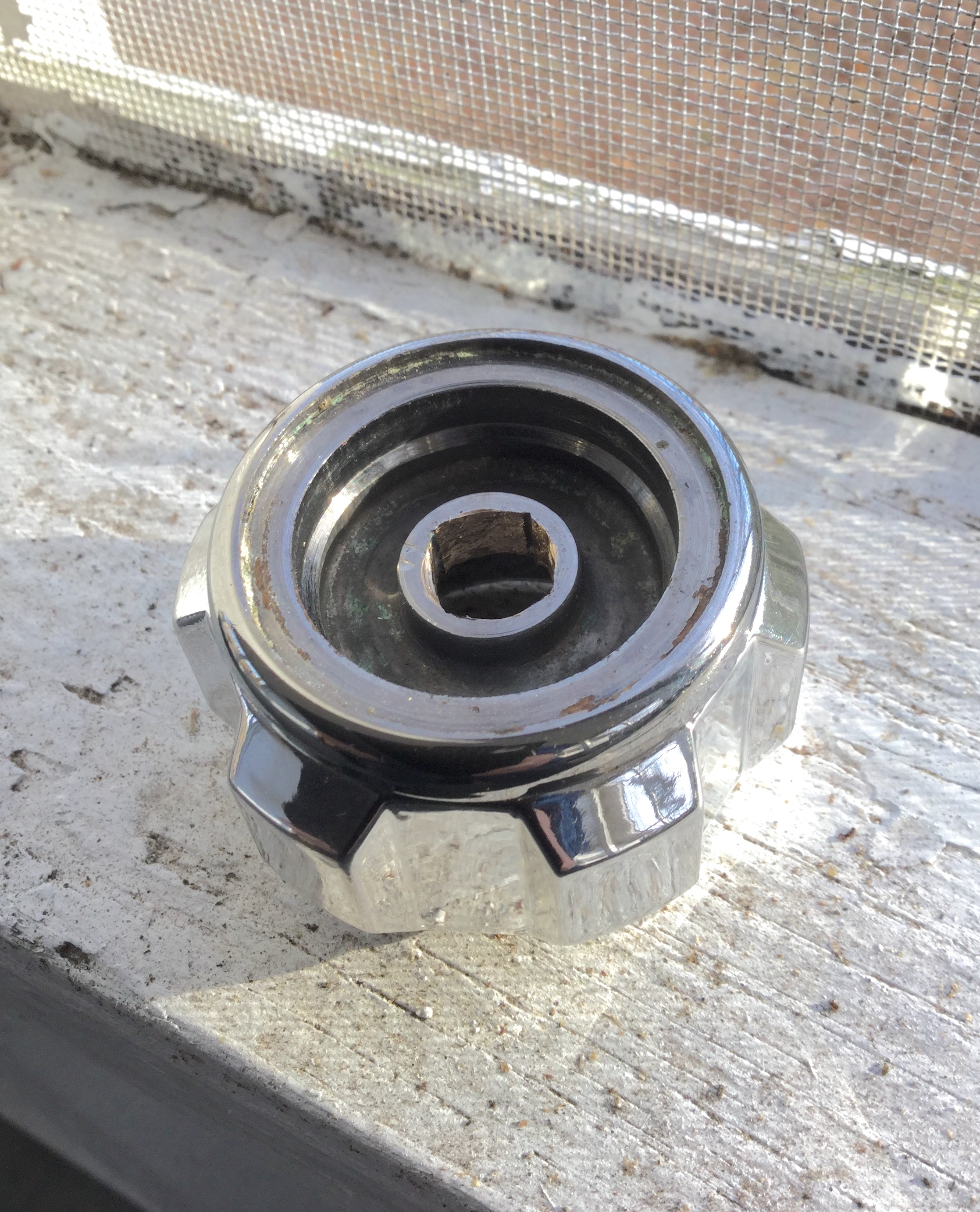

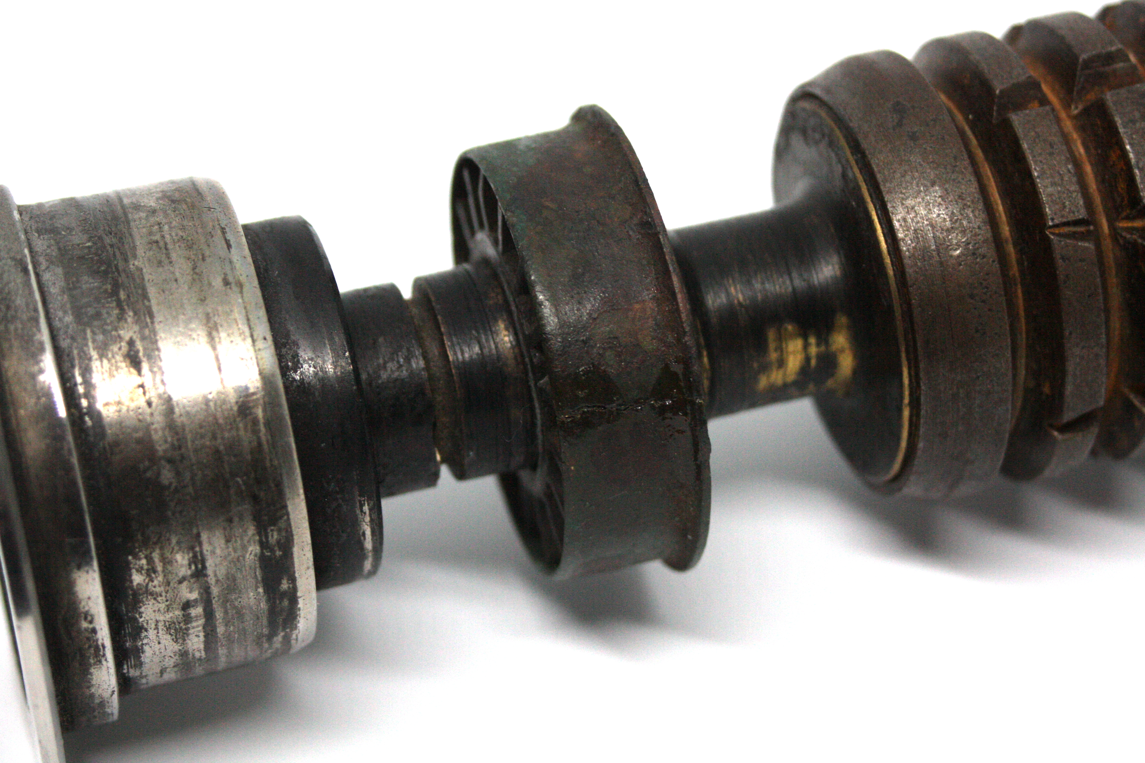

Question for the sink knob.
I can get the carriage bolt no problem. However, the bolts have that square bit under the head, & I can't find one thin enough that will allow the knob end cap to go back on. My Armitage has a raised flange inside that will keep the head of the carriage bolt to high.
Is this normal? Is this something that you guys had to grind down? Or am I not finding the correct bolts?
I would love to be able to get the "C" cap with its blue ring back on after I get everything together.

I built mine with an M6 rod, had to use a cone adaptor fashioned to fit but meant no alterations to any of the parts. That way you can use a small bolt under the end cap too.

I used a regular full threaded bolt (no square bit under the head) and then sanded/ground down the head of the bolt:
https://i.imgur.com/lJRTeAo.jpg
If I can't find anything, I'll see about going with your technique.
Thank you for the picture!

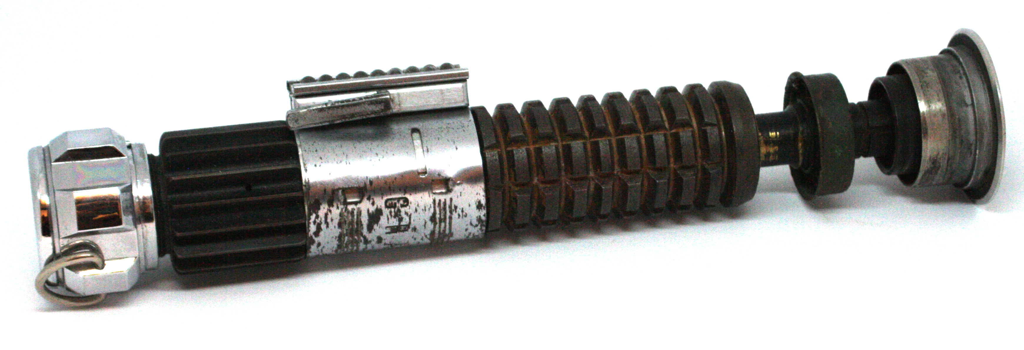

Here is one of mine. Its all vintage parts except the booster, which is a Serafino replica. The Balance Pipe is one of Roman's corrected male to female models. And the calc bubbles are not the correct version, but I wanted vintage over replica
That's beautiful!
Is there a reference picture of the sink knob with out the cap on it?
